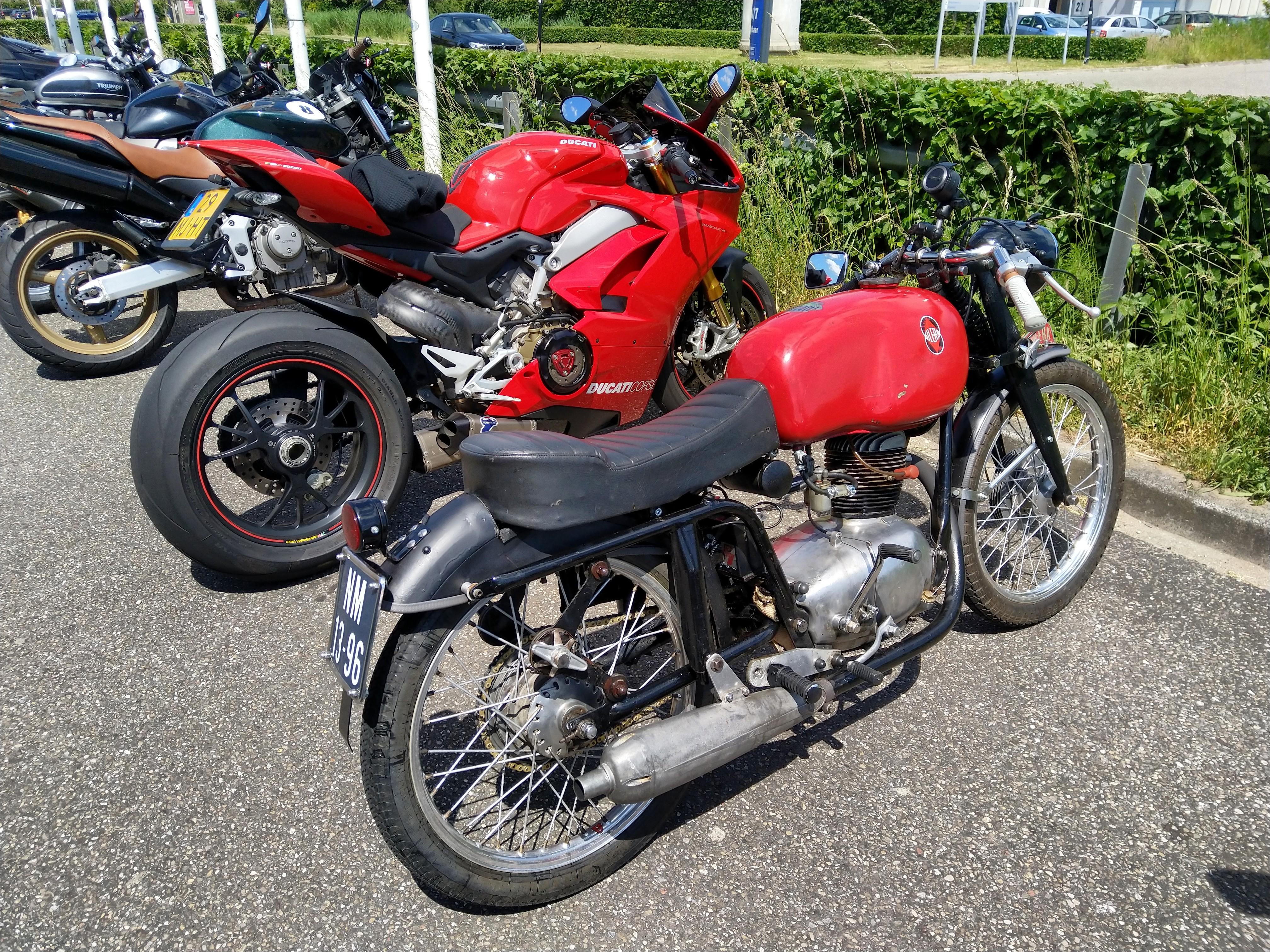

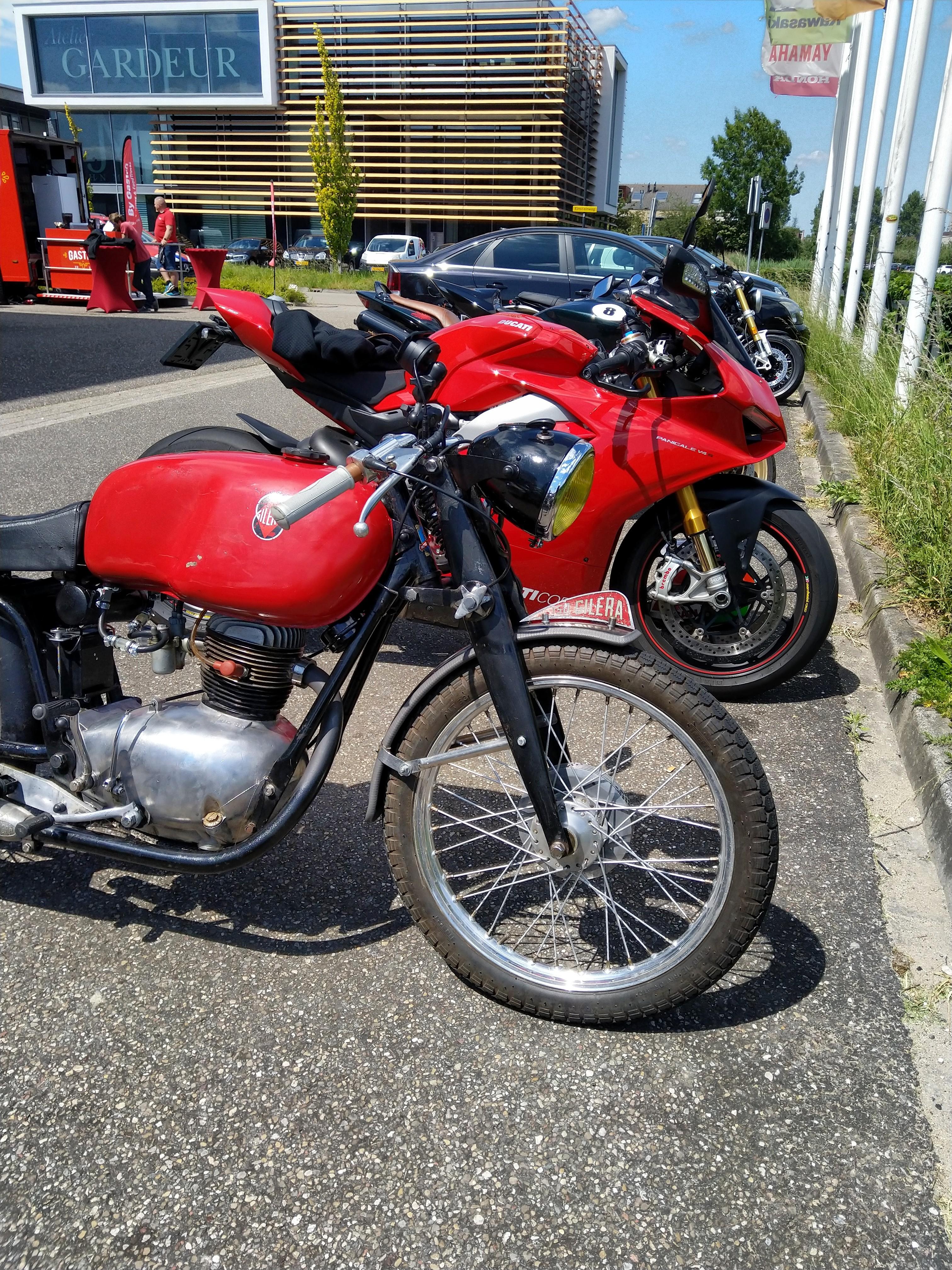

Sportbikes...................
50 years apart..... :tongue:

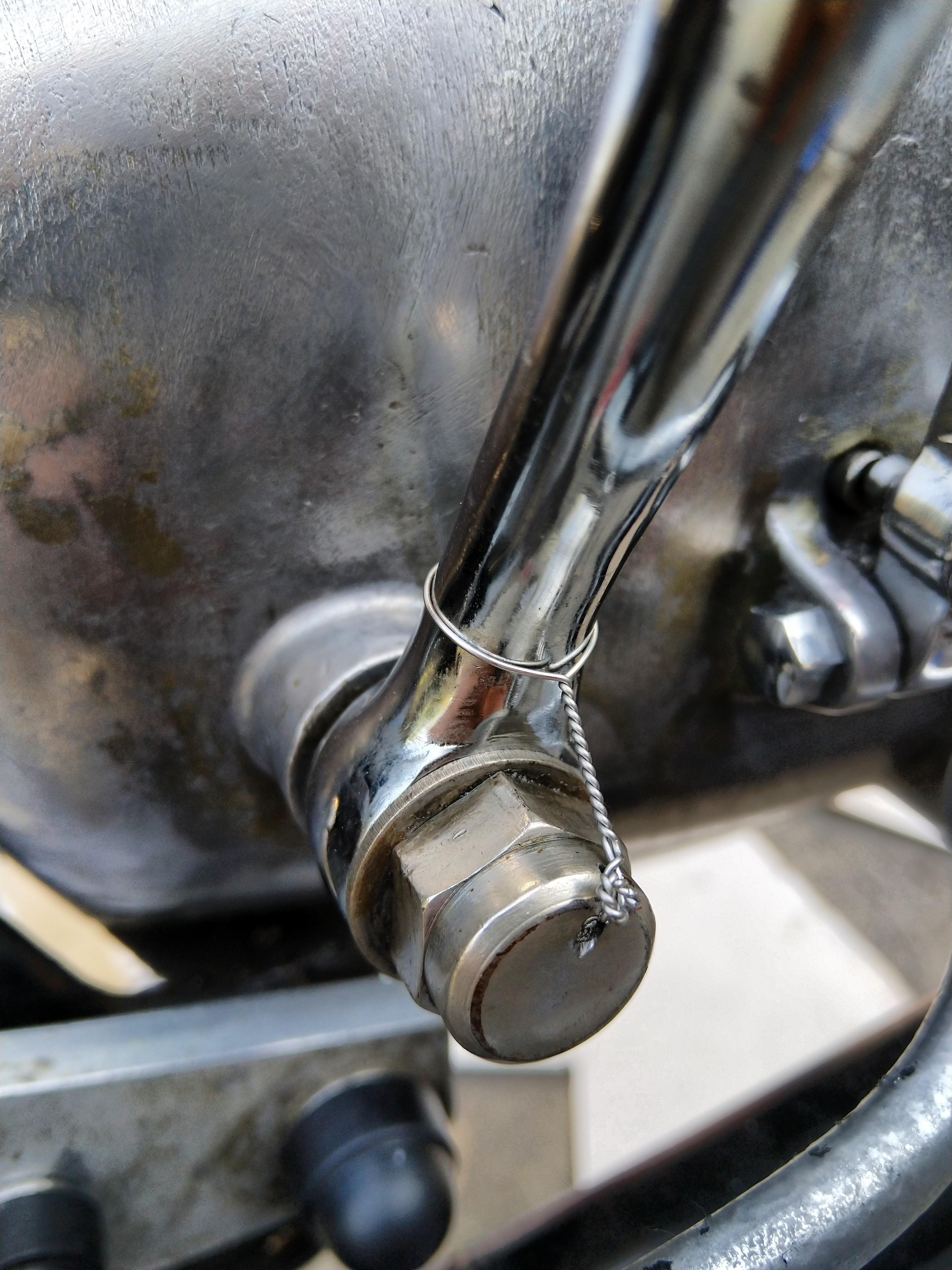

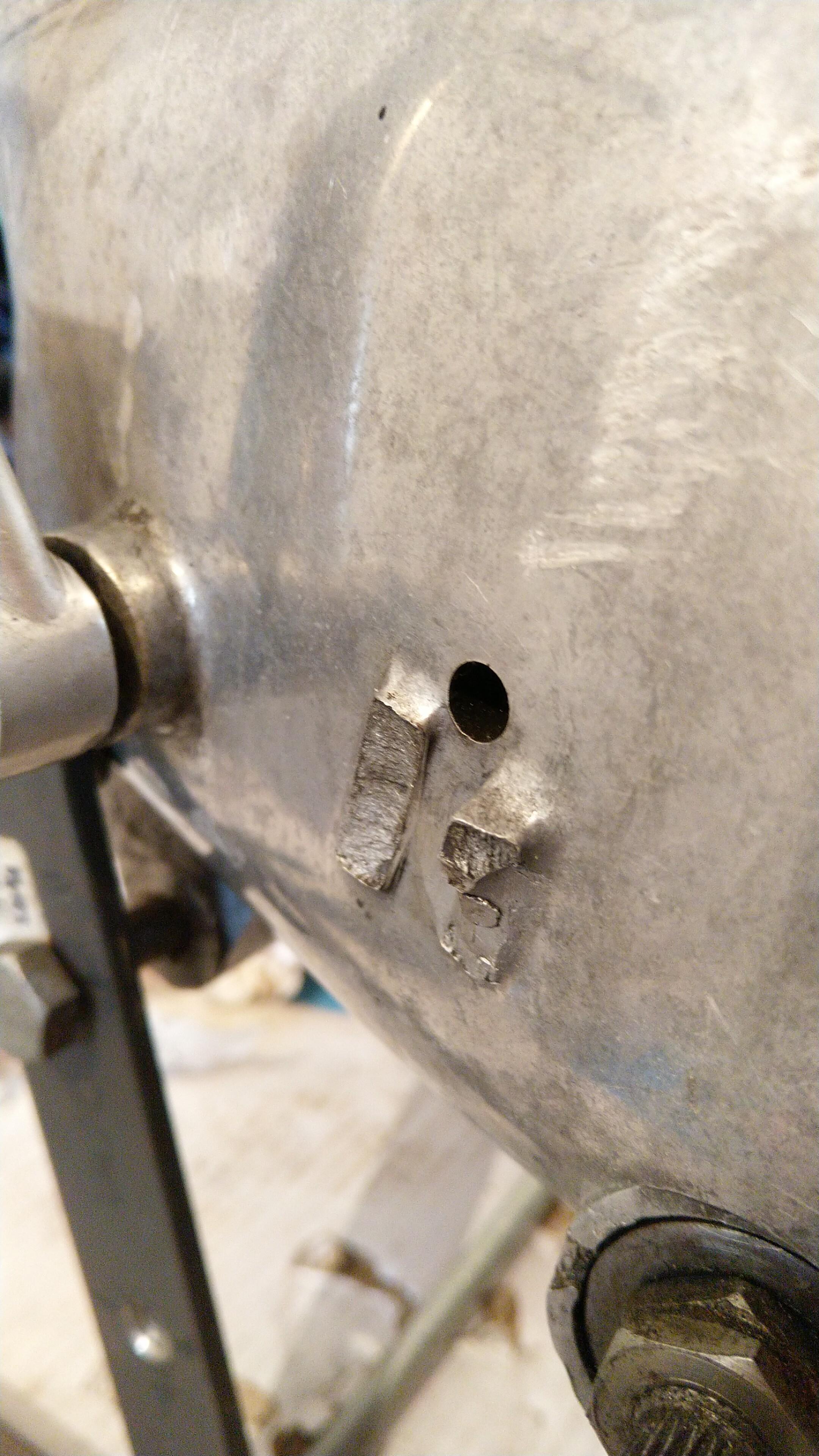

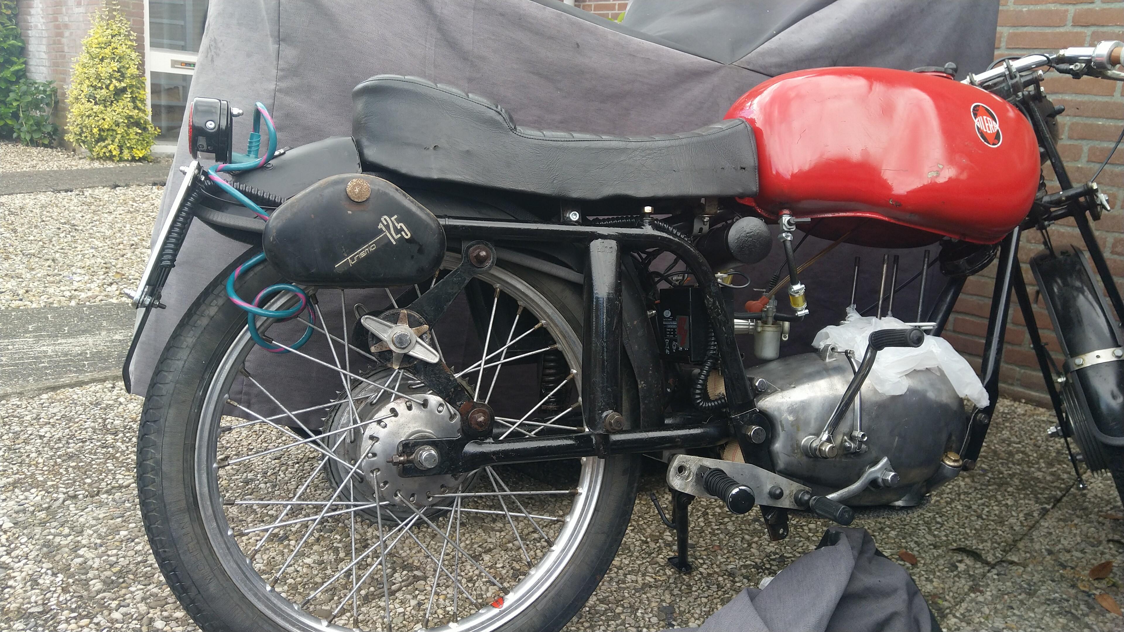

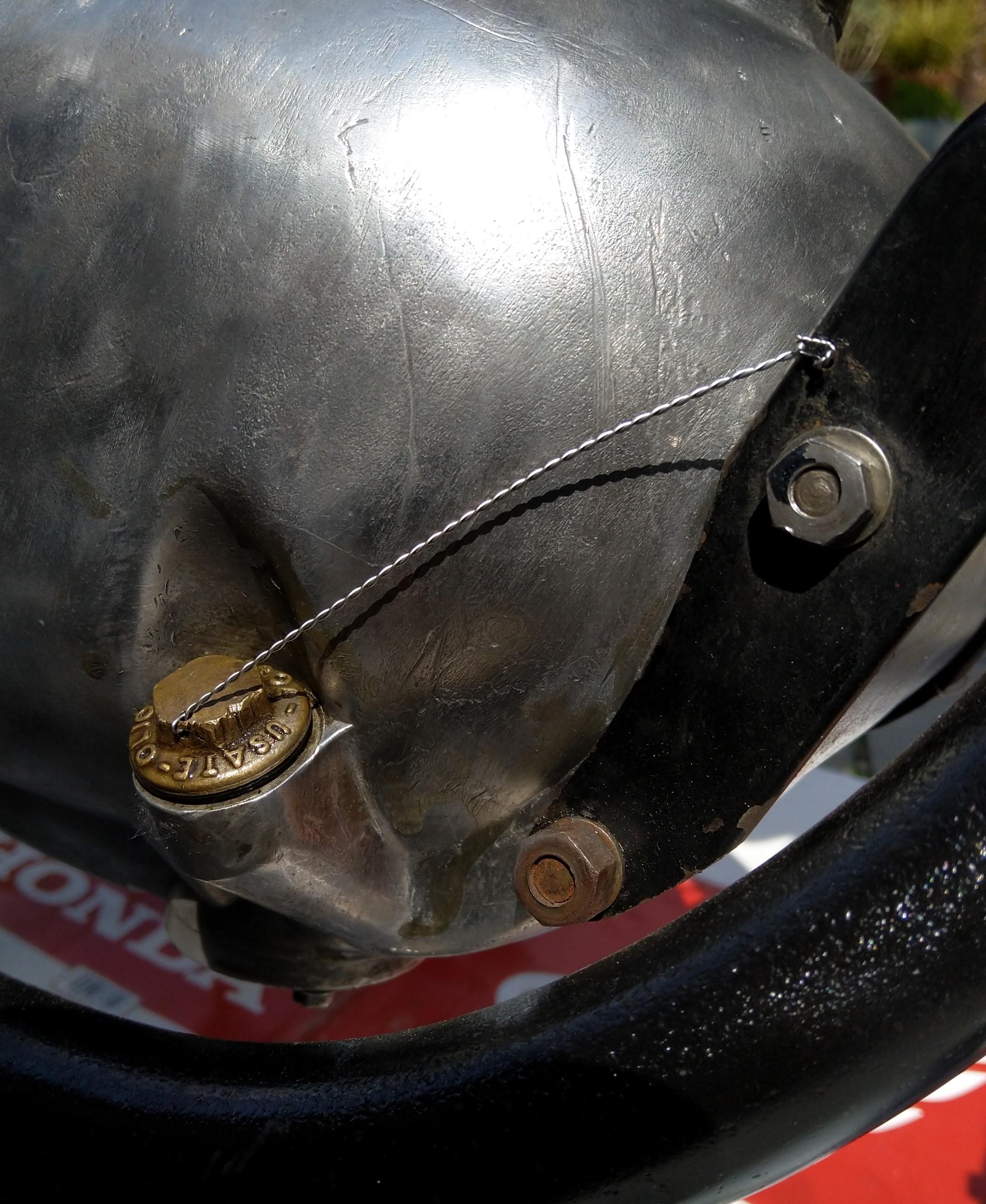

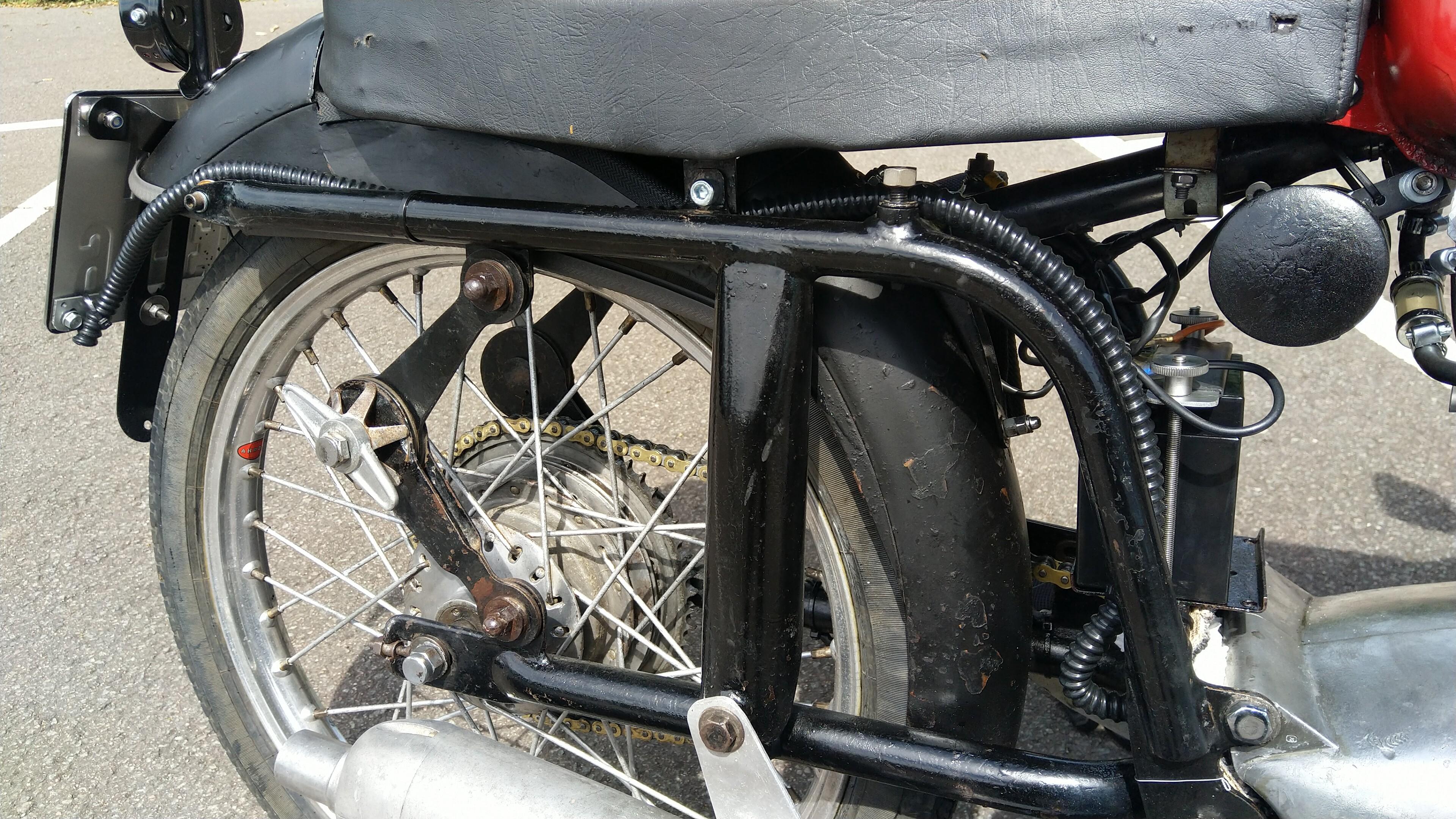

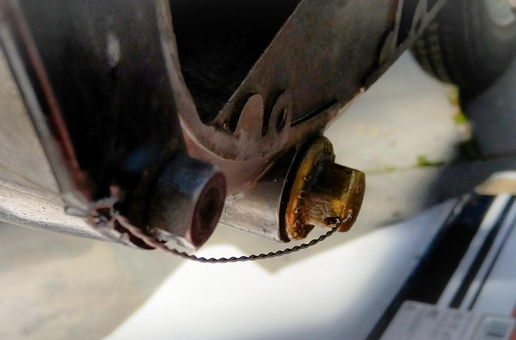

While I now have to wait for my tag, was busy today safety wiring a few nuts and bolts as "vibrator" may be her 2nd name..... :goofy:  150cc 50's engine, as expected I guess...
Note that this is NOT up to USAF/NASA spec, but one deals with the holes presented....
Had the engine running for a wee while, rode up and down the close; then the engine started to run like shyte. Misfiring, poor throttle response....   But, better now than late at night on the Bridge between Denmark and Sweden I guess.... :tongue: @keny

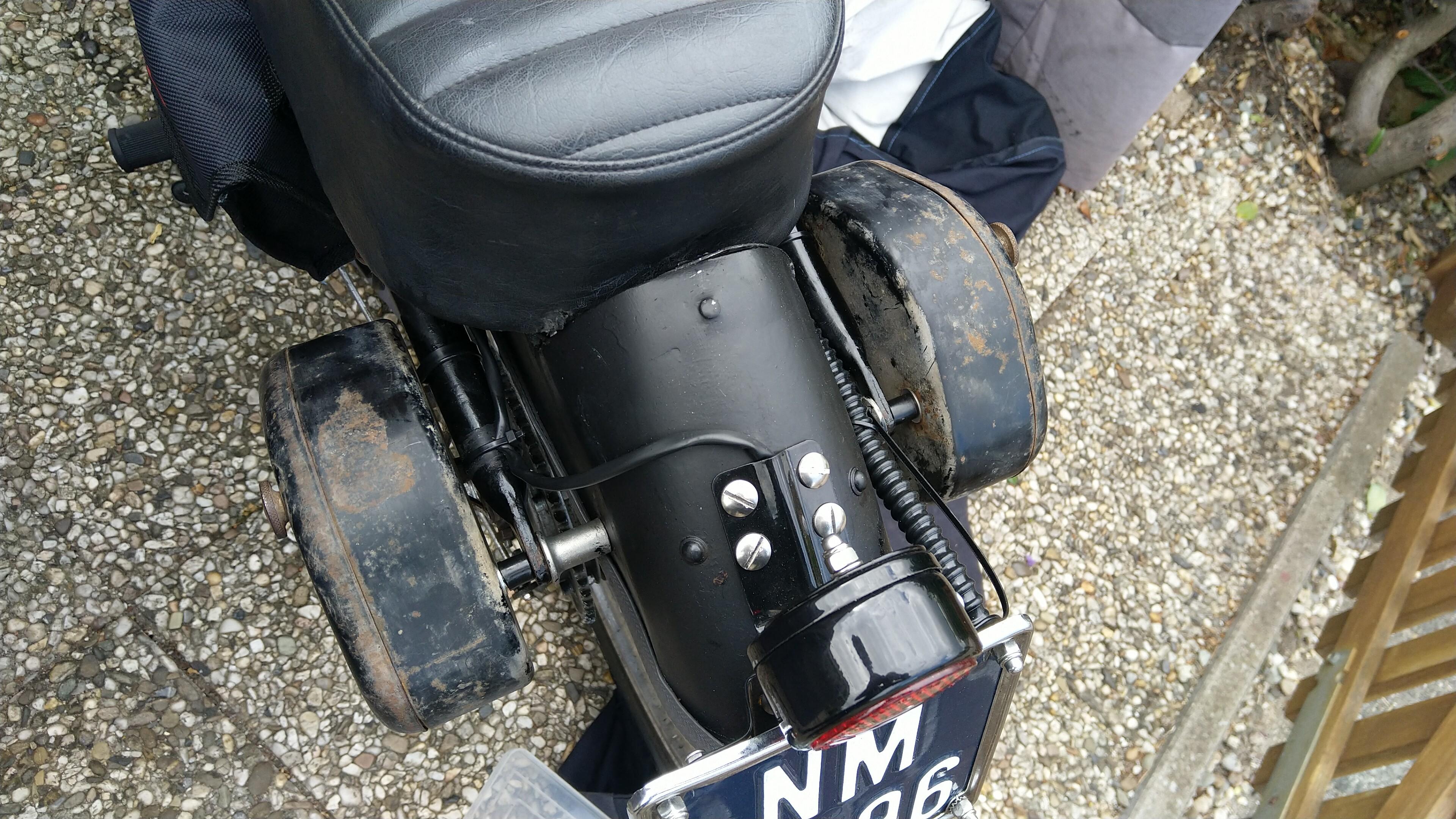

Registration complete - CHECK
Period correct plate made - CHECK
Liability insurance (€36/yr) - CHECK
1st shake down run - CHECK

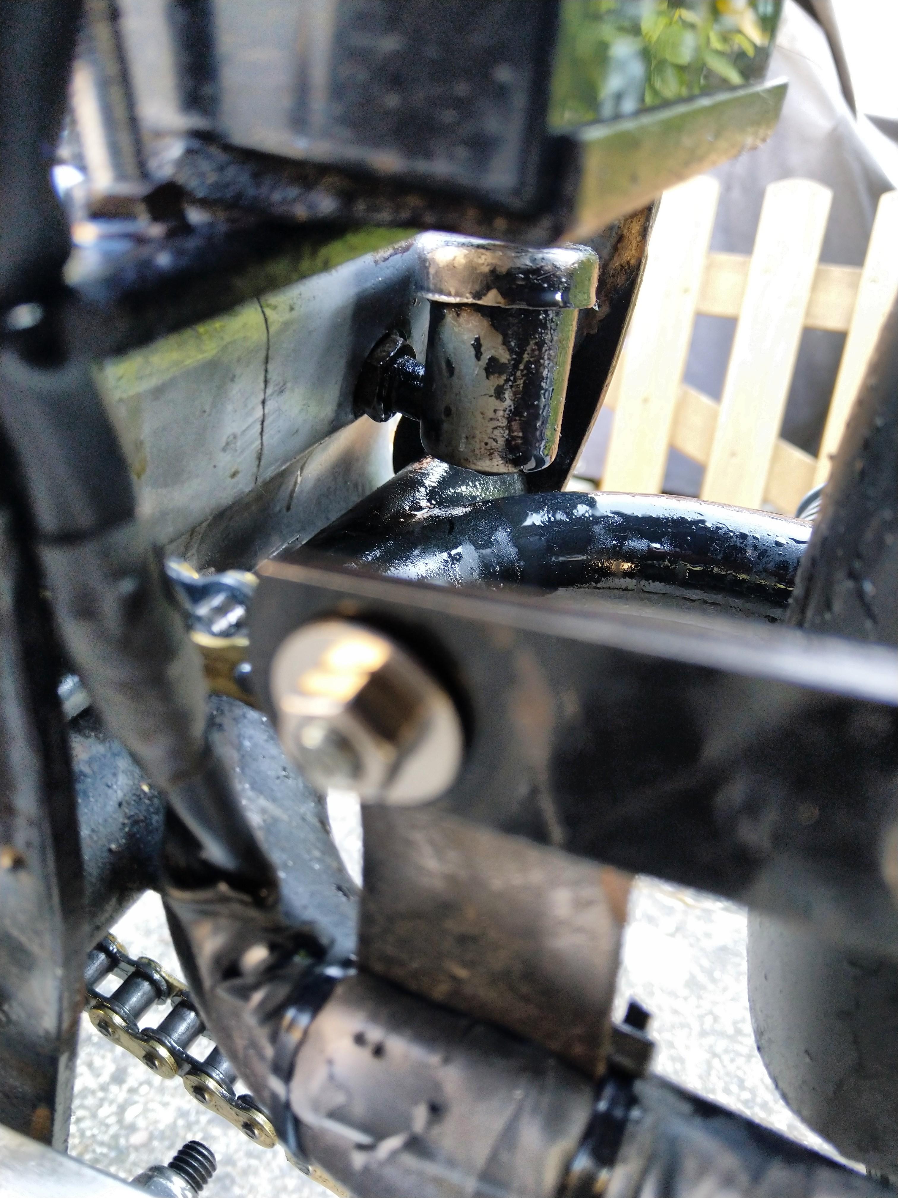

Carter vent - FAIL
All in a day's work I guess :goofy:
Oh man! Those pesky Carter Vents.:blink:
and
It's Always Somthing.
Main culprit is the piston rings, causing too much pressure inside the carter....  to be continued!

...don't forget to make sure the rear wheel nut is properly staked. Front too! 😉
:goofy:
Sportbikes...... 66 years apart
Did @SEBSPEED move into modding Ducs?? 😉

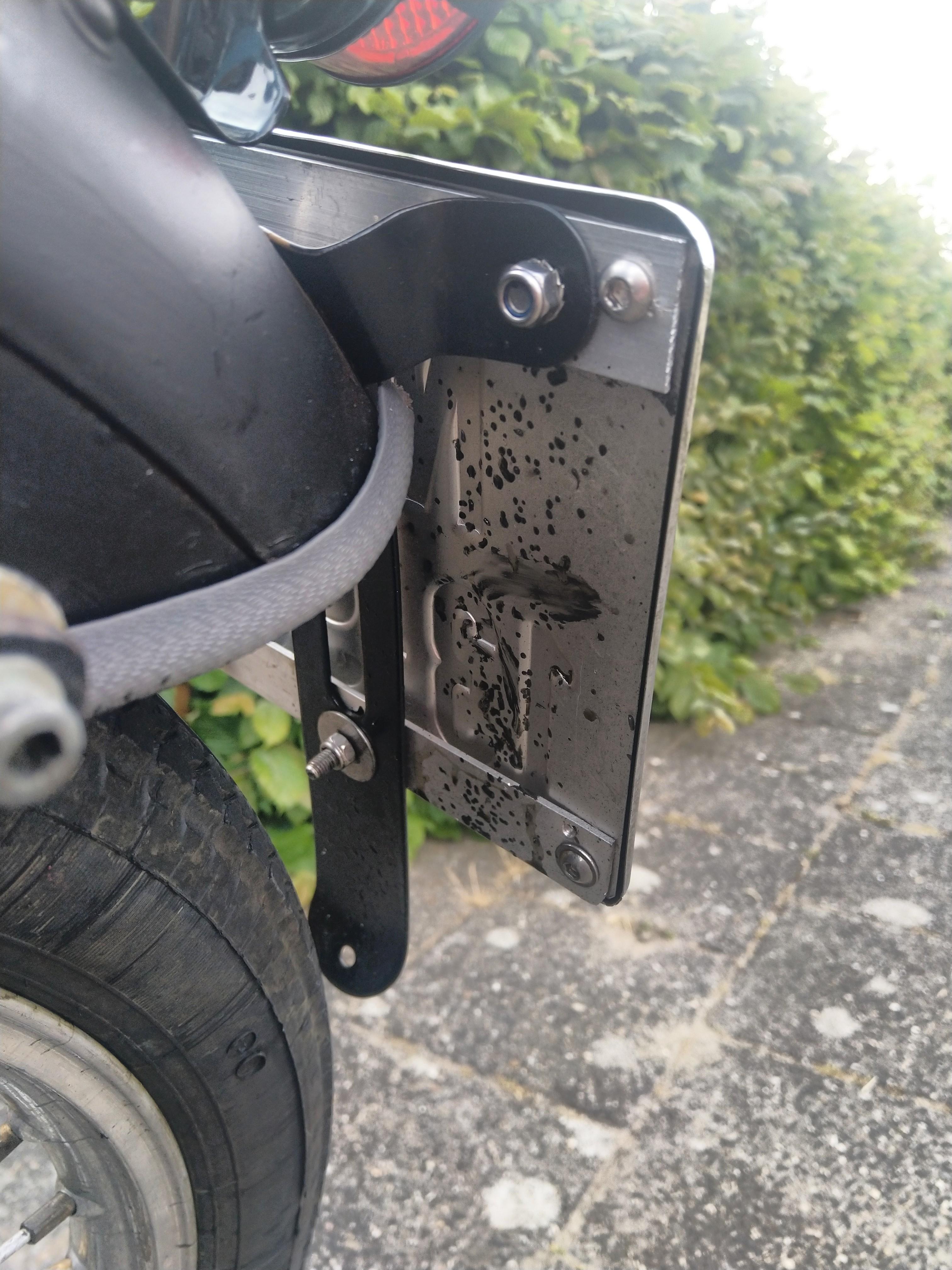

But she's an alpha female alright, marking  her territory

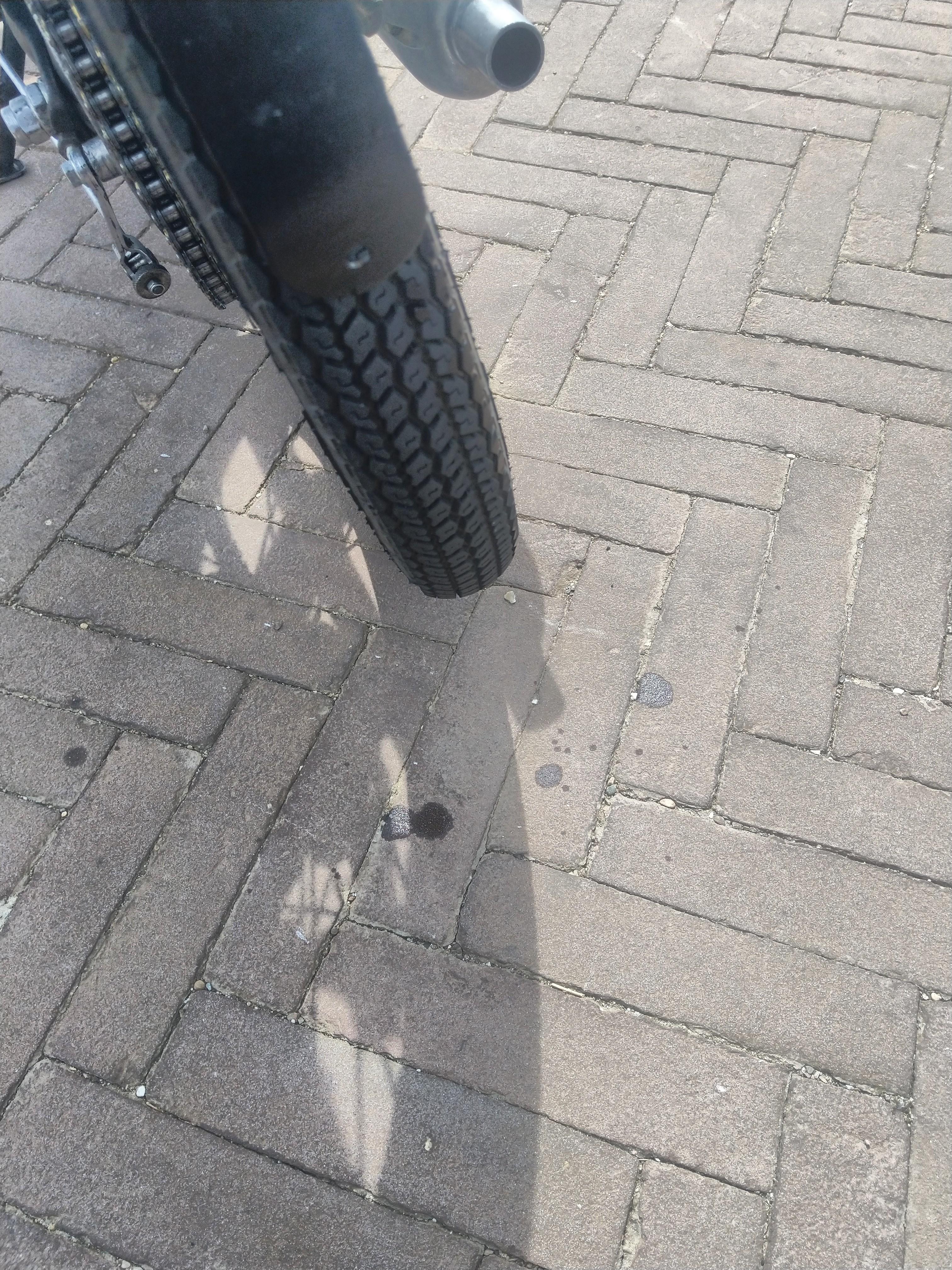

Piston rings remain suspect, the vent smokes quite a bit. Like a 2-stroke.... 😞

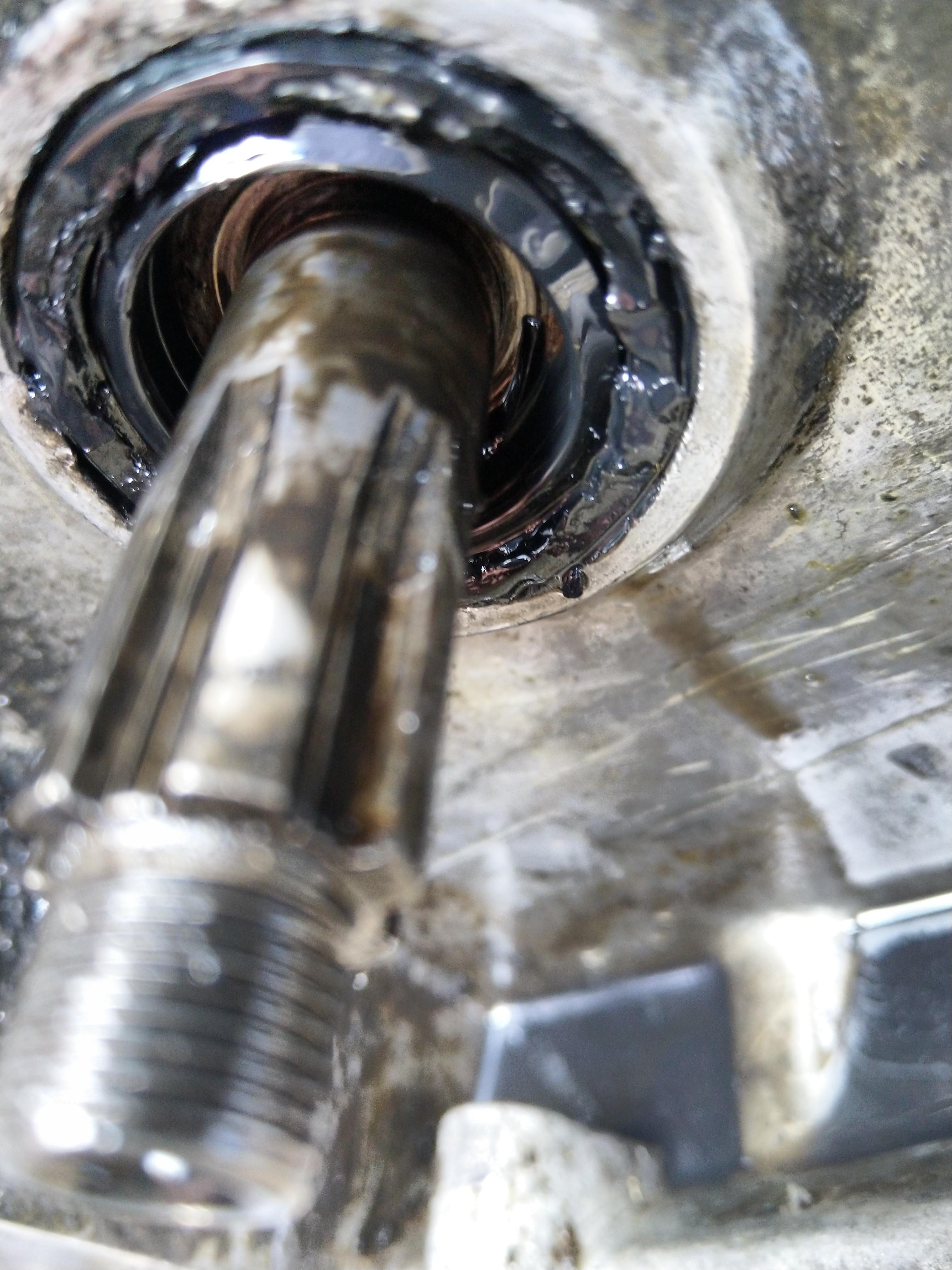

The main leak atm is the oil seal behind the clutch basket.
"Auto chain oiler" flings a bit.. :tongue:
New seal is en-route.. :fing02:

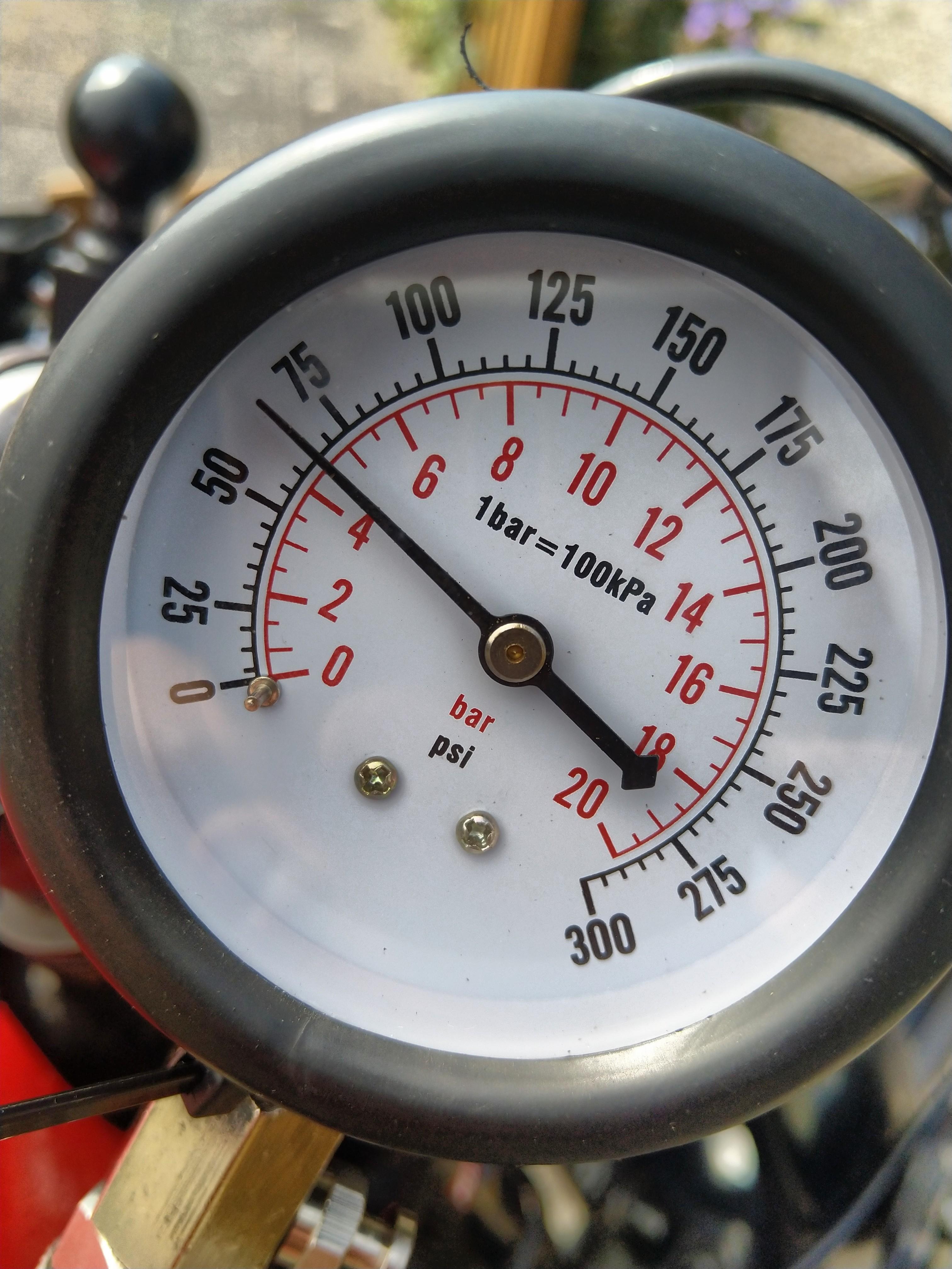

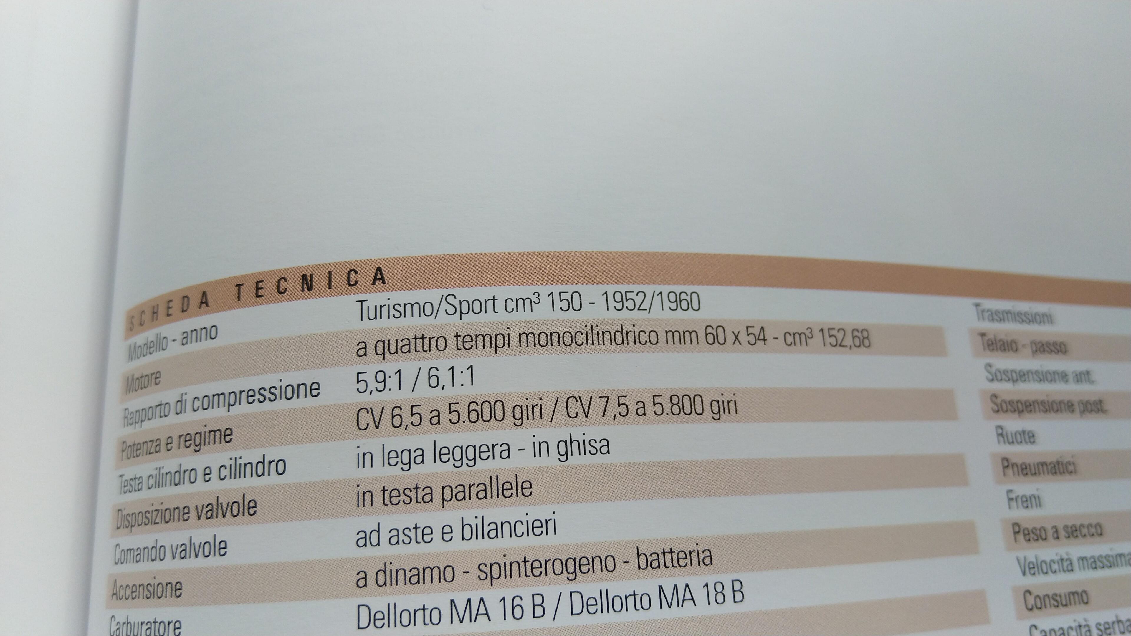

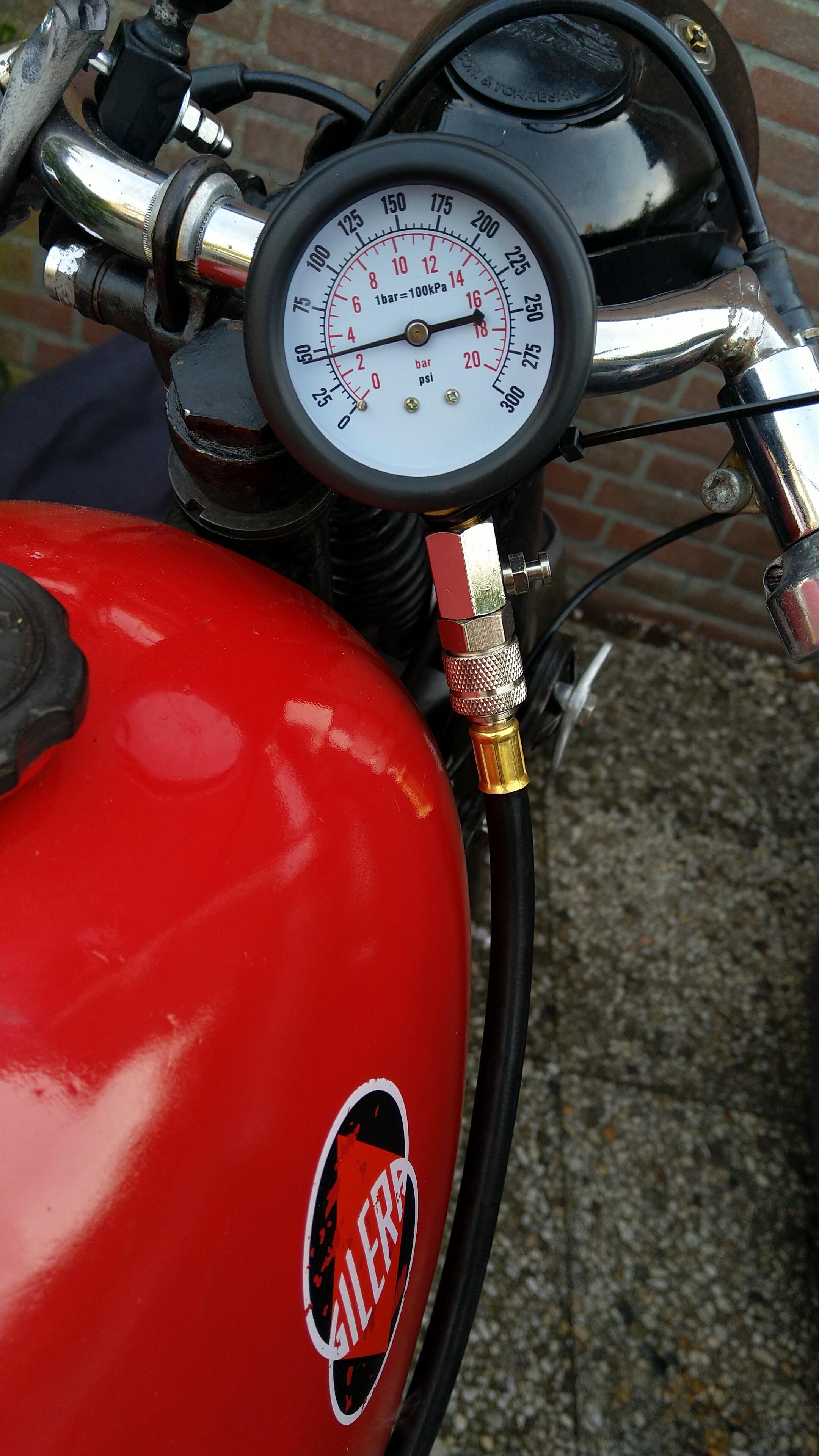

The book says I should have 5.9bar compression
I get....
So now I know where the over-pressure in tge carter comes from....
My bad, I measured with throttle shut.
With WOT
Still bad though....
This is the "Sport" engine so I should get 6.1...

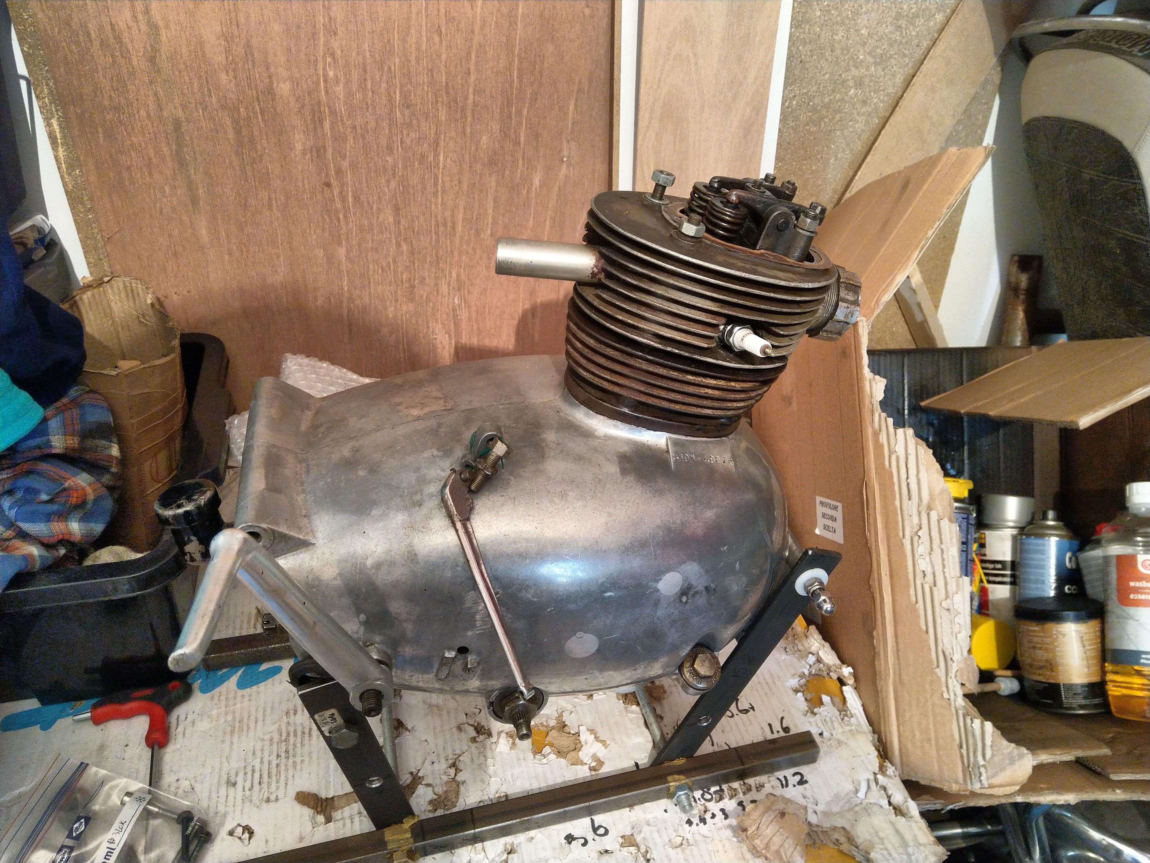

With the Gilera engine's piston rings most likely shot, I started on the spare "race" engine. Splittjng the cases to fit the (removed by a PO) kickstarter.

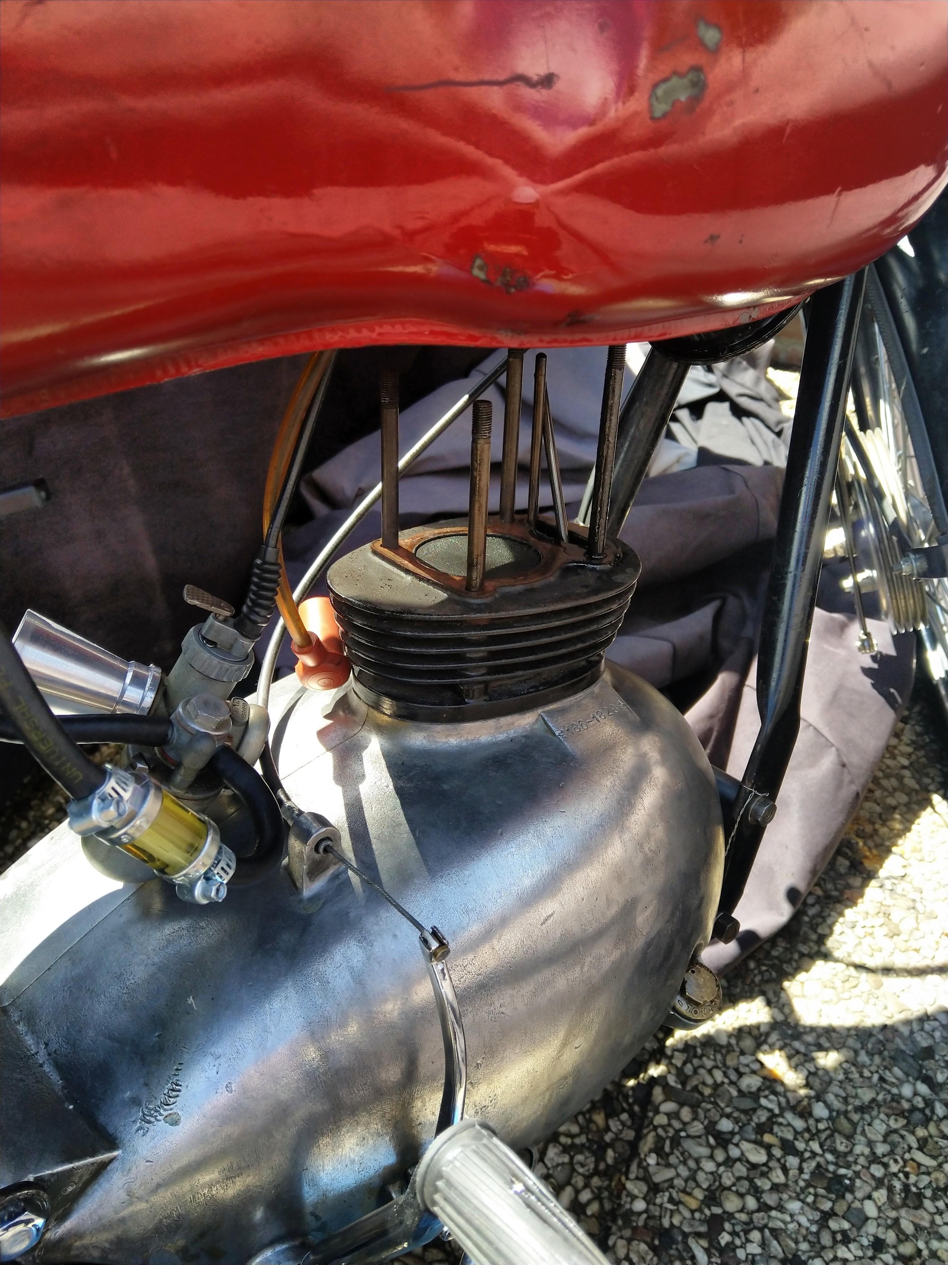

It dawned on me that both being 150's, it could be simpler for now to swap heads. That would get me back "on the road" quicker.  The worn head could then go for a refurb/rebore later.
"those in the know" are verifying if this a straight forward swap...

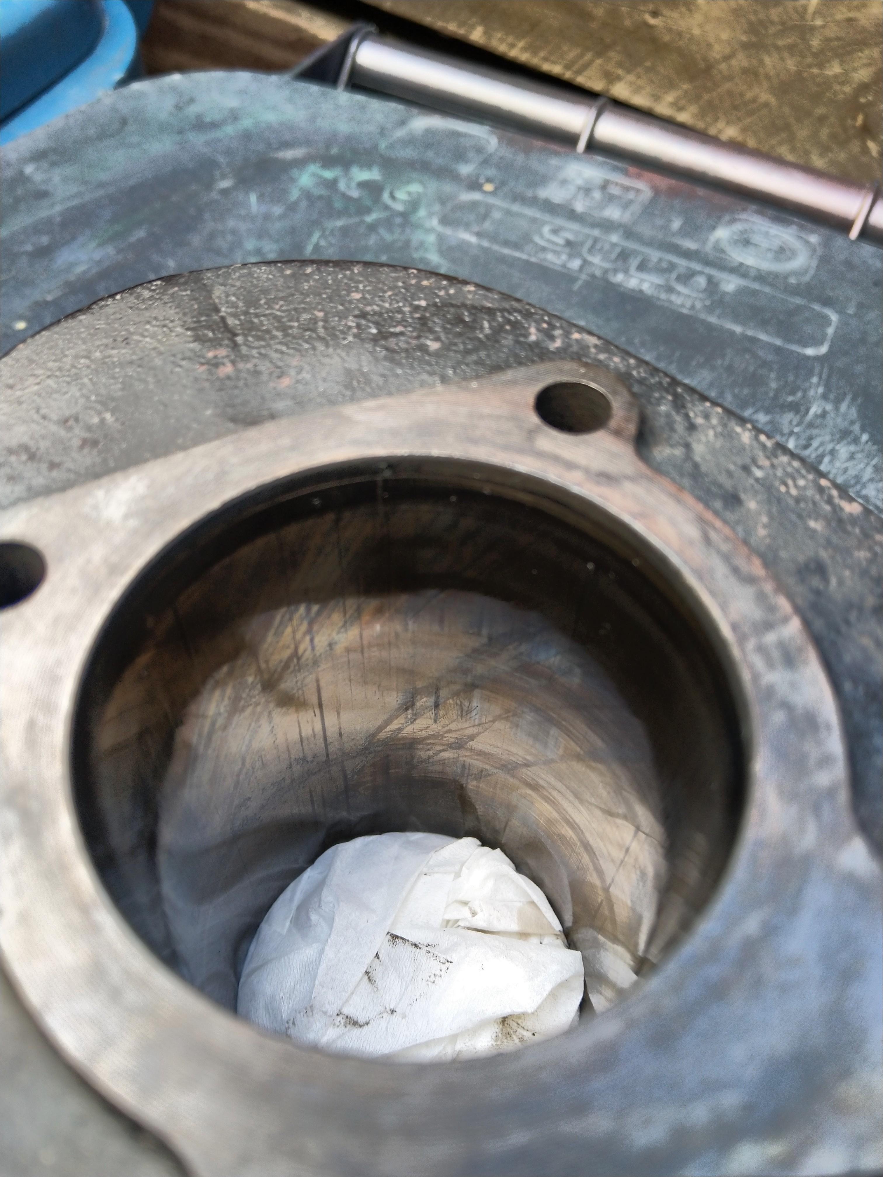

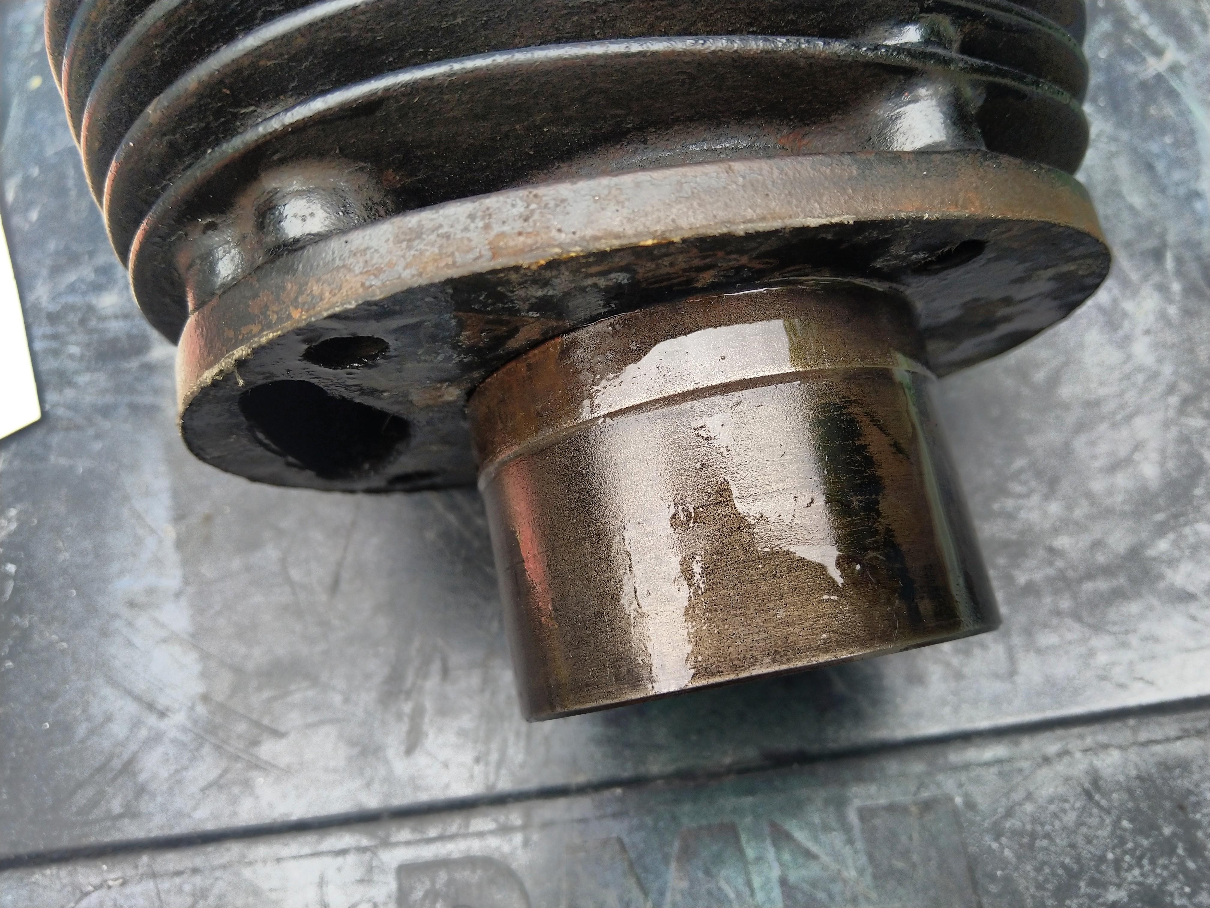

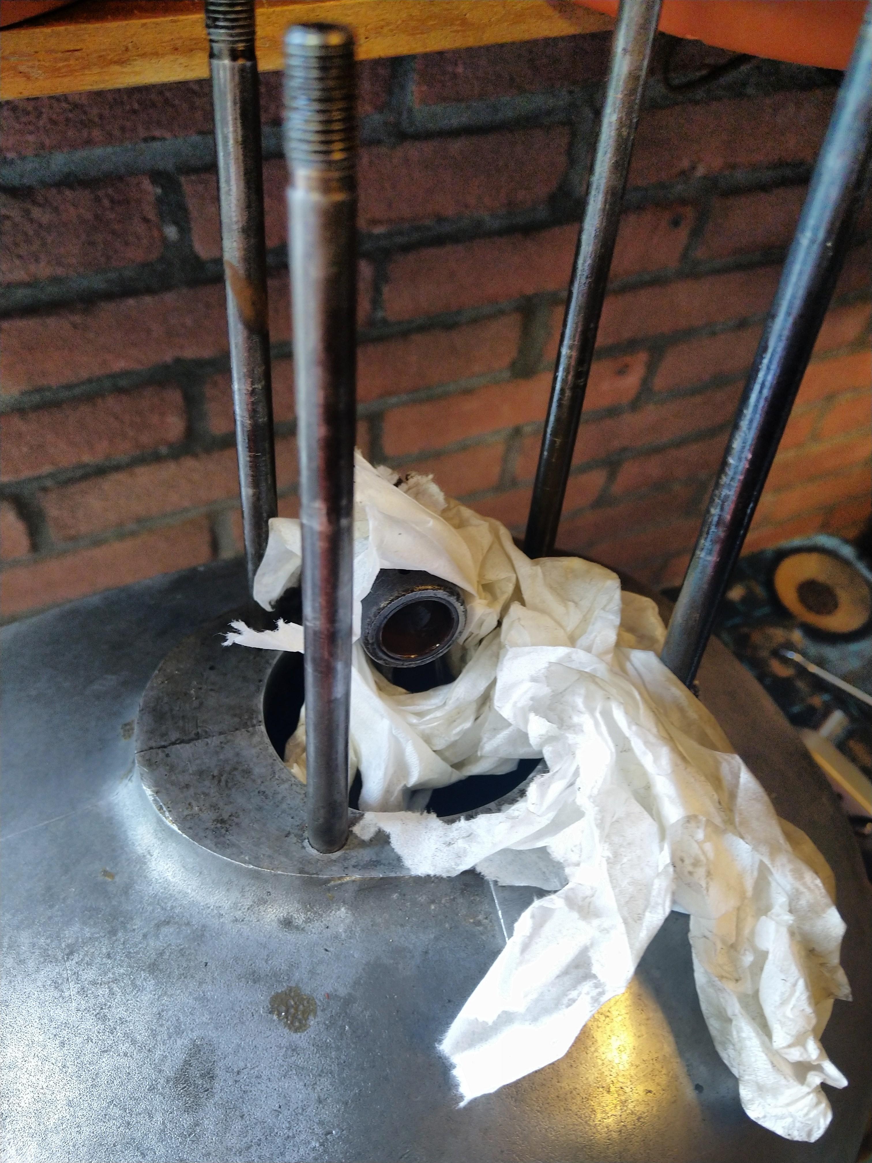

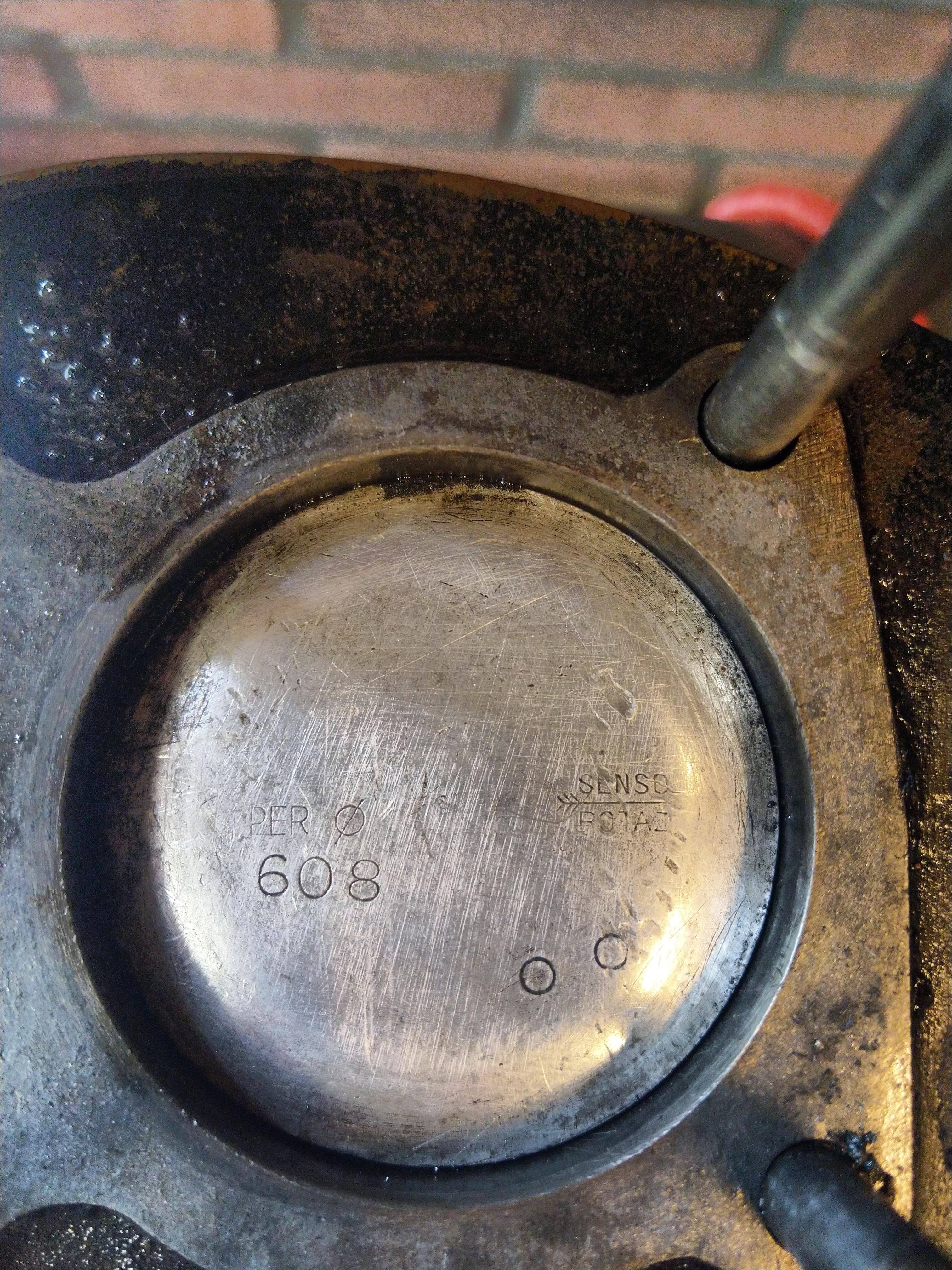

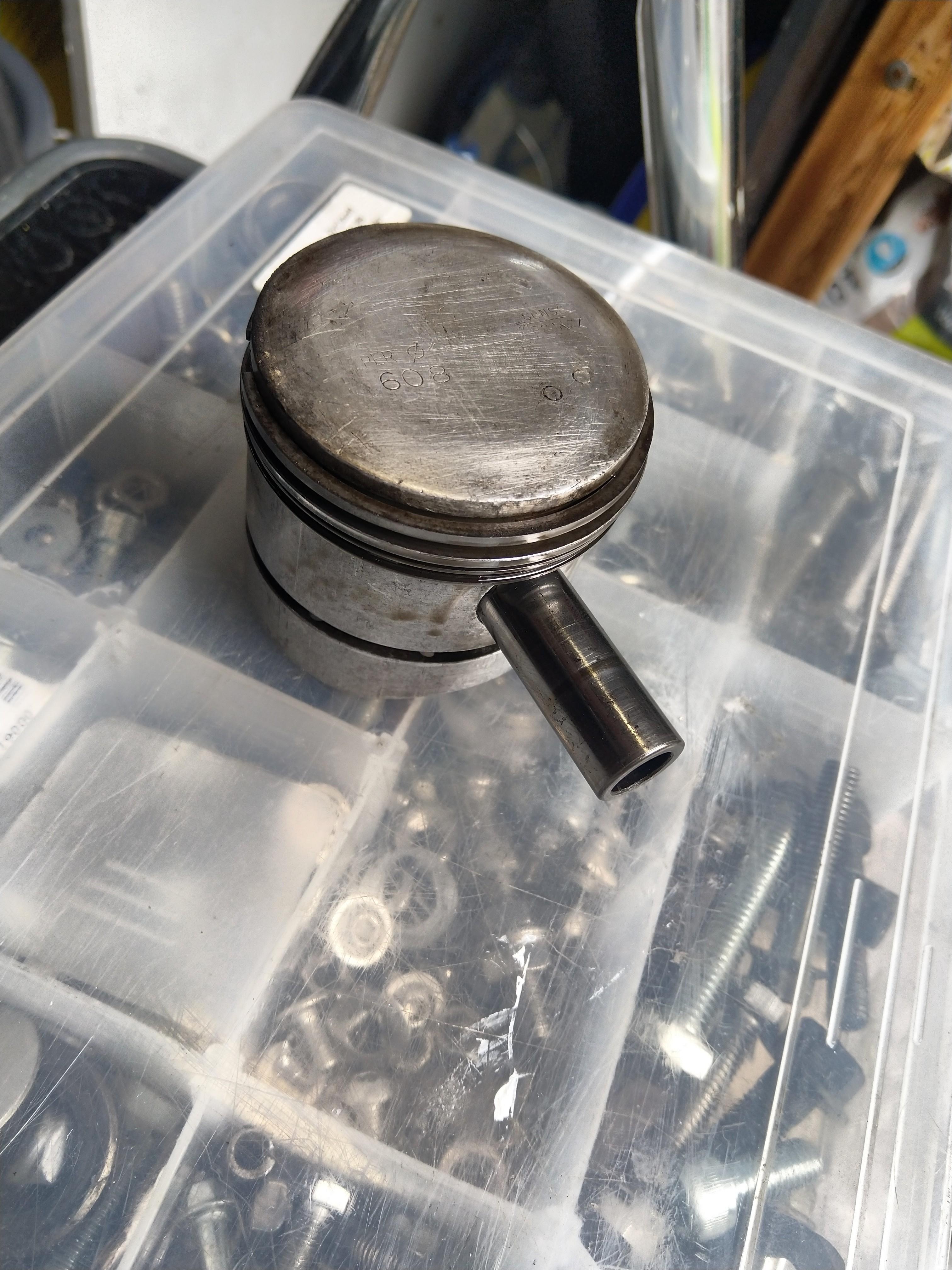

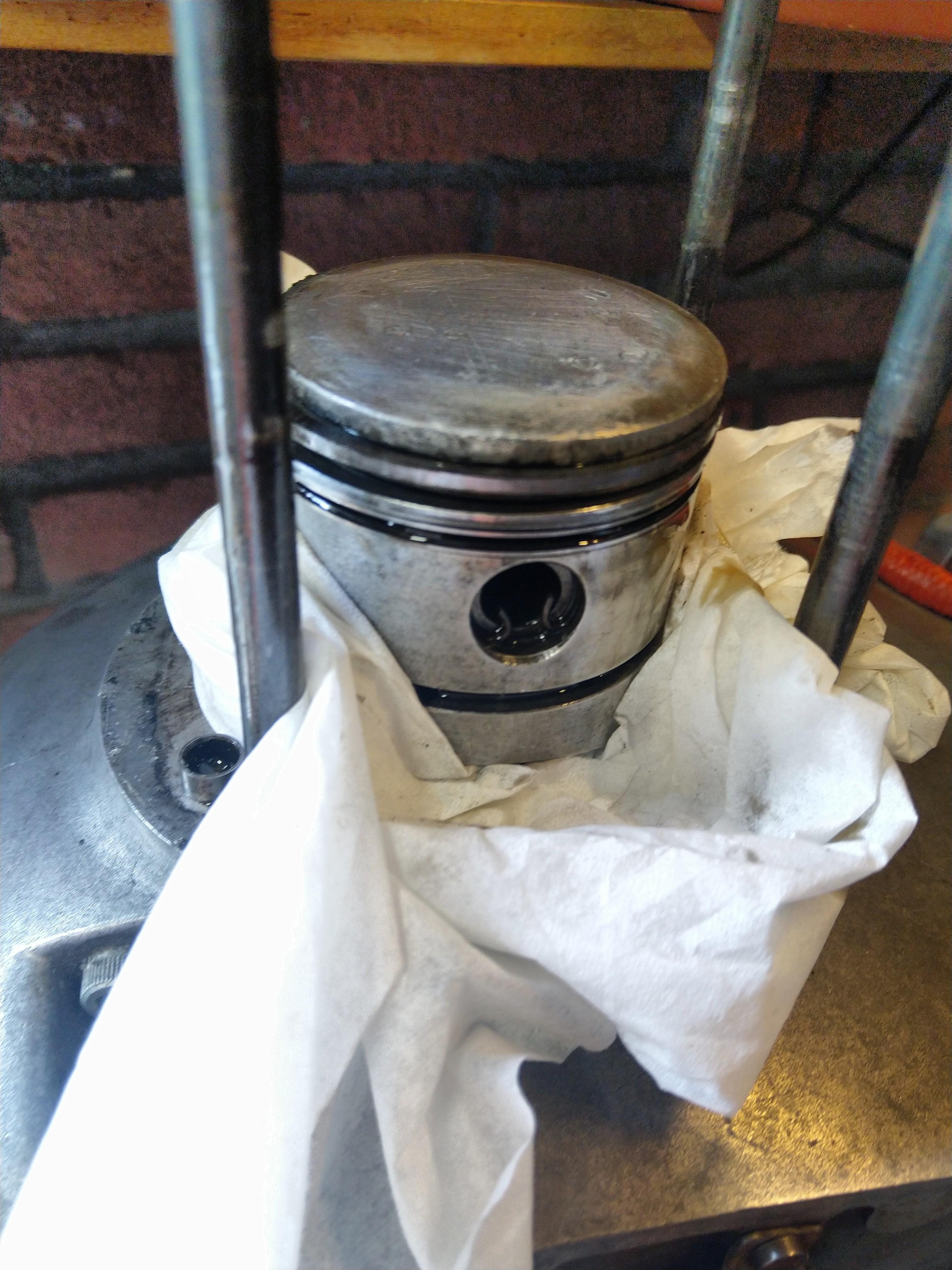

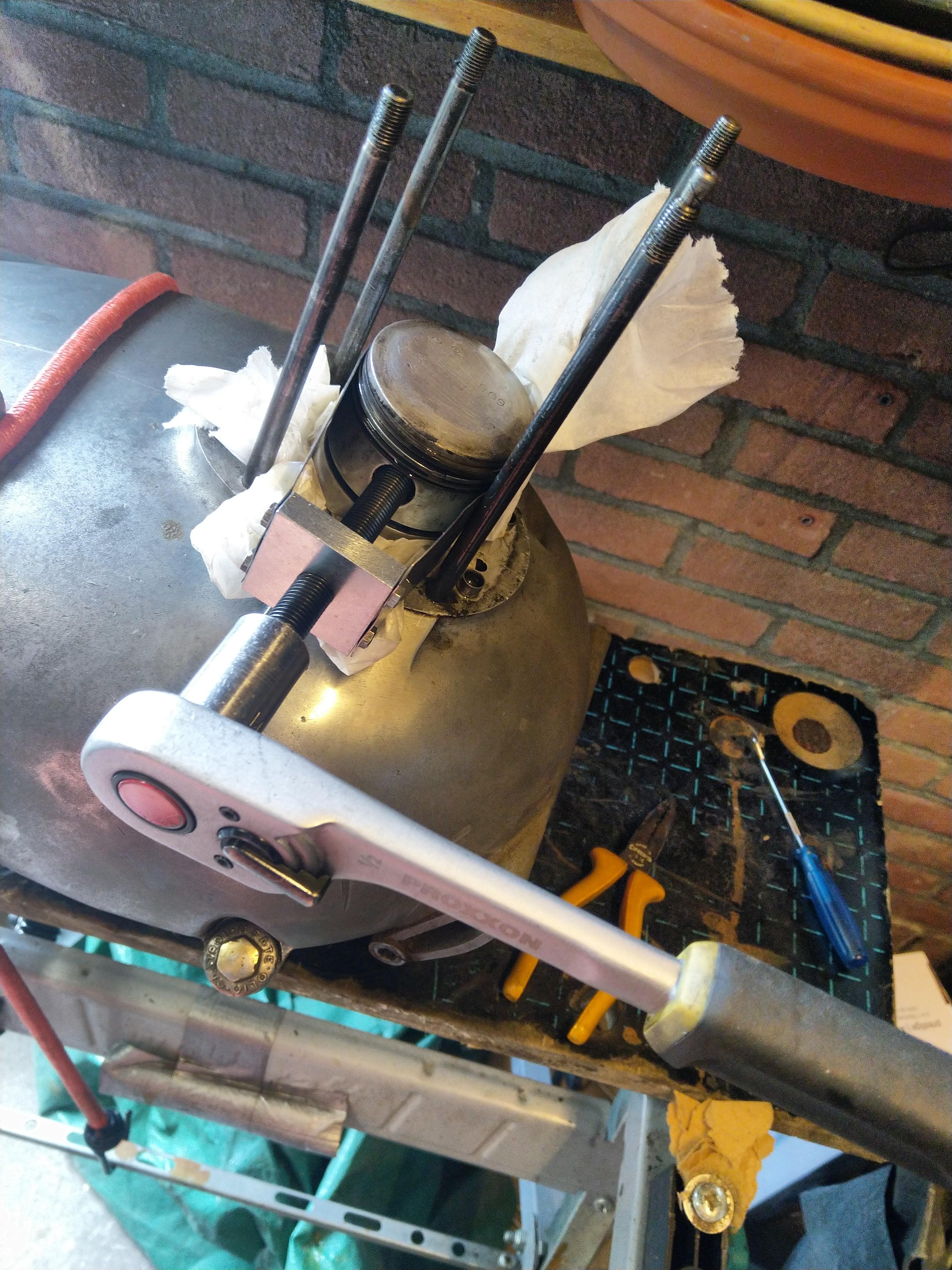

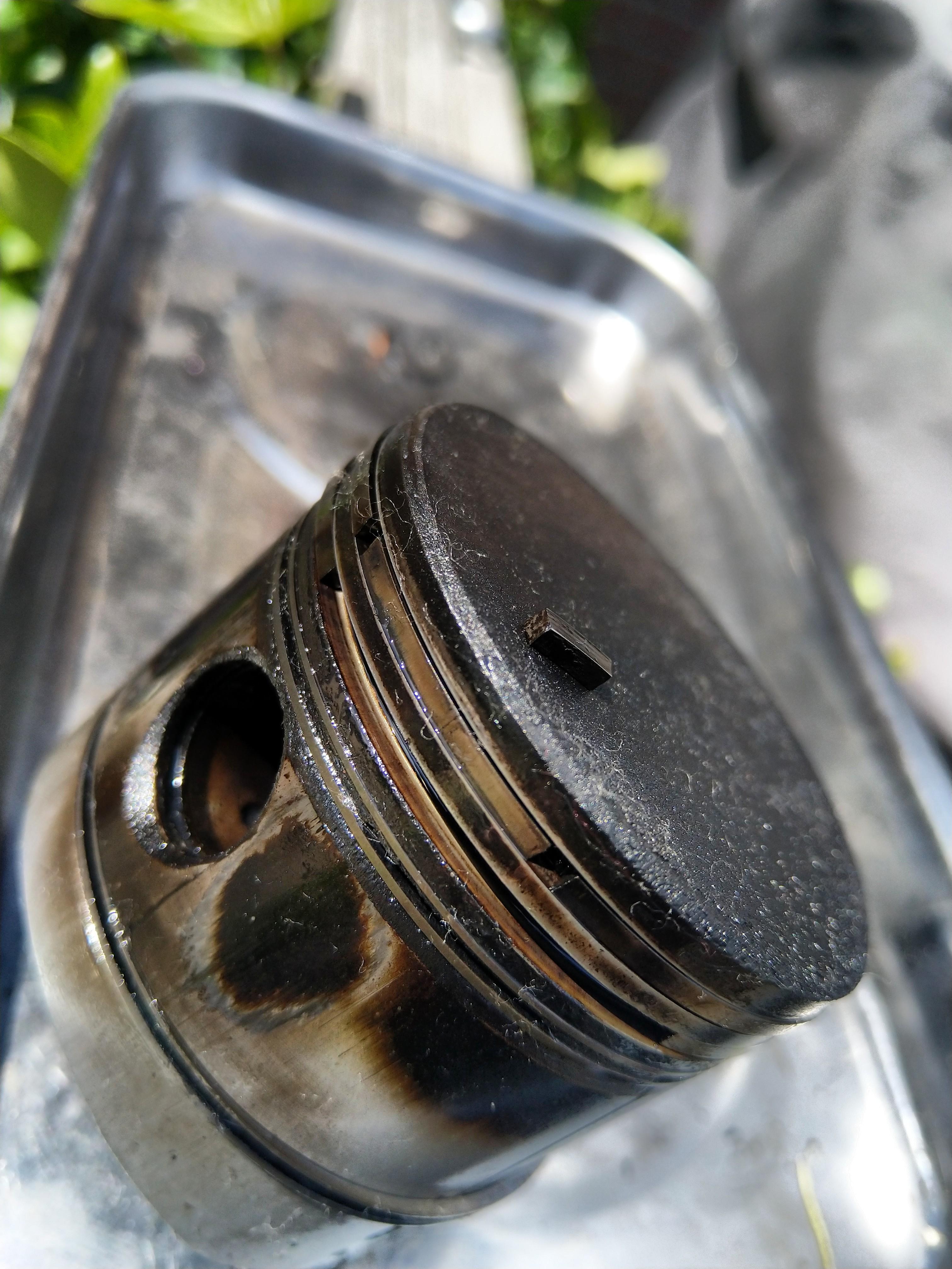

Today I removed a piston from a conrod for the very first time.  Painlessly :tongue:

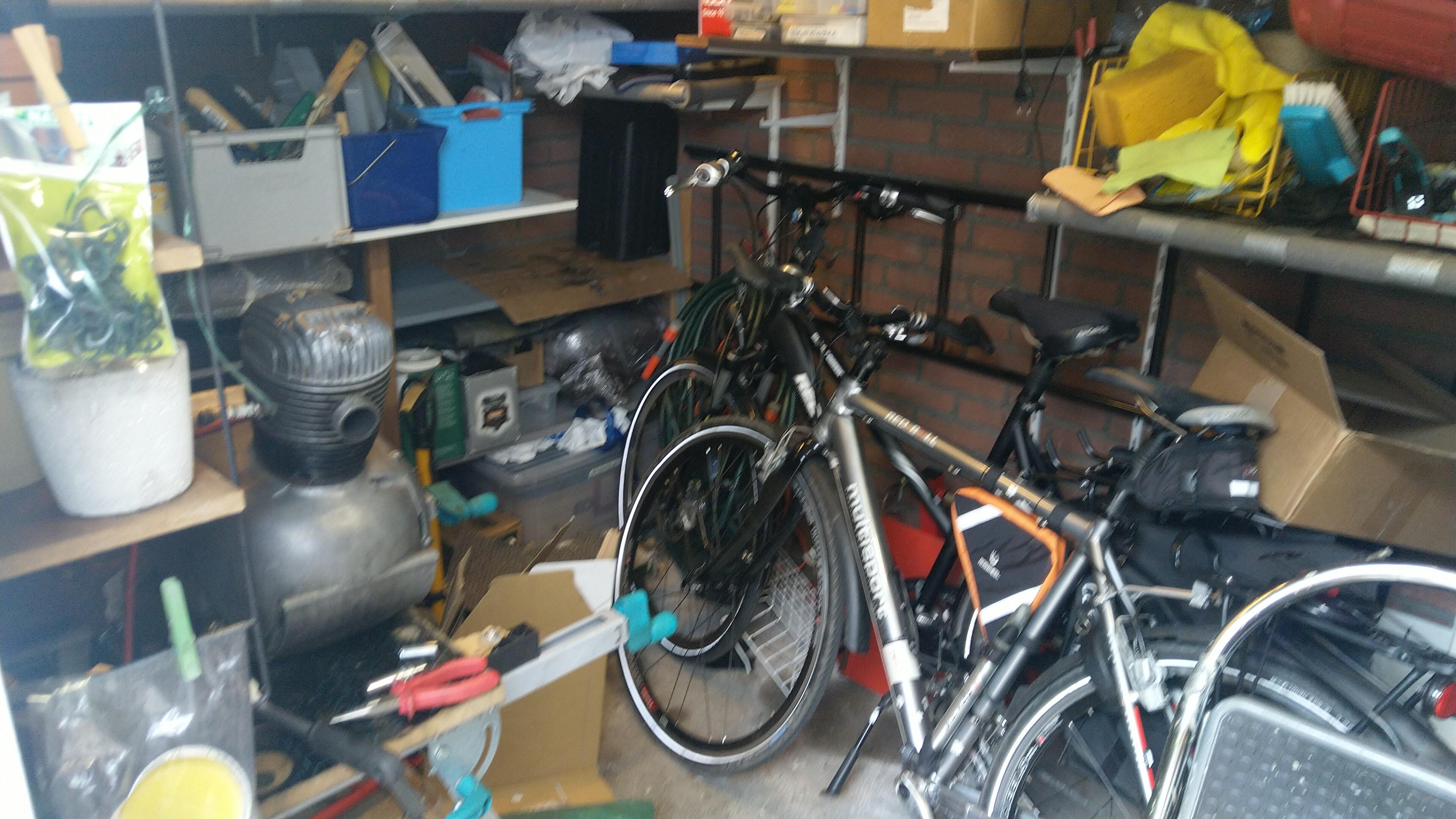

Raining today so the wee garden shed had to make do

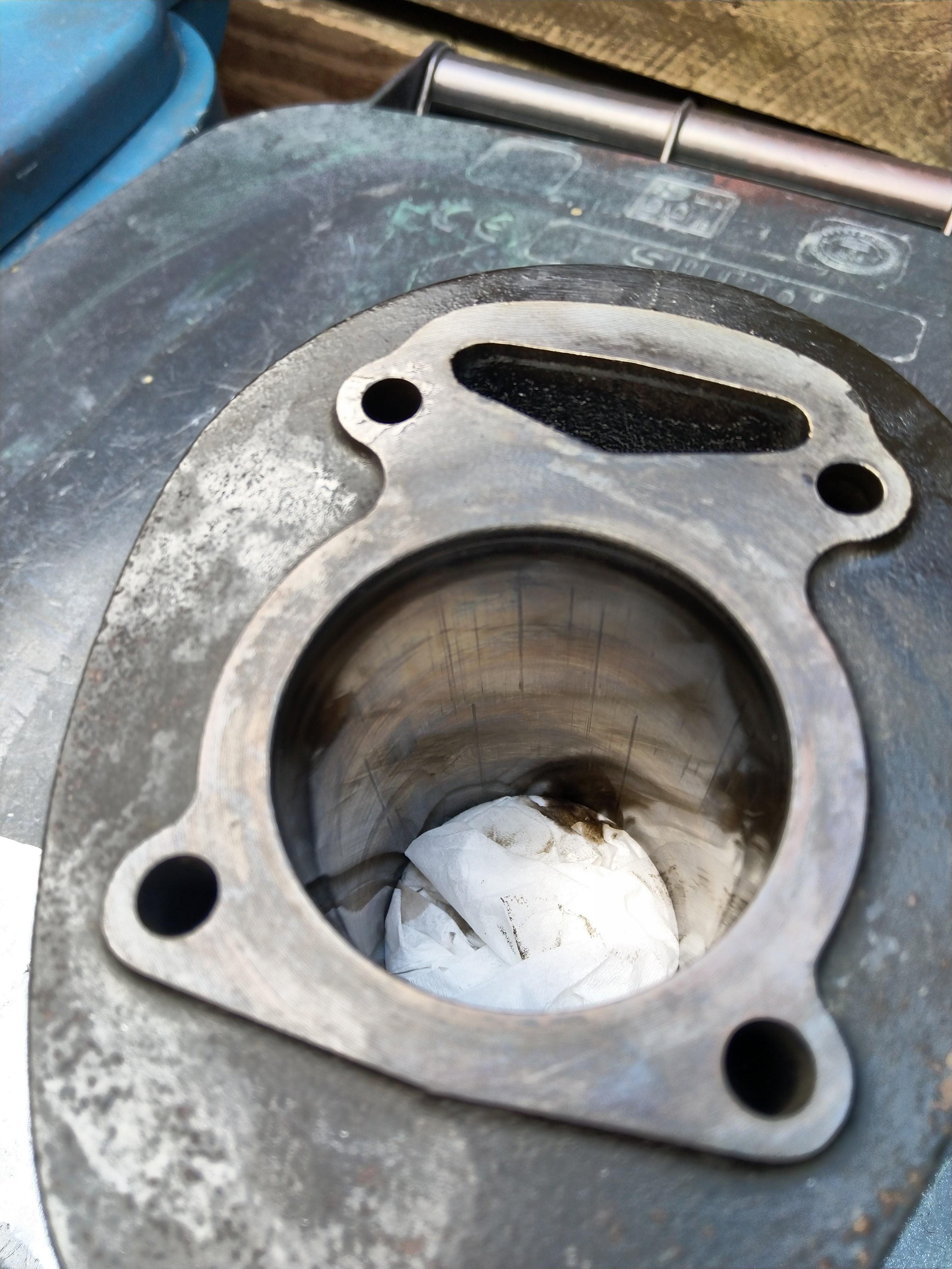

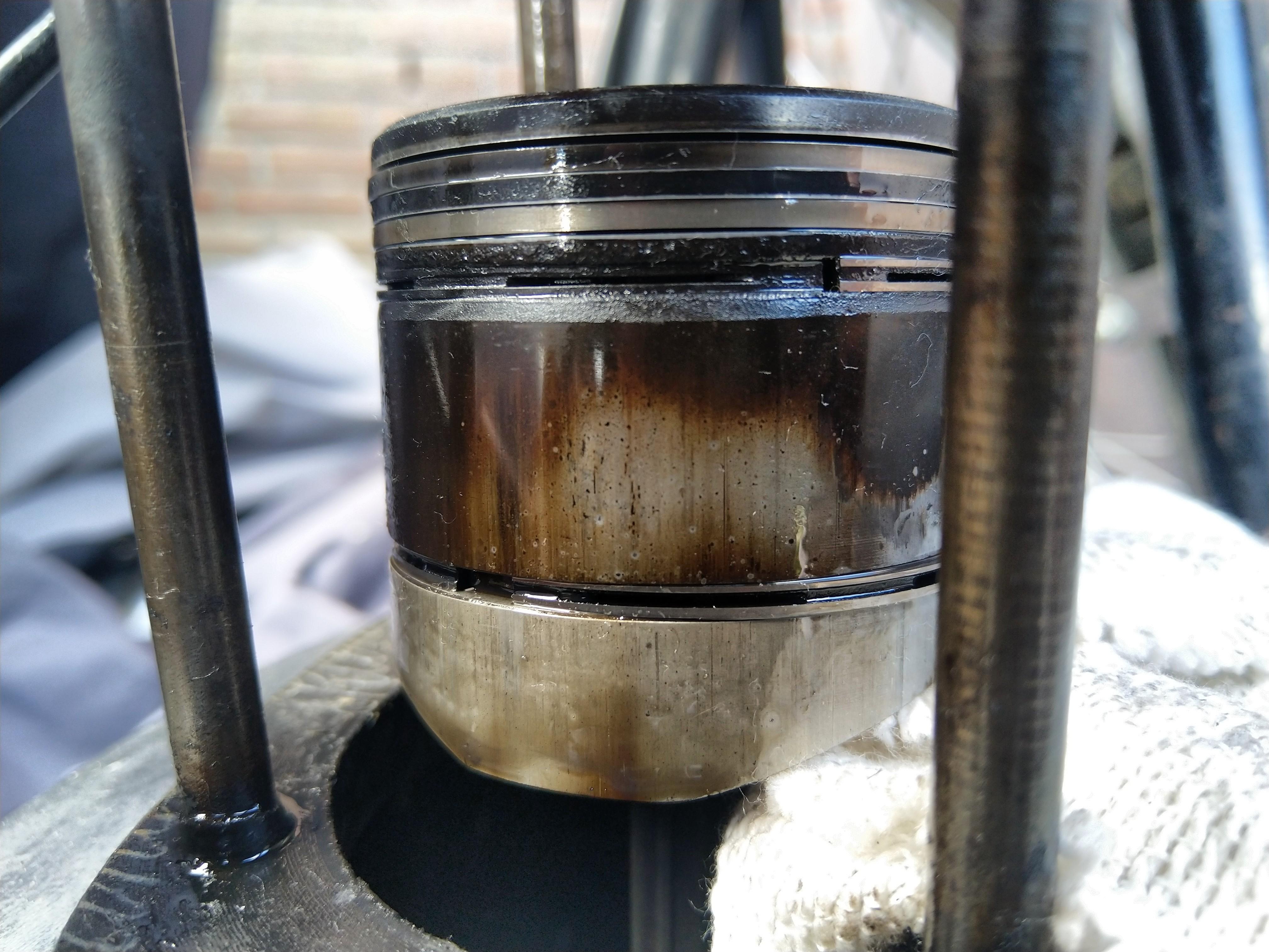

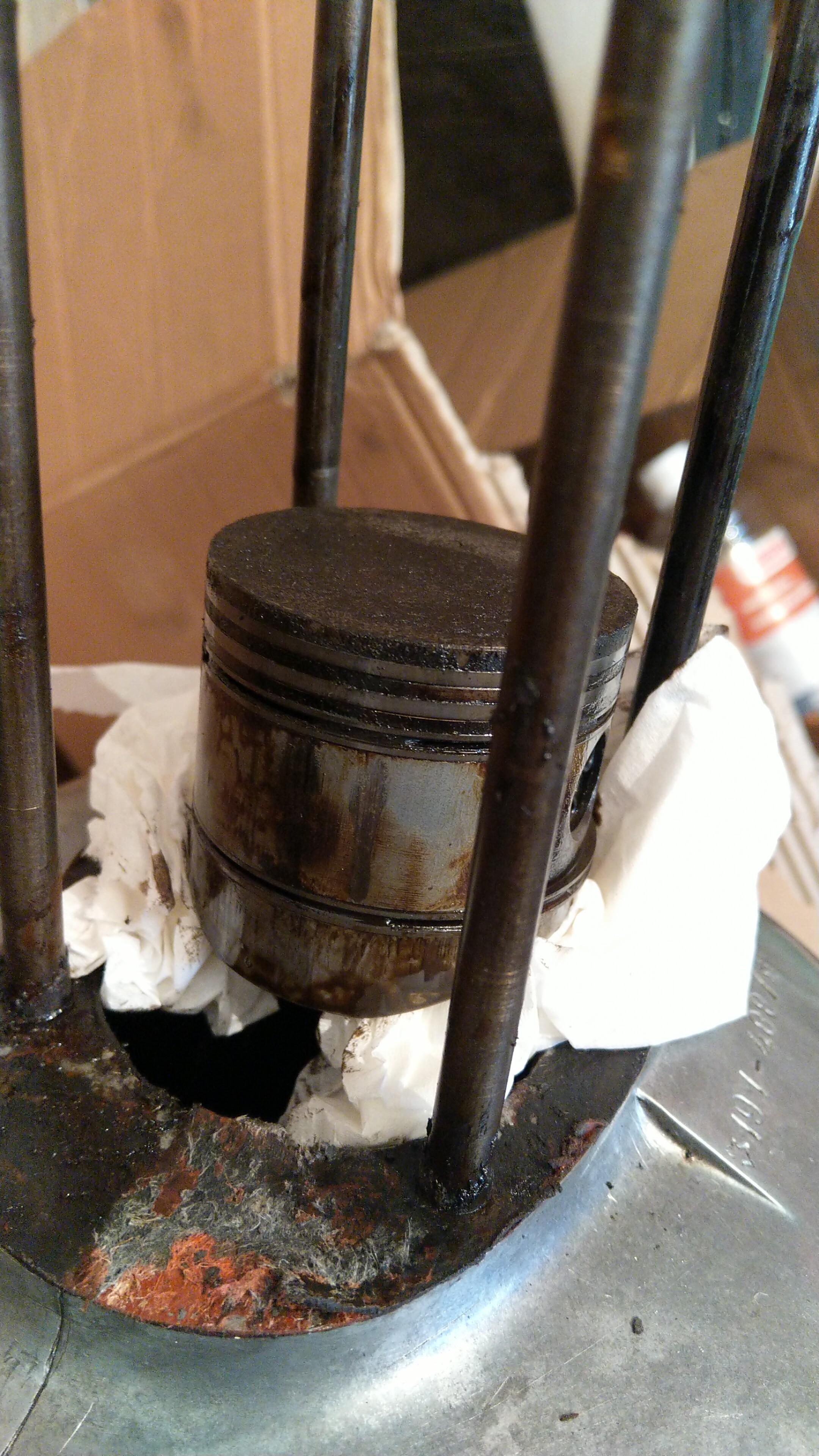

Testing the piston rings by pouring some petrol on the piston
No seepage and it cleaned up things nicely
To be continued

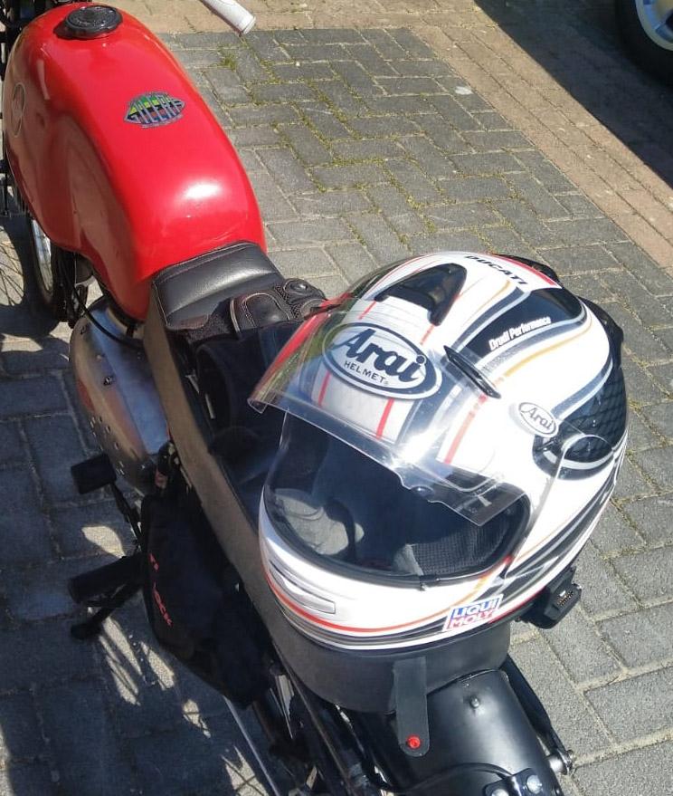

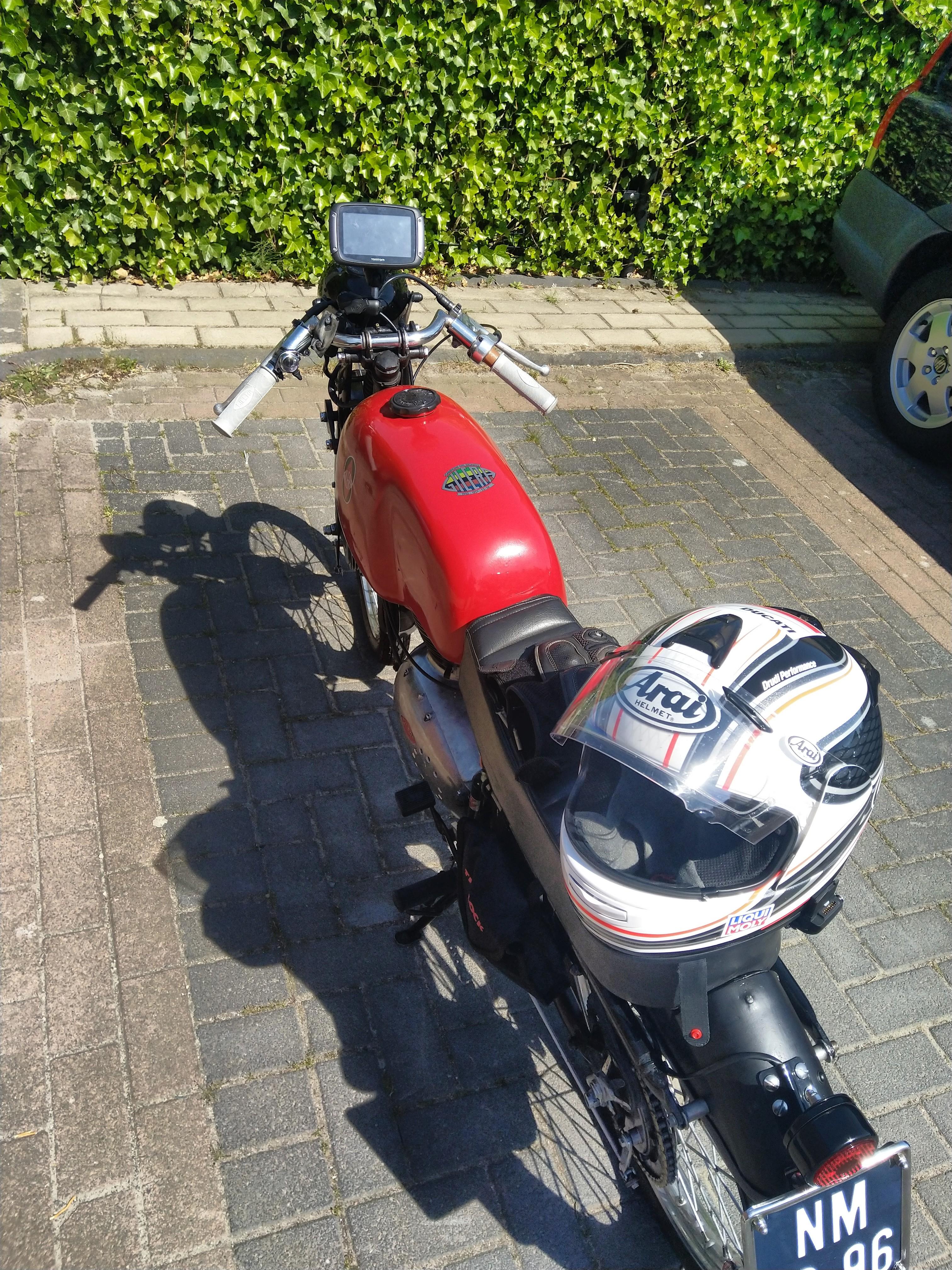

Helmet.....
 Which helmet to wear while riding the Gilera?
The Mamola replica?
Nah...  Too modern...
Which definately rules out
"The answer's easy if you take it logically..."
@Muff
6 hours ago, Dutchy said:
Helmet.....
The helmet is the right image but it's a nice face. And all those teeth. Are you sure about that choice?

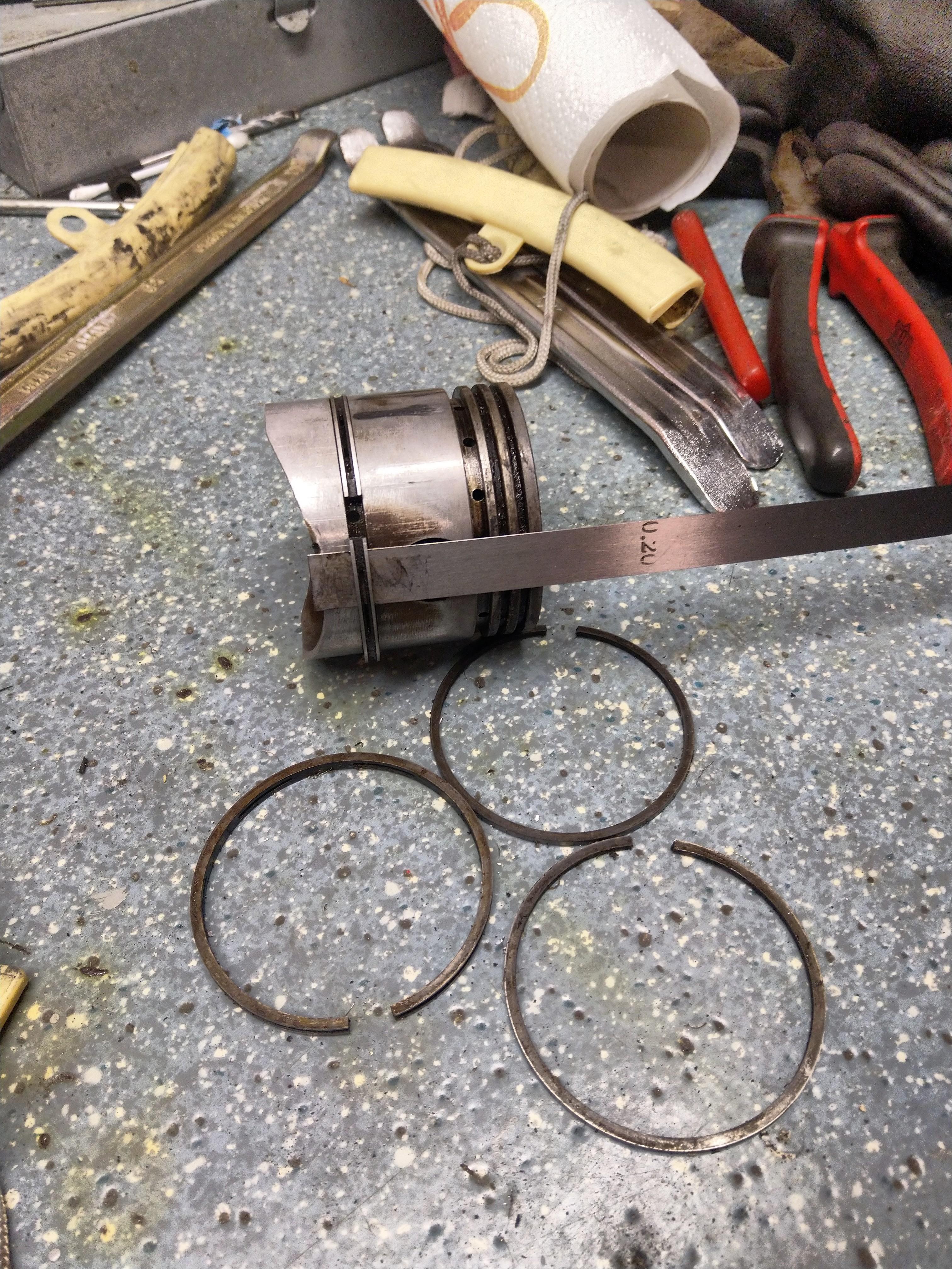

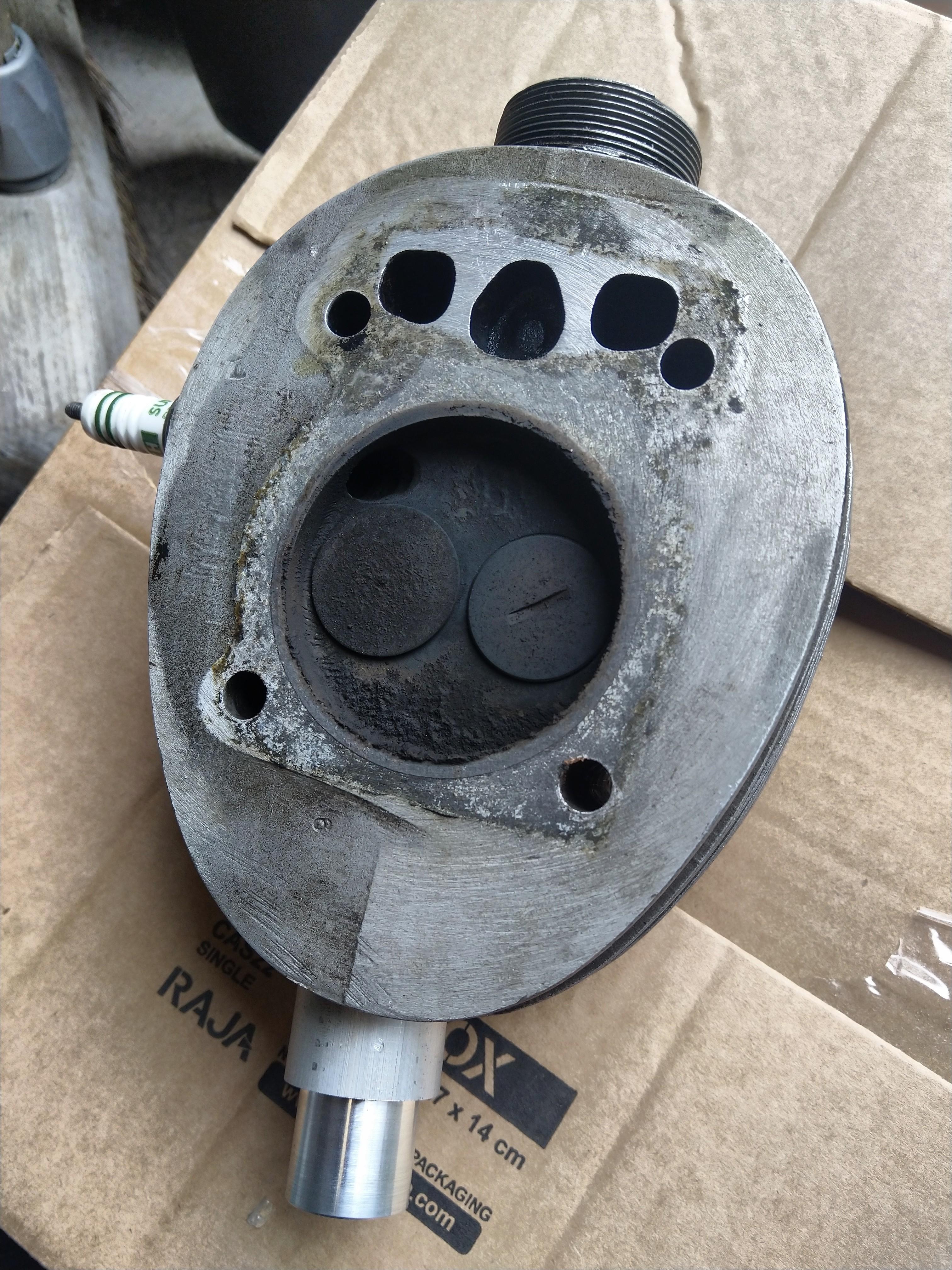

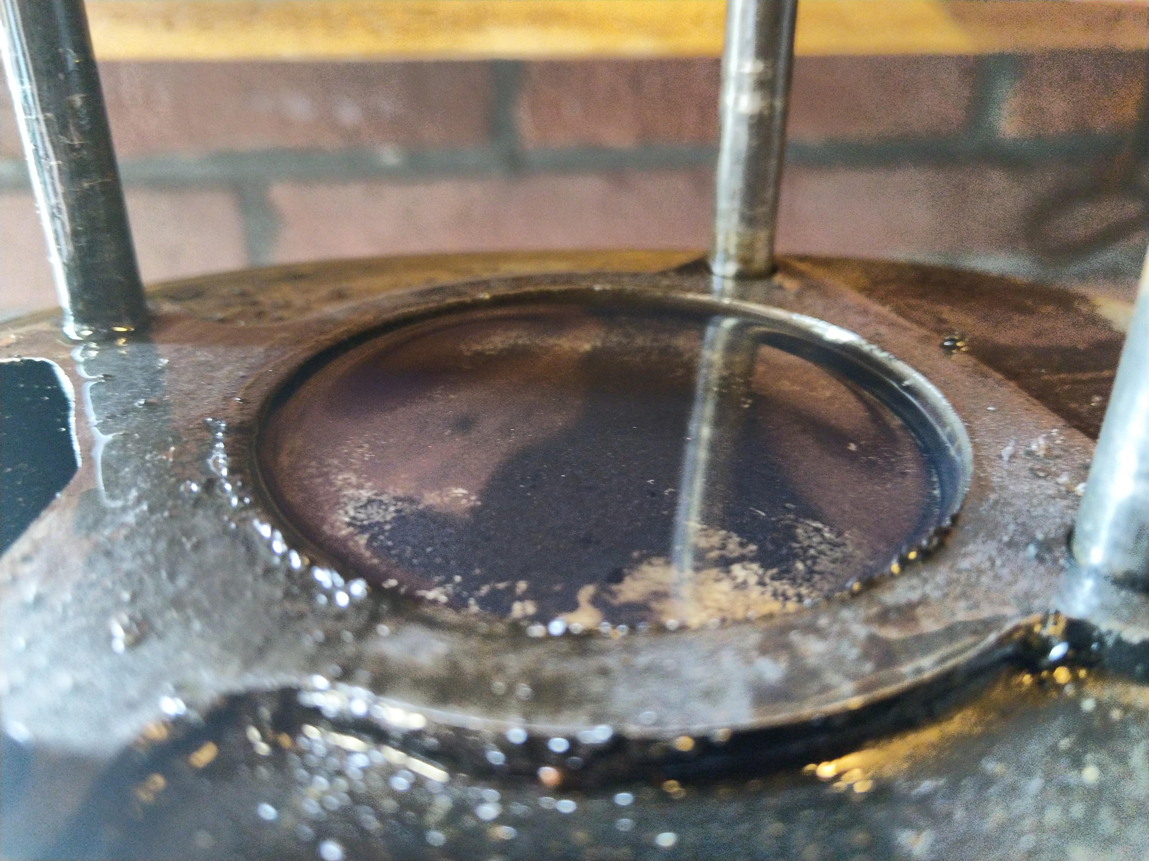

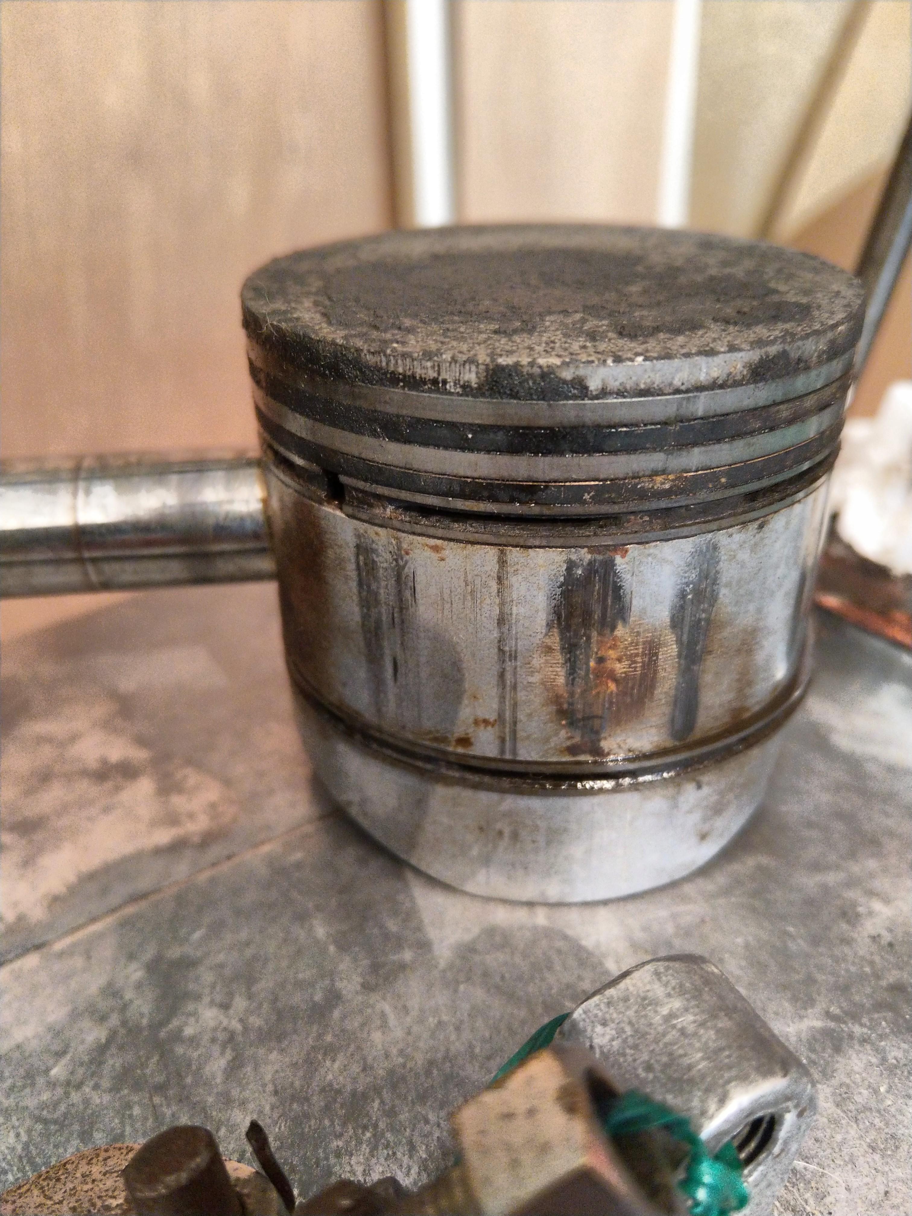

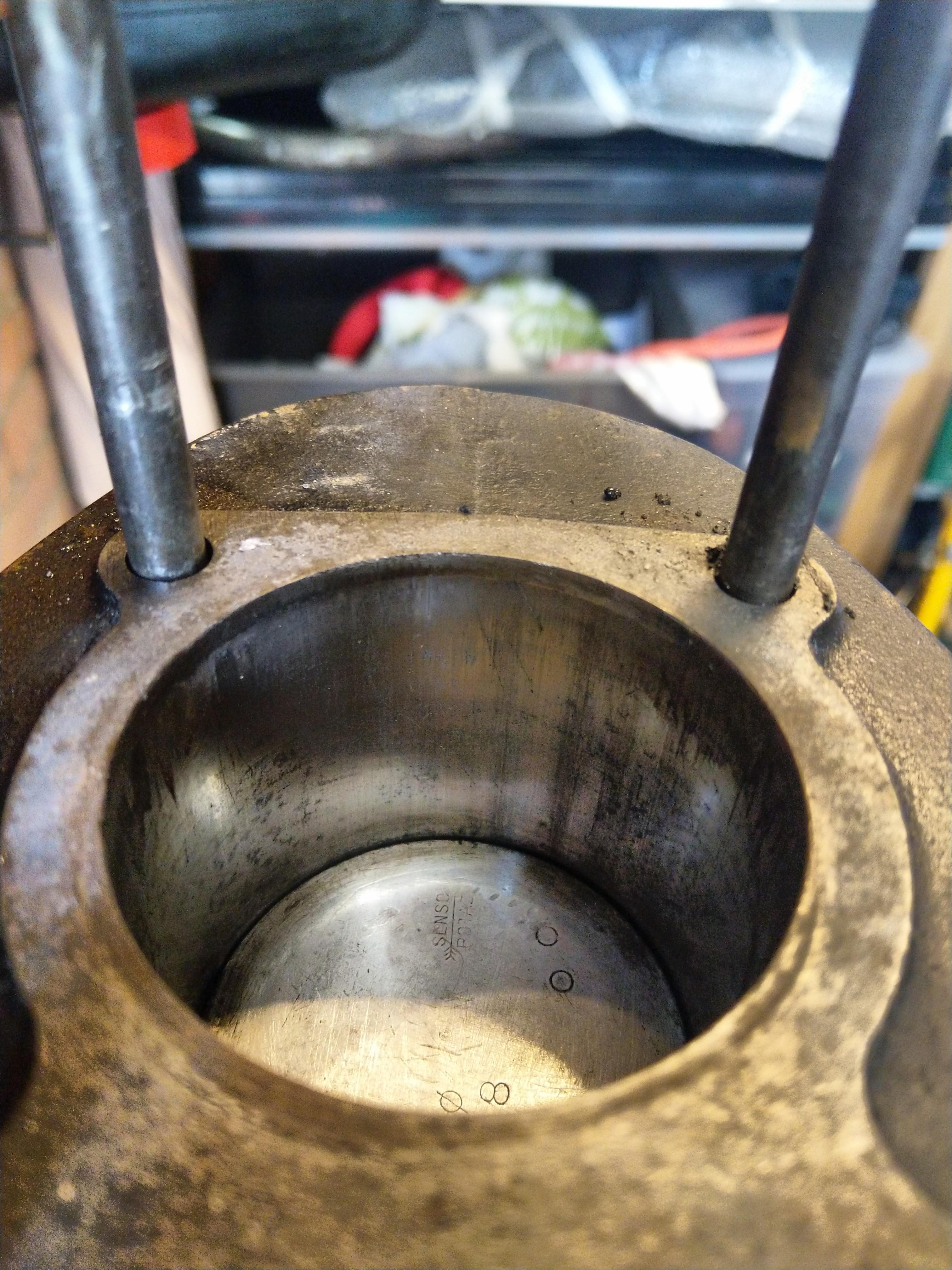

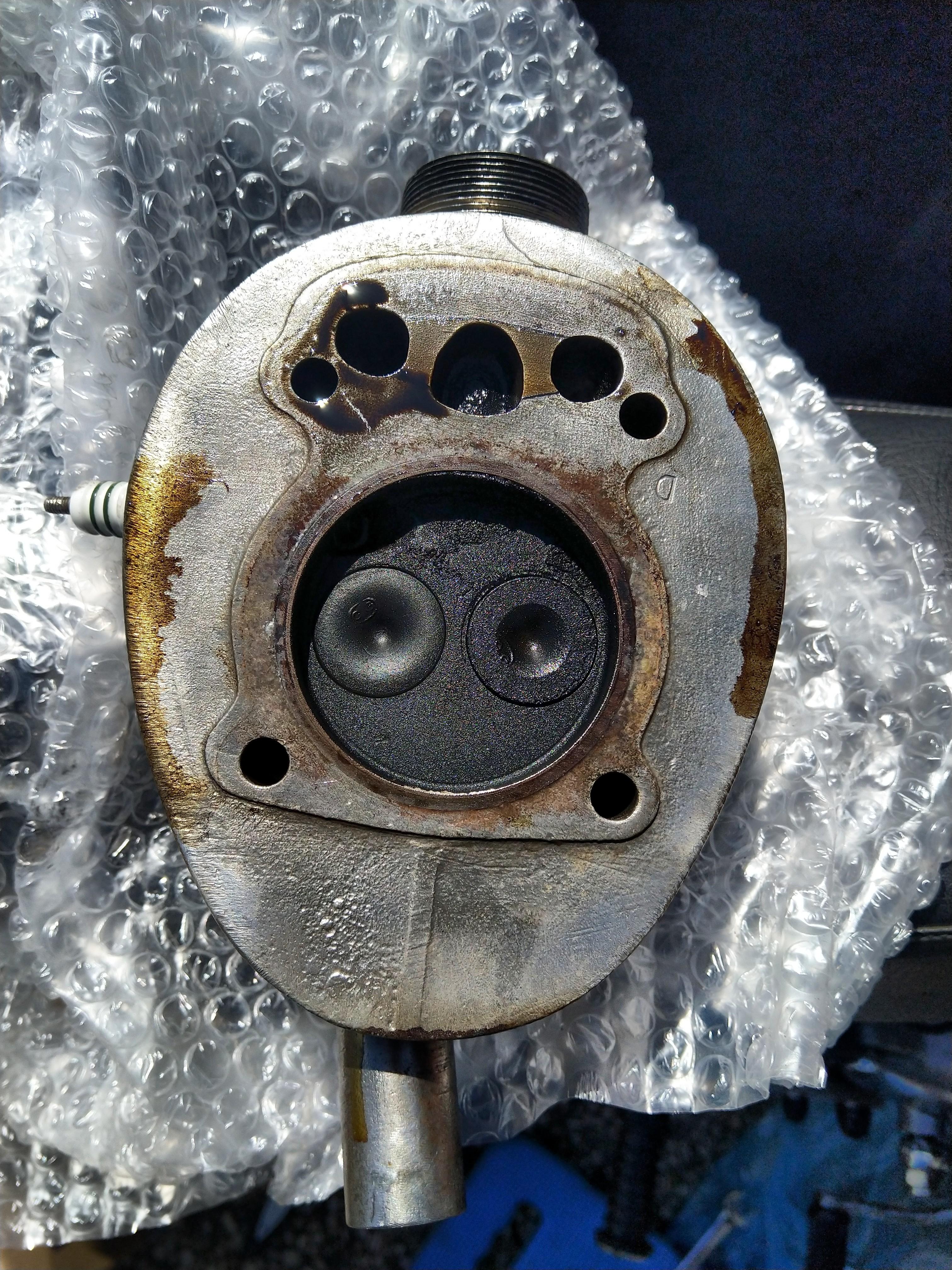

Practise makes perfect, so today I took the head of the oil burning/excess oil pressure engine.
Full Metal Jacket, euh Gasket...
"Oh....."
1 piston ring broken, other misses a whole section 🤢
So I will go fishing for metal bits with a magnet inside the carter 😉

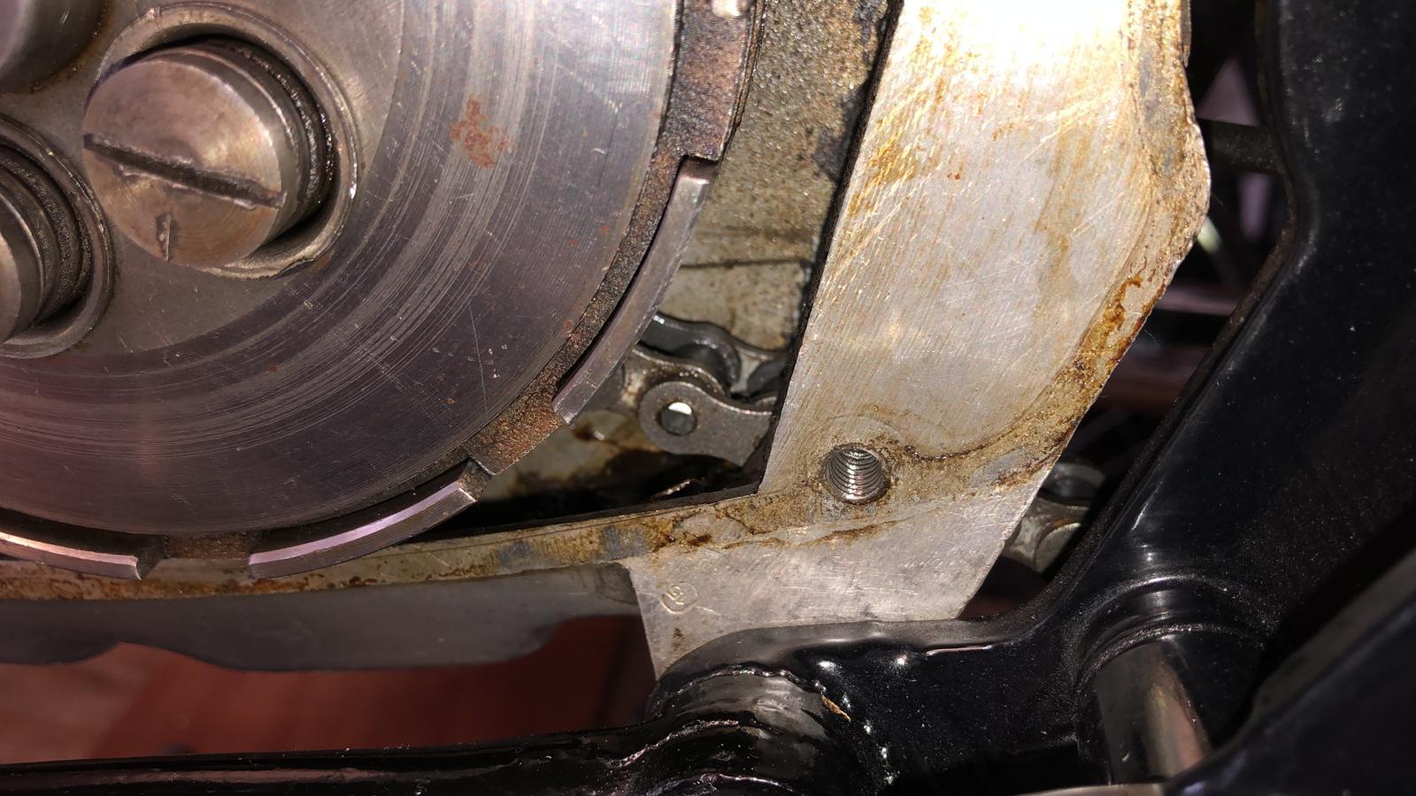

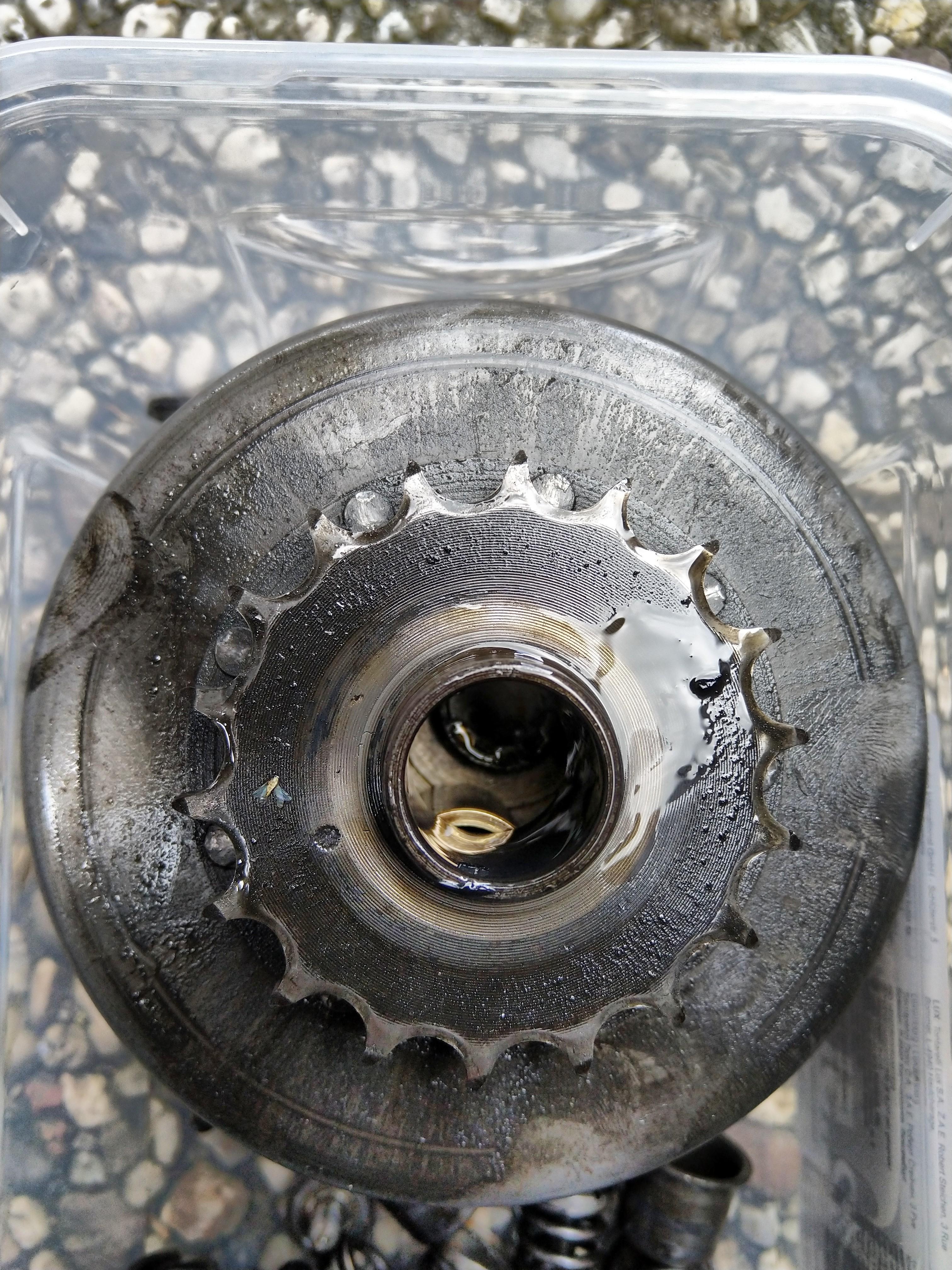

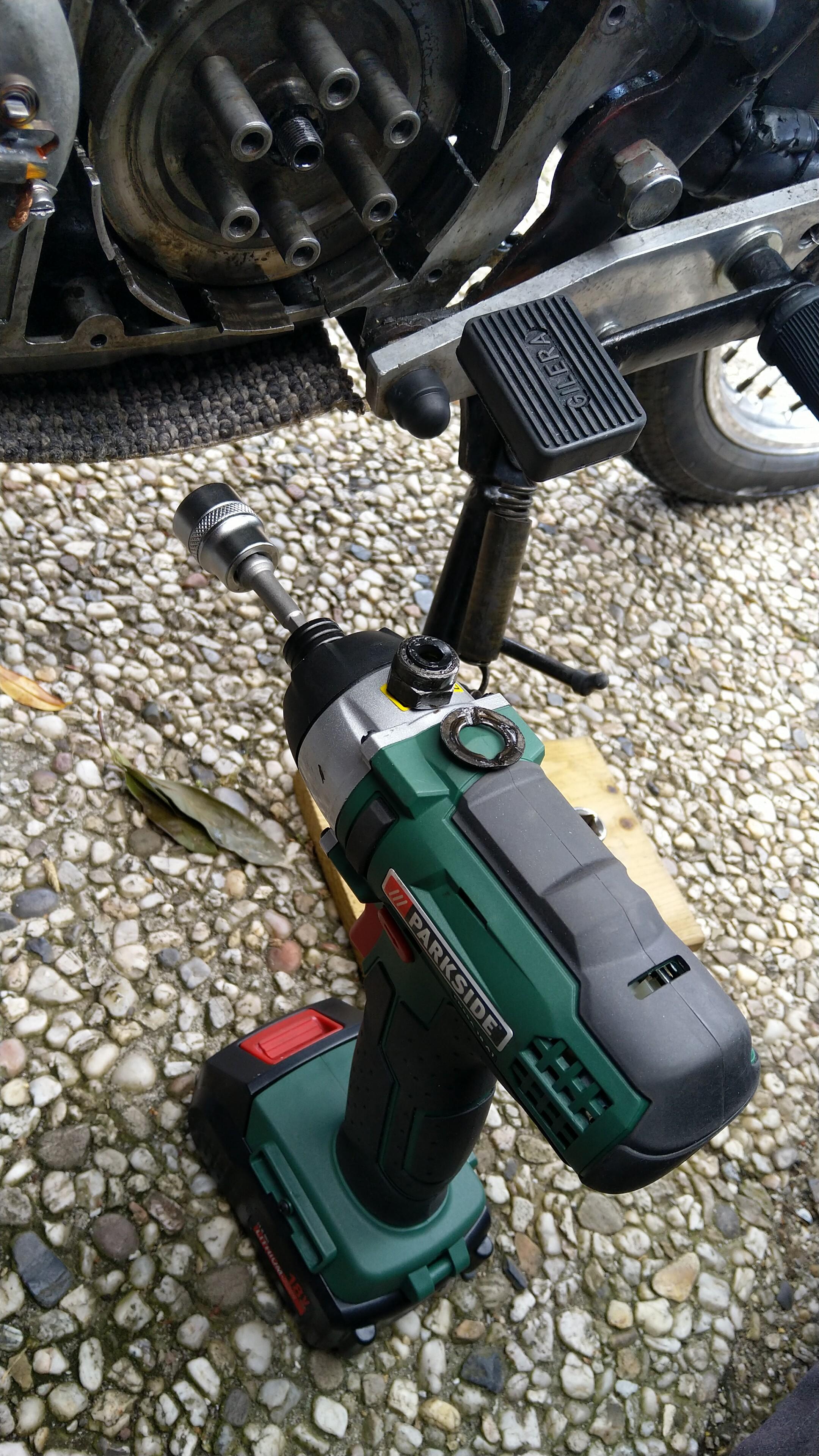

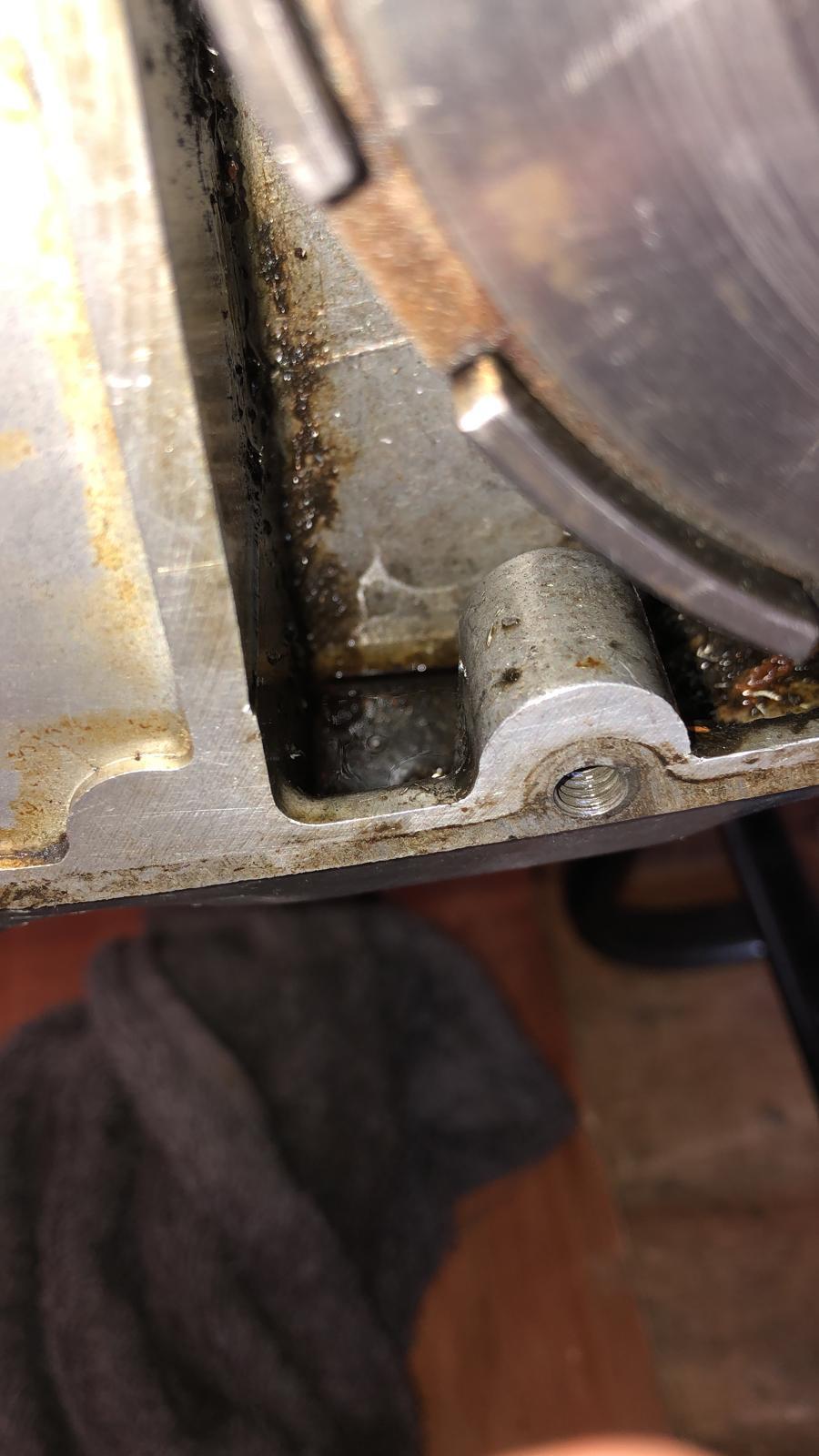

Removed clutch basket to reveal farked seal
I have a new seal in the shed.
Front sprocket is rivetted solid to the clutch basket, so you use it all....

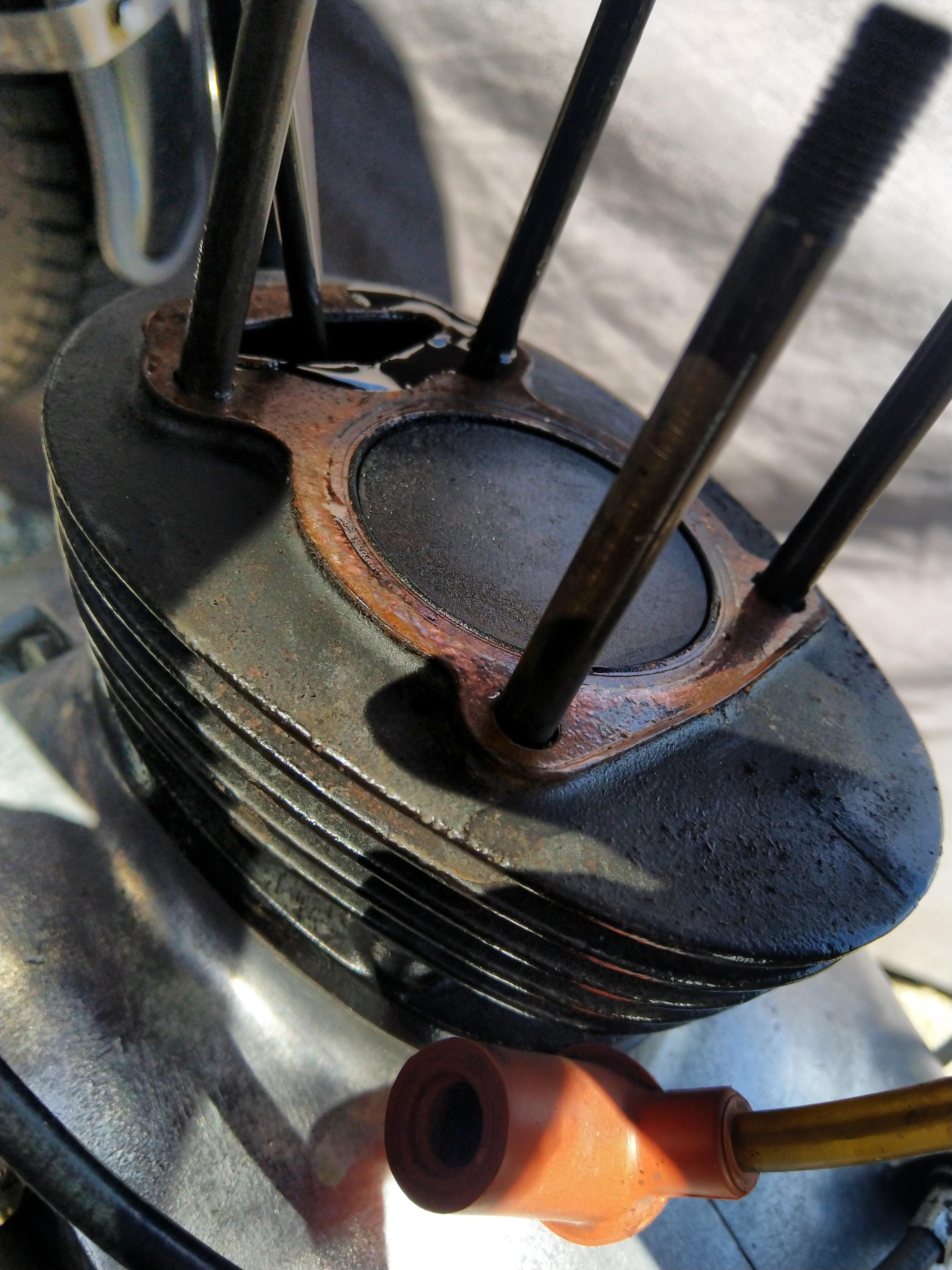

Numbah 3!!!!!
IMG_20200607_121128_DRO.thumb.jpg.1a16eba985c1e410eca60e3e98ec05a8.jpgIMG-20200607-WA0004.thumb.jpeg.dd5168ce993f6284f25e9339f91064b8.jpeg
needs  a welder too....

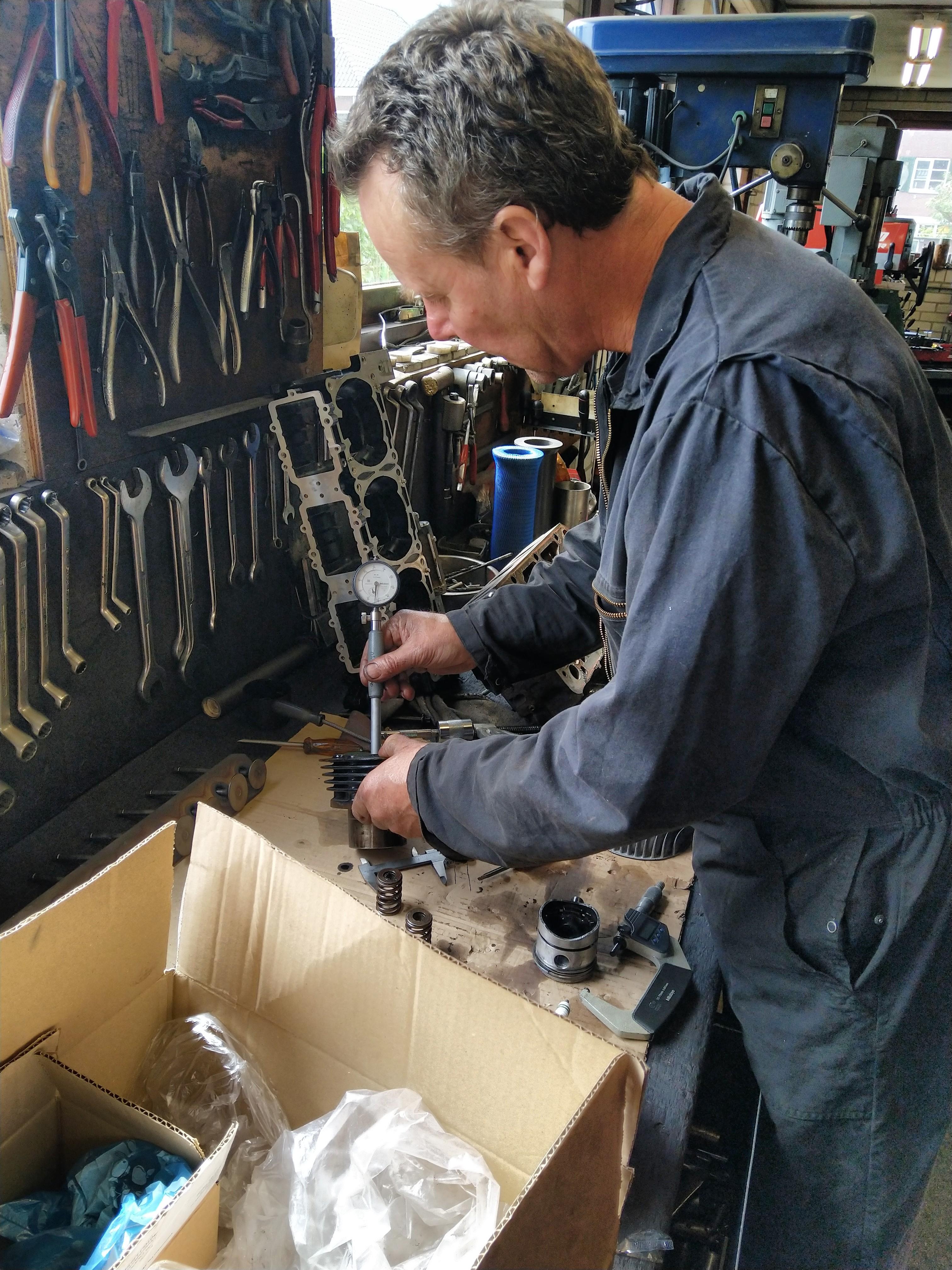

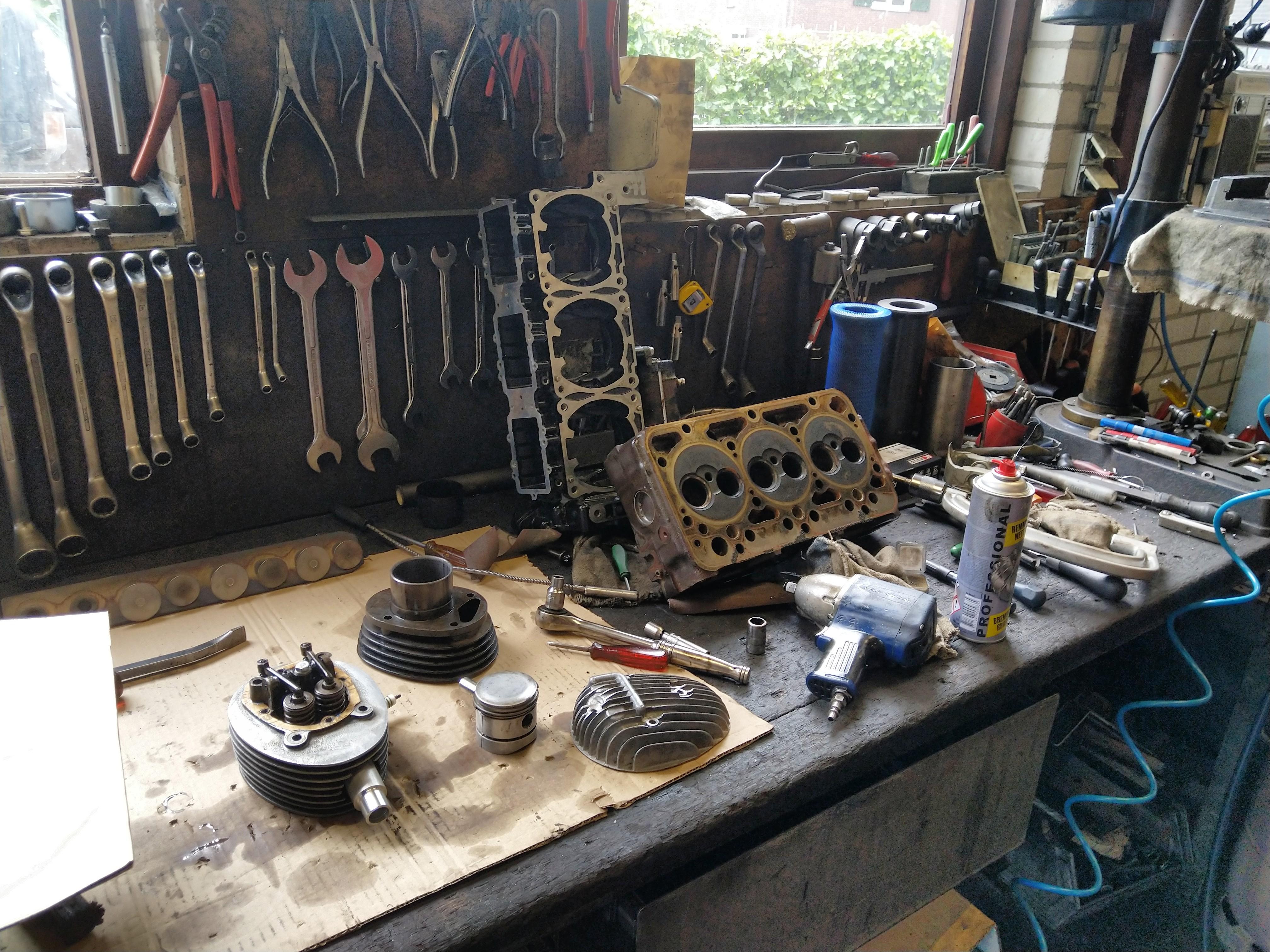

Took the 3 heads to a specialist.
He refurbishes all kinds
The verdict on mine?
The bad and the ugly go in storage "for later use"
The good one only needs honing the cilinder and new piston seals.
I removed the stuck ones
The head joined the WIP queue; ETA 2 weeks 🤞
