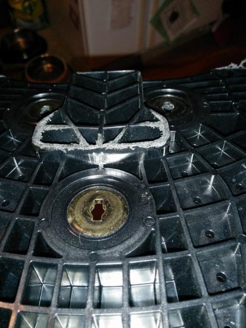

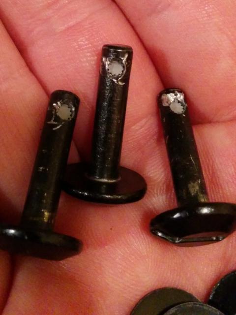

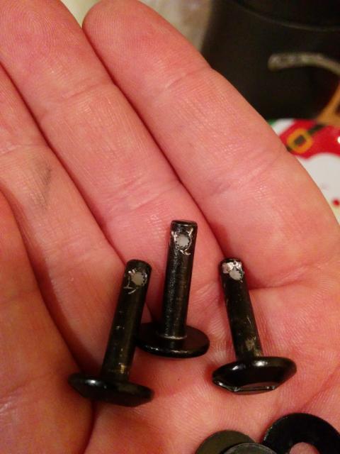

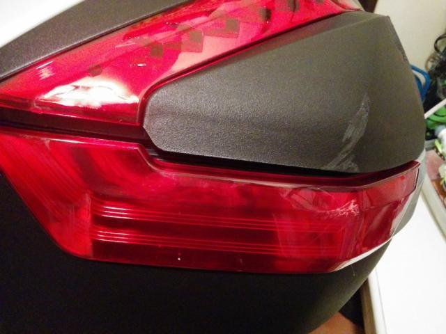

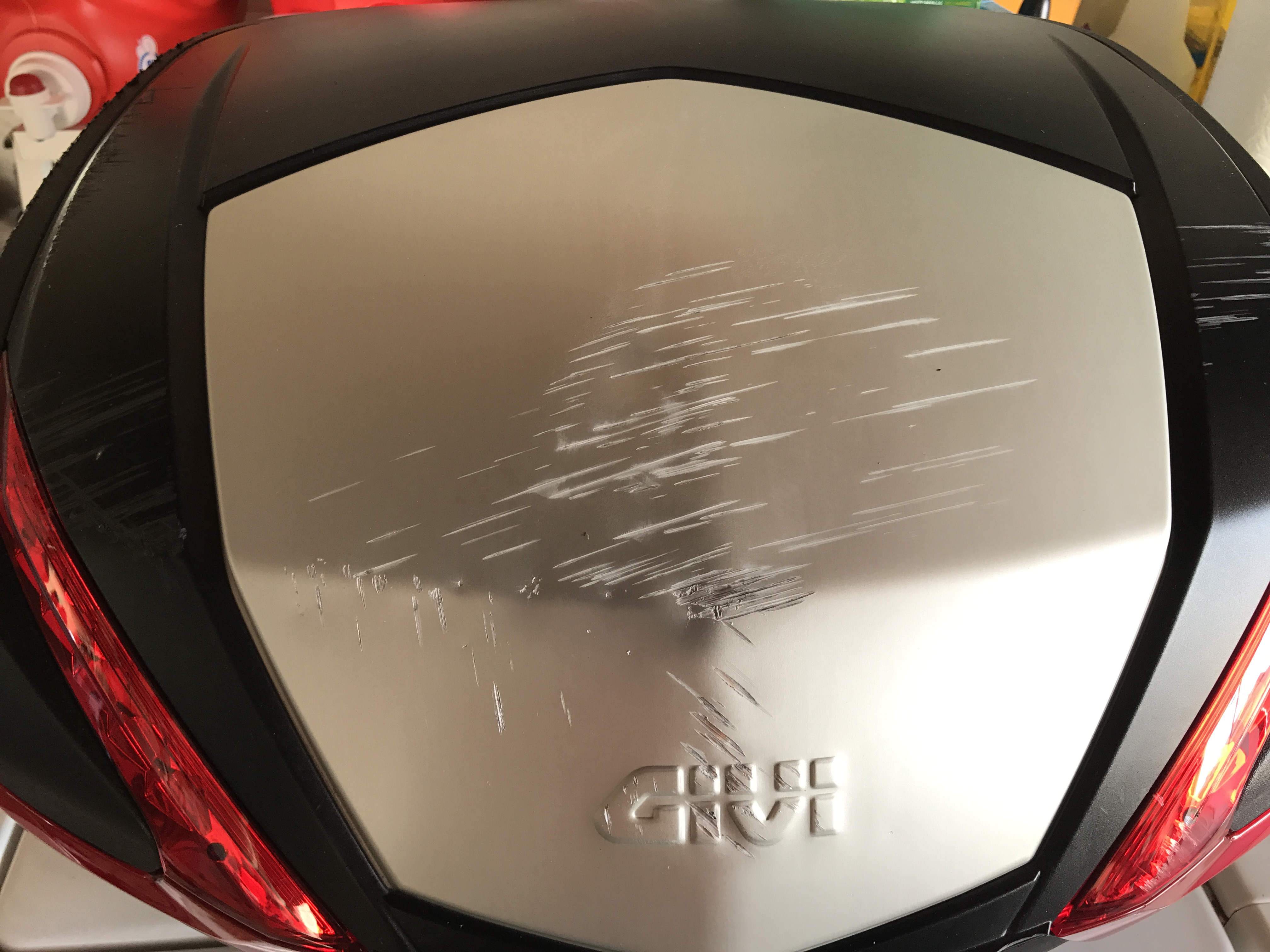

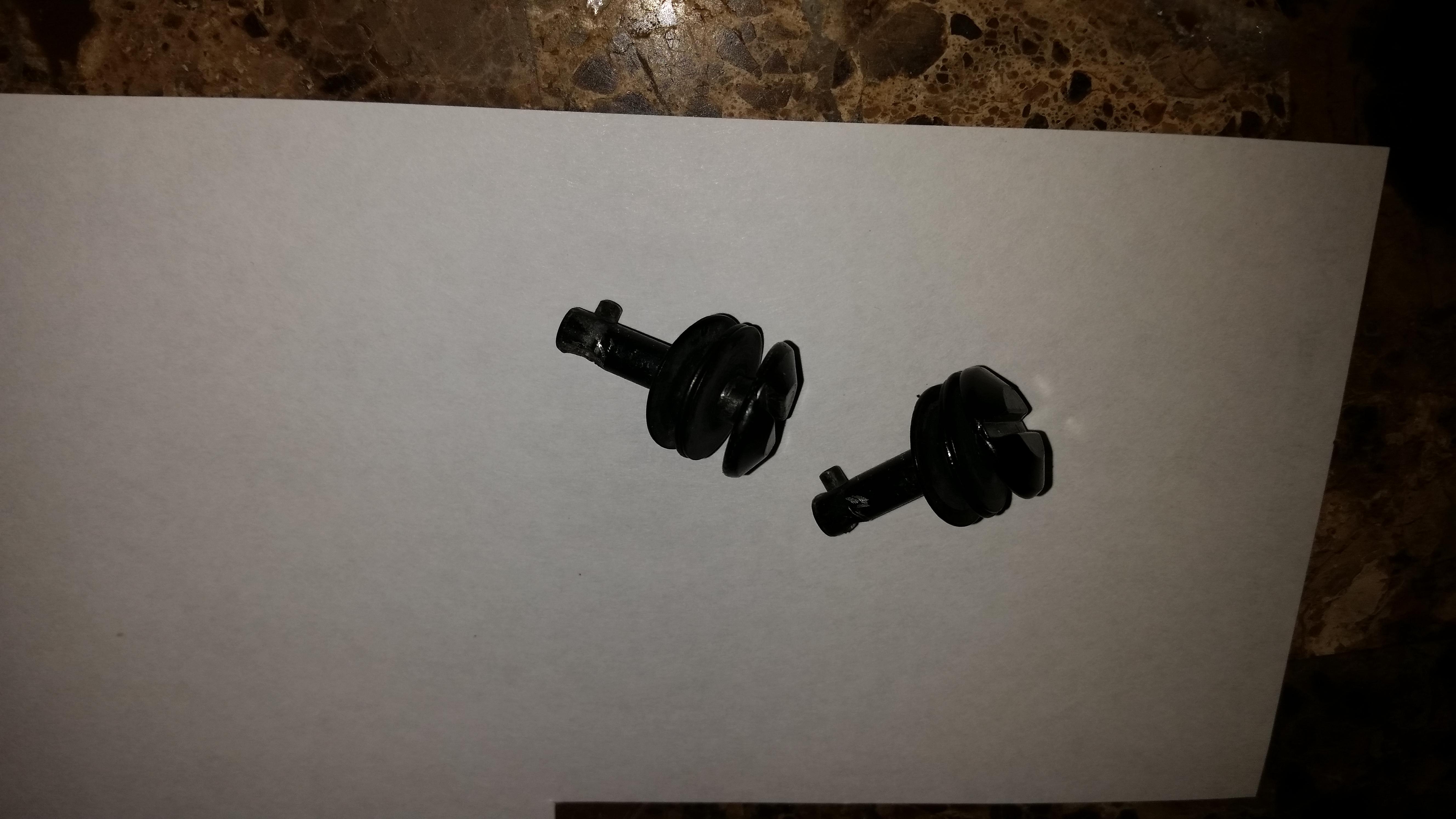

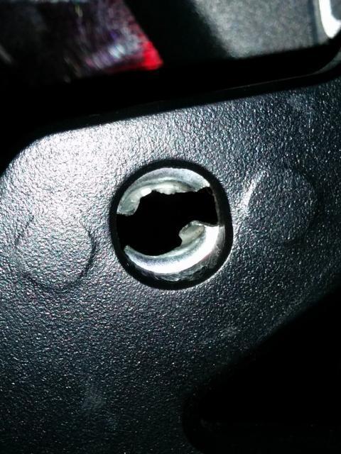

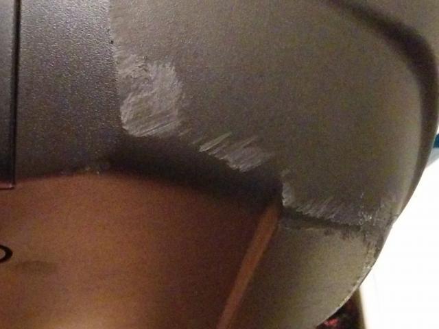

marriedman Posted June 4, 2015 Posted June 4, 2015 Just wanted put this out there, if you have the PT.00.152.405 SW-MOTECH Alu-Rack Topcase Adapter Plate (GIVI / Kappa Monokey) make sure and check the quarter turn bolts. Tonight I hit a bump on the expressway and all three sheared of cleanly. Luckliy my Givi V47 was still there when I drove back in the car. When I unlocked the plate from the now destroyed topcase, these three bolts fell out: If you are familar with this mounting system, you would know that there are supposed to be rods that run through the bolts perpindicular to the shank. Quote

Member Contributer MaxSwell Posted June 4, 2015 Member Contributer Posted June 4, 2015 Thanks for the heads up. I believe the holes at the end of those things are for cotter pins or split-rings. My racing catamaran used many of those and were made of stainless steel (ocean salt water). The split-rings were ss also. Perhaps the cotter pins or rings wore/rusted away. S/b easy to fix. Quote
marriedman Posted June 5, 2015 Author Posted June 5, 2015 The couldn't have rotted away, they were brand new. I bought the setup in March and installed them on the bike in April. There is literally less than a 1,000 miles ridden with those on the bike. Here is the replacement camloc: http://www.twistedthrottle.com/sw-motech-standard-quick-lock-for-alu-rack-topracks-replacement-part-each So far, Twisted Throttle is being very cool about it and I will be posting a follow up thread to give them their proper kudos. SW-Motech I have heard nothing from yet. Now that I think about it, I like the idea of cotter pins instead of these camlocs. Thanks for the idea. Quote

marriedman Posted June 8, 2015 Author Posted June 8, 2015 After talking with SW-Motech and Twisted Throttle, I decide I will journal everything that happens in regards to this situation. It can either serve as a testimony to their dedication to the motorcycling community or as a example of their indifference. On my VFR1200 I bought on 03/16/2015 and installed on 04/02/2015 a SW-MOTECH Alu-Rack Toprack To Fit TraX, Givi & Other Topcases For Honda VFR 1200F '10-'14 Part #GPT.01.723.15000.B http://www.twistedthrottle.com/sw-motec... r-1200f-45..... I also ordered & installed the monokey adapter plate SW-MOTECH Alu-Rack Topcase Adapter Plate (GIVI / Kappa Monokey) Part #GPT.00.152.405 http://www.twistedthrottle.com/sw-motec... pa-monokey..... I bought a Givi V47 top case to mount on the hardware. http://www.twistedthrottle.com/givi-v47... iters-case..... On Wednesday 06/03/2015 I was coming home from my motorcycle club meeting. The entrance to the highway is a long sweeper that has a poorly done patch job on the merge lane that stretched across the entire road. It is not a dangerous bump, just enough so that you know it is there. It has been there as long as I have been a member of the club so I know to keep my speed below the speed limit until after the bump. As soon as my rear tire goes over the bump, I feel something thump me in the back. I reach back and it is gone. So I pull over and look behind me and my top case is gone! I ride down to the next exit and make a loop and find my case in the middle of the highway. It tumbled and was most likely hit by a car. Every corner or edge is rounded and there is a crack in the lid. In the case, I had my gym bag (pair of shorts, a shirt, and headphones), Contigo water bottle (empty) bungee net, extra foam ear plugs, and a towel (Hitchhikers Guide to the Galaxy for those in the know!). I tried using the bungee net to secure it to my bike, but it was just not big enough. So I set my case on the side of the highway so as to not endanger anyone else. I rode home and grabbed the car and came back to retrieve the case. Thankfully it was still there! Once home I inspected the case. On these first two, you can see how the lid will not longer close: This is the bottom of the plate where it attaches to the Alu-Rack. The top of the adapter plate with the female part of the camloc secure points. And these are the camloc pins that failed. All three of them sheared off. I don't remember if I mentioned it before, but when I was installing the SW-Motech mounting kit & plate, I was very impressed with how well it appeared to be made. When you are assembling Givi kits, you leave everything loose until the end and slowly tighten things down then loosen to adjust as necessary to fine tune the alignment. The Alu-Rack was precise! No adjustments. Just follow the easy to read instructions and done in 20 minutes. That night (06/03/2015) I went to the Twisted Throttle website and dispassionately described the incident from the SW-Motech parts failure. I also sent a message to SW-Motech from their Facebook page. I received a reply from Twisted Throttle the next day. Hi Paul, We're all riders here and never like to hear about anything falling off a bike regardless of the reason. Since you purchased the carrier and adapter plate from us we would like to send you a replacement adapter plate under warranty. Please provide me with a current shipping address to do so. As far as the case is concerned. We can extend you a discount on the purchase of a replacement case to help you out. I'll be waiting for your response on your address. Best regards, Matt Alright, they recognize this is an issue and are going to take some steps to rectify the situation. However, This ruined my top case through no fault of my own. It is clearly a case of manufacturing quality. I believe that they should offer more than a discount on a 2 month old top of the line top case. We will see how much of a discount they offer. SW-Motech unfortunately are not impressing me much with their communication. via Facebook messaging: SW-Motech Hi Paul, thank you for your request. Sorry for the late reply we had national bank holiday in germany. My colleagues will contact you as soon as possible. Have a nice day. SW-Motech 2:58am SW-Motech Hi Paul, please send us your e-mail adress to contact you directly. Thanks. And here is the email after I gave them my information: Hi Paul, we received your request via facebook. We can only apologize that the you have such big troubles with our products. Our official partner in the US, Twisted Throttle will get in touch with you as soon as possible to take care about your problem. Cheers. Mit freundlichen Grüßen / Best Regards Marius Sarrach Sales I am not getting the warm fuzzies, but that could be because of the language barrier or perhaps they will work with Twisted Throttle behind the scenes. Here is my reply to them: Guten Morgen Marius, I appreciate you emailing me; however I am already in contact with Twisted Throttle. I have included them on this email so that we can all be on the same page. That being said, they only sell your products. I wanted to make sure that SW-Motech and potential customers are aware of any issues or faults with your designed and manufactured components. Twisted Throttle appears to be wanting to help, but things are moving slower than I believe they should. Since it is the SW-Motech manufactured parts that failed me and not a vendors customer service, I wanted you to know that I will be very vocal on social media platforms (as well as motorcycle forums) on how this situation is resolved. I was referred to SW-Motech on VFRDiscussion. I of course will be keeping a journal thread on that website as well as VFRWorld & UJMforums to let potential customers know how my situation plays out. As you know, motorcycle accessories are expensive, and I do not want other people throwing their hard earned money away on a product that cannot last 2 months and destroys a $400 dollar piece of luggage. As you are most likely aware, motorcyclist are a close knit group. You can be assured of word of mouth advertising spreading whether it be good or bad. In closing, I hope that we all can come to solution that not only rectifies this egregious situation, but also convinces me to become a lifelong SW-Motech fan purchasing all my accessory needs through Twisted Throttle instead of the person that decries your brand in every luggage thread that appears on the web forums. Respectfully, Paul H I am not passing judgement yet, I will of course wait until this entire situation plays out. But I will be keeping this thread updated here and on the other forums. This way it will be indexed for searches and other people may be able to use my experience when deciding on what mounting kit to purchase. As of now, I have no animosity towards SW-Motech nor Twisted Throttle, but nor am I endeared towards either as of yet. Quote

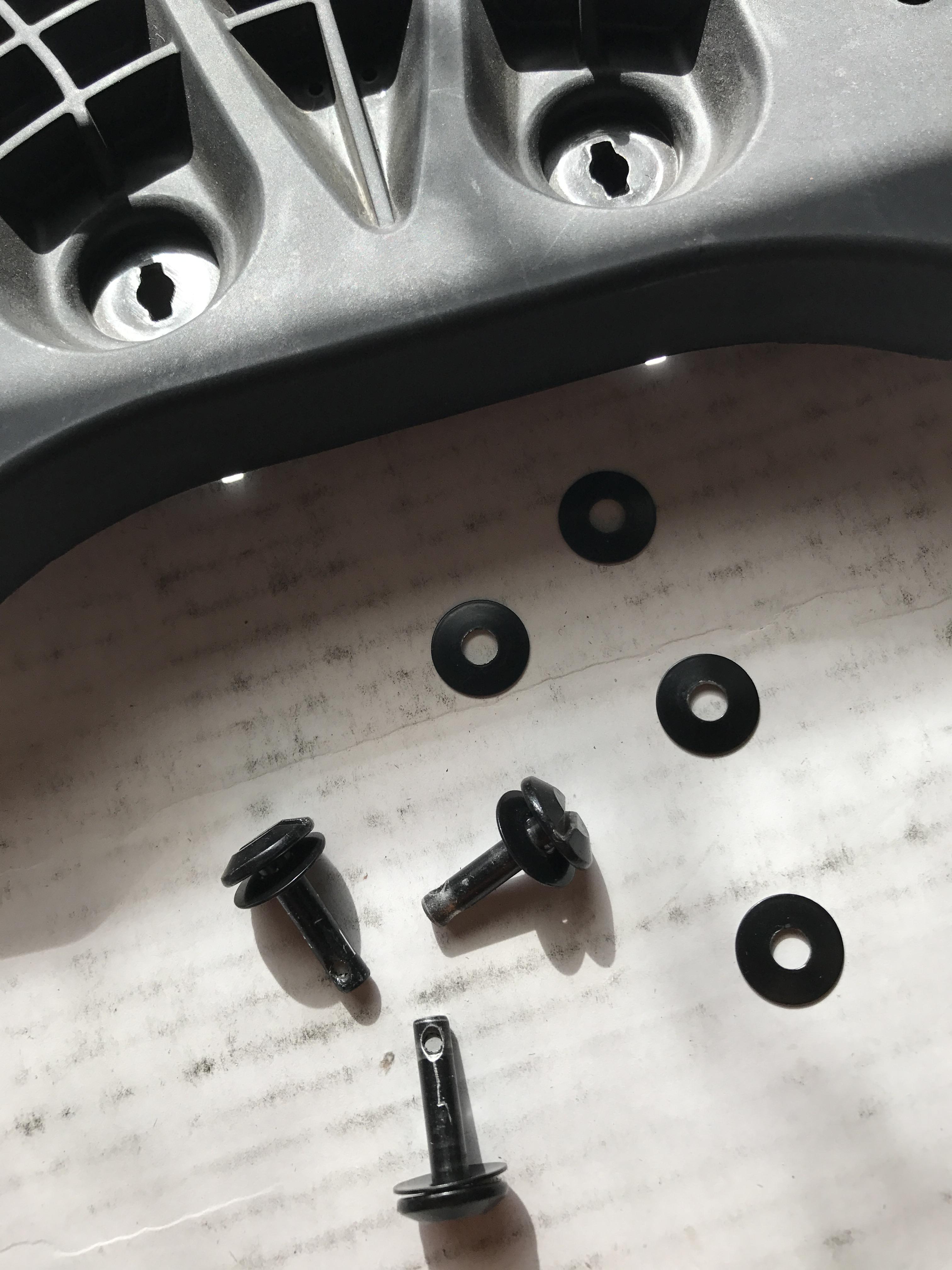

bayarearider Posted June 29, 2017 Posted June 29, 2017 I never felt right about those T-screws and also learned a few weeks ago that they're not engineered for the long haul. Was mounted about 1 year. My 6th Gen O.E. Box/rack had several years mounted without issue. All 3 screws sheared the T's leaving the Givi to bounce down the road like a beach ball. F'd it up. If I keep the rack, straight threaded bolts may replace those sketch Screws. The screws are not lost because they're trapped between the plate and the Box after they let go. My concern of a rigid mount is stress cracks to the box anchor points.  Twisted Throttle did offer discounted replacements. Contemplating options.   Quote
