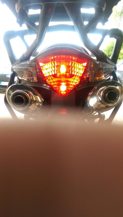

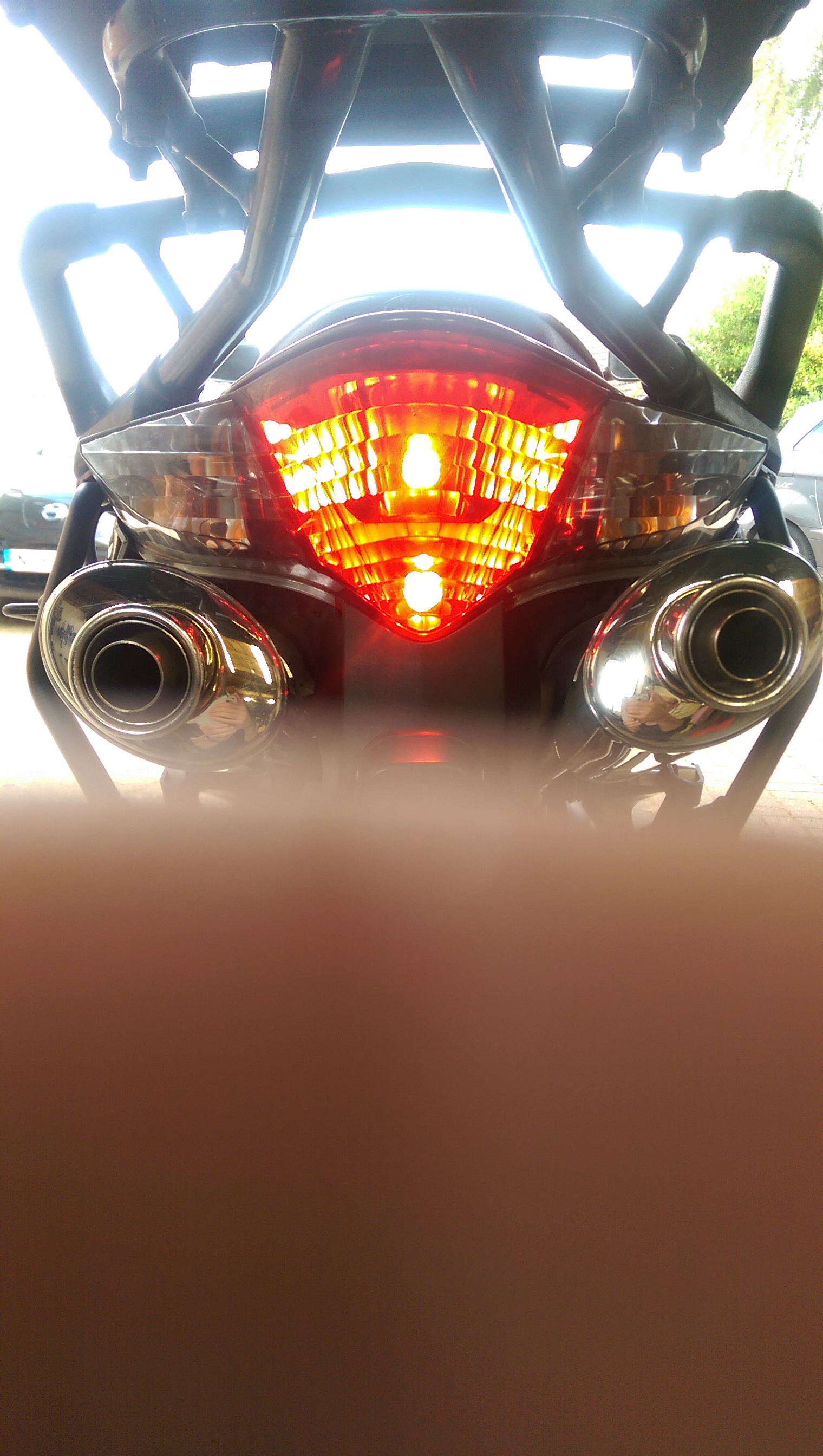

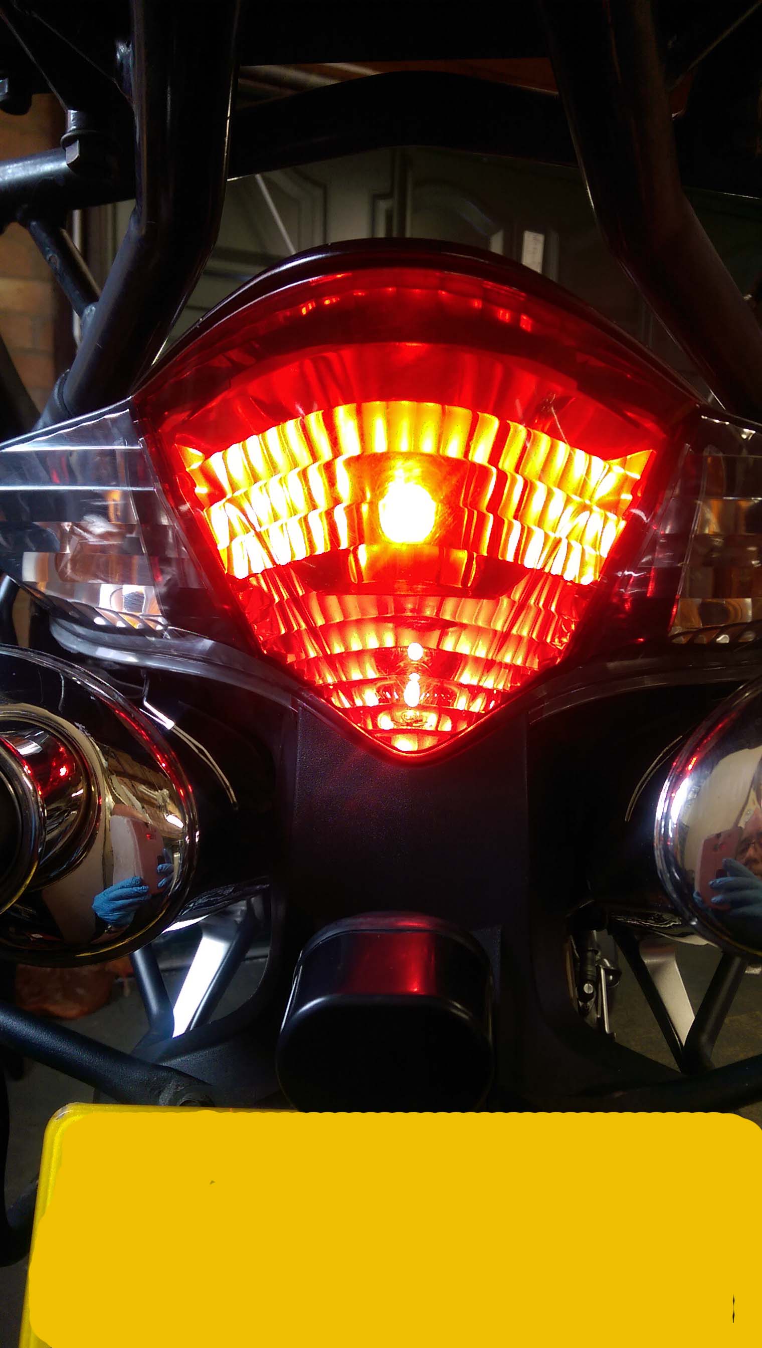

Member Contributer Skids Posted August 20, 2016 Member Contributer Posted August 20, 2016 Bought & fitted a pair of red LED taillight bulbs to my 6th Gen. Pics don't really do it justice but they definitely seem to be more intense than incandescent so I'm happy. Â First pic is of LED fitted to the top, incandescent to the bottom. Angle of shot may have affected picture but definitely more visible to the naked eye. 2nd pic is of both fitted. Quote
