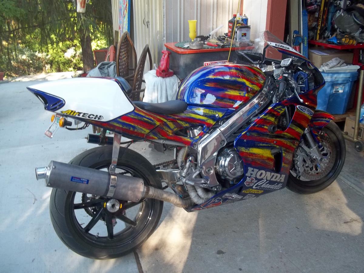

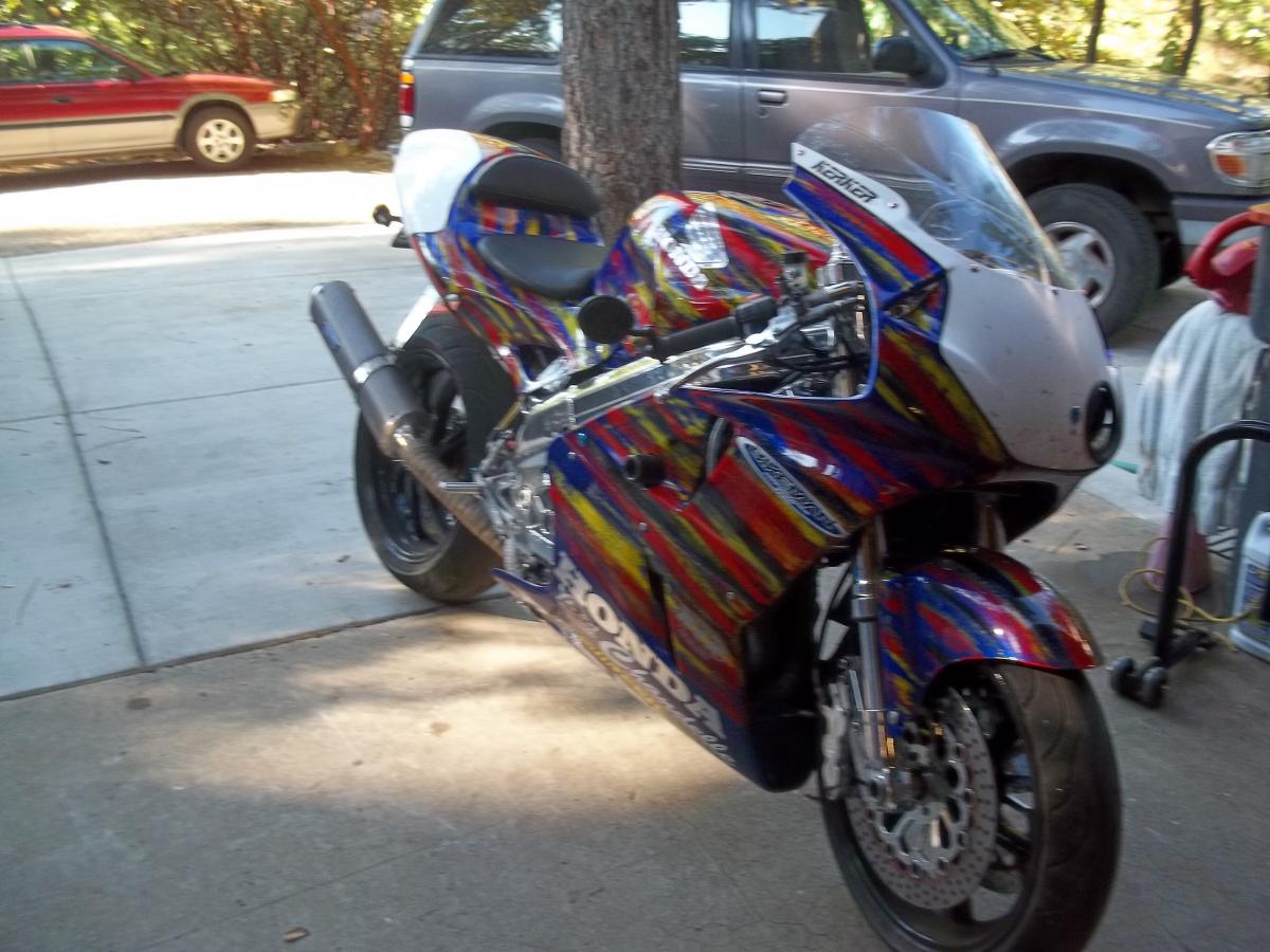

Member Contributer trjerm Posted October 25, 2011 Member Contributer Posted October 25, 2011 I've seen a few RC45 replica's on this site and I think most if not all were built on 3rd or 4th gen. VFR's. The 4th gens frame is almost identical to the RC45. Mine has an USD fork from a GSXR, Kosman Adjustable triple, steering head has been steepened by 1 deg., frames been lazer trued and polished, much eng work, 2 bros full exhaust, 49 state carbs w/ jet kit, RC45 rear wheel, Airtech 94-96 RVF750 race glass, and @ present is 100 lbs lighter than stock VFR. Quote

Member Contributer trjerm Posted October 25, 2011 Member Contributer Posted October 25, 2011 Hello, I got mine the cheap way, I bought an uncompleted racer off Ebay for 3K and put another $1500 or so into it to make it back into a streetbike. I think I'd look @ Beasley composites and get the street upper, lower and the solo tail($600+s/h). The GSXR front end, Kosmans triples, Brakes, Etc came off a GSXR race bike, these guys put between $18-20K into this build($6-8K in eng), before the rules changed to allow 100cc fours to race in superbike , @ that point they stopped working on this and started building a CBR 929 RR to race. (another 20K project that was totalled on its 1st track day). Anyway I think your heading in the right direction w/ that 97. If the stock plastics are in decent shape you could sell them and make enough to buy the Beasleycomposite race glass. Hopefully the 97 has aftermarket exhaust if not then just buy a slip on(High mount) and look @ the numerous post on USD fork conversions(what triples etc) Good Luck and have fun Quote
