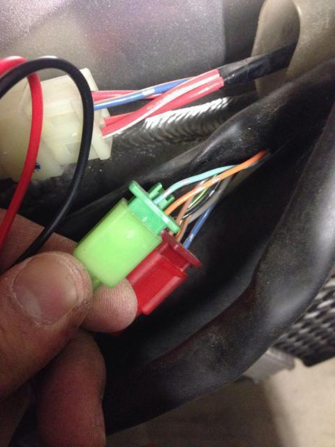

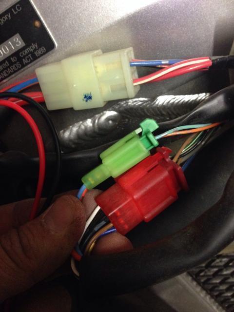

Member Contributer N2v Posted November 9, 2013 Member Contributer Posted November 9, 2013 (edited) Hi guys just about to copy my keys Made my ghetto leads and all And mine is totally different to u guys No red plug Colours of the wires are different please help. Take a look 2005 vfr800 Edited November 9, 2013 by N2v Quote
zRoYz Posted November 10, 2013 Author Posted November 10, 2013 You need to lift tank the wiring you want is between frame & throttle bodies & is with the big grey fuel injection plug. You have the wiring that runs outside of frame coming from R/R etc. ilim007 has posted pics above of fuel injection plug & red plug that is in that area. Quote
Member Contributer N2v Posted November 10, 2013 Member Contributer Posted November 10, 2013 Thanks for the prompt reply Found it Done the procedure and it worked.!!! Quote
