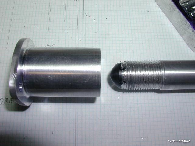

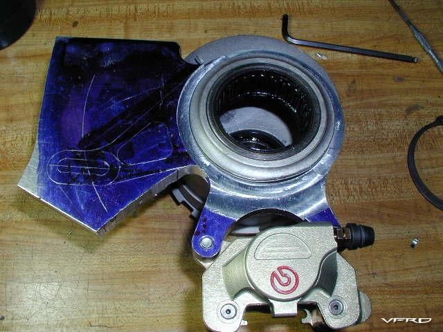

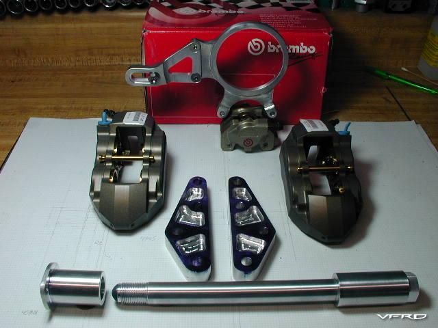

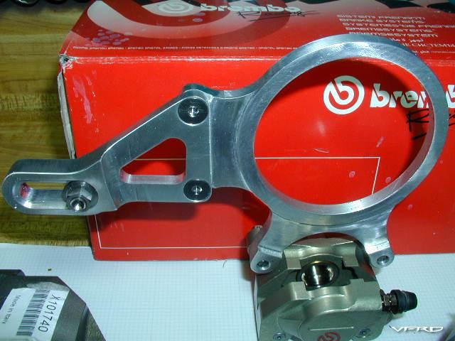

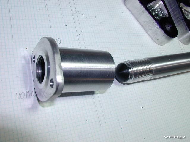

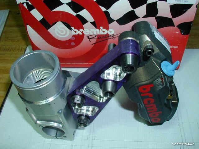

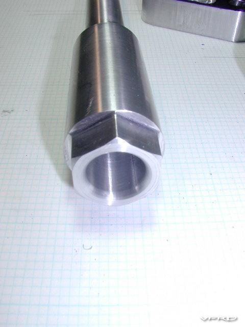

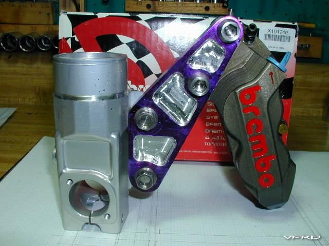

Member Contributer BusyLittleShop Posted April 1, 2010 Member Contributer Posted April 1, 2010 Busy Little Shop project pics... someone suggested I start a picture thread to show what goes on inside the BLS... enjoy... At a glance all BLS parts for a Honda RS250... here is what 39 hours of hand machining at $50 per looks like... Work in progress... BLS 6061 T6 aluminum caliper hanger for a 2 pot billet Brembo to fit RS250 axle cassette... BLS 7075 T6 aluminum axle insert and and axle with Delrin bullet for Ohlins forks... BLS Magnesium calipers mounts... It's nice when someone appreciates your work... I love it when a plan comes together and everything turns out perfect... Quote

V4 Rosso Posted April 1, 2010 Posted April 1, 2010 Looks good Larry :cheerleader: How many hours were needed to fabricate these parts? Quote

Member Contributer BusyLittleShop Posted April 1, 2010 Author Member Contributer Posted April 1, 2010 Looks good Larry :rolleyes: How many hours were needed to fabricate these parts? 39 hours of hand machining at $50 per... Quote
Member Contributer SAFE-T Posted April 2, 2010 Member Contributer Posted April 2, 2010 6061 T6 aluminum caliper hanger for a 2 pot billet Brembo That's what I wanted for my 5th gen, but didn't know anyone around here willing to do it. Quote
Member Contributer BusyLittleShop Posted April 2, 2010 Author Member Contributer Posted April 2, 2010 6061 T6 aluminum caliper hanger for a 2 pot billet Brembo That's what I wanted for my 5th gen, but didn't know anyone around here willing to do it. I think the 4 pot billet would actually stop you better... Quote
Member Contributer swimmer Posted April 2, 2010 Member Contributer Posted April 2, 2010 I can appreciate fabricating all of that stuff by laying out everything by hand and manually machining everything but I could probably model all of that stuff in SolidWorks in a few hours and send it out to be made by some shop with a CNC and a week later I'd have my parts for much cheaper than what you were paid to do that. I send a lot of my small jobs to some dude who does all his machining without a CNC because he is fast and his quality is super so I can appreciate your skills but NFW would I pay $2k for that. Quote
Lee 2002 Posted April 2, 2010 Posted April 2, 2010 Larry, I'm disappointed in the safety wiring displayed here.... specifically the right caliper mounting bolt.... the wire is actually pulling to loosen the bolt. Shame! As an ex-AF guy I'm sure that you would understand neither caliper mount bolt wiring would pass A/P inspection. Quote
Member Contributer BusyLittleShop Posted April 2, 2010 Author Member Contributer Posted April 2, 2010 Larry, I'm disappointed in the safety wiring displayed here.... specifically the right caliper mounting bolt.... the wire is actually pulling to loosen the bolt. Shame! As an ex-AF guy I'm sure that you would understand neither caliper mount bolt wiring would pass A/P inspection. You're right... thanks for pointing that out... and just think I was Quality Control prick in the USAF... Quote

Member Contributer vfrcapn Posted April 14, 2010 Member Contributer Posted April 14, 2010 I think the 4 pot billet would actually stop you better... I'll put this on my wish list Larry, would be nice on my '99 along with a single braided brake line through the swingarm! :fing02: Quote
