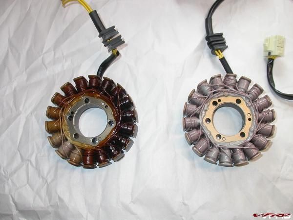

Member Contributer covfrrider Posted July 31, 2009 Member Contributer Posted July 31, 2009 I did my stator, and I wanted to add to the alignment step. I purchased 4 6mm x 75mm bolts at Lowes for ~$7. I cut the heads off of them and then used them in every other whole to accomplish the alignment. It worked like a charm. Thanks for the write up on this, my dealer wanted $225 + $275 ($500) to do the stator repair. I bought the Rick's for $160 (that included shipping) and did it myself. case torque specs honda vfr Quote

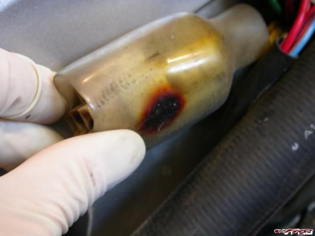

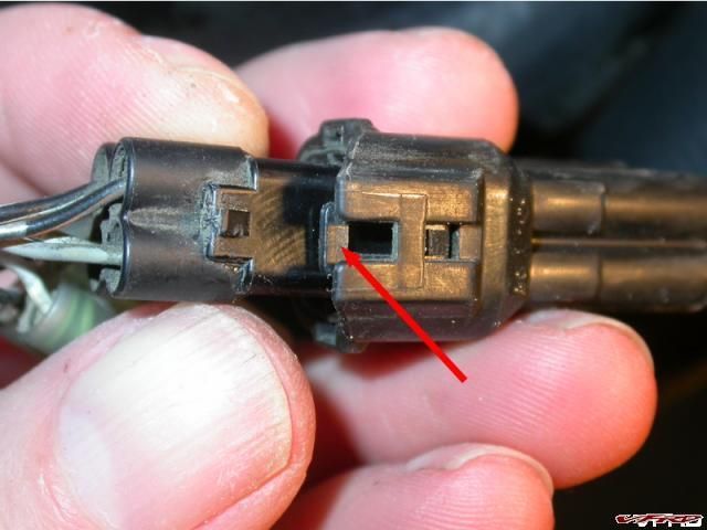

soichiro Posted January 19, 2011 Posted January 19, 2011 Looks identical to my connector on the 04. I did away with the connector and all is well. Quote

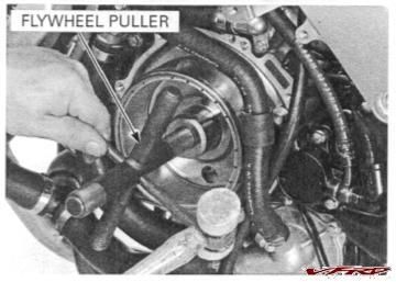

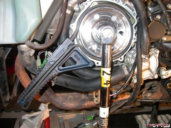

Member Contributer kaldek Posted June 6, 2011 Member Contributer Posted June 6, 2011 Does anyone know what size thread the flywheel needs for a flywheel puller? There's a bucket of tools on eBay etc but none of them mention the 2002+ models and the thread size needed. Honda Australia is quoting me $122 for the tool which supposedly costs $16 in the USA. The best info I can find is that the thread might be M20 x 1.5 RH thread. A tool is available from Motion Pro in that size.. Quote
Auspanglish Posted June 6, 2011 Posted June 6, 2011 Does anyone know what size thread the flywheel needs for a flywheel puller? There's a bucket of tools on eBay etc but none of them mention the 2002+ models and the thread size needed. Honda Australia is quoting me $122 for the tool which supposedly costs $16 in the USA. The best info I can find is that the thread might be M20 x 1.5 RH thread. A tool is available from Motion Pro in that size.. NFI Quote
Member Contributer kaldek Posted June 6, 2011 Member Contributer Posted June 6, 2011 Does anyone know what size thread the flywheel needs for a flywheel puller? There's a bucket of tools on eBay etc but none of them mention the 2002+ models and the thread size needed. Honda Australia is quoting me $122 for the tool which supposedly costs $16 in the USA. The best info I can find is that the thread might be M20 x 1.5 RH thread. A tool is available from Motion Pro in that size.. NFI Wow mate, that was the most useful post, EVER! Anyway I took a punt and ordered the M20x1.5 RH tool as listed above. We'll find out soon enough if it works! Quote
Member Contributer kaldek Posted June 14, 2011 Member Contributer Posted June 14, 2011 My new flywheel arrived today, and I dropped down to the local bolt supply company since my flywheel puller bolt hasn't arrived yet. I can confirm that M20x1.5 RH thread is the correct bolt size for removing the flywheel on any 6th-gen VFRs. The guys only asked for a couple of bucks but I threw them $5 since I've managed to get a couple of free bolts off them in the past. Only problem is, now that my Shorai Lithium-phosphate battery has arrived my signal dynamics voltmeter is no longer complaining about low voltages at idle. It's even sitting above 12.5 volts with the engine off and all the accessories powered up (and headlights too). Quote
wera803 Posted June 14, 2011 Posted June 14, 2011 Just curious, why was the flywheel replaced?? Was it damaged somehow?? I didn't see any reason in the write-up. Quote
Member Contributer kaldek Posted June 14, 2011 Member Contributer Posted June 14, 2011 Just curious, why was the flywheel replaced?? Was it damaged somehow?? I didn't see any reason in the write-up. It's listed briefly in the first post - basically the 2002 model VFRs had a weak charging system that would flatten the battery when idling if the lights are on and the fan kicks in. And when the stator starts to wear out the problem only gets worse. There was a recall for these in the USA, whereby the stator and flywheel were replaced for free, but in some cases folks did it themselves. Like me, for example, doing it now. :-) Quote
wera803 Posted June 14, 2011 Posted June 14, 2011 It's listed briefly in the first post - basically the 2002 model VFRs had a weak charging system that would flatten the battery when idling if the lights are on and the fan kicks in. And when the stator starts to wear out the problem only gets worse. There was a recall for these in the USA, whereby the stator and flywheel were replaced for free, but in some cases folks did it themselves. Like me, for example, doing it now. :-) Okay, thanks. I knew there were stator problems, but didn't realize the flywheel would "wear" and need to be replaced as well. Maybe it looses magnatism?? I don't think it actually touches the stator, does it?? Quote
Member Contributer kaldek Posted June 15, 2011 Member Contributer Posted June 15, 2011 Okay, thanks. I knew there were stator problems, but didn't realize the flywheel would "wear" and need to be replaced as well. Maybe it looses magnatism?? I don't think it actually touches the stator, does it?? No no, they don't wear - only the stator wears out (heat causes the insulation in the wires to break down). The main problem was that the stator and flywheel combination on the 2002 was so small that it could not charge the battery and run the lights when the bike was idling. In other words, it wasn't manly enough and the bike needed a bigger one! Quote

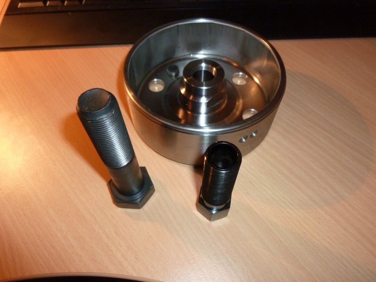

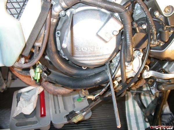

Member Contributer kaldek Posted June 15, 2011 Member Contributer Posted June 15, 2011 OK folks I have two flywheel puller bolts ready to go. One of them is solid, one hollow. Which one do you all think I should use? Use the hollow one! Will the solid one damage the hole for the flywheel retaining bolt on the end of the crankshaft? The hollow bolt by the way is the Motion Pro tool. Quote
Member Contributer kaldek Posted June 17, 2011 Member Contributer Posted June 17, 2011 Well I just did my flywheel and stator upgrade this evening, and it all went smoothly! I tell you, that strap wrench idea was fuggin' useless if you're a piss-weak nerd like me or don't have any friends handy. In the end, I removed the flywheel bolt using my airgun - BAP BAP BAP and off she came, just by putting the gearbox into sixth. If you don't have an air ratchet, you really will need to either be a strong mutha, or have a mate put everything he has into holding that flywheel in place with the strap wrench. One thing I thought would be a nightmare (but ended up being a piece of piss) was getting the flywheel off the crank. I mean I stuck that Motion Pro bolt in there, turned it a couple of times and I was freaking out because it wasn't getting tight until I realised the flywheel had already come off the crank. Anyways, with the new flywheel and stator I'm getting 22 volts AC at idle (cold) whereas I was previously getting 18 with the OEM 2002 stator and flywheel. I will definitely recommend that anyone changing their stator have an impact screwdriver handy, because the bolts holding the stator to the engine cover are TIGHT and the screw heads (they'll either be torx or hex) are soft and will round out before you know it. When my original 2002 stator died in 2010 (cooked itself), I couldn't get the bolts out and got so mad I attacked the entire stator with an angle grinder. It was good stress relief, but fugged up the stator alright. Gosh, is there anything left on this bike I *haven't* changed?! Quote

Member Contributer kaldek Posted June 19, 2011 Member Contributer Posted June 19, 2011 Also, since changing the flywheel and stator I rode to work today in heavy traffic. Even when idling with the lights on and fan running, my voltages never dipped below 13.2. That's way better than the old charging system. Definitely a recommended upgrade for 2002 owners who commute in traffic (especially in hot climates). Quote

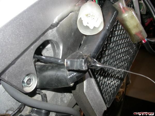

Guest Mobius Posted July 18, 2011 Posted July 18, 2011 I would like to add a few helpful hints that I discovered during this installation that may help others.<BR style="mso-special-character: line-break"><BR style="mso-special-character: line-break"> 1. When wrapping a wire around the plug to pull through, be sure to wrap it in such a may that there are no sharp edges to catch. I did not do this on the first pull, and the plug seemed to catch every edge it could find and had to be coaxed through with a long screwdriver. On the second pull, I wrapped the plug with smooth electrical tape in the shape of a bullet. It pulled through effortlessly. 2. This tip is obvious for those with mechanical experience. I wished I used a chemical gasket remover because it is very easy to scratch the soft metal surface of the stator cover. I also removed the small bits of (silicone?) around the wire plug that were originally installed at the factory. Probably should not have done this. Quote
surfpete Posted February 16, 2012 Posted February 16, 2012 Just diagnosed a faulty stator on my 2006 model (already replaced R/R and battery on AA advice!!). Can anyone advise if this model would need the rotor replaced as well as stator - obviously hope not as this would make job much easier. Also any idea of outer diameter for 2006 model - is it the 107mm or 115mm??? Cheers Quote
Member Contributer Rice Posted February 16, 2012 Member Contributer Posted February 16, 2012 06 should have an upgraded rotor. I just changed my stator and left the rotor in place. With new stator and some upgrades to the charging system (extra grounds, beefier charging wires and direct soldering instead of plug connectors, I get excellent charging at all RPMs with all of my lights, fan and heaters on high. 1 Quote
Member Contributer didit Posted February 16, 2012 Member Contributer Posted February 16, 2012 Didn't do the flywheel, but I have fond memories of my RR and Stator-ectomy taking place in the parking lot of the BW in Eureka, CA. Thanks to HS & radar (and a few on lookers holding the beer), she came out of post op just fine. Sucked having it happen on the road, but so rewarding to be riding with peeps who know what the heck they were doing. I'd offer this tid bit. . . . If you are experiencing even slight electrical blips, before you go much further than your local shop, order the parts & do it in the comfort of your own garage. Another big shout out to tightwad for the site member source of where to get the parts www.wiremybike.com. 1 Quote
spud786 Posted February 17, 2012 Posted February 17, 2012 Just diagnosed a faulty stator on my 2006 model (already replaced R/R and battery on AA advice!!). Can anyone advise if this model would need the rotor replaced as well as stator - obviously hope not as this would make job much easier. Also any idea of outer diameter for 2006 model - is it the 107mm or 115mm??? Cheers Only the original 02 models, need a Rotor, all newer models already have the Newest flywheel/rotor. How many miles are on you 06 at stator failure? Quote
Member Contributer kaldek Posted February 17, 2012 Member Contributer Posted February 17, 2012 Can anyone advise if this model would need the rotor replaced as well as stator - obviously hope not as this would make job much easier. Also any idea of outer diameter for 2006 model - is it the 107mm or 115mm??? Rotors don't wear out, so no need to replace. Outer diameter of original 2002 model stator is 107mm. Outer diameter of upgraded stator is 115mm. I have one of each in my garage just lyin' around. 1 Quote
