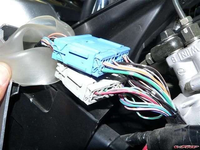

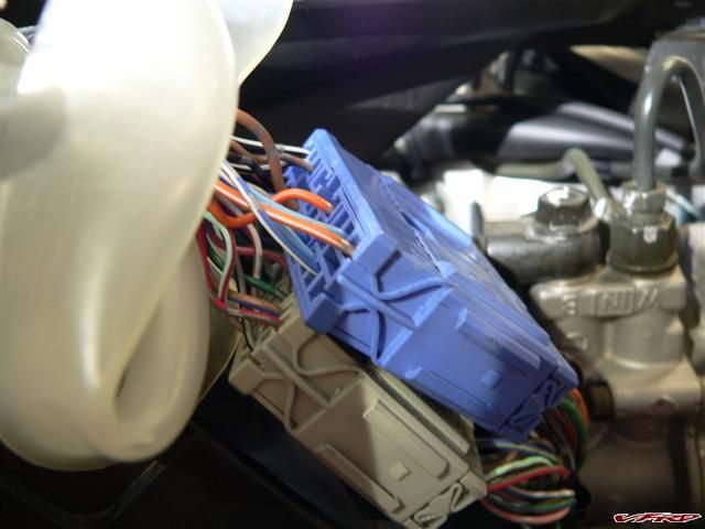

KanadianKen Posted July 11, 2007 Posted July 11, 2007 My good buddy out on the left coast of Canada, Mookiethemagnificent - phew thats a mouthful - bought a VFR on my suggestion, and recently had some battery/electrical gremlins to sort out. Being as I'm not there to help him - I figured I could show him how to fix or pre-empt the blue connector ground connection issue AND pre-empt the problem on my own bike. Here's a quick summary of what I did. (As luck would have it my soldering iron decided it was too hot out to work properly, so instead of soldering the connections, they are hard crimped, and then electric tape covered.) First thing - locate the blue connector under the left side fairing, hidden inside a crappy little plastic cover. Locte the green wires on both sides of the connector. These are the wires you need to work with. The goal is to create an additional path ACROSS the blue connector - as well as create an additional ground location for these wires. I used a knife to carefully shave off a small (1 cm) length of green sheathing from each green wire - on each side of the blue connector. Next - I needed to find a secondary ground location to attach the soon to be created "jumper" wire. Found the 8 mm bolt that attached to the frame - just under the left of the gas tank. With that located, I needed to create the jumper wire. HEre's what I made: Wire is 14 gauge, and has a ring terminal crimped onto the end to attach to the frame near the left side of the gas tank. I stripped out a small section of sheathing to make the contact with the aft side of the blue connector (green wire) and the end piece to connect to the forward green wire. Next - I used some crimp connectors to attach the white Jumper wire to the already exposed copper inside the green wires. Its basic stuff - but it worked great: Once I was sure that the connections were super tight - I wrapped them in electric tape, double layers. All thats left in the process is to put the fairing back on. HOpe this helps explain how this fix can be accomplished with basic tools, and minimal expense. Might have been a $2.00 fix. It is not a difficult task to complete - and even if your blue connector with green wires isn't "bad" why wait till it goes bad and strands you? 1 Quote

Guest bsd43 Posted July 14, 2007 Posted July 14, 2007 It seems to me that the only side that needs beefing up is grounding the front harness (left connector in the picture), since it seems that all (most of?) the failures have been to parts that are hooked up to the front harness, i.e. front lights, turn signal relay, and bank sensor/engine stop/fuel relay. I have a single Posi-Tap from the front harness green wire to ground, and that's it. The back end will just use the standard ground. Quote

Guest Pete McCrary Posted November 14, 2007 Posted November 14, 2007 Just so I'm 100% positive on this fix. It's the blue connector but the green colored wire is the ground circuit Honda uses - correct? Quote
Baileyrock Posted November 14, 2007 Posted November 14, 2007 Just so I'm 100% positive on this fix. It's the blue connector but the green colored wire is the ground circuit Honda uses - correct? Yes, that's why we have pictures too! :unsure: Quote
Guest Pete McCrary Posted November 15, 2007 Posted November 15, 2007 Cut me some slack Bailey, I'm old and color blind. Quote
Baileyrock Posted November 15, 2007 Posted November 15, 2007 Cut me some slack Bailey, I'm old and color blind. Well be careful then because there's a gray multi pin connector right next to the blue one. I'm old too! :thumbsup: Quote

Member Contributer danterini18 Posted May 3, 2009 Member Contributer Posted May 3, 2009 I finished installing the VFRness and was going to do the Blue Connector ground fix. When I checked the blue connector, there is the green wire on one side and not the other. Am I looking at the right blue connector? Steve Quote
Member Contributer danterini18 Posted May 3, 2009 Member Contributer Posted May 3, 2009 Correct. Shouldn't there be a green wire on both sides? Thanks, Steve Quote
Member Contributer Rivcyko Posted May 4, 2009 Member Contributer Posted May 4, 2009 What, color blind? LOL. Just follow the green wire. Lower right- most wire. (from your pic). That's the one you want. Quote
Guest VFOr Posted May 4, 2009 Posted May 4, 2009 Correct. Shouldn't there be a green wire on both sides? Thanks, Steve The recall schematic shows one of the grounds no longer routed into the blue connector, that spot is empty. Quote
Member Contributer Rivcyko Posted May 4, 2009 Member Contributer Posted May 4, 2009 What, color blind? LOL. Just follow the green wire. Lower right- most wire. (from your pic). That's the one you want. Please forgive, LOWER LEFT- most. Correct. Shouldn't there be a green wire on both sides? Thanks, Steve The recall schematic shows one of the grounds no longer routed into the blue connector, that spot is empty. Perhaps, (Not like the schematics, have ever been wrong). BUT,...I see a green wire in the pic. 1 Quote
Member Contributer danterini18 Posted May 4, 2009 Member Contributer Posted May 4, 2009 I emailed Tightwad and it seems the recall addressed this issue. So I guess that is why only one green wire in and none on the other side. The recall must have installed the tan connector below it and solved the issue...I hope. Thanks, Steve Quote
Member Contributer NVR2L8 Posted May 5, 2009 Member Contributer Posted May 5, 2009 Yea, the green wire on the front side of the blue connector is missing if you've had the recall performed. I think I mentioned that in my post above... Quote
