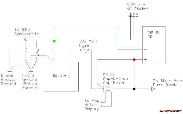

Please describe what you mean by "commoned them". I can solder, but don't know the methods of connection, connectors to be used, etc. What is your method of connecting the new add'l 12 ga wire to the two green wires on the R/R plug?
What fitting did you use at the battery positive terminal that accomodated the 2 new 12 gauge wires? Or did you use two separate fittings?
Did you bypass the stock R/R feed to the stock harness through the white connector on the skinny red wire, or is that still connected? If so, how did you attach the two new 12 ga postive wires to the R/R positive output?
Finally, why did you run the R/R negative to the frame, rather than to the battery (as you ran the R/R positive to the battery)?
Thanks for your work on this. Very helpful.

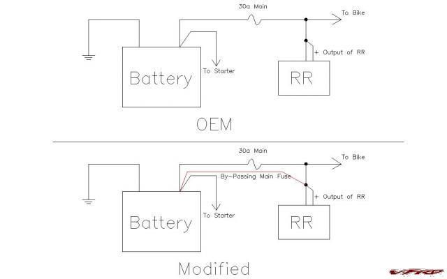

Yea, all the above might prevent this..
Fuse? Can anyone explain why the fuse didn't blow?
Yamaha part on my VFR-bad Karma? After the second stranding via a Honda rectifier..BTW-the sticky surface on the back of the rectifier made a good thumb print impression for an ultimate identification.

To clarify for me, you left the OEM arrangement for the R/R to the stock harness and just added wires to it? You didn't cut the R/R/harness connector out and direct-wire the R/R charge wires into the main battery lead?
I took a different tack and may need to change it. I bypassed the stock charge wire and cut it out. I direct-wired the R/R charge wires together, then tied them to a single 12 ga wire that I ran to the postive battery post as an add-on. I figured the 12 ga wire would be sufficient, given the skinny R/R charge output wires, and didn't want more wire than I needed.
Then I bypassed the stock harness and direct-wired the R/R ground wire to the brake valve ground, where the main battery ground attaches, again using 12 ga wire.
I picked up a little (1/4 volt) with this direct wire arrangement, but, after hitting 14.6 or so at 1,500-2,500 rpm, then decreasing as rpm increases, still ends up at 13.94 v warm @5 k rpm, clean connections, brand new battery, brand new upgraded R/R and brand new Honda stator.
Hence my interest in your technique. Thanks again.
I left the OEM wires intact because:
A ) it gives you more wire potential to hook it all together...it's not hurting anything, just inadequate
B ) Not to upset the original OEM wire integration just in case it mattered...if it does, I'm safe, it it doesn't then nothing hurt.
I think you should at least double up your wires...age old rule concerning wiring: You can never have to much.
Another possible problem...I think the OEM runs the RR wires to the starter THEN it distributes from there. You have essentially reversed that (batt first, than starter) not sure if it matters, but, it could.

This is why the went to the extra black wire in the 6th gen rectifier straight to the battery, since they were sensing voltage at the RR over the red and black leads which were slightly undersize and would get hot and give a flase reading. The black lead carries no current so remains cool and makes a better measurement point. The better answer would have been for honda to just upsize the wires and leave the black wire off it. I have no idea why they didn't do it that way...

Ok, here's a couple more questions.
I have the wiring diagram in front of me (I could make copies showing what I think you mean, and post them), and of the 2 red/white wires that go into the reg, one comes from the battery, and the other one goes to the main connector for headlight, dash etc.
My first question is: Do you use the same fuse, add a new one or bypass it all together?
2nd question: Would it work to take the terminal off the connector for the reg, solder it with the bigger wire and put it back in?
3rd question: Knowing that the second red/white wire isn't a link to the battery, do I still need to double it?
4th question: I noticed that the 2 red/white wires are connected together at one point, shoud I use that instead to connect the bigger wire?
Thanks,

It does by pass the fuse...you could add one...but I would put one in each wire individually.
IF there is a short that could cause a problem, it would have to be in that 8" piece of wire. Highly unlikely really.
If it's in another area, the OEM fuse will take care of that. If you wreck bad enough to cause a short in that wire, I think the wire will be the last thing you need to worry about. In all actualities, the wire will actually function as a fuseable link if no fuse is used.
If it's something that worries you, add a fuse in line
Majority (possibly all) of OEM auto manufacturers DO NOT use a fused charge lead - no reason to really.
I would just add the wires. It will keep the charge leads as short as possible and maintain the OEM wire routing for the original wires.
IF the original wires coming of the reg simply go straight to the battery (and are short) replaceing them out of the plug would be fine but the wire would have to be completely replced from the reg to the battery to be most effective.
Doubling up both of the wires and hooking directly to the battery maximizes the charge potential.
If the RR only has the single lead going to the battery for charge THAT is the major problem in the system.
Share this post
Link to post
Share on other sites
True that auto's don't use a fused charge lead, but the RR is on the fused side of the battery already, if you provide a direct link from the rr to the battery, you just by-passed the 30a fuse for the entire electrical system. In your system, you could remove the 30a main fuse and the bike would still function normally.
Have you looked at the wiring diagram?
If not, here is my best explination
Battery>30a Fuse> Y splice with one lead going to the RR the other going to bike power.
You went directly from the RR to the battery, therefore the existing 30a fuse could be removed completely from the system and be function normal.

Guest zam70
I understand what your saying at it is a very good point...
Since you have the diagram at hand, what does the OEM 30amp actually interrupt that is not protected @ the fuse panel? Just curious.
If it is just the charge lead to the battery, I wouldn't worry about it. That would mean the 30 amp fuse is protecting the originall RR wires.
Like I said, if it's something that concerns you, fuse each additional lead individually...it's a good idea, just not something I did.

Quick Sketch of the Wiring Diagram
Quick Diagram Quick Diagram<br />
Share this post
Link to post
ahhh, its protecticing your main harrness. if you have say your headlight wires short, the 30 fuse will blow saving your entire harness from melting. wires make terrible fusible links as they are usually bundled with other wires which they can melt to in a short failure situation.
you would have to increase the wire size from RR to batt, RR to fuse, fuse to main distro point to gain the benefits while still being protected.
Sorry, forgot about that fuse when i gave advice earlier, nice catch.

Here is the wiring diagram of what I did. You won't have the Kriss Amp-U-Tron in line, but you can mearly cut the main feed to the battery and splice in an extra wire to boost charge to the battery.
Wiring Upgrade New + Wires in Red, New - Wires in Green. All wires used are 12ga high strand.
Keep in mind that when you have the extra wire coming directly from the RR to the battery, and you add a second 30a fuse, you then have on the bike side of the battery, 60a of potential. To prevent this you may want to change the 30a fuses for 15a or 20a fuses so as not to have such a huge potential in case of a dead short.
Thanks for posting the diagram and explanation. I'm no electrical diagram reading guy, so please let me confirm that:
You ran one 12 ga wire from each of the R/R's positive outputs and buttonholed them into the big stock to-the-battery positive terminal somewhere south of the terminal, itself (ignoring the amp meter issue). True?
Then you ran the R/R ground directly to the battery negative terminal?
Then you buttonholed the R/R ground to the frame ground?
Then you ran a second ground from the R/R ground line from the battery negative terminal to the frame ground under the plastic?
Then you ran a separate ground wire from the brake res to the frame ground?
If true, you have no new wires added to the positive terminal, but two new wires added to the negative terminal? (one incoming from the R/R and a new one leaving to the frame ground)
If not true, please clarify as to how these wires are physically attached. Sorry in advance if it's my electrical ignorance but if it helps, I am learning a lot, and others likely are, as well.
