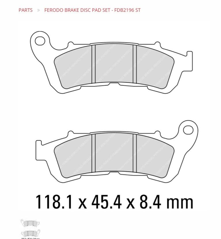

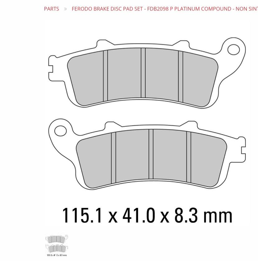

Member Contributer Grum Posted November 16, 2023 Member Contributer Posted November 16, 2023 Here's the drawings and dimensions for the Front and Rear Ferodo pads I replaced on my 2009 6gen years ago. Fronts sure don't look compatible to the Rears! Fronts = FDB2196ST Rears = FDB2098P 1 Quote

Member Contributer Grum Posted November 17, 2023 Member Contributer Posted November 17, 2023 The other thing worth considering is that there is a 40mm difference between the front and rear disc diameters. Front and rear pads would surely have slightly different arc angles you'd think! Quote

spud786 Posted November 19, 2023 Author Posted November 19, 2023 Final verdict, no dice, the frame of the right fronts are longer by 1/4 to 1/2 inch. I guess I'll be sitting on thees right front pads for a while, I did them not long ago, and order another set of rears, Quote
