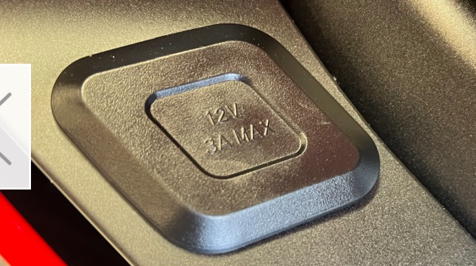

weewards Posted September 26, 2023 Author Posted September 26, 2023 Interesting, there is definitely a panel on the top of the left side panel that says 12V, I just do t know what is underneath… Quote

Member Contributer Captain 80s Posted September 26, 2023 Member Contributer Posted September 26, 2023 The only mention of a 12V 3A power socket I can find is on the X (2018+). Have you seen this F in person? Maybe somebody retrofitted one from the X. I believe it is a cigarette style socket, as I read mention of somebody trying to use a mini air compressor and blowing the fuse. Quote
weewards Posted September 26, 2023 Author Posted September 26, 2023 I haven’t seen it in Person as yet but the pictures clearly show the flap shown in the picture and the description of the bike says includes a 12V power socket. it looks standard but as you say it might be a part from the cross runner as I can’t find it listed anywhere either. i will know for sure in a few days…. Quote
Member Contributer Skids Posted September 26, 2023 Member Contributer Posted September 26, 2023 The 2018+ X definitely has a power supply on the top of the lhs fairing. It's a cigarette lighter socket, not a usb. No idea about the f-model. 1 Quote

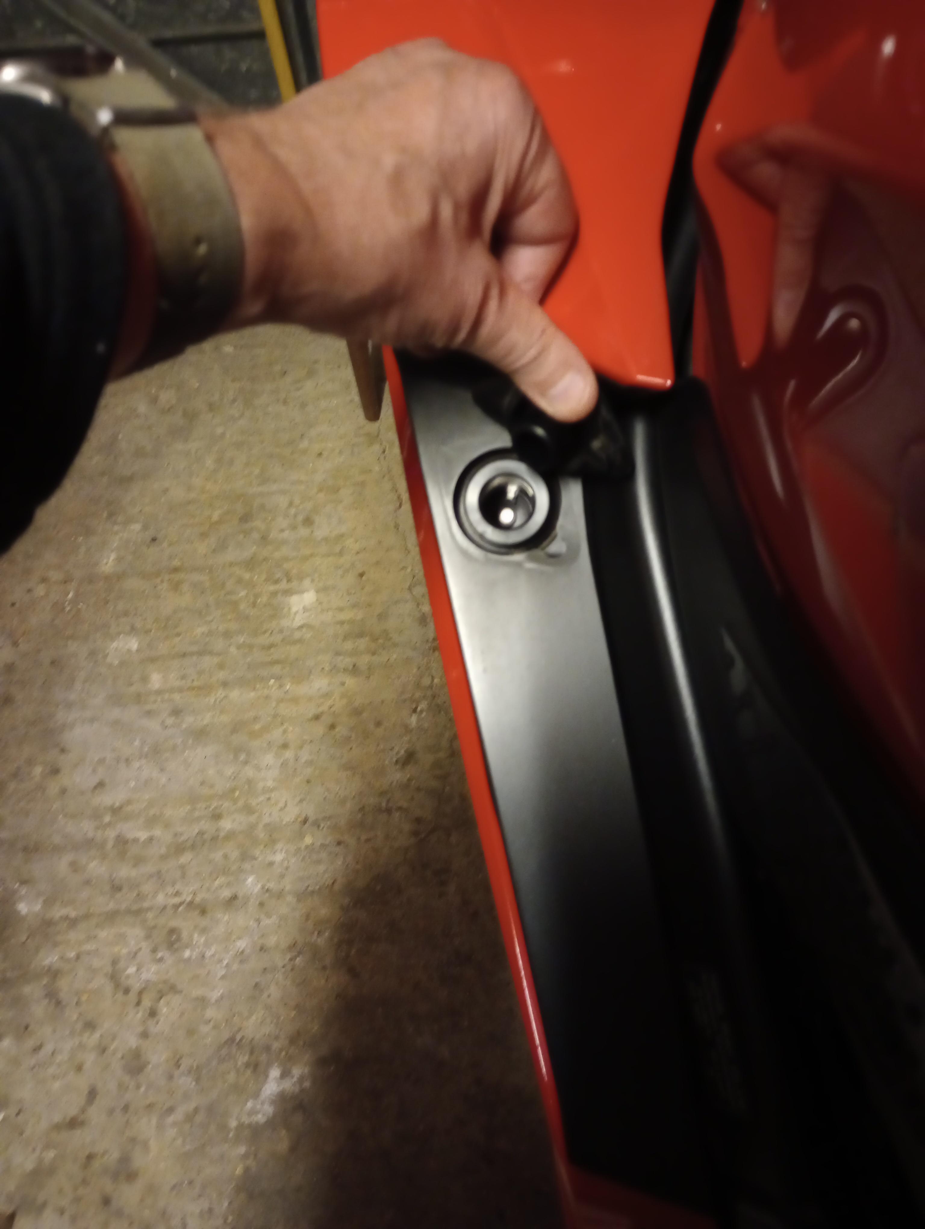

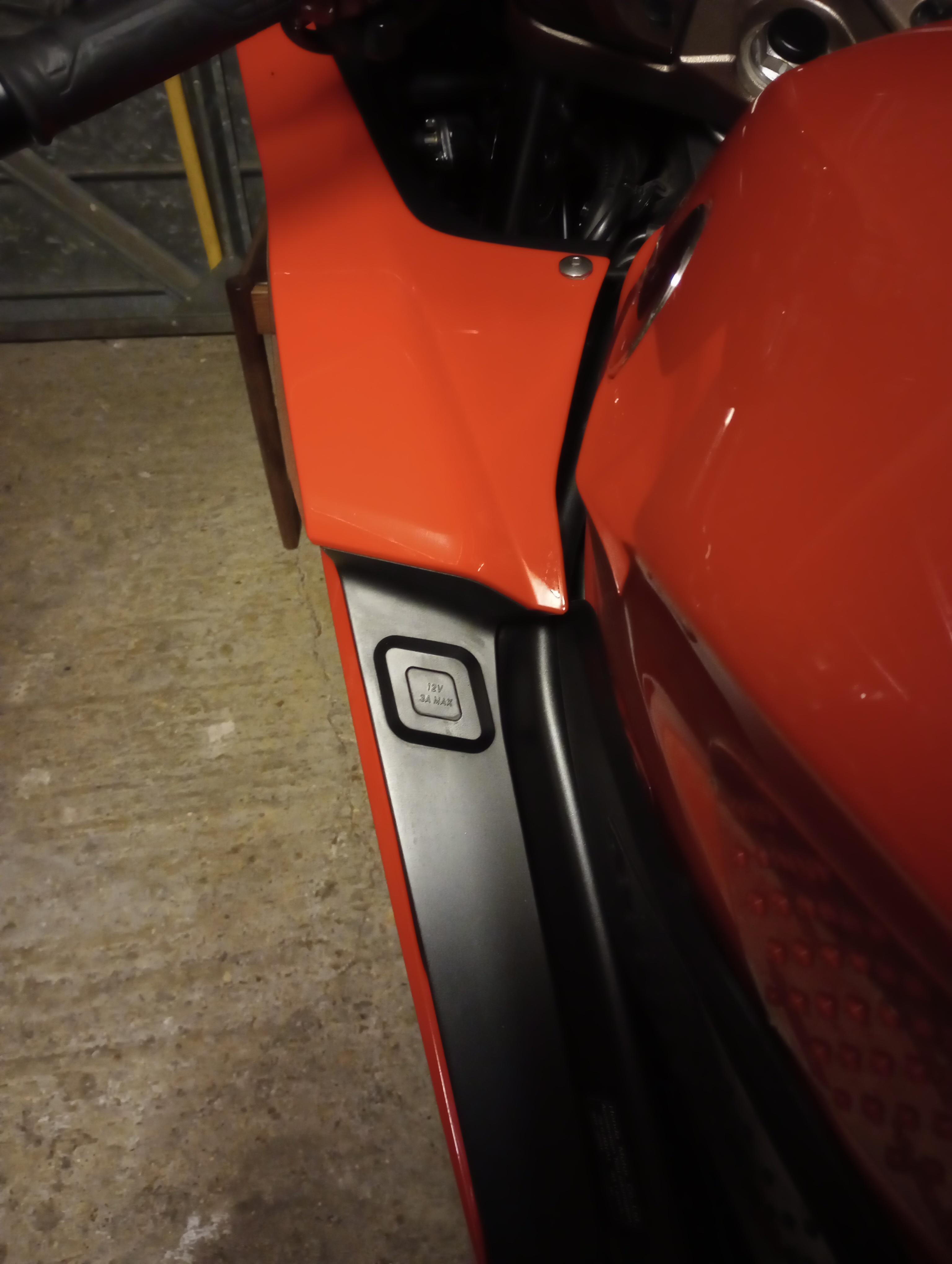

Member Contributer Presson Posted September 26, 2023 Member Contributer Posted September 26, 2023 Here you go. This is the 8th Gen F-H model: it's a standard 12v socket. Actually not great for wet weather unless you can find some way to weatherproof the adaptor 2 Quote

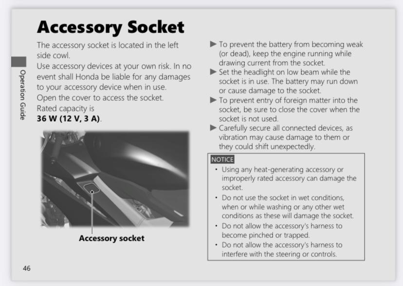

Member Contributer VFR78 Posted September 26, 2023 Member Contributer Posted September 26, 2023 All Fs after 2016 had them. The explanation in the handbook doesn’t inspire confidence (attached). My Quadlock is wired directly to the battery. 1 Quote

weewards Posted September 27, 2023 Author Posted September 27, 2023 10 hours ago, VFR78 said: All Fs after 2016 had them. The explanation in the handbook doesn’t inspire confidence (attached). My Quadlock is wired directly to the battery. Yes, basically don’t use in the uk as it ‘might’ rain… 1 1 Quote
