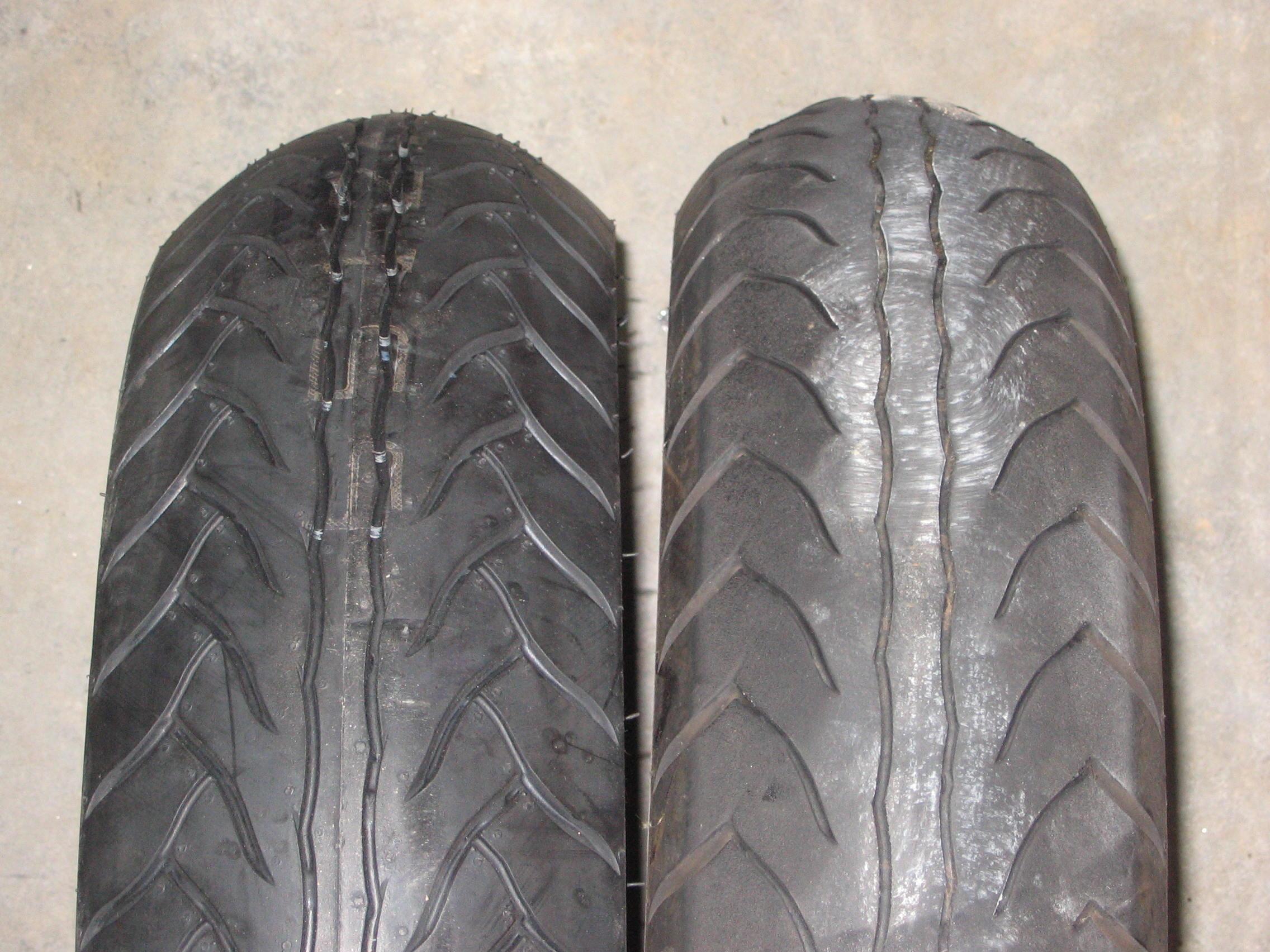

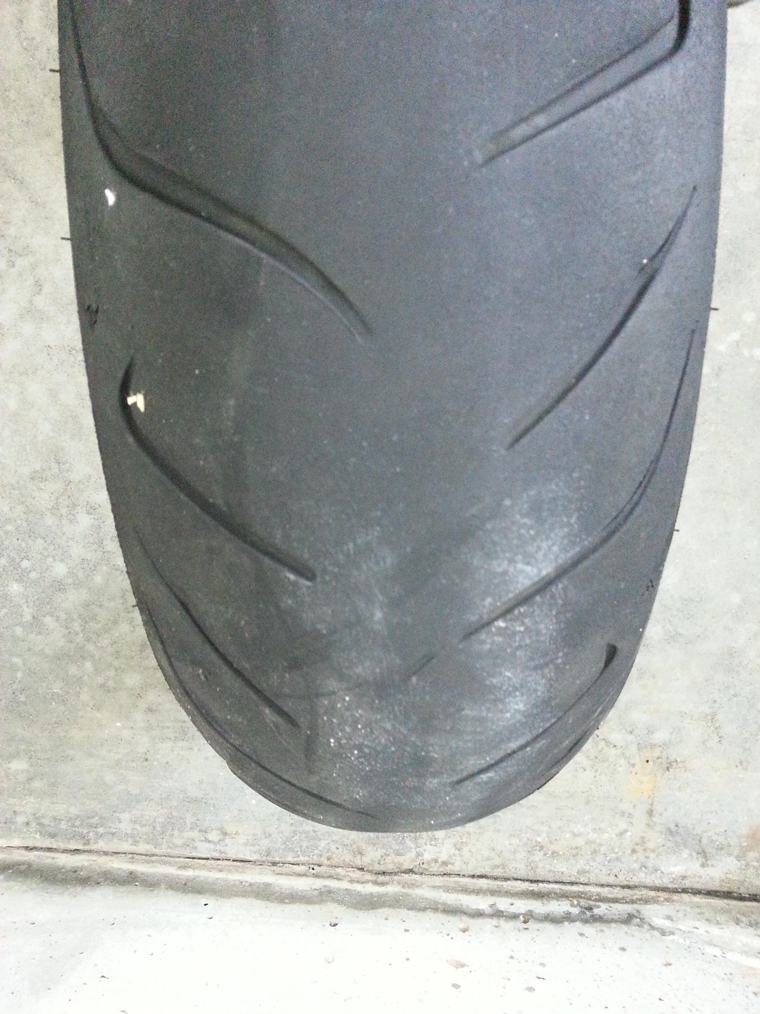

There's a pretty big difference from leading and trailing edge, yes, but moreso that it isn't round left to right. That makes high and low spots that a rider can feel with the change in effort. And, the high spots, of course, provide less grip. Admittedly, many don't notice these things, which is why I was asking. (Genuinely curious, not poking the bear. 🙂 )
Of few of mine from the past. For whatever reason, pics of this seem to be hard for cameras to capture.

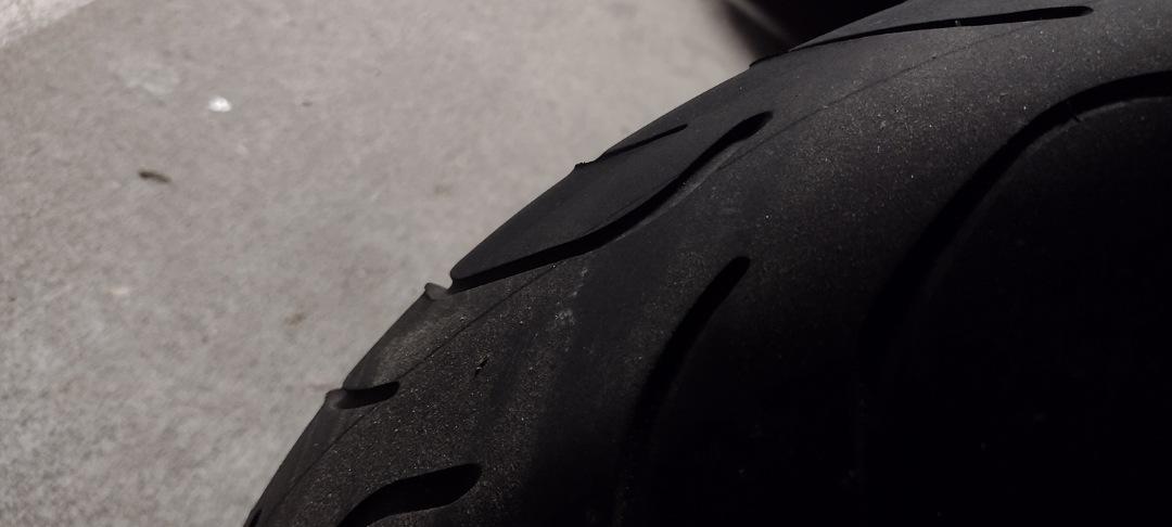

You're talking more about the fact it's squaring off?  I haven't noticed any significant difference over past tires I've ran.  They all get flat in the middle.   I don't get to commute to work on US 129.  As the flat becomes more pronounced with wear I can eventually tell tip in isn't as smooth as a fresh tire, but that doesn't keep me from taking it down to the wear bars.  Or maybe a little farther... 😁
As for that little curled lip on the trailing edge of the siping, I think that has to due with the nature of the tread pattern and forces from acceleration.  Those side treads are more perpendicular and are taking forces broadside on the trailing edge.  I've burned through numerous sets of Bridgestones that had a very similar tread pattern and I'm on the last one on the 2nd VFR.  That also exhibits the trailing edge curl.

Feathering on edge of sipes more visible in previous photo:

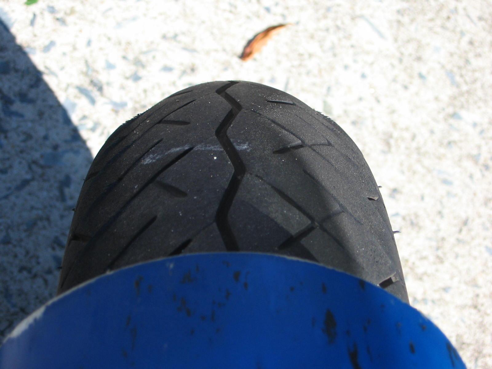

I had that issue on mine too. Day 2 @ AMP on Q3+
uc?export=download&id=1KfJxEH8cjBUxBDuDC
Consulted with Dave Moss and he suggested I go 2/1psi less to 31F/28R. And increase rear rebound-damping. I added 1/4-turn per session and ended up 1 full turn more @ 2.75 turns compared to original 1.75. Much more even wear by 3rd day. Not much left, but definitely better. Also improved my times by 1.2s/lap, which is HUGE!
uc?export=download&id=1Z-MtT3CC113a4VGTY
Got set of KM1 in, looking forward to tyres that lasts more than 3-days!!! Especially at Attesa Podium Club track, which is much higher speeds. 🙂
