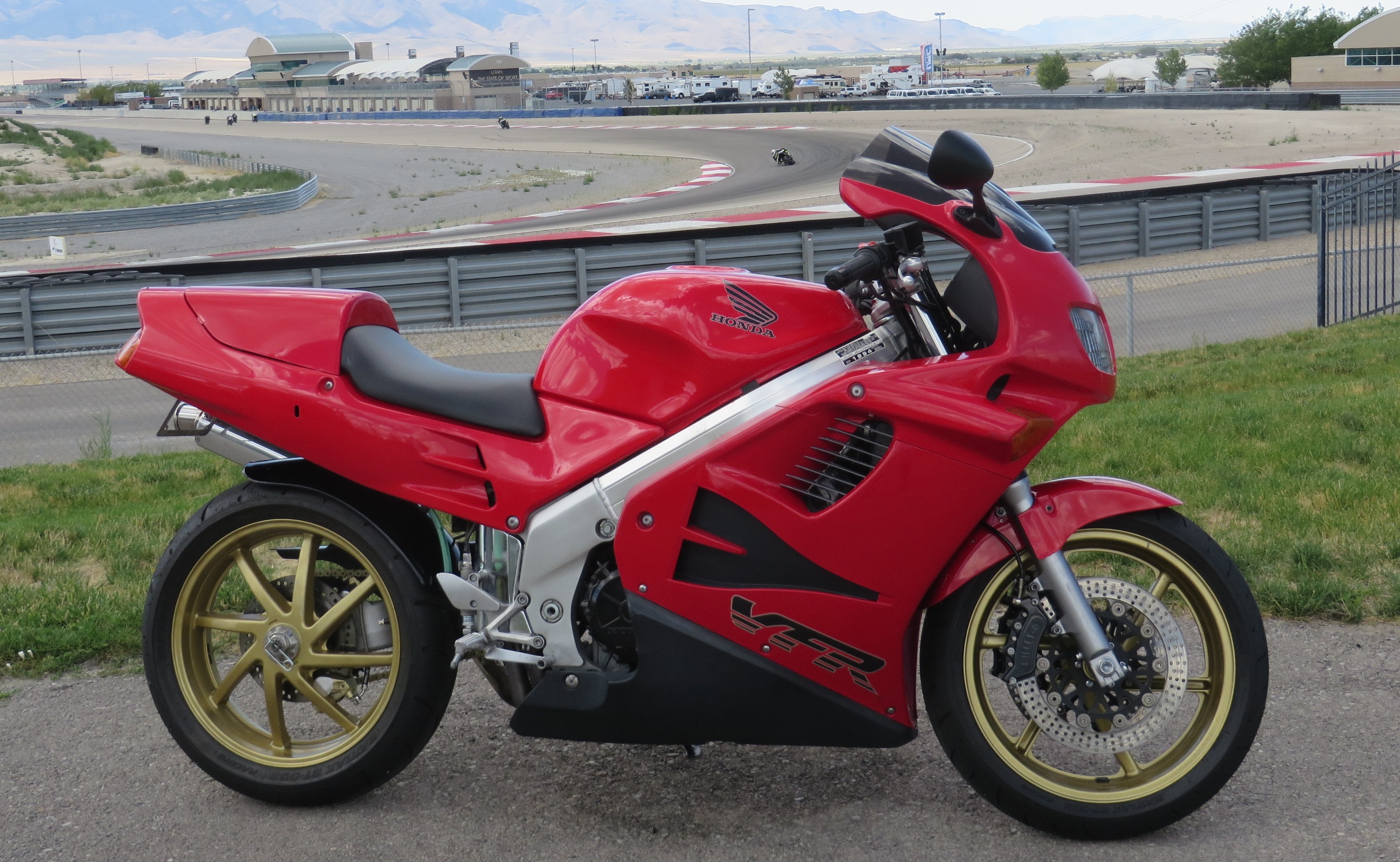

0 Member Contributer slo1 Posted January 28 Member Contributer Share Posted January 28 On 1/23/2023 at 9:17 AM, Captain 80s said: Having the spindle (and/or wheel) modded for different wheels has been done for a while over on hawkgtforum. I had my Hawk modded for a VFR wheel and there has been plenty modded for Ducati wheels. You might pop over there and poke around. https://www.hawkgtforum.com/forum/honda-hawk-gt-bros-discussions/hawk-bros-vendor-area/927189-spindle-mods-by-ww-r Hawk spindle is pretty easy to modify for Duc/VFR rear, but the VFR spindle is not. I put a Hawk spindle that was modified in the Tyga 4th Gen, and could run nc30/35 or Duc wheel. Quote Link to comment Share on other sites More sharing options...

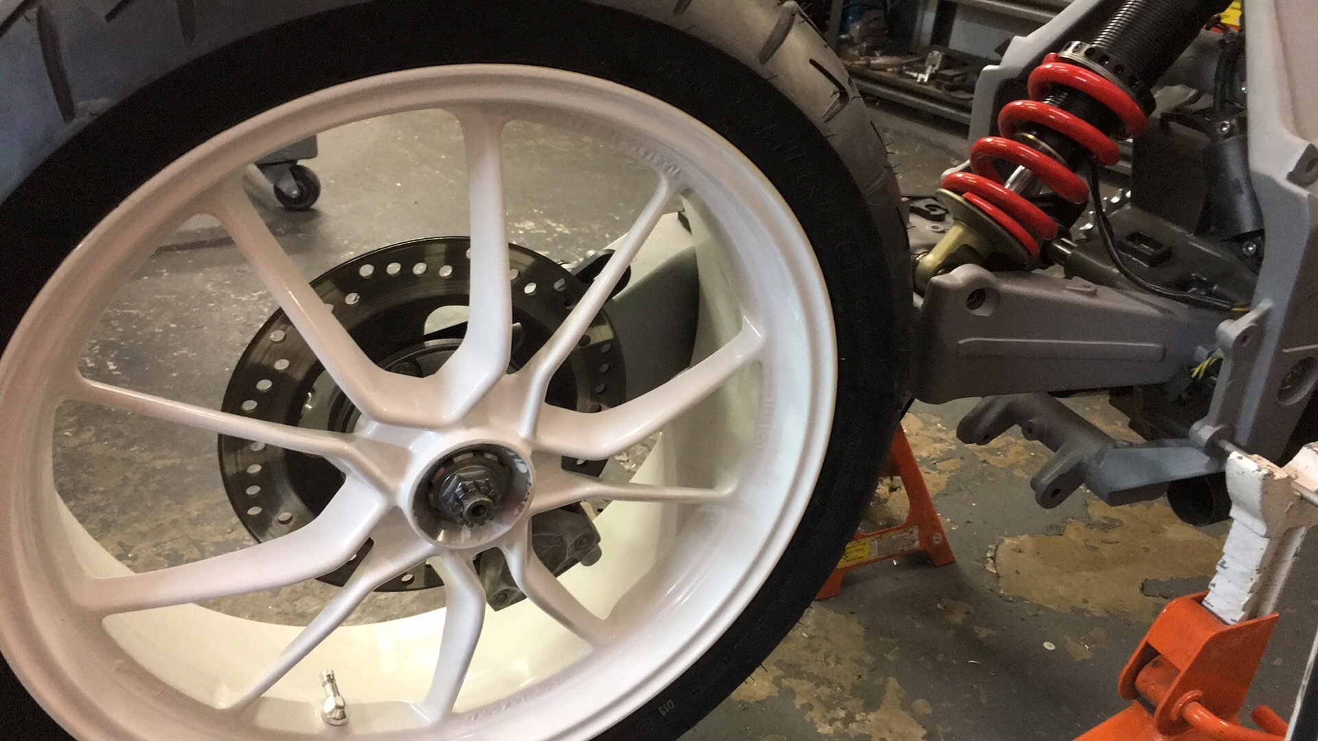

0 SEBSPEED Posted February 11 Share Posted February 11 On 1/23/2023 at 11:59 AM, Sweeper said: You might try a pm to @SEBSPEED. Pretty sure he will have be in the know. I have done the conversion using Triumph parts. I modify the wheel stub of the Triumph axle via machine/press fit/weld then add spacers and drive pins so it all can be bolted in the 750 swingarm. 1 Quote Link to comment Share on other sites More sharing options...
0 SEBSPEED Posted February 11 Share Posted February 11 On 1/23/2023 at 12:48 PM, vfrcapn said: There may be a kit like this, https://www.extremecreations.com.au/1098-ducati-hub-conversion-kit-for-vfr800 around so you can just mount in the Ducati hub, spindle, wheel & brake. Sebspeed was talking about making a kit like this also. I did make a run of these kits, and I still have a bunch available. 3 Quote Link to comment Share on other sites More sharing options...
