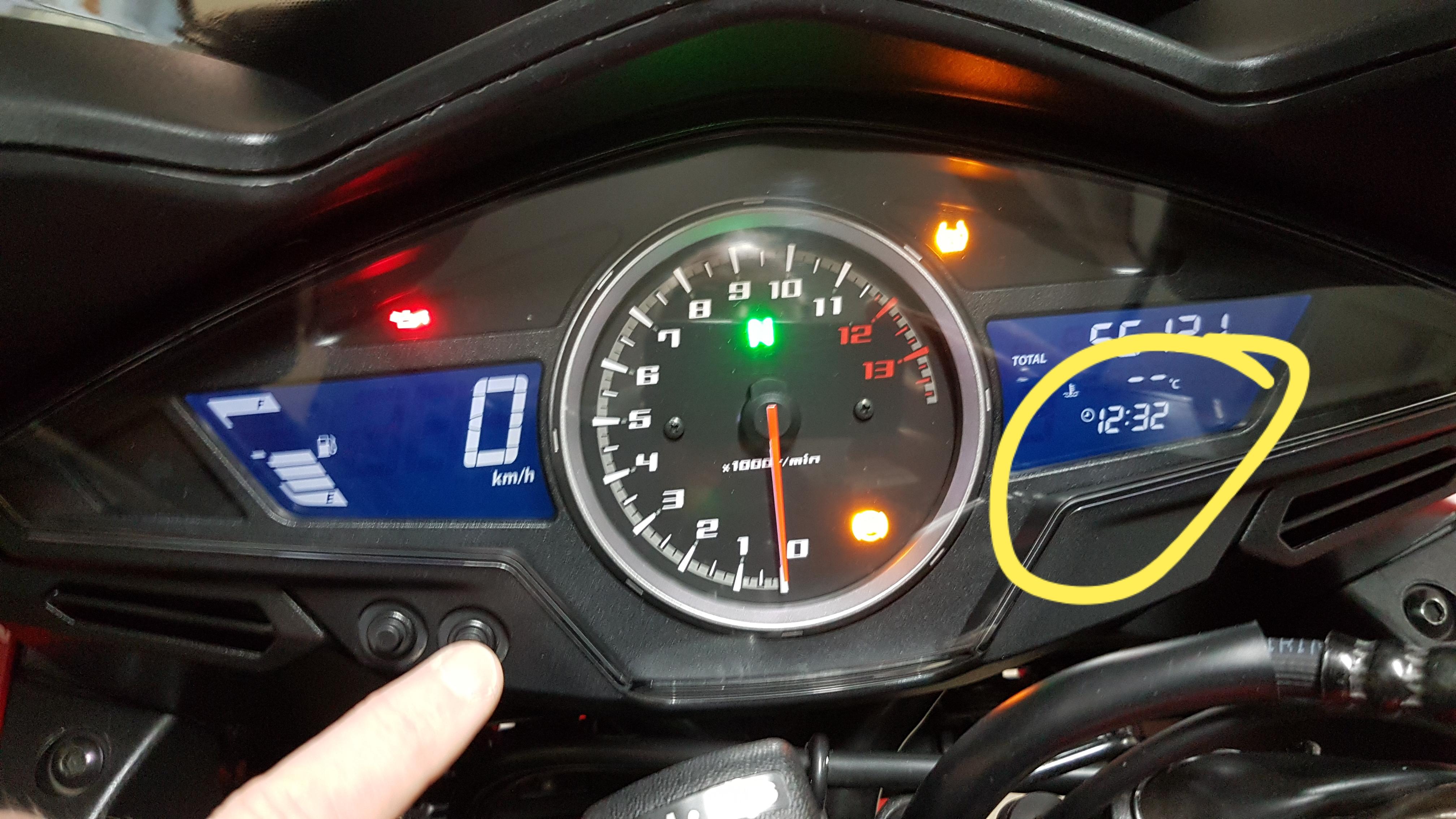

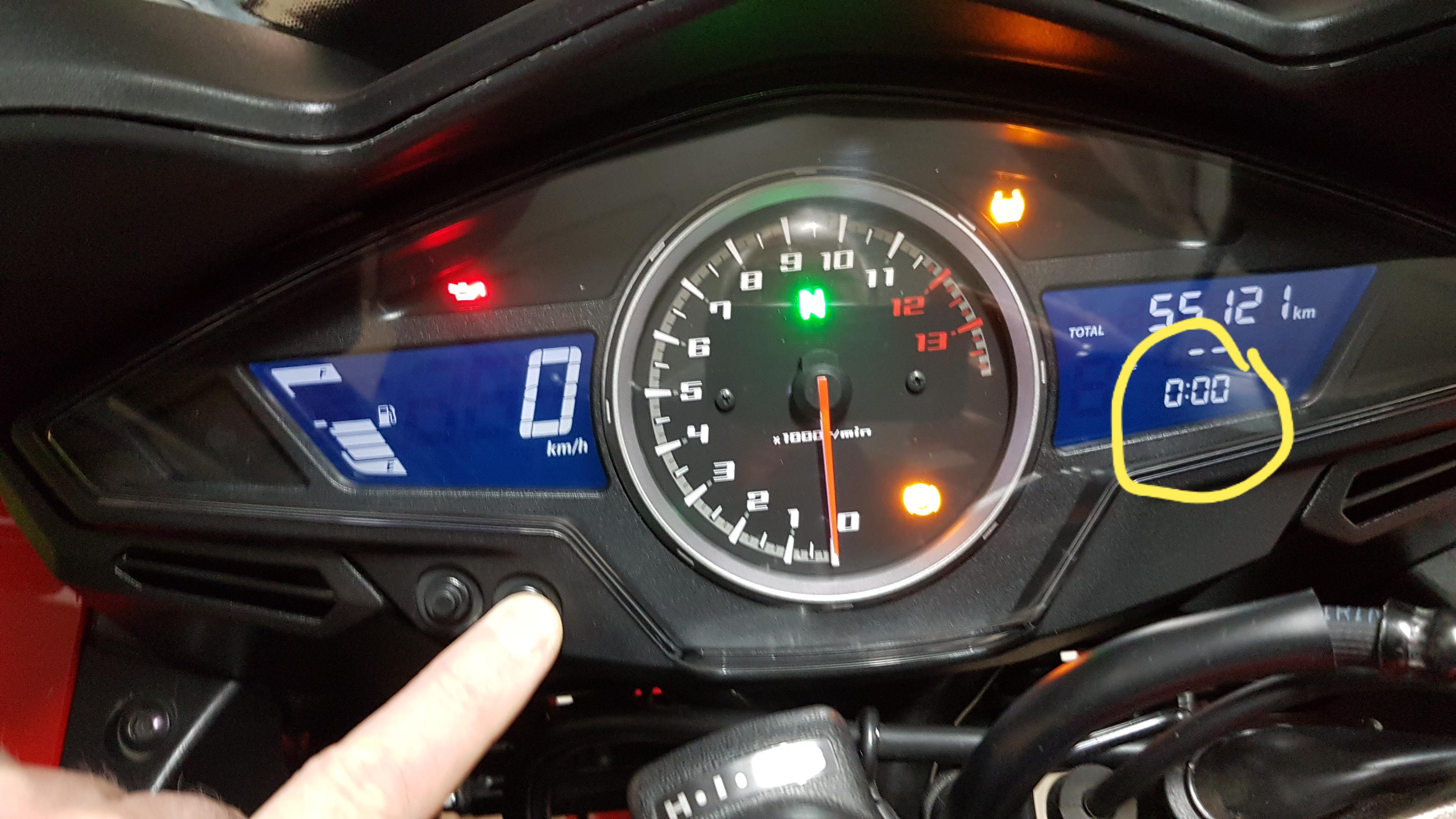

Member Contributer Grum Posted November 14, 2021 Member Contributer Posted November 14, 2021 Can assure you the method I posted works for time setting. Your clock has two modes Clock and Trip Time. I'm sure you have your clock set to Trip Time mode! Trip Time mode will initially display 0:00 as you've mentioned. You can toggle between Clock and Trip Time mode by simply pressing and holding the B button for about 2secs. Photos showing Clock Mode and Trip Time Mode by pressing button B for 2secs. 1 Quote
