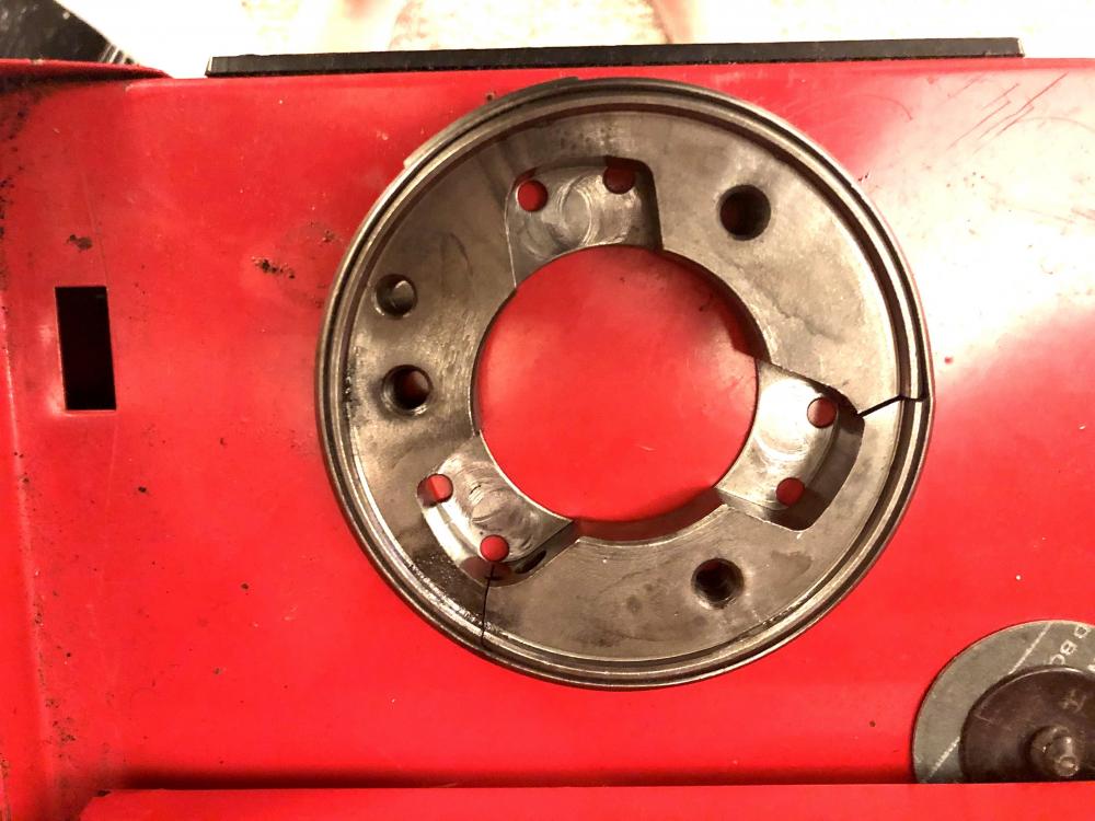

On 11/21/2021 at 5:46 AM, JZH said:
Well, unless it looks like this:
That's the only pic I could find quickly, but I've seen them with cracks in all three places.

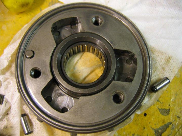

This thread from the recent past has some photos of a seriously grenaded starter clutch, below . . .  not sure if that's been ruled out by now.  The OP began another thread looking for a replacement for his '86, but I don't recall seeing the outcome if one was ever posted.  Hopefully that's not the issue in this case.
https://www.vfrdiscussion.com/index.php?/forums/topic/99151-86-vfr750-changed-starter-clutch-now-bike-just-backfires-and-wont-run/#comment-1128681
That's more like what I was looking for in my pics folder.  I think we can file it under "design flaw"...
Ciao,
JZH
My 86 made some horrible clattery clacking noises so I pulled my starter clutch expecting this. Actually...not a mark or crack on it at 106000km, even the rollers and weights looked like new. Just the springs looked a bit packed down, so I replaced those.

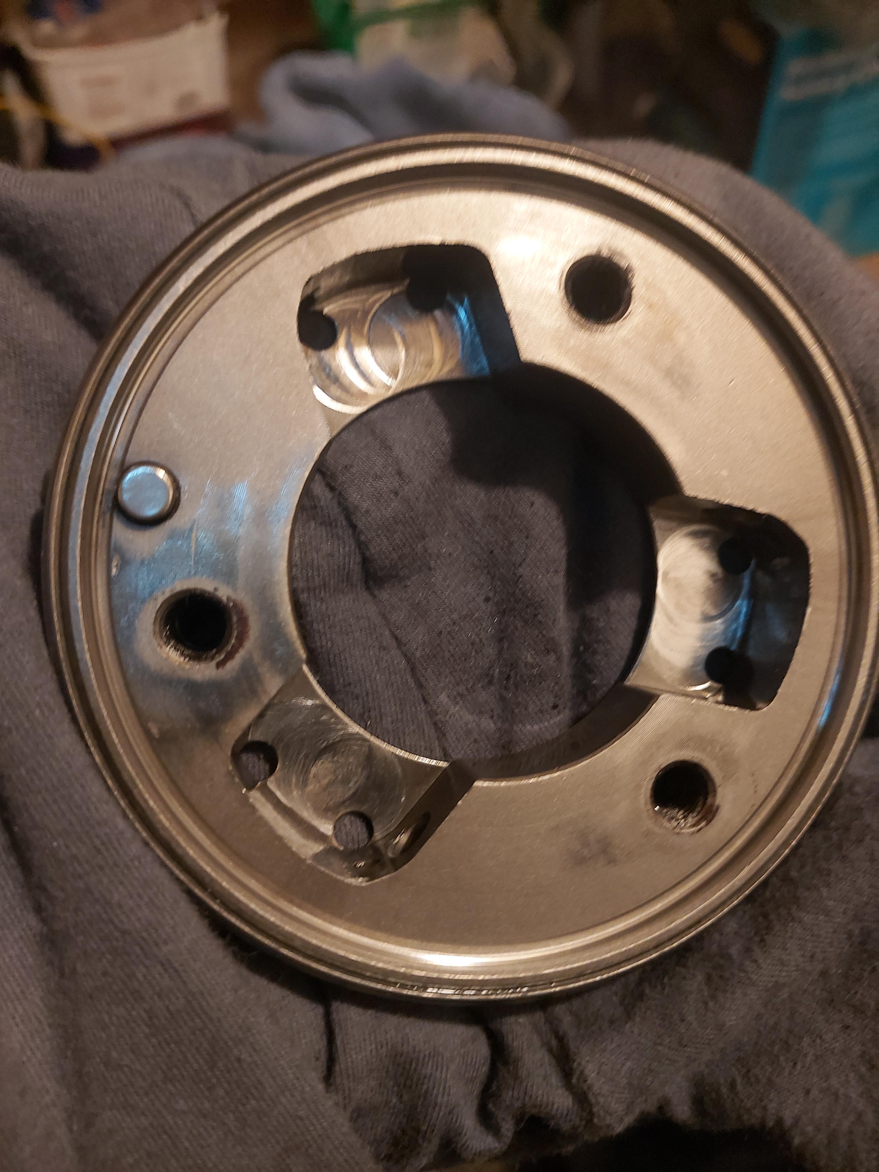

Thanks for the help. I've removed the starter clutch and disassembled it. The clutch outer doesn't have any cracks but the roller seats are slightly worn.

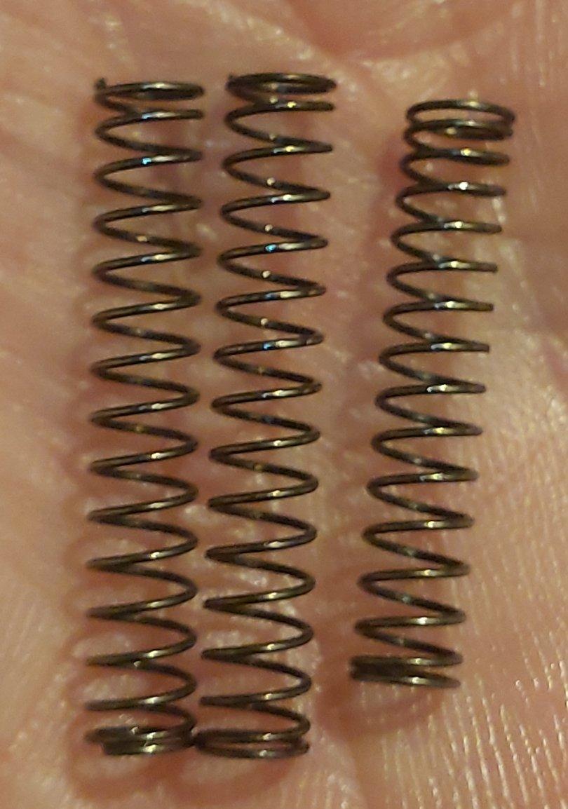

The springs are odd and looks suspicious.
I would put new springs in as that one is quite a bit shorter than the other 2. I have also seen where it was recommended to rough up the area where the rollers contact or some such. It wasn't much that needed to be done, but worked well. I'm not sure where to point you to for the info. It also looks like it would be good to put new spring caps and rollers in as well. If you have no cracks then that would be kind of a rebuild of the clutch.

Thanks, I just ordered a repair kit by Tourmax that includes the springs, cups and rollers.
Edit: I fixed it! After fitting new springs, rollers and caps the problem is gone. The bike starts now every time without any issues.
