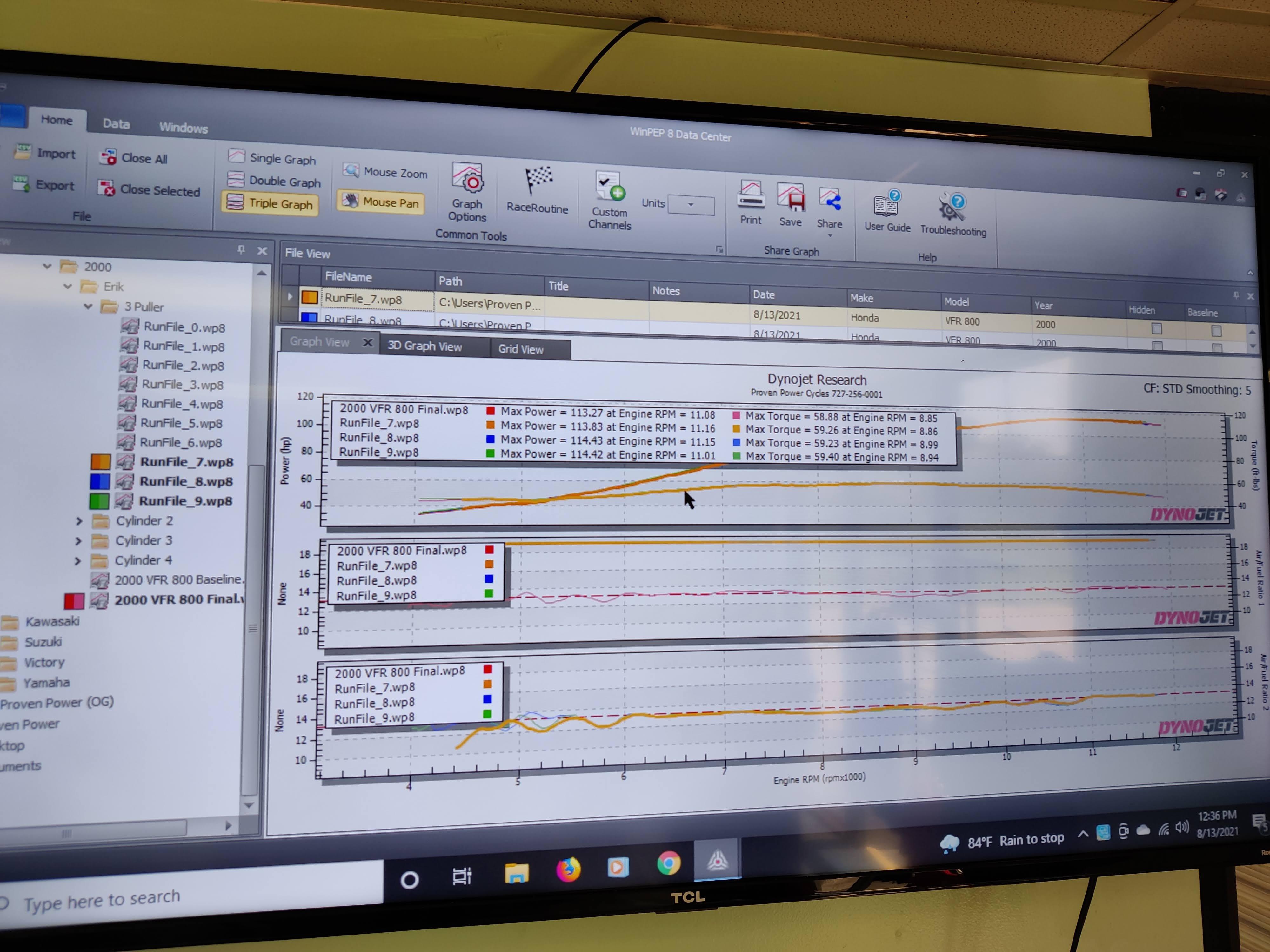

Member Contributer Ughandi Posted August 18, 2021 Member Contributer Posted August 18, 2021 (edited) Back at it again. This bike has come a long way. ...and we are just getting started... Stay 'tuned' for this winter... Edit 1: Red line is from a dynotune from this past February on the exact same dyno in Tampa, Florida. That day was 20F cooler than this re-baseline. Edited August 18, 2021 by Ughandi additional information 4 Quote
Member Contributer sfdownhill Posted August 19, 2021 Member Contributer Posted August 19, 2021 Great numbers - thanks for posting. 1 Quote
68mustang Posted August 28, 2021 Posted August 28, 2021 How did you get 114 hp? Mod list please? Quote
Member Contributer sfdownhill Posted August 28, 2021 Member Contributer Posted August 28, 2021 114hp is what a good 5 gen puts out on a generous dyno with the following mods: -WiLD headers from VFRD -good slipon midpipe/muffler -K&N air filter -Power Commander -a good dyno tech that knows how to tune 3 Quote
Member Contributer Ughandi Posted August 30, 2021 Author Member Contributer Posted August 30, 2021 On 8/28/2021 at 10:45 AM, 68mustang said: How did you get 114 hp? Mod list please? I can't reveal ALL my secrets... ;D The biggest difference between the February dyno and just a few weeks ago is my lightweight flywheel. Shaved a bit over a pound off of it. 2 Quote

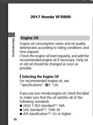

Member Contributer DannoXYZ Posted August 30, 2021 Member Contributer Posted August 30, 2021 Note that oil must be matched to engine-design, specifically bearing clearances. Recent shift to lower-weight oils matches more precise manufacturing tolerances and tighter clearances. Older vehicles with larger bearing clearances should stay with oils recommended by manufacturer. Recent case with BMW M-cars blowing engines due to viscosity-breakdown from high-performance use on tracks. BMW's solution was to go with 20w60 oil on all their M-cars . Problem solved, no more failures. Don't risk your engine trying to get that last 2-3hp out of it by downgrading oil. Not worth it. 1 Quote
Member Contributer BusyLittleShop Posted August 30, 2021 Member Contributer Posted August 30, 2021 8 hours ago, DannoXYZ said: Don't risk your engine trying to get that last 2-3hp out of it by downgrading oil. Not worth it. Mercy Danno!!! You can get that last 2-3hp by Honda's recommended oil or equivalent... you're not risking your engine by running a freer flowing 30 grade... Honda's engineers have tested it to make sure it will meet and exceed your mileage expectations... Quote
Member Contributer DannoXYZ Posted August 30, 2021 Member Contributer Posted August 30, 2021 2 hours ago, BusyLittleShop said: Mercy Danno!!! You can get that last 2-3hp by Honda's recommended oil or equivalent... you're not risking your engine by running a freer flowing 30 grade... Honda's engineers have tested it to make sure it will meet and exceed your mileage expectations... Straight out of 1998-2001 manual it says, "RECOMMENDED ENGINE OIL" and "Viscosity: 10W-40"" The 10w30 oil "may" be used if conditions are within range. That's up to 88F only. Most of track season at Thunderhill is 100F+, not even close! 2 Quote
Member Contributer ShipFixer Posted August 31, 2021 Member Contributer Posted August 31, 2021 15 hours ago, BusyLittleShop said: Mercy Danno!!! You can get that last 2-3hp by Honda's recommended oil or equivalent... you're not risking your engine by running a freer flowing 30 grade... Honda's engineers have tested it to make sure it will meet and exceed your mileage expectations... You have it backwards again. The bearings were designed for a range of viscosity vs RPM for temperature, with consideration for the shared sump with the transmission that cycles the lubricant hard that drove viscosity selection. Visosity is specifically the only characteristic that matters; higher viscosity means the bearing surfaces stay further apart (less bearing eccentricity) and touch less. The "flow" you believe in is only created by RPM and...viscosity, period. Refer back to classwork. I recommend Shigley's Mechanical Engineering Design over "Stuff I found on the Internet that kinda sounds like how I think the physical universe works." 1 Quote
Member Contributer BusyLittleShop Posted August 31, 2021 Member Contributer Posted August 31, 2021 18 hours ago, DannoXYZ said: The 10w30 oil "may" be used if conditions are within range. True... but now the freer flowing and cooler running 30 grade oil is recommended to be used in all conditions... You can bet that Honda's engineers have tested it to make sure it will meet and exceed your mileage expectations... Feel free to release those ponies... Quote
Member Contributer BusyLittleShop Posted August 31, 2021 Member Contributer Posted August 31, 2021 4 hours ago, ShipFixer said: higher viscosity means the bearing surfaces stay further apart (less bearing eccentricity) and touch less. Mercy Patrick... flow equals more separation not pressure... quote Dr. Haas "It is time to introduce the concept of lubrication. Most believe that pressure = lubrication. This is false. Flow = lubrication. If pressure was the thing that somehow lubricated your engine then we would all be using 90 weight oil. Lubrication is used to separate moving parts, to keep them from touching. There is a one to one relationship between flow and separation. If you double the flow you will double the separation pressure in a bearing. The pressure at the bearing entrance is irrelevant." "In fact the relationship between pressure and flow is in opposition. If you change your oil to a thicker formula the pressure will go up. It goes up because the resistance to flow is greater and in fact the flow must go down in order for the pressure to go up. They are inversely related. Conversely if you choose a thinner oil then the pressure will go down. This can only occur if the flow has increased." Quote Rat540 "Plain bearings, such as rod and main bearings are lubricated by oil flow, not by oil pressure. Oil pressure is NOT what keeps these parts separated. Oil pressure serves only to supply the oil to this interface. The parts are kept apart by the in compressible hydrodynamic liquid oil wedge that is formed as the liquid oil is pulled in between the spinning parts. As long as sufficient oil is supplied, no wear can occur. In addition to this, the flow of oil through the bearings is what cools them." Quote
Member Contributer boOZZIE Posted August 31, 2021 Member Contributer Posted August 31, 2021 19 hours ago, DannoXYZ said: Straight out of 1998-2001 manual it says, "RECOMMENDED ENGINE OIL" and "Viscosity: 10W-40"" The 10w30 oil "may" be used if conditions are within range. That's up to 88F only. Most of track season at Thunderhill is 100F+, not even close! This looks like a race bike, so I am assuming you are riding in full leathers. At 119 I'm not worried about what oil is in your mc, I'm worried about your mental and physical health. Lol, but kind of serious though, why? 1 Quote

Member Contributer DannoXYZ Posted August 31, 2021 Member Contributer Posted August 31, 2021 3 hours ago, BusyLittleShop said: True... but now the freer flowing and cooler running 30 grade oil is recommended to be used in all conditions... You can bet that Honda's engineers have tested it to make sure it will meet and exceed your mileage expectations... Feel free to release those ponies... A 2017 VFR800 engine is nowhere even close to same engine as 1998. You can't just use updated specs on older engines. Look at what happened to all those old cars with flat-tappets when API SL came out. Using those modern oils destroyed older engines quite quickly. BTW, look up boundary-layer V=0 effects. Need to understand how hydrodynamic wedge is created and what it does for lubrication... requires zero flow... Quote
