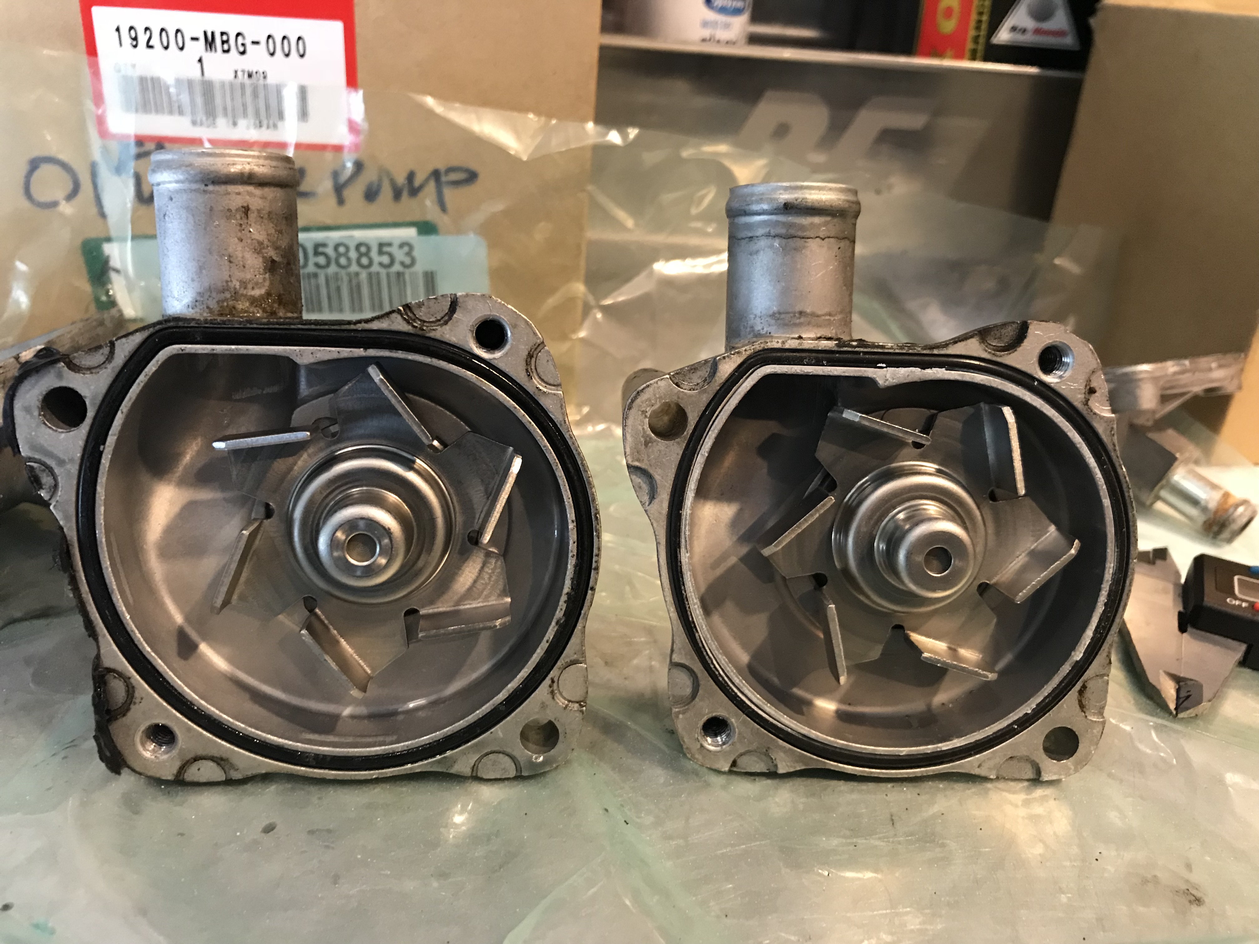

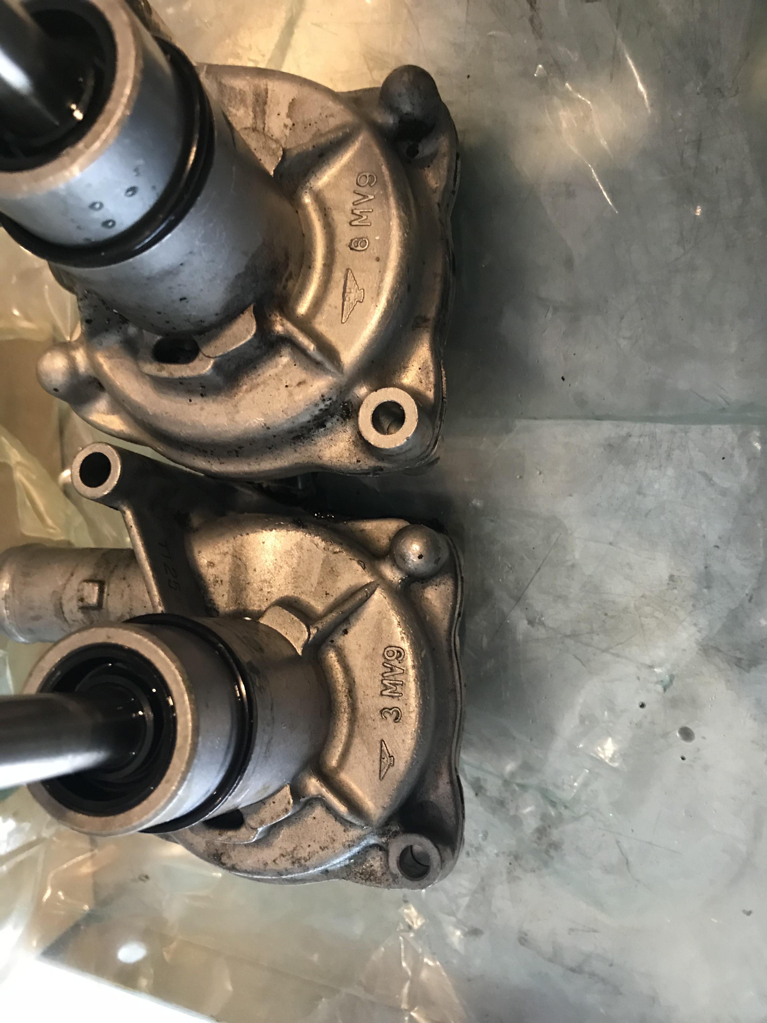

0 Member Contributer Duc2V4 Posted May 29, 2021 Member Contributer Posted May 29, 2021 I'm 99% sure I made the swap, perhaps more than once. I think the first time I went from my 5 Gen to my 6 Gen after the 6 Gen blew out it's WP at the track. Here are some pics of the two. Don't ask me which one is which because I forgot to document that. So if you can't tell, I don't think your bike will either. 😉 1 Quote
0 comradeQuestion Posted May 30, 2021 Posted May 30, 2021 The housing of the one on the left does look ever so slightly larger, though it could be the angle of the camera. Thanks Duc, I think that's about as definitive as I could have hoped for. Quote
0 Member Contributer Duc2V4 Posted May 30, 2021 Member Contributer Posted May 30, 2021 3 hours ago, comradeQuestion said: The housing of the one on the left does look ever so slightly larger, though it could be the angle of the camera. Thanks Duc, I think that's about as definitive as I could have hoped for. It fit, so had to be looks. 🙂 Quote

0 Member Contributer JZH Posted June 2, 2021 Member Contributer Posted June 2, 2021 On 5/31/2021 at 12:30 AM, Dangeruss said: It could be down to something as minor as a different bearing or seal material, thicker cover O-ring etc. I am surprised though that the NLA 5th gen number doesn't supersede to the 6th gen number. Not sure about Honda, but Yamaha do this if it fits. Yes, Honda does that, too; the "MV9" visible on the outer housings in the photos above refers to the 1992 CBR600F... Ciao, JZH 1 Quote
