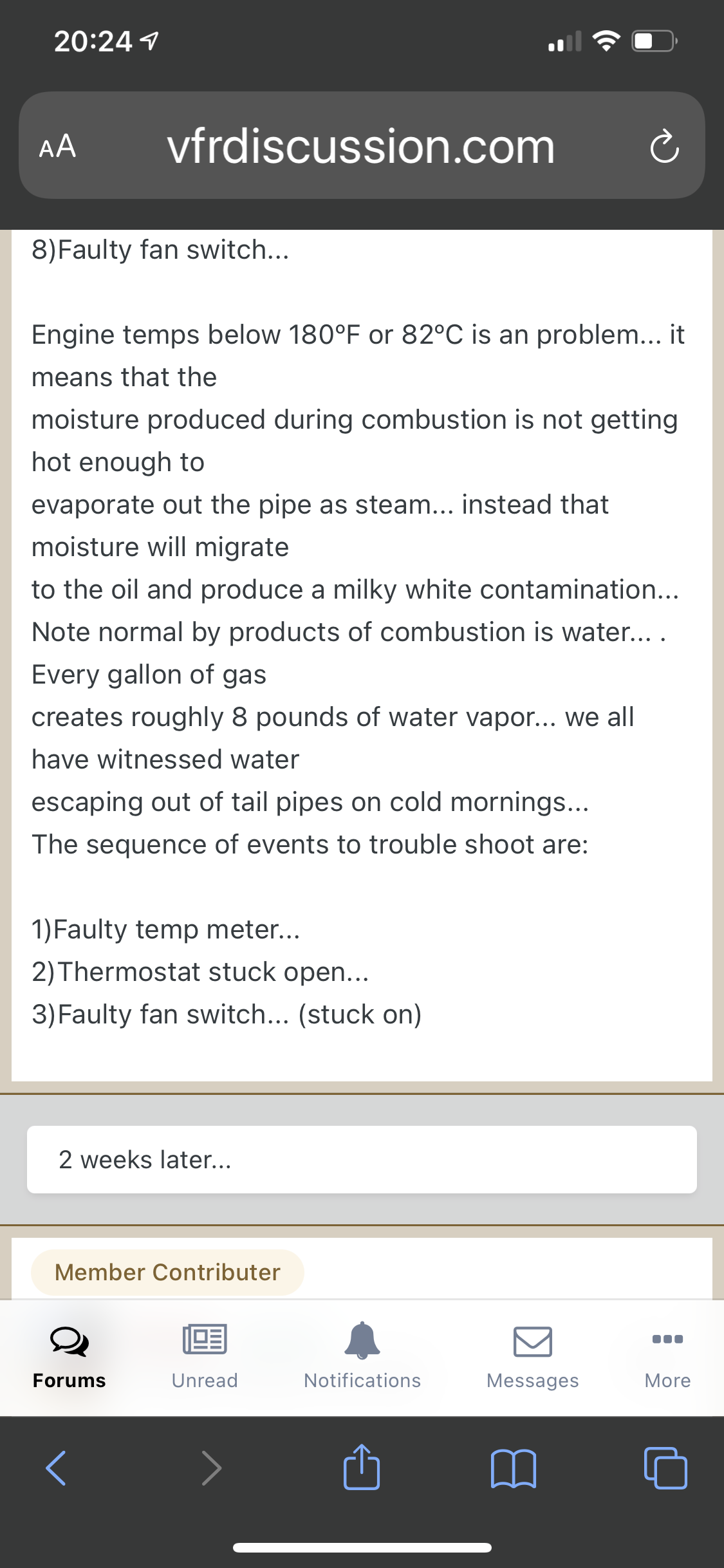

Member Contributer Bikespod Posted April 3, 2021 Author Member Contributer Posted April 3, 2021 Searching through other posts I found something that rang a bell. When I bought the bike I remember it had a slight milky deposit in the oil window. it disappeared quickly and hasn’t returned but......it’s all starting to point to a thermostat that is stuck open. poor mpg, rads warming too early, low running temperature, and now this ⬇️ Quote
