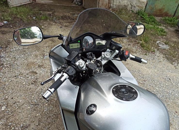

I went to see a 6th gen in my city and it was in good condition, but one thing that caught my eye was that the tank logo was different, like the ones on the new 1000 cbr's.  I asked the owner about it and he said it was becouse it's a JDM version (Japanese Domestic Market) as he checked the VIN. I didn't get the VIN myself thinking I will be able to find the info online, but I can't seem to find any information on google or here about JDM versions of the VTEC or even liveries and color versions over the years.
Does anyone know if this is really a JDM version and are there any differences other than the tank logo? I'm guessing emission regulations would probably be different so might have something different with the PAIR or something? I'm in Europe btw.

Ha, yr right, it is a 6th Gen tank. For some reason, it just didn't look right.
My bad.
Could it be a USA import then?

The pictures and the light are very strange on the photos, maybe that's why. Tank seems bulkier right behind the triple clam for some reason and now I notice it doesn't have the typical HISS and Unleaded Fuel Only stickers on it.

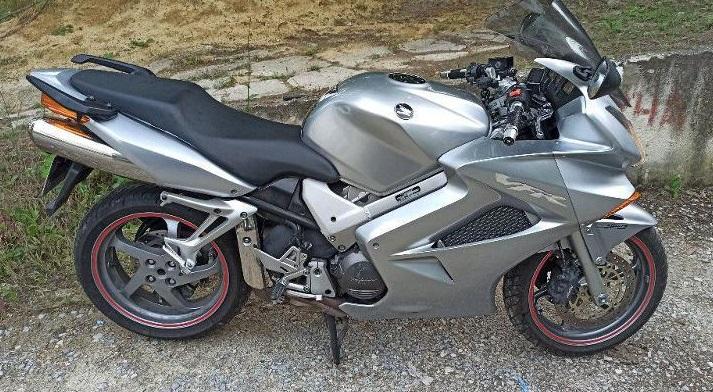

Personally it looks to me like the JDM thing he tossed out at you is to throw you off the track of either repairs or mods (or both) made to the bike.  Nothing wrong with either - plenty of us have done one or both.  The troubling part of it is that IMO he's not coming clean with you.  If what he says is true, then my next question for him would be "may I please see the paperwork"?  If he has none, I'd just move on to one I could be more confident about.

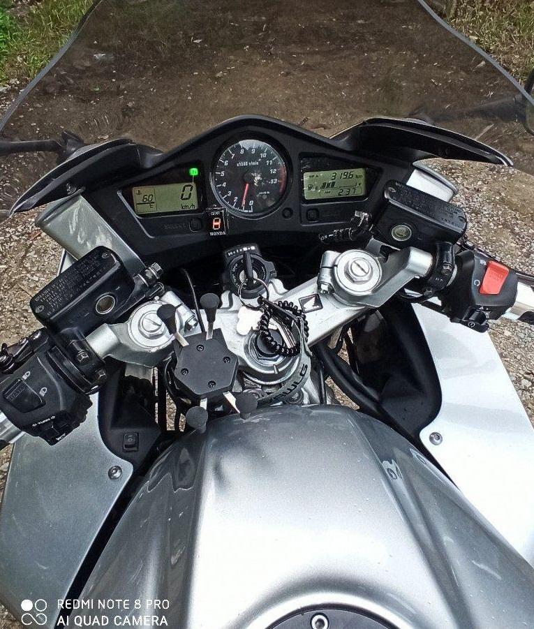

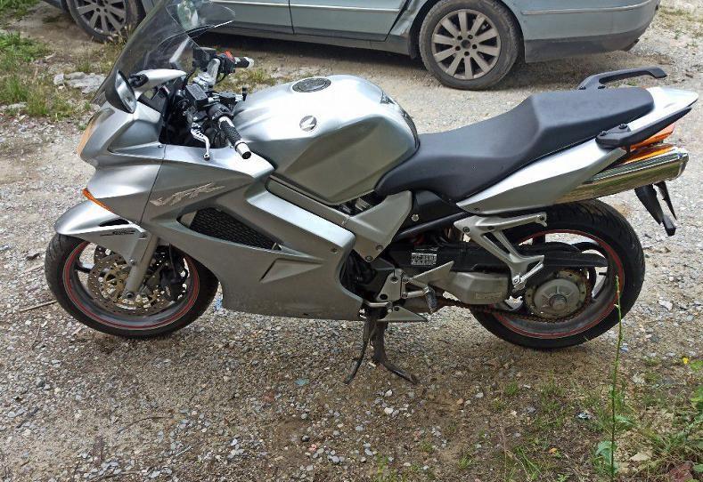

That bike is 100% a dropped bike that has been repaired with cheap Chinese fairings and most likely a resprayed tank with a newer Honda emblem.
The paint on the front fairing doesn't match to the side panels (regardless of viewing angle it should be much closer), nor do the panels beside the gauge cluster fit like proper OEM.
Highlighted below are what are signs of Chinese fairings
This is also most likely the reason it has different bar ends and grips. Another thing to note is that the front peg scrapers are much shorter than they should be. They usually break off when the bike has been dropped.
I would say this is a very dishonest seller and to stay away. Either that or the person he sold it to lied to him and he is passing on the same dishonest information.

Another tell-tale sign that this is a a respray/chinese fairing replacement is the VFR logo was installed on the wrong angle
IMHO, because this guy is feeding you the Bull, i'd just walk away from it.
