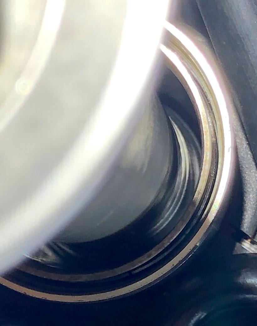

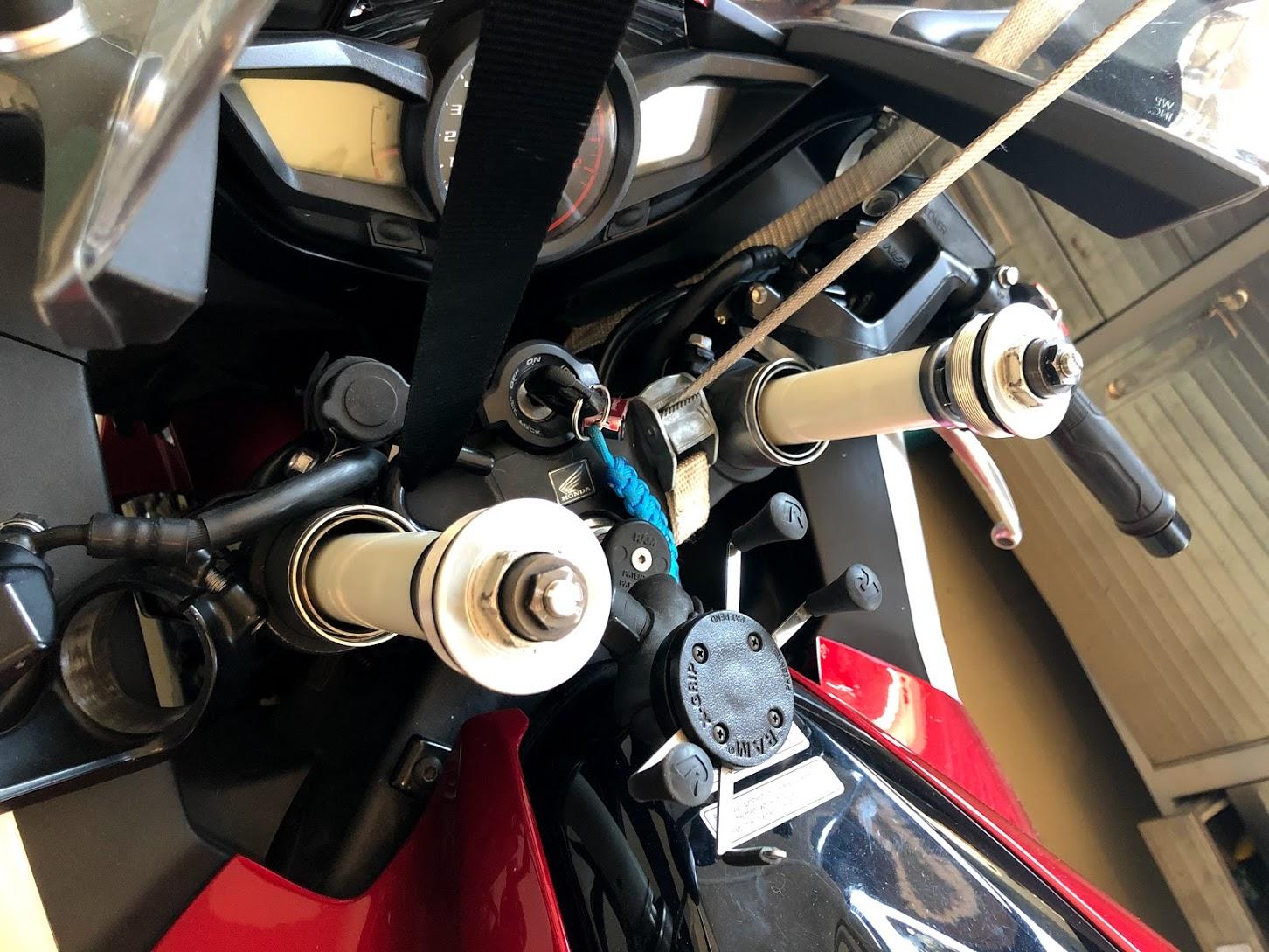

Vlad Posted April 8, 2020 Author Posted April 8, 2020 status update. so I unscrewed the top caps, bike tilted forward to max compression of both shocks. I don't see any oil in the tubes looking from top and though I can only see & reach about 4" deep (~10cm) with a thin plastic tie-down, before it gets stopped by something. See attached images. Looking through the manual (pages 15-27, 15-28) it looks like they do 160mm oil measurement BEFORE plastic collar and spring are installed. I'm thinking about attempting to remove plastic collar and the spring while still having shocks installed on the bike. Anyone sees potential problem with this? Other ideas? Quote
Member Contributer Terry Posted April 9, 2020 Member Contributer Posted April 9, 2020 I have taken the caps and springs off my VFR800 while the forks were installed. Not really any different from doing that with the forks removed except there is a motorcycle in the way and the tubes are not truly vertical when setting the oil level. Obviously the springs are under compression so take care when you get the caps off. I stick a screwdriver at right angles into the spring and wind the spring up/out on the screw driver. Helps the oil to drain off nicely inside the leg. When you check the oil level make sure the forks are fully compressed with the springs out. I assume when you do this you will have pulled the rebound needles right out; when you reassemble, it is important to fix the cap/locknut in the right position on the damper rod, otherwise the adjuster may not be able to move the needle through the right range. I tighten the rebound adjuster down to fully in, then screw the cap on until the needle LIGHTLY bottoms out. Now hold the cap in place and back the screw out 1/2 turn, and tighten the locknut. Quote
Member Contributer RC1237V Posted April 10, 2020 Member Contributer Posted April 10, 2020 Yep, sorry, I keep doing it to add fluid, but yes, need to remove the spring, spacer, spacer washer, and top adjuster (manual calls it the fork bolt). The 1200 manual also states that when you re-install the rebound adjuster, to back it off all the way, counter-clockwise. Also if the pre-load is all the out it will be easier to engage the fork caps. Quote
Vlad Posted April 13, 2020 Author Posted April 13, 2020 ok, I ended up removing shocks off the bike as I could not figure out how to press down the white plastic collar inside the shock to disassemble, with shock on the bike. Indeed I had too much oil; removed 35ml + 65ml, measured 160mm off the top edge when compressed. Now ride is back to normal. Thank you all for all the help and advises. Quote
