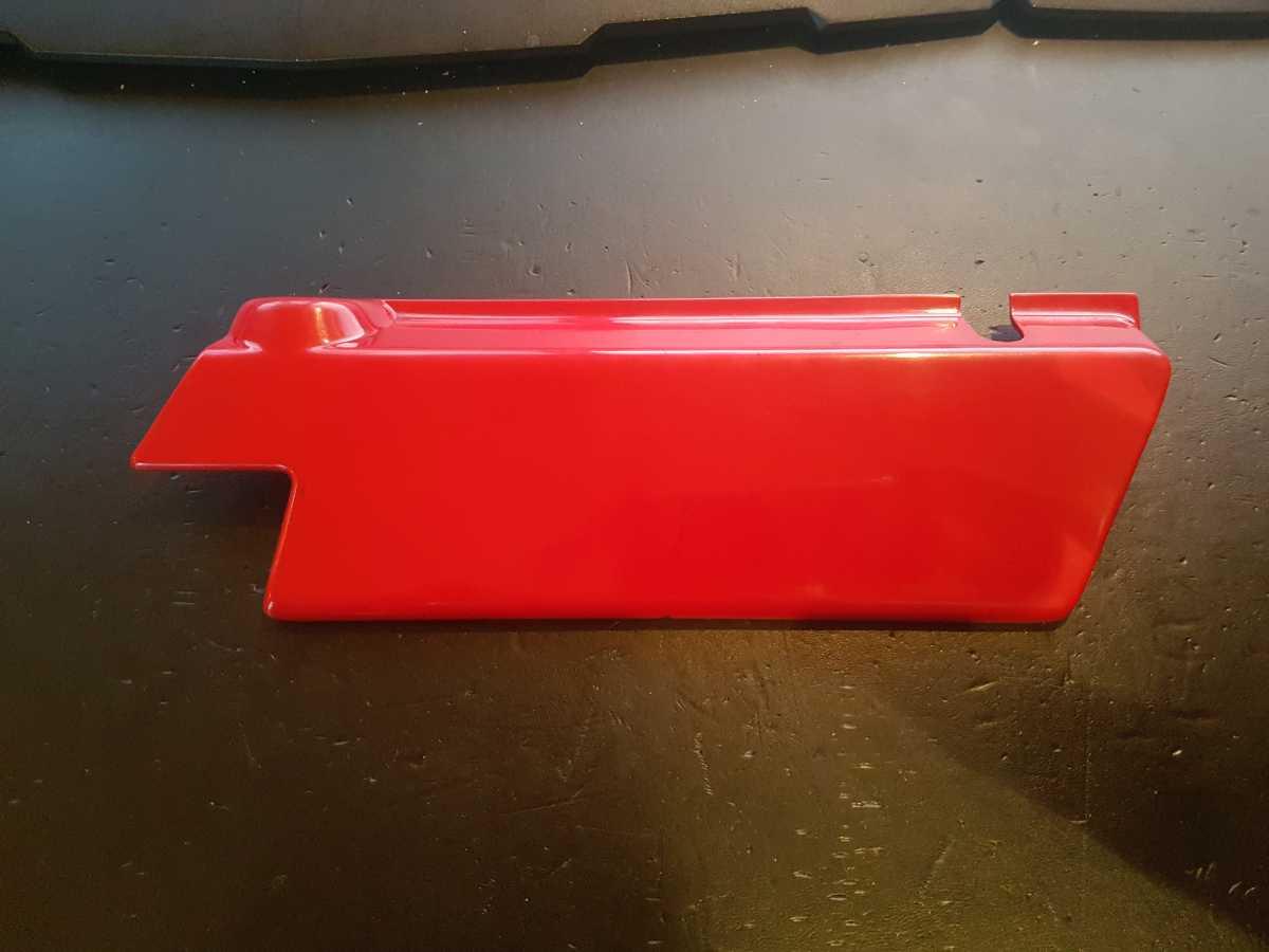

I have an old R-157 one with buggered mounting bosses.  Let's see if I can find it...

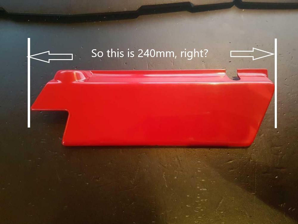

I'd be happy to send it to anyone who would make a 3D printing file of it to share with the group.  It's just under 240mm in its longest dimension.
Oh. John. Excellent. Thanks for the pictures. I have access to a printer that makes bits up to about 10 inches. This would work. But it only makes PLA prints, not ABS. So, not great. PLA is like leftover corn stalks. Not the best material for this sort of thing. More on that here:
https://www.3dhubs.com/knowledge-base/pla-vs-abs-whats-difference/#what-are-abs-and-pla
Anyway, to be clear, it's about 240mm long, like this?
That would make it about 60mm wide. The angled bit looks to be 22mm max. It seems to me my sidestand has two screw holes, so it must attach from the back. That might be tricky. Still, how hard can this be? I'd be inclined to drill the mounting holes in the homemade piece and just live with two more visible fairing bolts.
A 10 inch scrap of extruded aluminum or steel or maybe even a leftover corner chunk of tv set cabinet and you're done. 20 minutes. EZ peazy...  😉
(file pic)
...well, okay, maybe a little longer than 20 minutes...but totally doable... I have to think a bit.
(Ed. Oops. I've been privately...if unofficially...notified that I am dangerously close to hijacking this thread. Apologies to Auspanglish for the breach of protocol. I will continue on my own thread if I proceed with this little project.)

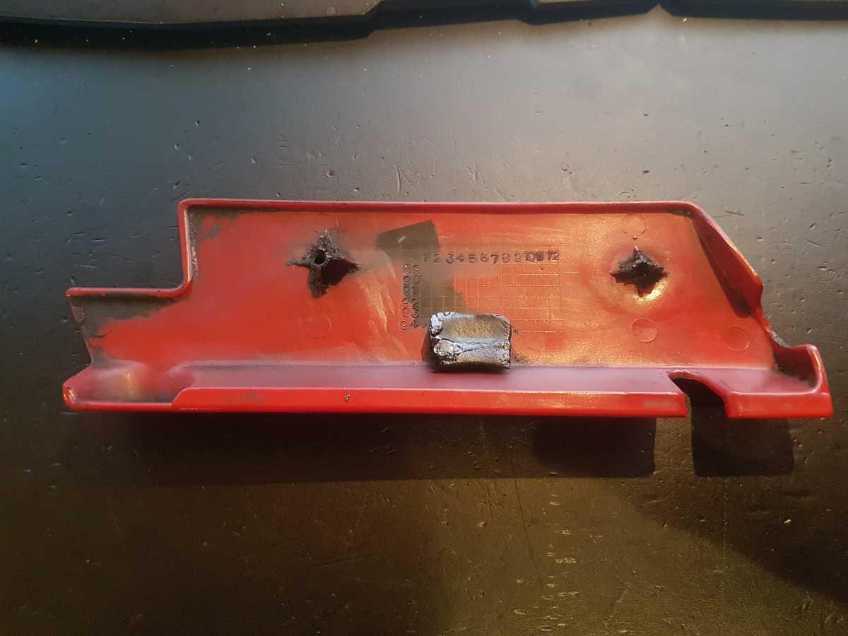

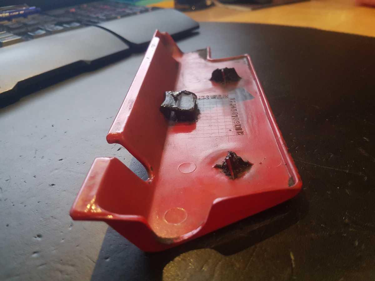

Yes, 240mm in length.  It originally mounted from the back, and those two mounting bosses used to be not half-corroded!  Unfortunately, it is a very complex shape, as you can see from the first picture above--well beyong my capability to model.  I think it would have to be scanned or fiberglass-molded.
I agree. The shape is complex and a proper copy would have to be scanned and molded or printed in ABS or fiberglass.

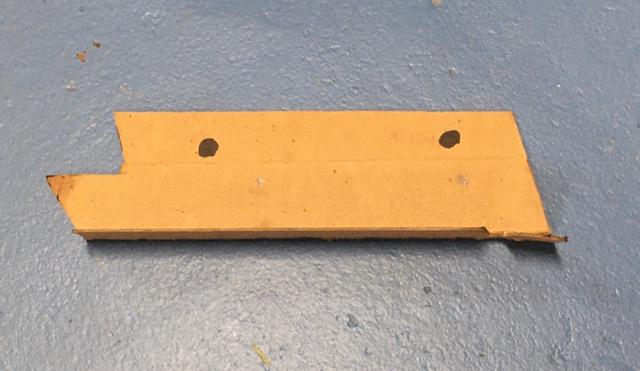

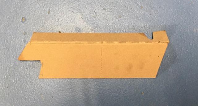

But that isn't stopping me from playing with a crude replacement. I cut out a cardboard copy from my guesstimates of the dimensions from your pictures.
And I think I'll try to make up a prototype from a scrap of PVC fence post when I get a chance. The PVC might be sturdy enough to work down there on the kick stand. I don't know how Honda ever expected the ABS covers to hold up in that location. I'll post progress on my own thread.

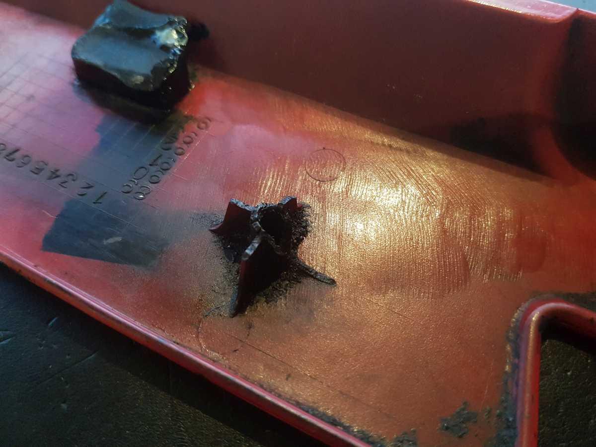

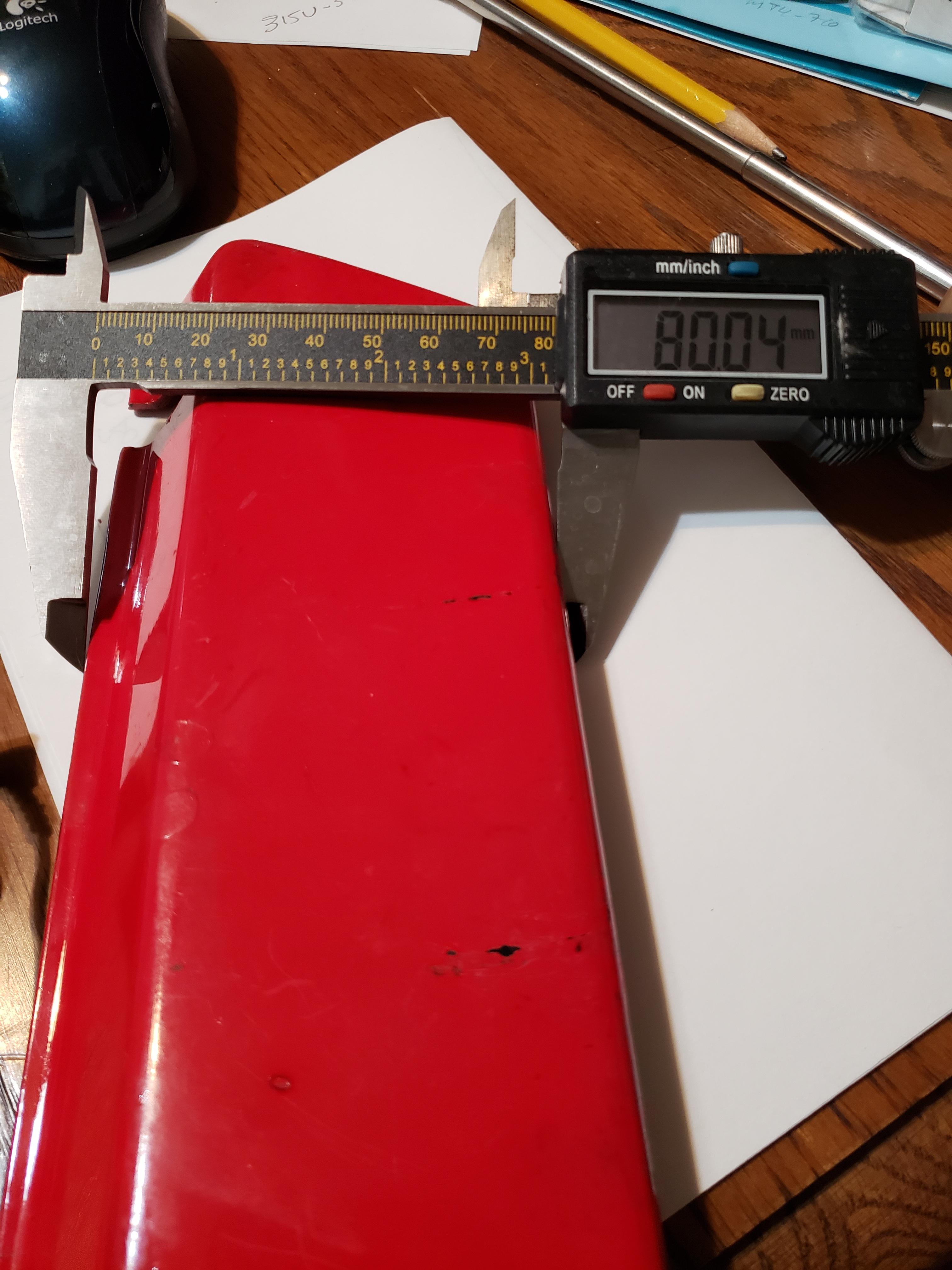

Upper boss = 18.8mm tall
Lower boss = 16.8mm tall
Both bosses angled slightly toward flange
80mm wide
I could make some, but it would not be profitable....the previously mentioned 3D printing would probably be the best....and beefing up the bosses would help too!
Upper boss is 24mm from edge and lower boss is 26.75mm from edge. Bosses are ~108.5 center to center
Thanks for the additional pictures and dimensions. The 3D file is the way to go. Thurn's price of 59 euros is a lot. But it's reassuring that somebody bothers to makes these available at any price.
Your pictures make a few things more obvious. The angle between the two primary faces is greater than 90 degrees. Maybe 120 degrees. And that dimple that covers the sidestand bolt will not be easy to replicate. The bosses are a problem too. I'm guessing that broken bosses are a primary point of failure on the originals. It'll take some tweaking on my cardboard prototype. I'll continue my own development on a separate thread.
