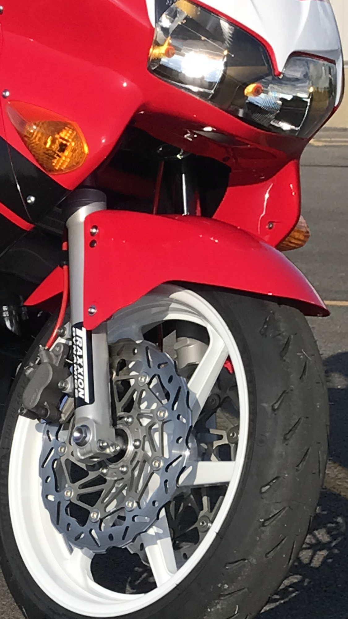

There is no “bolt-on” frontend, no matter what anyone says. You’re simply not going to directly replace one frontend with another, without other modifications and retrofits.
The easiest 5th Gen setup follows: F3 lowers fit VFR uppers. VFR front master cylinder works with F3 calipers. VFR front wheel, rotors, axle, and spacers work with F3 lowers and calipers. VFR fender requires simple brackets and spacers to mount to F3 lowers (F3 fender may direct-fit, but, I didn’t have one). F3 hose length works. Remove center piston of rear caliper, drill a hole into the fluid transfer passage for the outer pistons, and reinstall center piston. Plug center piston feed hole with a banjo bolt and crush washer. Replace rear master cylinder with a Honda 14mm version found on various CBR sportbikes (some finagling of the clevis may be required to mate to the VFR pedal). If you want brake light activation from the rear pedal, you’ll need to use a banjo bolt pressure switch. A single, VFR rear brake hose will work. Every single component mentioned should be completely rebuilt with new seals, fluids, etc, and new braided brake lines figured in, as you’re working with 20yr-old stuff.
USD forks are overkill on the VFR, as they’re much stiffer and ride harsher because of that. The original forks are able to flex and absorb impacts, road chatter, etc, which takes the edge off bumps and is much more comfortable in the saddle. 5th Gen forks are the same forks as the early SV, which are being raced by countless riders around the world at a much faster pace than anyone on a VFR. A GSXR frontend (USD) and brakes aren’t worth a single second on any race track, on an SV, per a multi-time national champion who races them. Therefore, swapping a similar USD frontend onto a VFR doesn’t make sense, if one is actually looking for overall performance. Plus, the USD frontend and required de-link are going to cost more than one initially thinks, because there are all the unforeseen things, like missing/misfitting hardware, unexpected leaking seals, higher-than-expected component costs, and so forth. Lastly, just bolting on components isn’t going to magically transform the bike. Without springs, valving, correct settings, good brake pads and lines, good shock, proper geometry setup, etc, it’s just stuff bolted to a bike.
Now, someone is going to come along and call “bullshit”, with what I’ve just said. And, they’ll put in their 2¢ why you need USD forks, 6-piston brakes, etc, when you’re not actually exceeding the component limits of what you already have. A simple de-link and investing in optimizing most of the existing components will be more beneficial than just throwing stuff at the bike for the sake of bling.
You’re welcome to come ride my bike, which has good front and rear components for everything, along with geometry changes, if you’re doubting me. The last to ride it, a 6th Gen owner, called it “Amazing!”. If life works out, I’ll be at the NC get together.
Let the flaming begin. 😁
This is my setup.

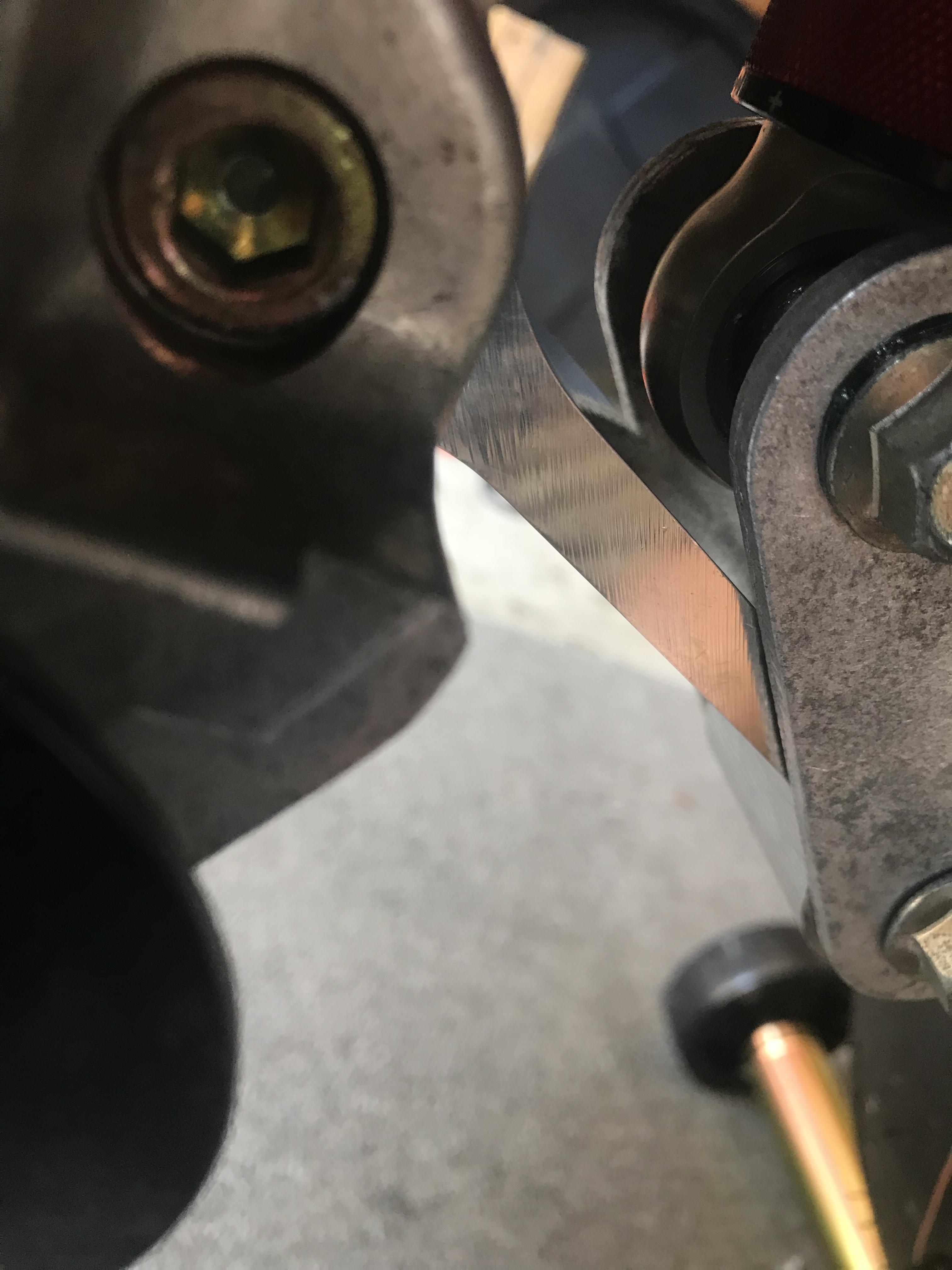

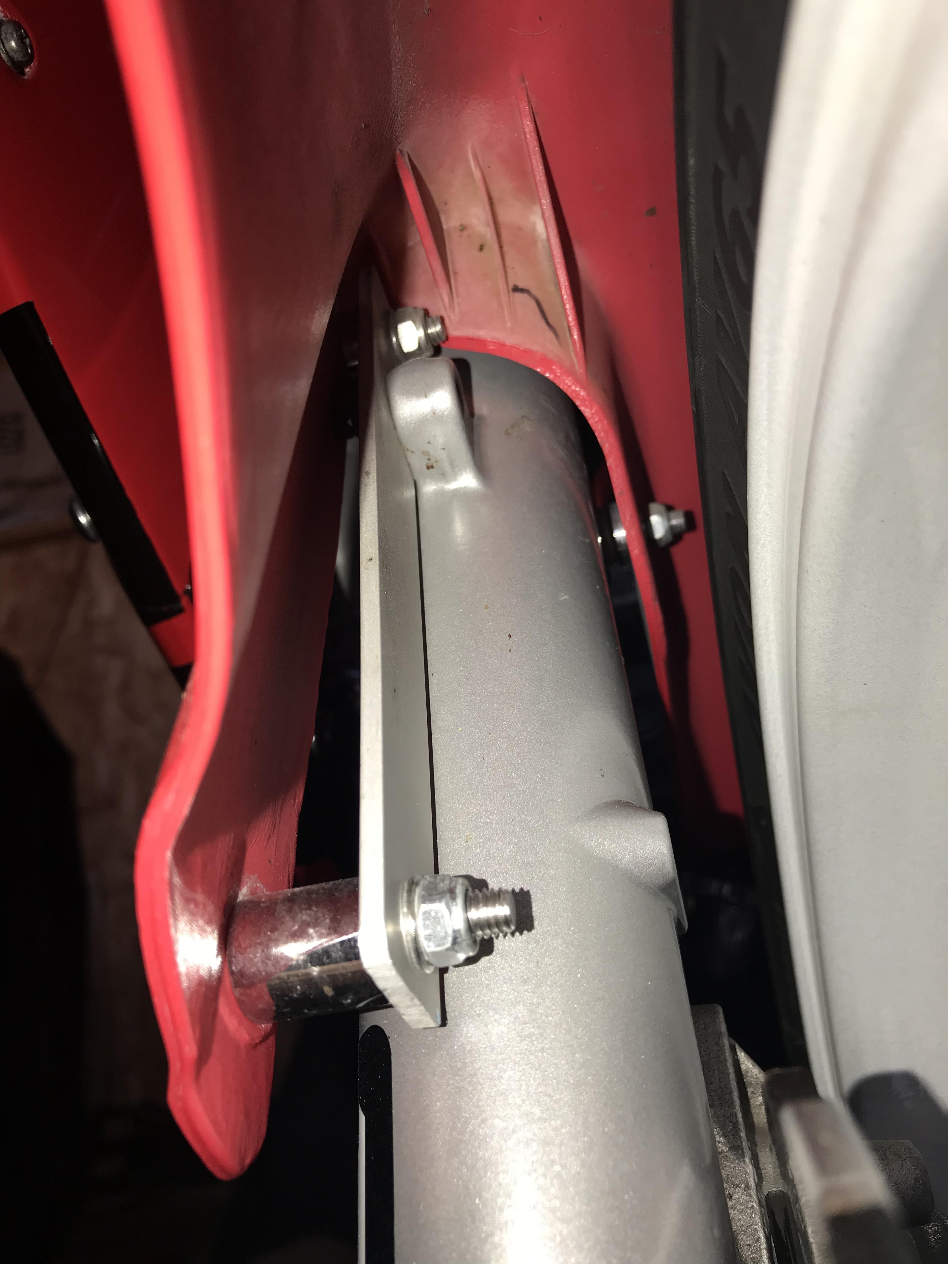

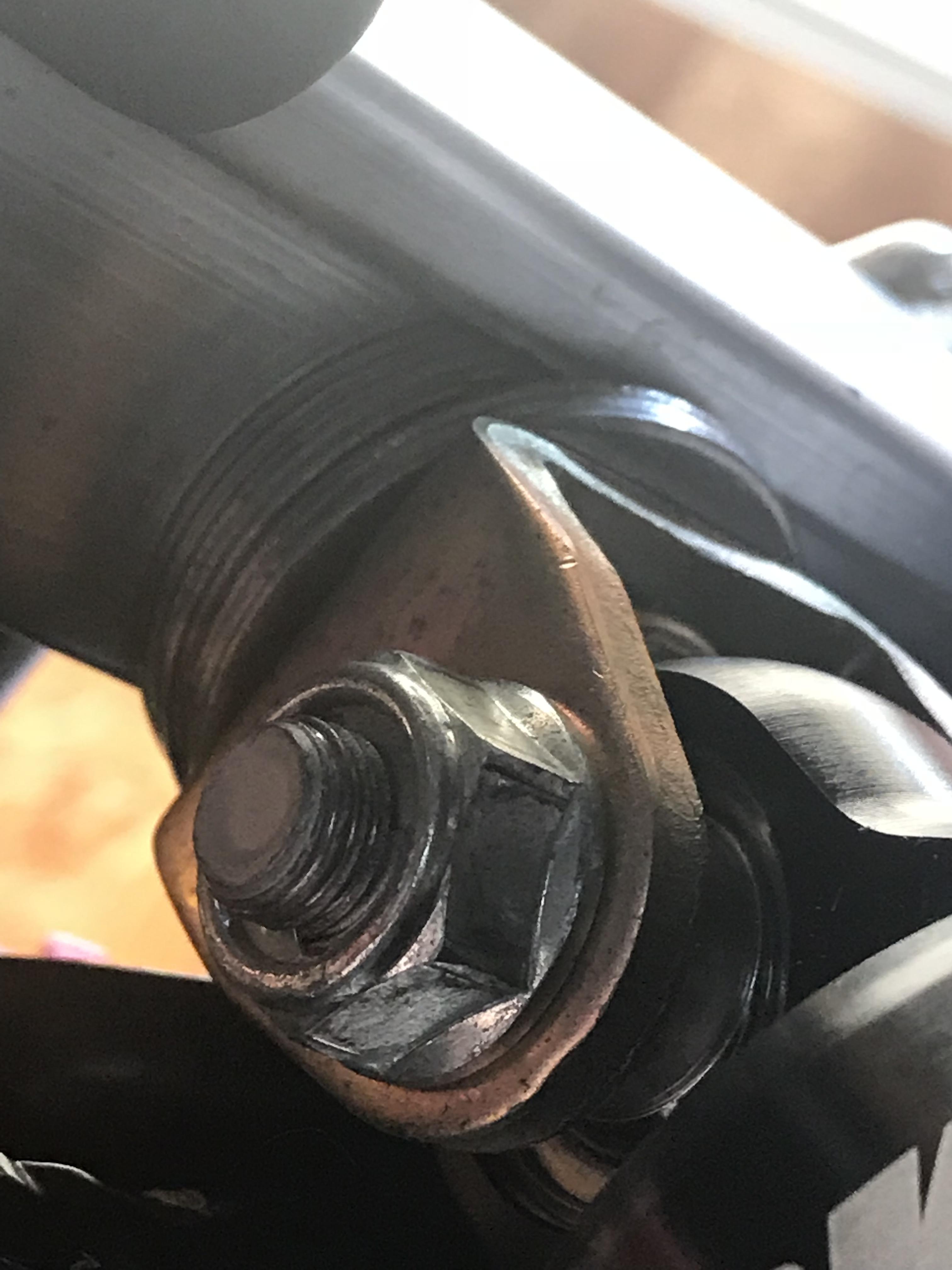

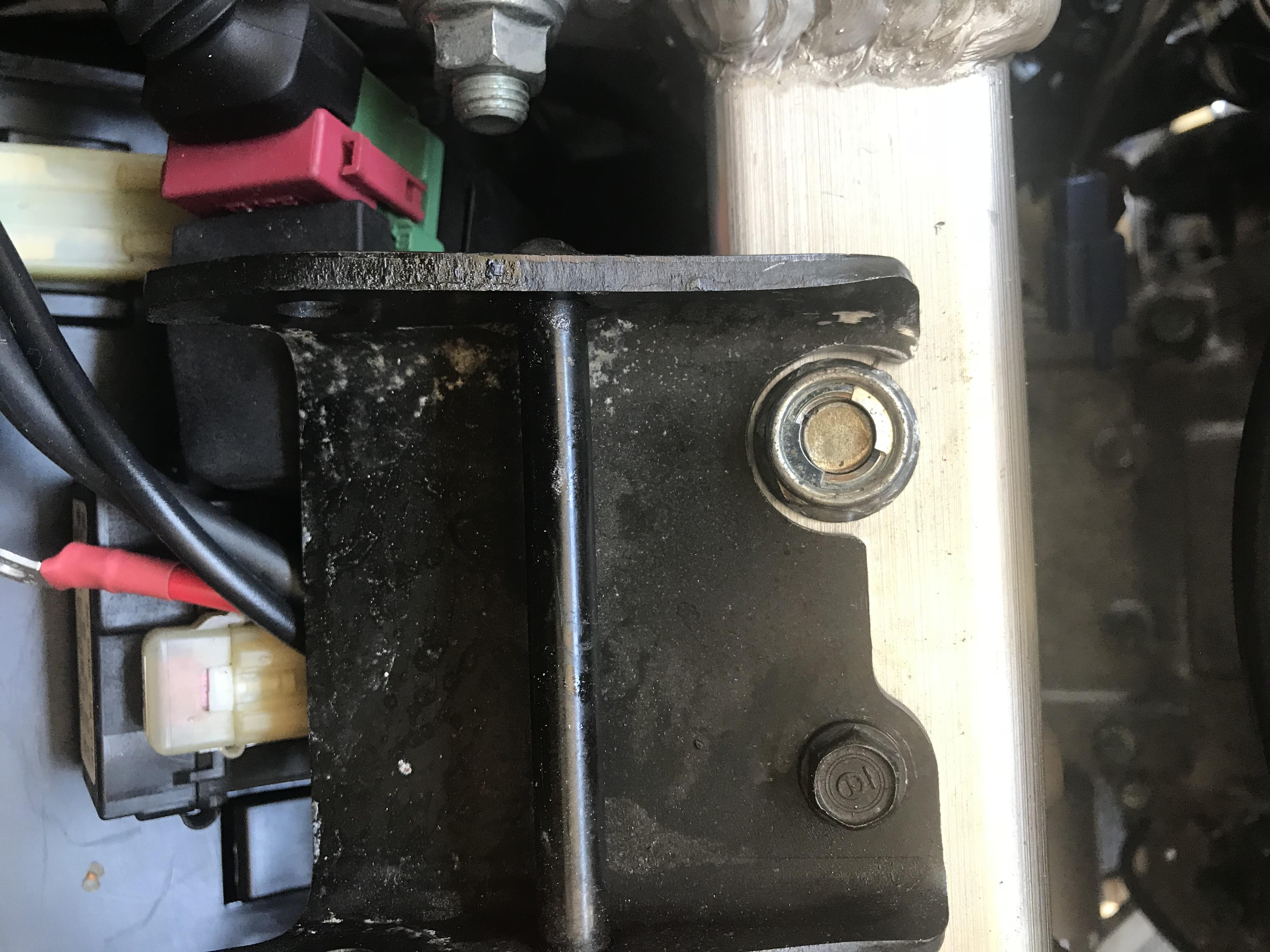

If you’re OK with the linked brakes, just do straight-rate springs, aftermarket valves, and oil set to the correct level. Any good supplier (RaceTech, Traxxion Dynamics, DMr, etc) can send you everything set to install, with guidelines. The fork internals will work with most de-link options (they’re all Showa of the same design), so you’re not buying everything again, should you go that route.
For shocks, the most affordable option, that can be serviced by about anyone, is a Wilbers. If you have the budget, a Penske 8900 is a great option, as well.  I’m not completely sure of what your options are in your location. Whatever you get, you want something adjustable-length. That’ll allow you to raise the rear ride height, which will get the bike handling more nimble. You can shim the rear clevis, by stacking washers atop it, to gain rear ride height. But, you can only go so for, before fabrication work comes into the picture. That’s why I suggest adjustable-length. Finally, I’m not a fan of shop-branded shocks, because if they go under, the owner dies, they change product lineup, you’re going to be out, as far as servicing. No one will have parts. And, so much of the stuff is Chinese-sourced garbage with a shop decal stuck on it (I know a shop doing exactly that). Spend a hundred or two more and get something serviceable around the world, hopefully with the shock company having a dealer close to you.
Tires play a huge part in how your bike feels at the clip-ons. The pointier the front tire, the lighter the handling. Instead of just running what everyone else is, research front tire profiles. I always suggest a sport front tire (street sport; not a track sport) matched to that manufacturer’s rear sport-touring tire, for those wanting handling and good longevity.
In short, just jacking up the rear ride height and choosing the right tire setup will do wonders, for little money.

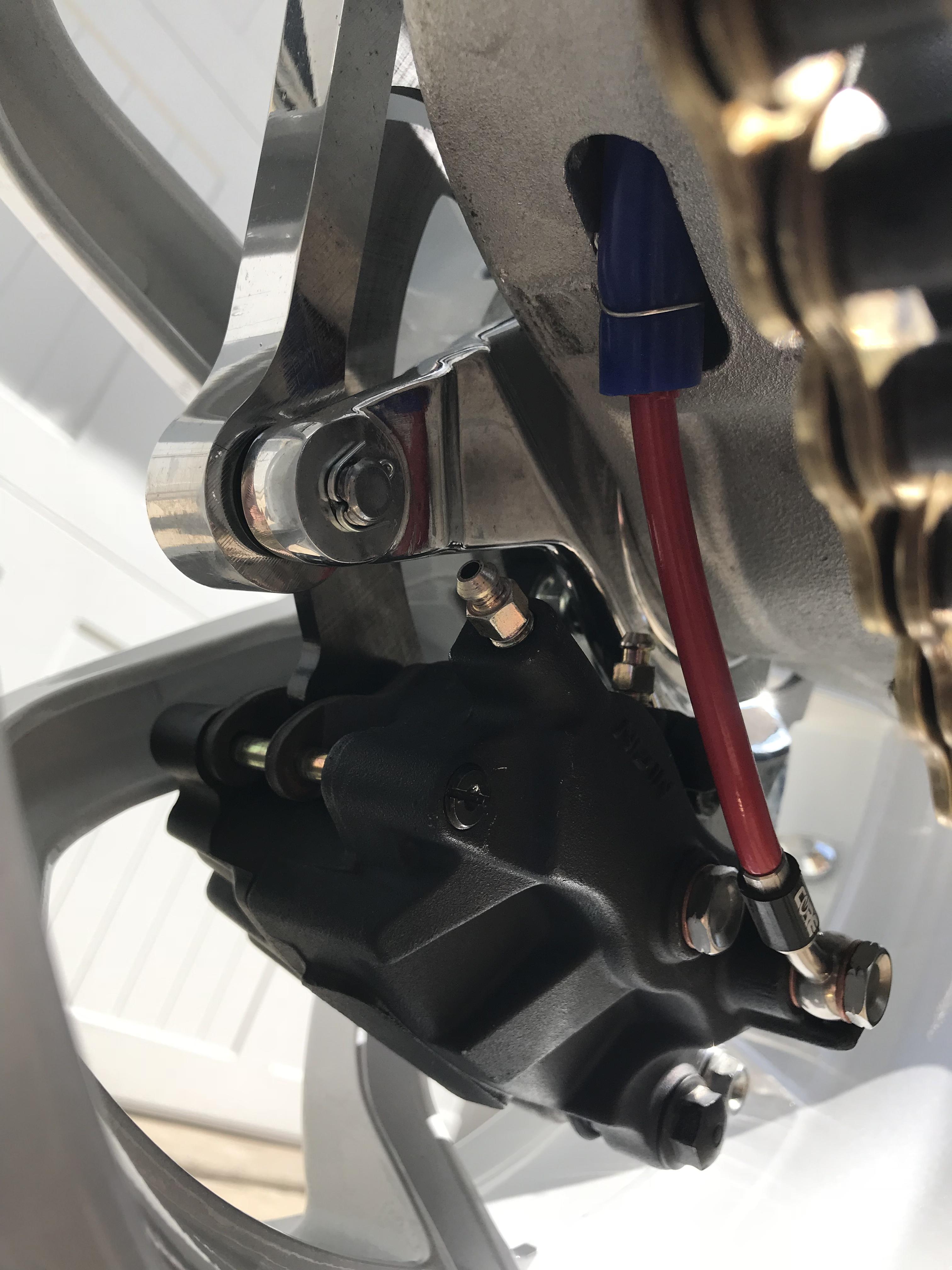

Pic #1 is showing the tank bracket drilled to gain more shim height.
Pic #2 is a shimmed clevis.
Pic “3 is showing the limit for rear ride height. The lower shock eye WILL hit the linkage if going too far.
