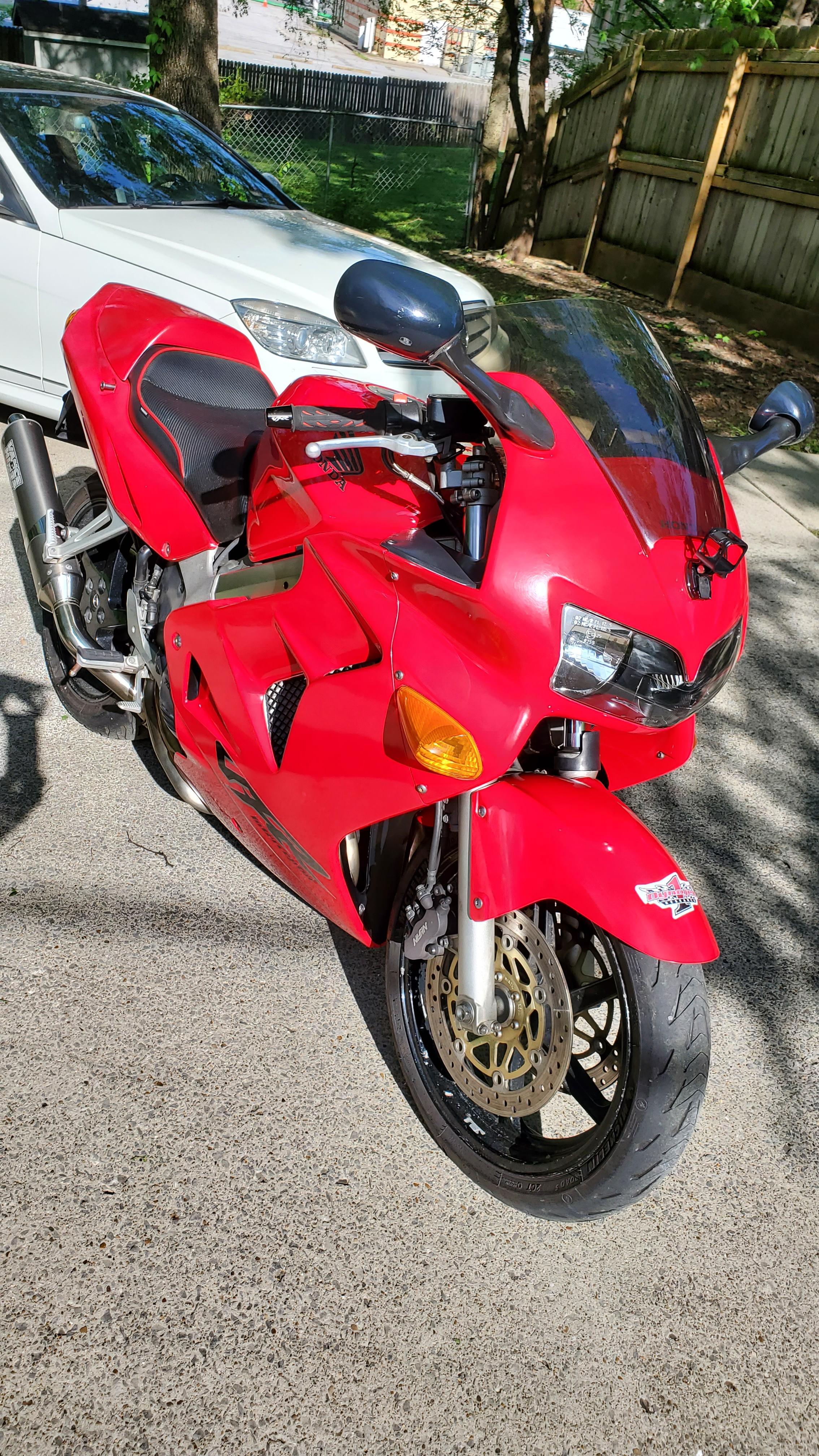

Member Contributer interceptor69 Posted December 26, 2019 Member Contributer Posted December 26, 2019 Recently replaced both my headlamps with halogens and they worked great for about 2-3 weeks but on the last ride of the year I went out to turn the bike on and they wouldn't come on. Does anyone know why that may be happening? I checked the fuse under the seat and it was fine. Quote

Member Contributer interceptor69 Posted April 13, 2020 Author Member Contributer Posted April 13, 2020 I'm embarrassed to say that the bulbs were simply burned out despite the fact they were only 2 or 3 weeks old. Before I called my buddy with the voltmeter to come over I decided I would at least pop and old one in that I still had the low beam working just to make sure they weren't burned out before he drove all the way here. Turned out that was a good move because that was all it was. I am now wondering if these old VFR's electrical system can't supply enough current or voltage to these halogen bulbs. Or maybe the heat got to them -I don't know because they were very hot- you could feel the heat on the headlight cover. I should have popped an old bulb in before assuming something electrical was kaput- the simplest solution... But thanks to everyone who responded to my post. Quote
