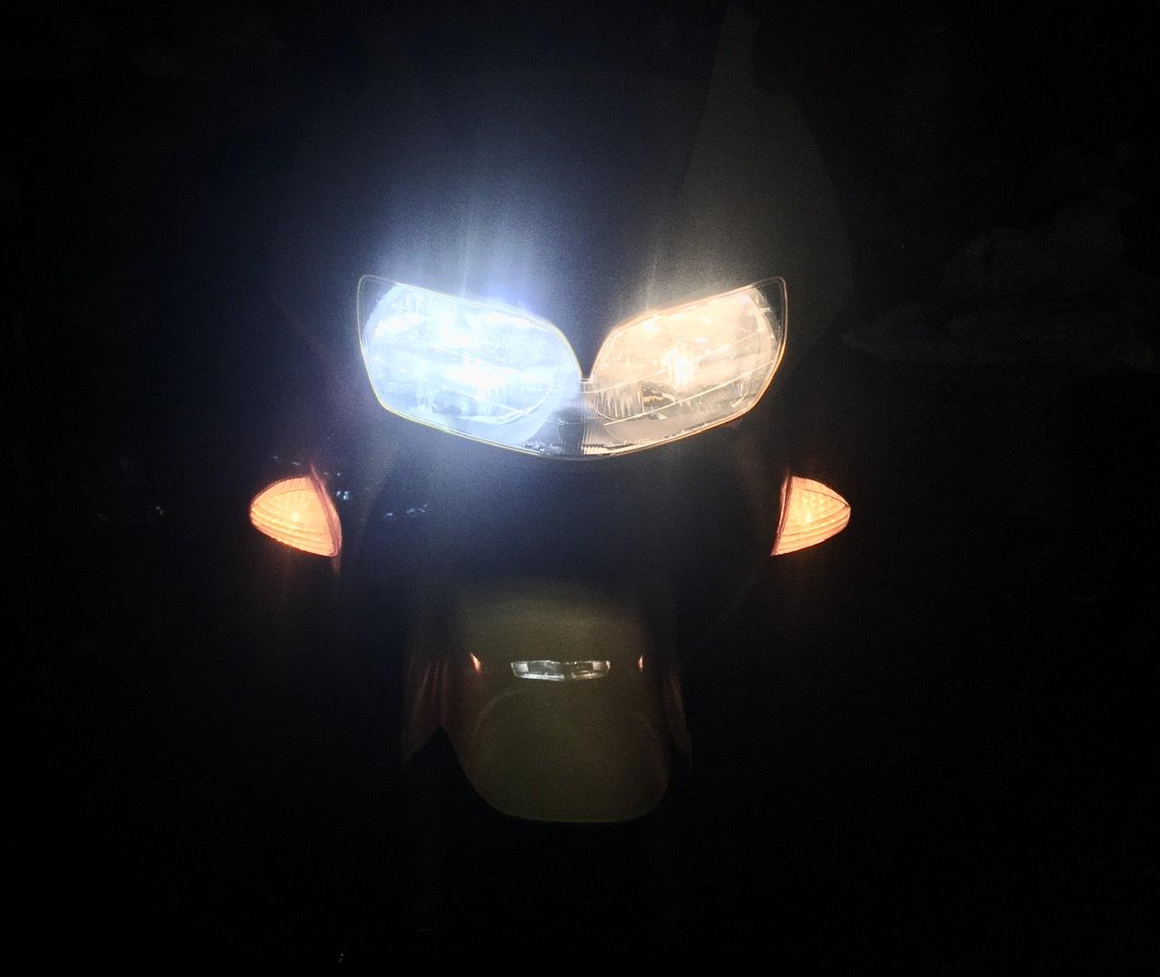

Member Contributer thereisnospoon Posted November 27, 2019 Author Member Contributer Posted November 27, 2019 sorry, i can't figure out how to make the image smaller. comparison between the halogen and led. Quote

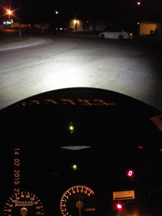

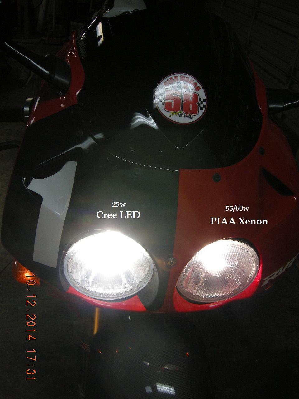

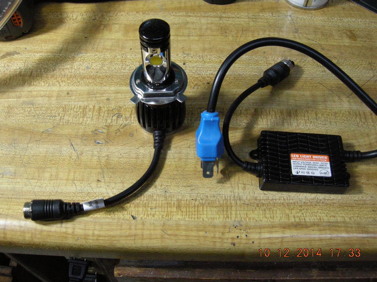

Member Contributer BusyLittleShop Posted November 28, 2019 Member Contributer Posted November 28, 2019 Out on the highway late at night... inky blackness is stealing your sight... you got halogen head lights and they ain't bright... your motorcycling by pale moon light.... On Mr.RC45 I replaced my PIAA 60/55 watt Xenon gas Super White bulbs that glow in the 4200 Kelvin range with Speed Metal's 25 watt Cree LED H4 with a working high and low beam... now I'm riding so bright I have to wear shades... I paid $69 each at Cycle Gear for the Speedmetal LED kit...http://www.cyclegear.com/SPEEDMETAL-LED-Conversion-Kit Quote

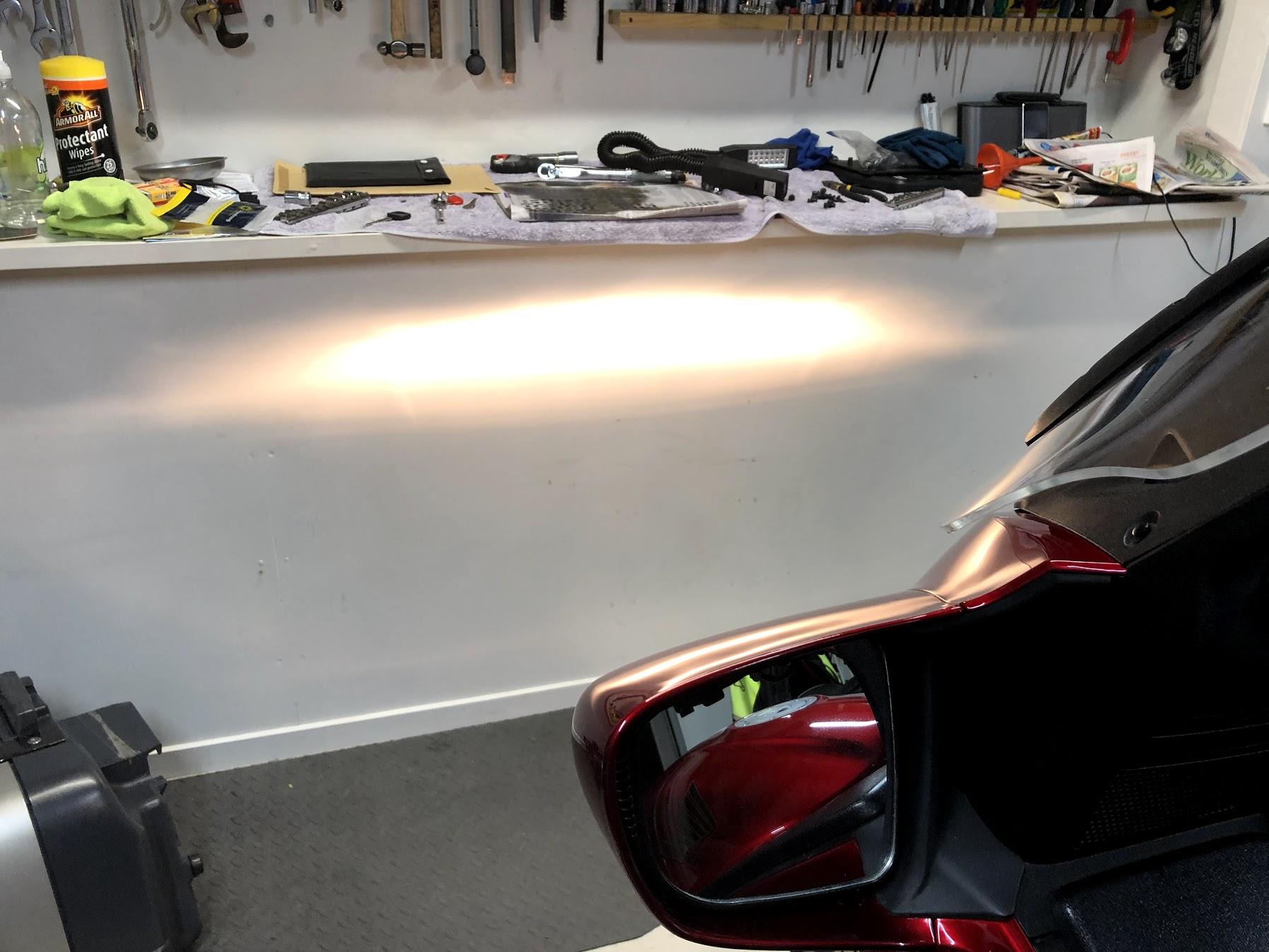

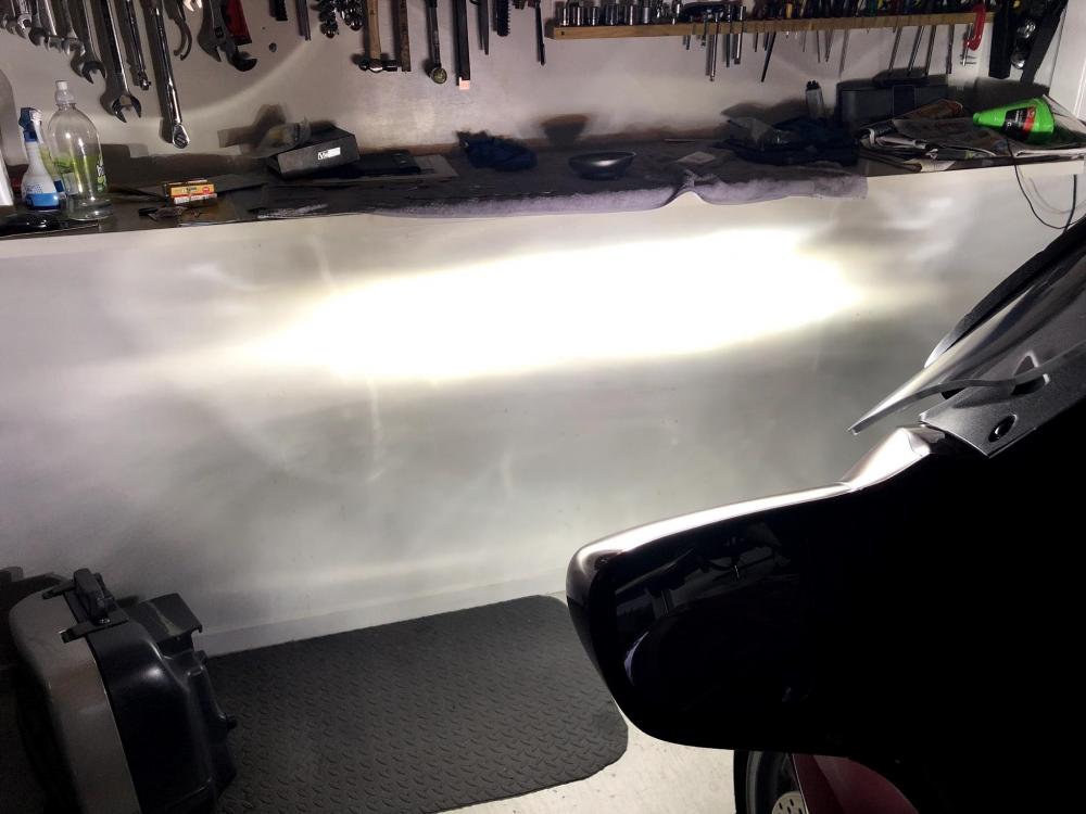

Member Contributer Terry Posted November 28, 2019 Member Contributer Posted November 28, 2019 The topic of "can I replace my weedy incandescent bulbs with more manly LED's?" seems to come up on every forum. There's always a keyboard warrior that leaps into type with "you can't do that, the pattern of the LED is different/the reflectors are designed for filaments/you'll blind everybody". To which I respond, shop carefully and buy LED's that position their emitters in the same location as the filaments of that old incandescent, and the reflector won't care where the light is coming from. Below are some comparison pics of low beam on my ST1300, first with the halogens, then with some no-name brand LED's from China. I like 'em. Sorry I didn't tidy up my bench before snapping the pics... 1 Quote
