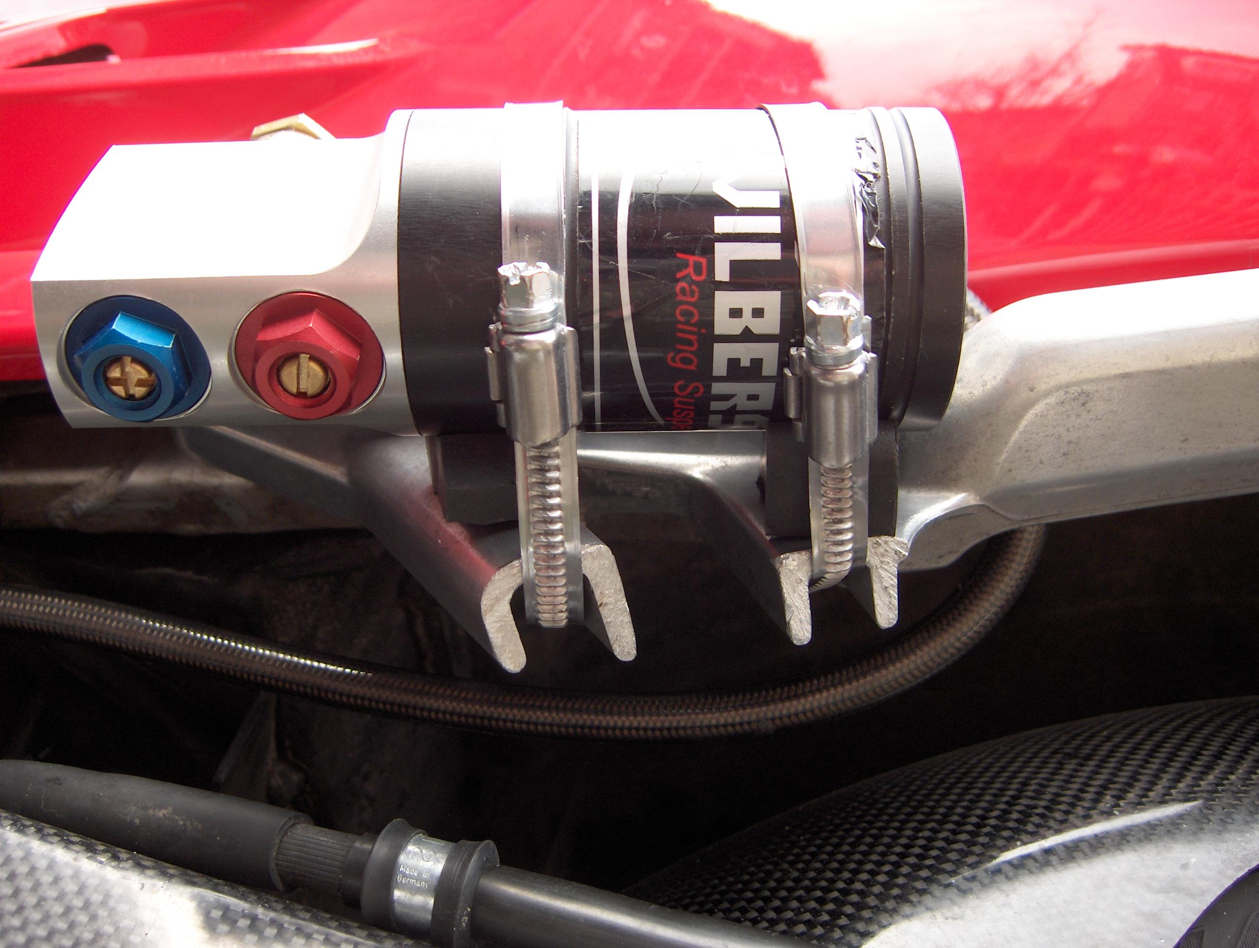

Member Contributer Terry Posted September 11, 2019 Member Contributer Posted September 11, 2019 Somewhere I may even have a copy of the original installation instructions! The reservoir was separated from the frame spar on some rubber mounts, and held in place with big hose clamps. Quote

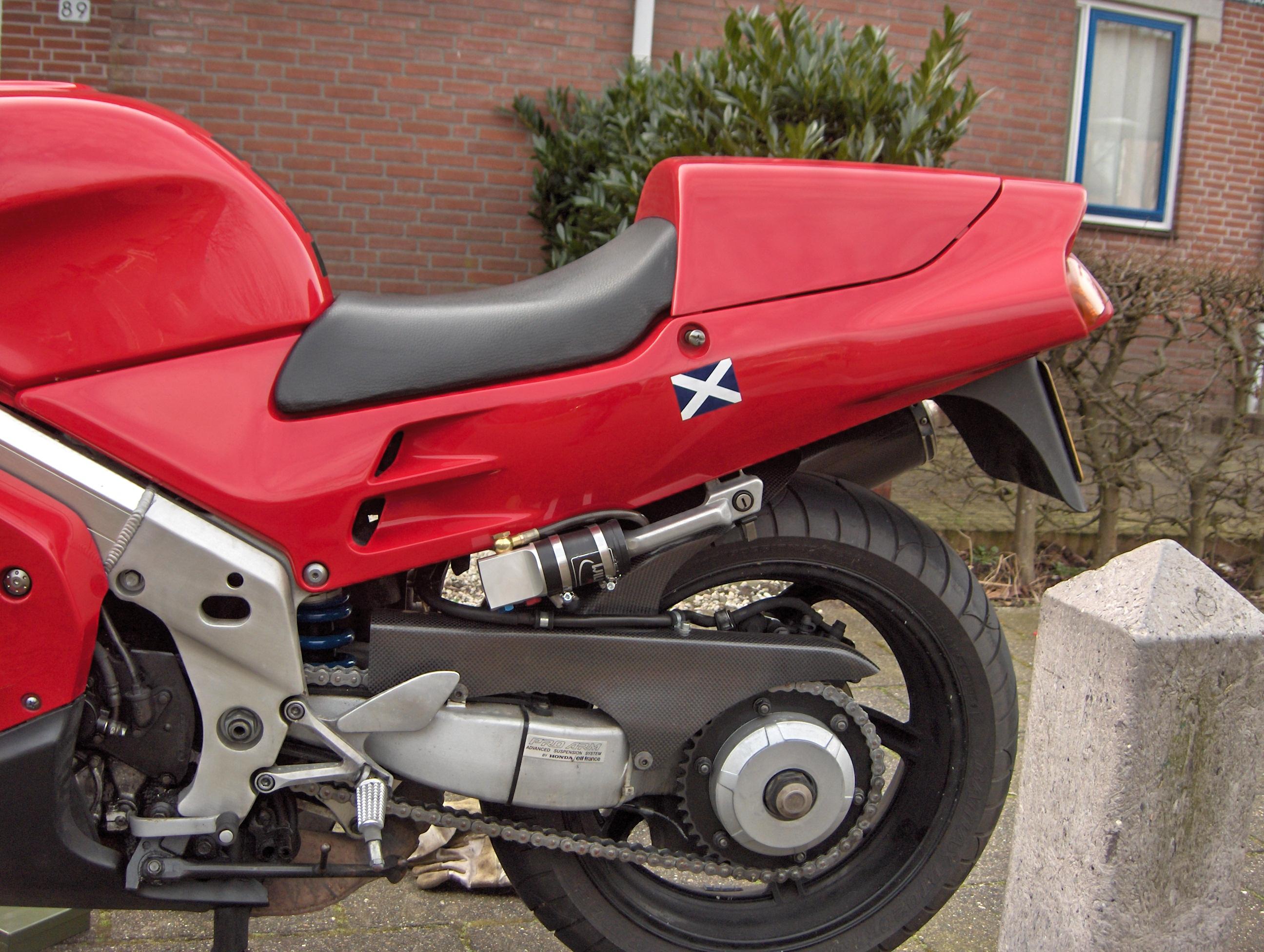

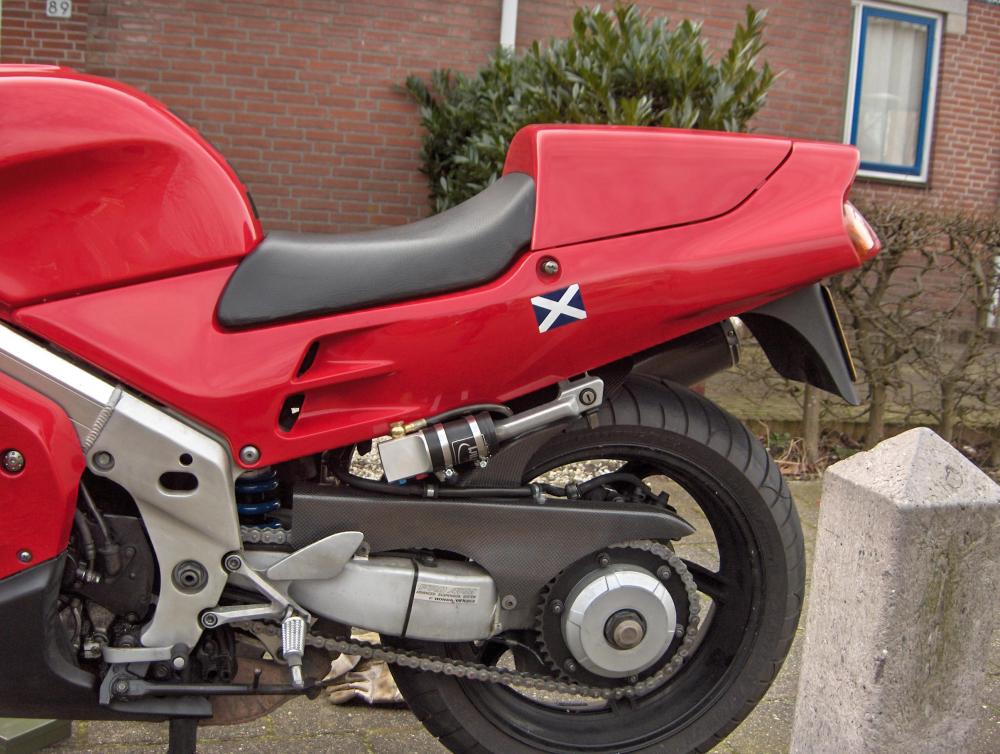

Member Contributer SamW Posted September 11, 2019 Member Contributer Posted September 11, 2019 Mine is mounted in the same location as the picture above. Quote

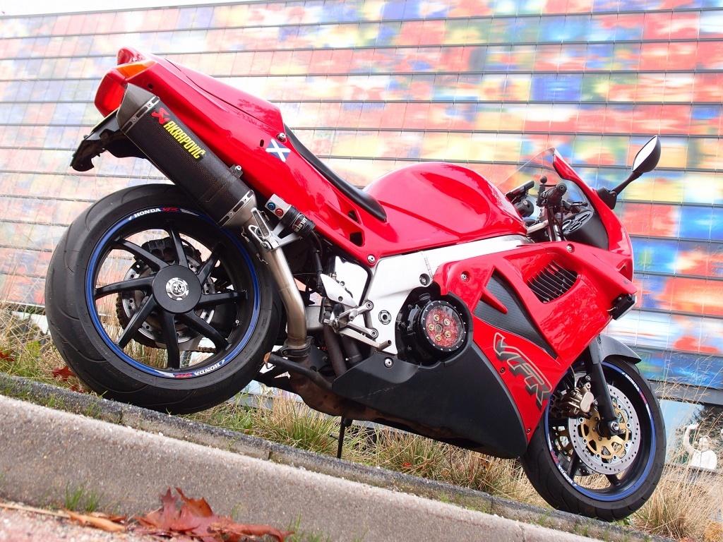

Member Contributer Dutchy Posted September 11, 2019 Member Contributer Posted September 11, 2019 As for the location of the clicker, any place will be fine, even under the saddle. You tend to set it once and forget. But it it of course also a show piece! For a while I had it here Ended up here: 1 Quote

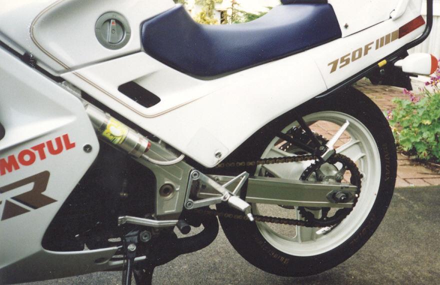

CharlieFoxtrot Posted September 24, 2019 Posted September 24, 2019 This is a Penske. I had a Fox many years ago and it was probably mounted similarly. Quote
