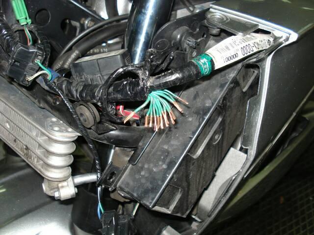

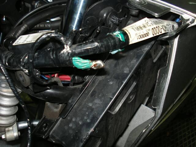

Member Contributer Grum Posted August 18, 2019 Member Contributer Posted August 18, 2019 Check the Earth Block - Orange junction box left front side of bike. This unit has multiple green wires that are commoned together that cause many EFI issues. The trick is to cut the wires from the block and neatly solder them all together. Would also check the ECM Grounds, A9, A20 (Green/Pink wires) and B1 (Green wire) to make sure they are solidly connected back to the battery negative terminal. Note ; A connector on ECM is Black, B connector is Gray. You'll need a good multimeter for this continuity check. Another thing to be sure of is that with Ignition ON that you have a good 12v at ECM B8 (Black/White wire) a low voltage here, especially while cranking may not allow the injectors to operate. Post Edit - Thanks Terry, sorry, wrong location for the 5th Gen. Should be left side below seat. Quote
Member Contributer Terry Posted August 18, 2019 Member Contributer Posted August 18, 2019 A bad earth was my thought too, Grum has shown the position on a 6G (02-). The 98-01 5G has a similar earth block as part of the main wire harness located on the left side of the bike below the seat. It is probably still wrapped up in tape but you will be able to feel the rectangular shape before you unwrap it. Quote
Member Contributer zupatun Posted August 19, 2019 Member Contributer Posted August 19, 2019 I've had similar codes and issues. When these wires become loose in the gang block (Orange in my 2000) a reading from the sensor circuit associated with any loose green ground wire can result in a positive floating voltage giving this generating an errant signal and the ECU flags that as a reading and resulting error code. Matt Quote

Ehonda Posted August 25, 2019 Author Posted August 25, 2019 So... i did the earth block cut and solder, and the other earth wires directly to the battery neg. I dont have a multimeter at the moment to test the other wires. Checked and cleared codes again, no codes left or returning now. Can smell fuel in the exhaust now and sometimes splutters, very poorly though 🤔 Quote

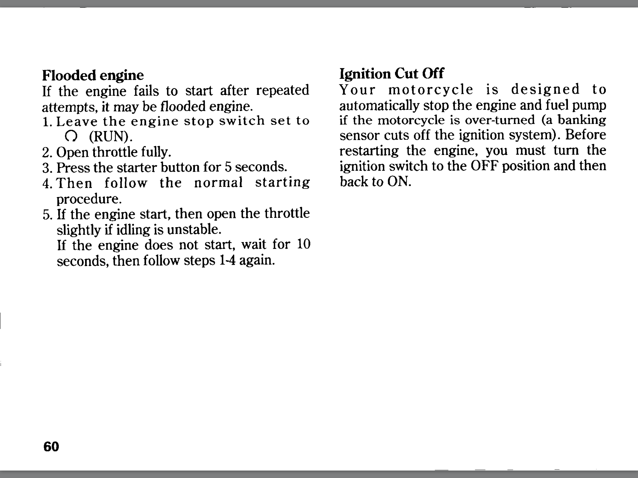

Member Contributer Grum Posted August 25, 2019 Member Contributer Posted August 25, 2019 2 hours ago, Ehonda said: So... i did the earth block cut and solder, and the other earth wires directly to the battery neg. I dont have a multimeter at the moment to test the other wires. Checked and cleared codes again, no codes left or returning now. Can smell fuel in the exhaust now and sometimes splutters, very poorly though 🤔 Does your engine run or do you still have issues? Wonder if you have a flooded situation? You may need to go through the flooded start procedure. Crank it over with the throttle fully open for a while this will help purge the cylinders, then go back to starting with no added throttle. Should eventually splutter and kick into life and run normally. Quote

Member Contributer Grum Posted September 8, 2019 Member Contributer Posted September 8, 2019 On 18 August 2019 at 11:13 PM, Ehonda said: Started in the morning no worries, then left it an hour, came back to go for a ride.. wont start. Absolutely nothing had changed or been touched. Mate. How long did you run the engine when you started it in the morning?? Just getting back to the flooded engine scenario. Did you read the Link I posted regards the flooded VFR1200? If you only started the bike for a short period the combustion chambers do not get hot enough to to burn off the rich fuel, next cold start the ECM will again force a rich fuel mixture causing a flooded situation. This situation could well be made worse by the fact you have either 95 or 98 octane in the tank - The additives in Premium Fuel to increase its octane, actually decrease its volatility, so it just won't vapourise as readily as 91octane. (There is no benifit running Premium fuel in a VFR!). Your statement "Can smell fuel in the exhaust now and sometimes splutters, very poorly though 🤔" is typical of the flooded situation mentioned. Guess I'm stating the basics here, but if you have Compression, Rotation, Ignition, Fuel and Air (in the RIGHT amounts) you should get some response from an engine. Another thought for excessive fuel could be a ruptured Fuel Pressure Regulator. This causes excess fuel to be sucked into cylinders 3 and 4 via the vacumm hoses, no Fi codes for this fault. Thoughts of a faulty Cam or Crank Pulse Sensor would inhibit your spark and flag up an ECM Error code, you apparently don't have any error codes and you state you have Spark. Can't agree with your thoughts that in the space of one hour the Ignition Timing would suddenly go way out, never heard of that happening. Good Luck - Keep us posted. Quote
Ehonda Posted September 9, 2019 Author Posted September 9, 2019 Running fine for at least 15min just on the centre stand while having a chat to a family member. And had taken it out for 5min burn up the road prior to that. I did the flood prodecure maybe 40 times yesterday, would be lucky to get one little pop each time. Left the plugs out for 24hrs, came back to it just then. No difference. Quote
Member Contributer Grum Posted September 9, 2019 Member Contributer Posted September 9, 2019 52 minutes ago, Ehonda said: Running fine for at least 15min just on the centre stand while having a chat to a family member. And had taken it out for 5min burn up the road prior to that. I did the flood prodecure maybe 40 times yesterday, would be lucky to get one little pop each time. Left the plugs out for 24hrs, came back to it just then. No difference. Fair enough. Reckon you should check the ECM Grounds and 12v Power as suggested above. Also have a good look at the wiring and state of the main Fuse at the Starter Relay. Heat stressed wire and overheated fuse legs have caused strange problems, bit of a known weakness. Quote
