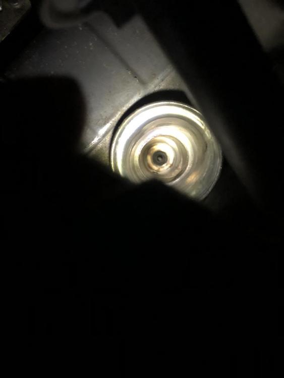

2wenty Posted July 11, 2019 Posted July 11, 2019 Hey guys, Just bought a super clean RC36 with 7K and on my 50 mile ride home something happened. I was almost home and I was pulling away from the light and there was a small pop and it started running terribly, there was a loud ticking like an exhaust leak. Does anyone know if its a common problem or a known problem to blow an exhaust gasket? The bike has a slip on so I thought it might have been at that joint but the sound is coming from somewhere closer to the engine. I didn't really get a chance to run it and check exactly where it is since its midnight here. I took a look by the radiator where the front 2 headers come out and nothing looks unusual, no gasket material. Not seeing any fluid leaks yet and I checked the oil and dont see anything that might be water. Also I dont remember seeing any smoke. Im guess from the mile I rode to get it home it sounded like an exhaust leak but who knows. Not really the greatest way to start ownership. Also the seller lucked out like a mofo. Really hoping this is nothing. Maybe its running lean as hell from the slip on and the exhaust got really hot and the old gasket let go. IDK. Was super fun ride home except for the crazy soft suspension and now this. Any help would be great. Thanks Quote

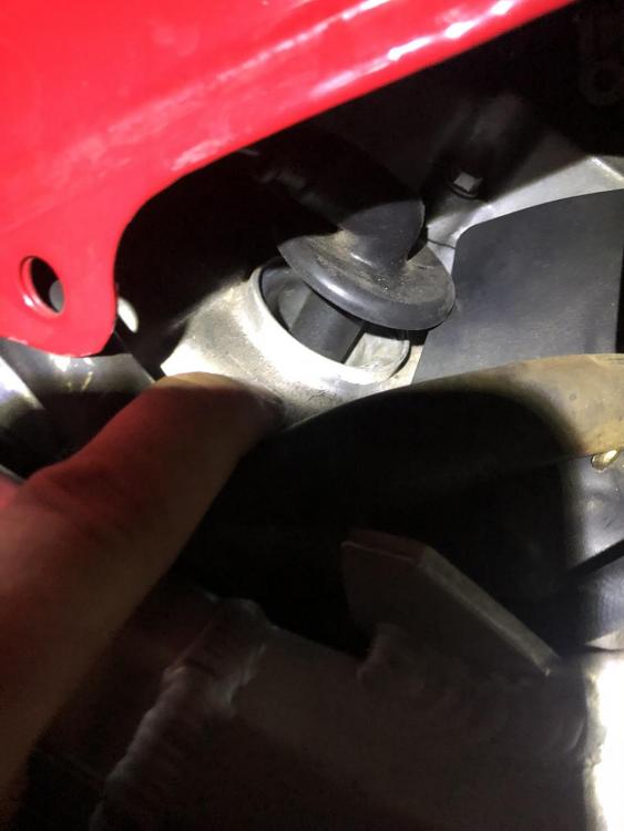

2wenty Posted July 11, 2019 Author Posted July 11, 2019 Well F me sides ways, couldnt sleep with this on my mind so I went down to take the plastics off to have a look. Couldn't really get them off since I dont know anything about this bike yet. Fired it for a fast second and put my hand under the bottom exhaust connections to check for a leak. Nothing. The sound it def coming from under the seat/tank. I pull the seat and try and peak from the shifter side and what I see is the spark plug boot sticking up?! WTF?! Im praying to god at this point that the plug was just not tightened down all the way and or backed itself out. I figured out how to raise the tank so I can get the wire and plug out at the same time, can't believe this S#$t, the plugs broke off in the head. I mean wtf?! Im guessing someone broke it off in the head and left it and or used the last remaining thread to tread it back in just to sell it. Uhh man, I literally bought this bike as second transportation because my BMW needs a new part like once a week. Im praying to god again I can back this thing out without doing anything else, or else its just going to sit for a very long time. Im not taking the head off. Is this common?! Been working on pretty much anything that has a gas motor my entire life and never seen this. Quote

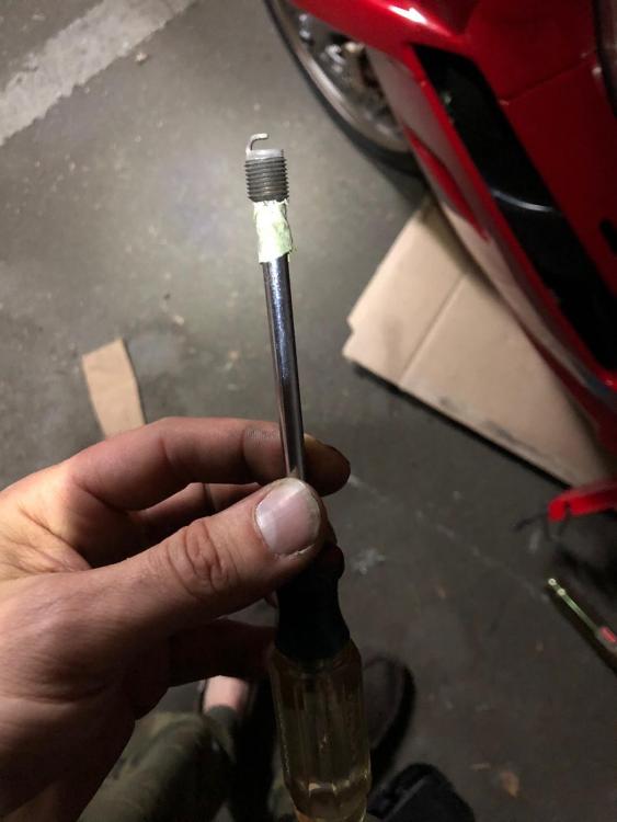

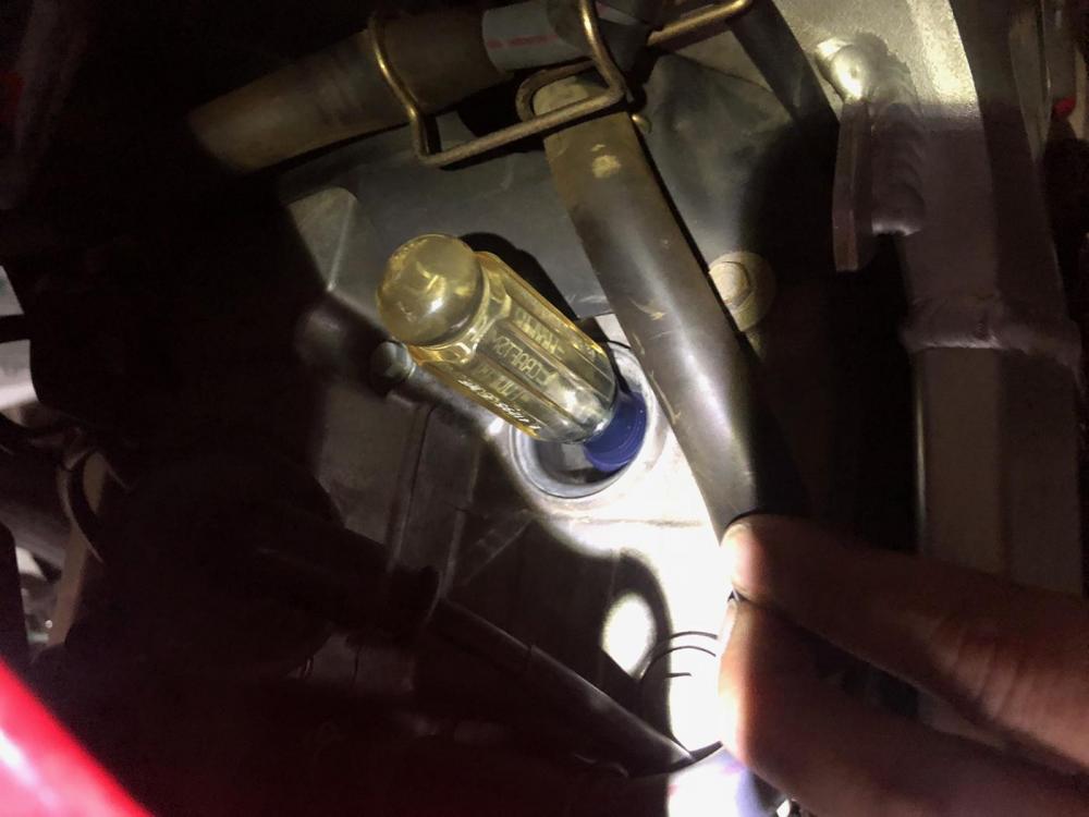

2wenty Posted July 11, 2019 Author Posted July 11, 2019 So I get down on my knees and asked god, "why, you screw me nearing every god d$mn day, please let me just have one, I can't live like this." Not letting this go. Grabbed a flat screwdriver to see if it would fit and wedge, it was too big. Went back and grabbed a Phillips, it started backing out, "yes god! thank you, noooo, no, I'm not celebrating too early, I'm sorry". It stopped backing out and was slipping, it was hung up, "please god, not now, I need this one, I promise I wont be cocky" grabbed some masking tape and wrapped it around backwards, "pleeeeaasseeeee", YESSSSS!!!!!!!!!!! THANK YOU!!!!!!!!!!! I just want to keep screaming Allāhu akbar but its 2am. I know deep down I should replace the other plug, but hell no, Im not rolling those dice. Quote
bdouvill Posted July 11, 2019 Posted July 11, 2019 What a story! It reminds me plenty of time when you say to yourself: "But why???" Lucky for you you were able to solve it in the end. Also, rear cylinder spark plugs are easier to access than the front ones. I did not know how to changes plugs without removing the cooling radiator. Let us know how she runs after you put a new plug in. Quote
2wenty Posted July 11, 2019 Author Posted July 11, 2019 Bro, for real. The bike has 7,700 miles on it so the plugs are good for awhile, the gap on the broken one looks decent. Just hoping no more are broken. As of now Im leaving it, I cant afford for one to break off in removal. The ride home was pretty great other than the crazy soft suspension, but ill have a look at that and have it setup soon. Im coming off a Duc 1098 with race exhaust and the RC doesnt quite shake the ground like that one did, but it does sound pretty good, albeit kinda quiet compared to the Duc even with the slip on. Might need a header in the long run but for now, she's pretty nice. Just need to stiff the suspension up and add some preload to get her to turn a little better. BTW, where should the temp needle sit when cruising on the highway/freeway? Mine sits at about the 25% percent area if you consider the cold to hot marks 100%. Should it be about half way (50%)? Do I have a thermostat problem too? It does seem like it takes a little bit to warm up. Thanks! Quote
Member Contributer Dutchy Posted July 11, 2019 Member Contributer Posted July 11, 2019 Front plugs: loosen radiator and push a wedge (piece if scrap wood) from the side to move it out more to give you just enough space. As for the other plugs, maybe the PO overtightned them? Set torque wrench to spec for the plug, switch direction and see if the other rear one will come out. Increase torque setting by small increments if not. Temp gauge: after 19 years, 100k+ ownership I can tell you it rarely moves over 25% 🙂 Quote
Member Contributer YoshiHNS Posted July 11, 2019 Member Contributer Posted July 11, 2019 I've never seen that before. Lucky it wasn't stripped threads. I'd probably replace all the plugs. Rears are easy. The fronts, you remove the lower radiator bolt, loosen the top, and you can hinge it forward towards the forks to get your hand in there. I usually take the fan off too, or at least 2/3 bolts and swing it out of the way. Makes life much easier. Quote

GreginDenver Posted July 11, 2019 Posted July 11, 2019 Nice "save" with that broken spark plug. Good job. I've seen some strange things with spark plugs. When I saw your first picture I was thinking you had a thread failure in the head and the engine spat out the spark plug (I've seen this happen on 1990s-2000s Kawasaki engines). Quote

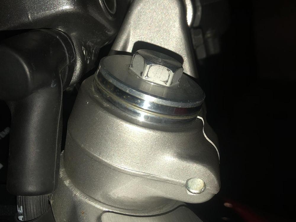

2wenty Posted August 14, 2019 Author Posted August 14, 2019 Before I try and lower the forks, this is what it looks like. Do I measure 10mm from the ring? Quote
Member Contributer Dutchy Posted August 14, 2019 Member Contributer Posted August 14, 2019 Yeah as a starting point yes that will do. What year is yours?, 3rd or 4th gen? That fork top looks "different" (in my recollection of my 1997). Another thing you can do is raise the rear by putting a U-shaped spacer between top of rear shock and frame. U-shape because then you just loosen the bolt instead of an o-ring where you need to remove the shock. OEM suspension so-so to begin with, most likely it will be shot. But these mods are free so try first if you like the result. PS: bought it a month ago and want to sell it? So just fix and flip? Quote

2wenty Posted August 14, 2019 Author Posted August 14, 2019 Just lowered it about 3-4mm more about 7 total from the ring. I could already tell the difference pushing back into its parking spot. I took it for an easy run through Mulholland to see whats up. I wouldnt think just moving 3-4mm would be a big deal but its definitely noticeable. Couldn't really ride hard since its pitch dark but it does want to turn in better. The bars a stiffer to turn and if I wiggle the bars its a lot twitcher. Did a little freeway run to see if I was going to be more prone to tank slappers. Doesn't seem too bad. It does seem like its putting more load on the front tire which is probably bad news for 10 year old tires. Looks like Im going to have to get them sooner then later. I wish it would be easy to adjust the forks 1mm at a time but that just seems like a nightmare. Quote
2wenty Posted August 14, 2019 Author Posted August 14, 2019 Also can someone confirm, is the stock/factory setting for the forks suppose to touch the ring or is slightly down from the ring like in the picture above? Quote
