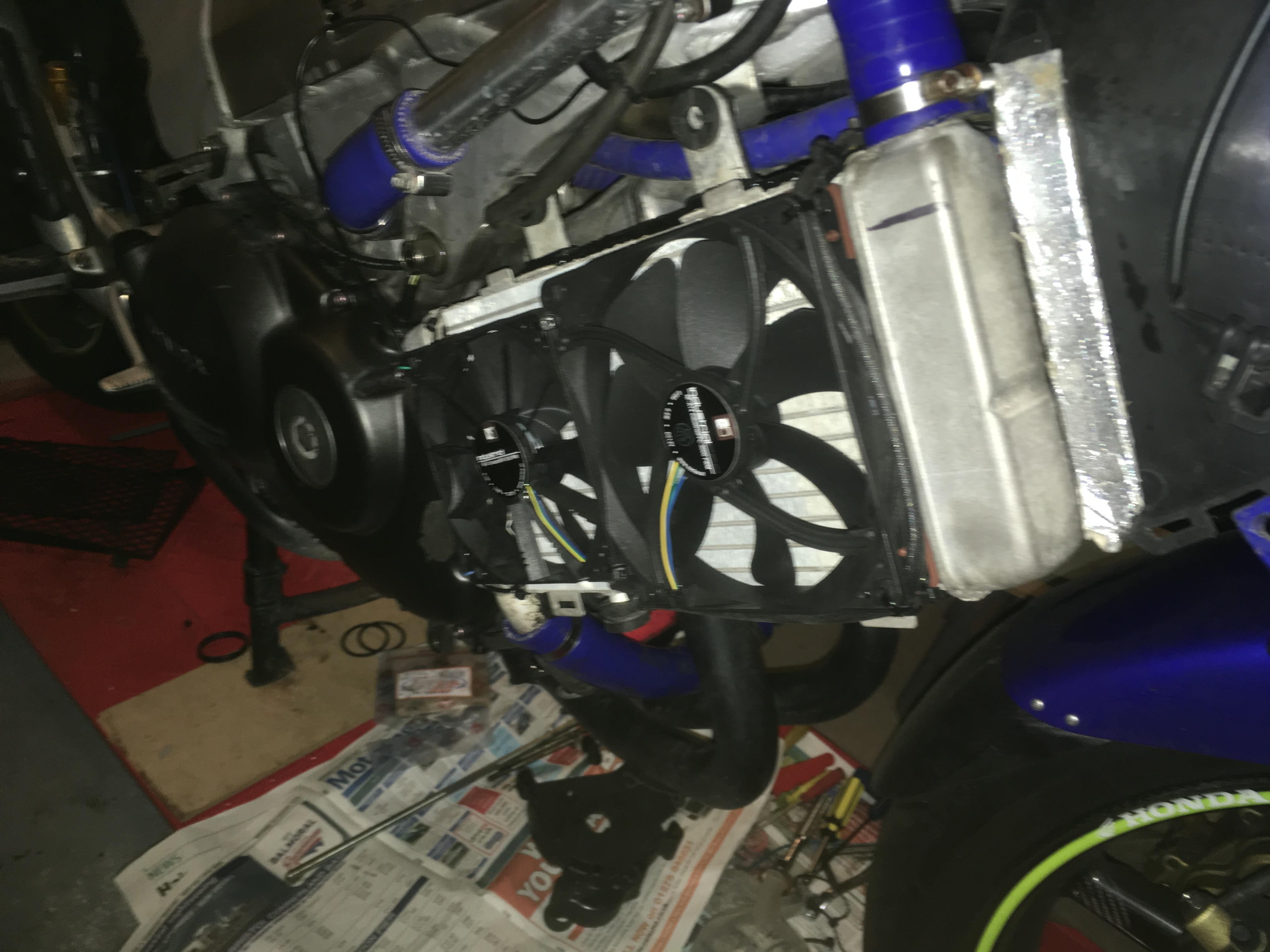

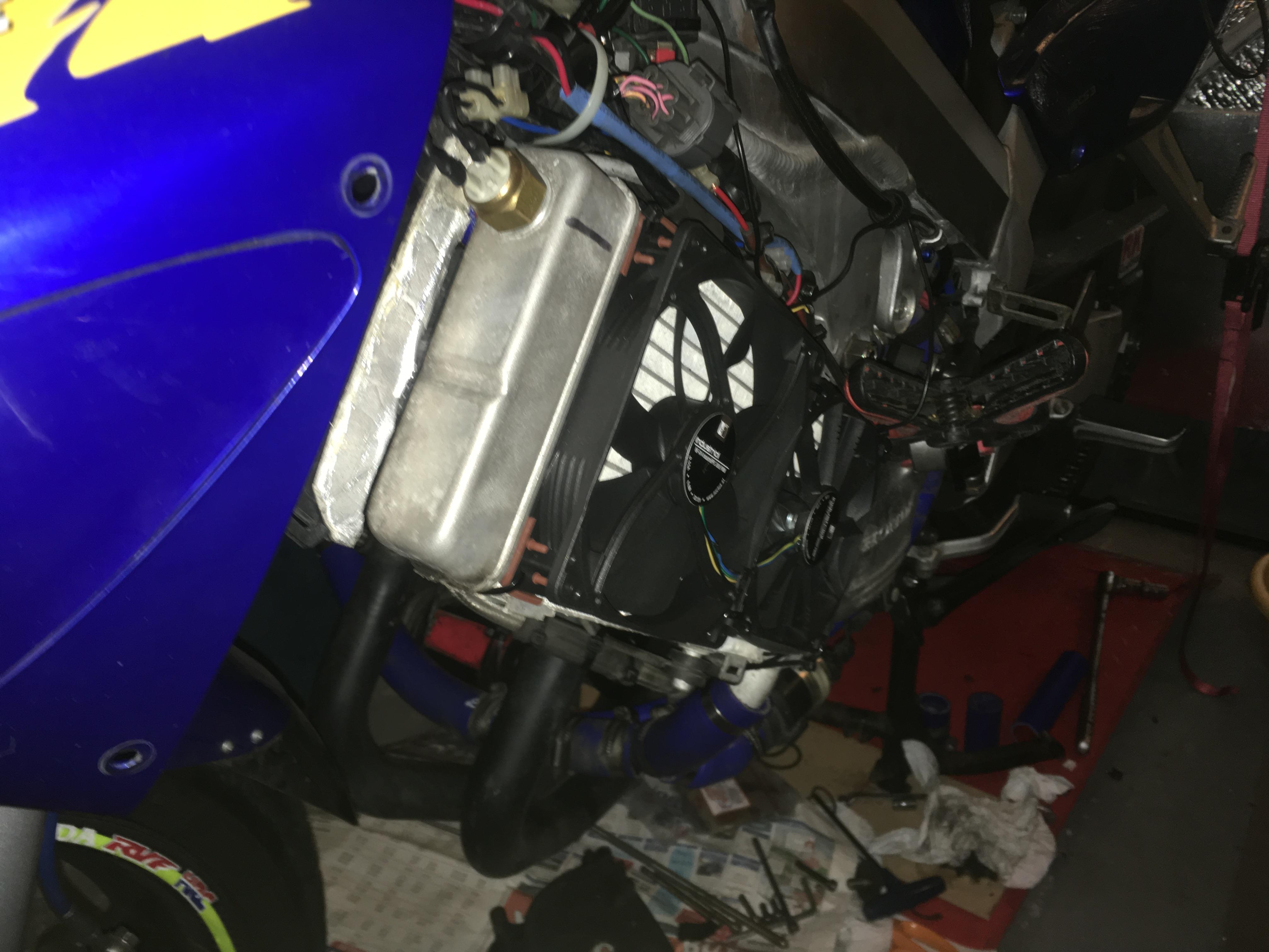

You could always do this 👍😎
Works a treat.
Same both sides oem fan is long gone these are IP67 rated fans & the combined FPM is 50% more than the OEM fan & both suck air outwards through the rads. I have 90C thermal switch which resets at 80C. Works great. Plus if one fan dies there are 3 others still working.
Just needs a little sculpting of the outlet vents where they cross the fan frames. This is not visible from outside.
Have fun.
  • Like 5
Works a treat.
Have fun.
You managed to get those under the fairing and make it look relatively stock eh? Niiiice! Puller fans are always more effective, without a doubt, and having fans on both radiators has got to really drop the heat in a hurry.
Can you show a picture of the fairings back on the bike to see how the fans are exposed. Thanks
