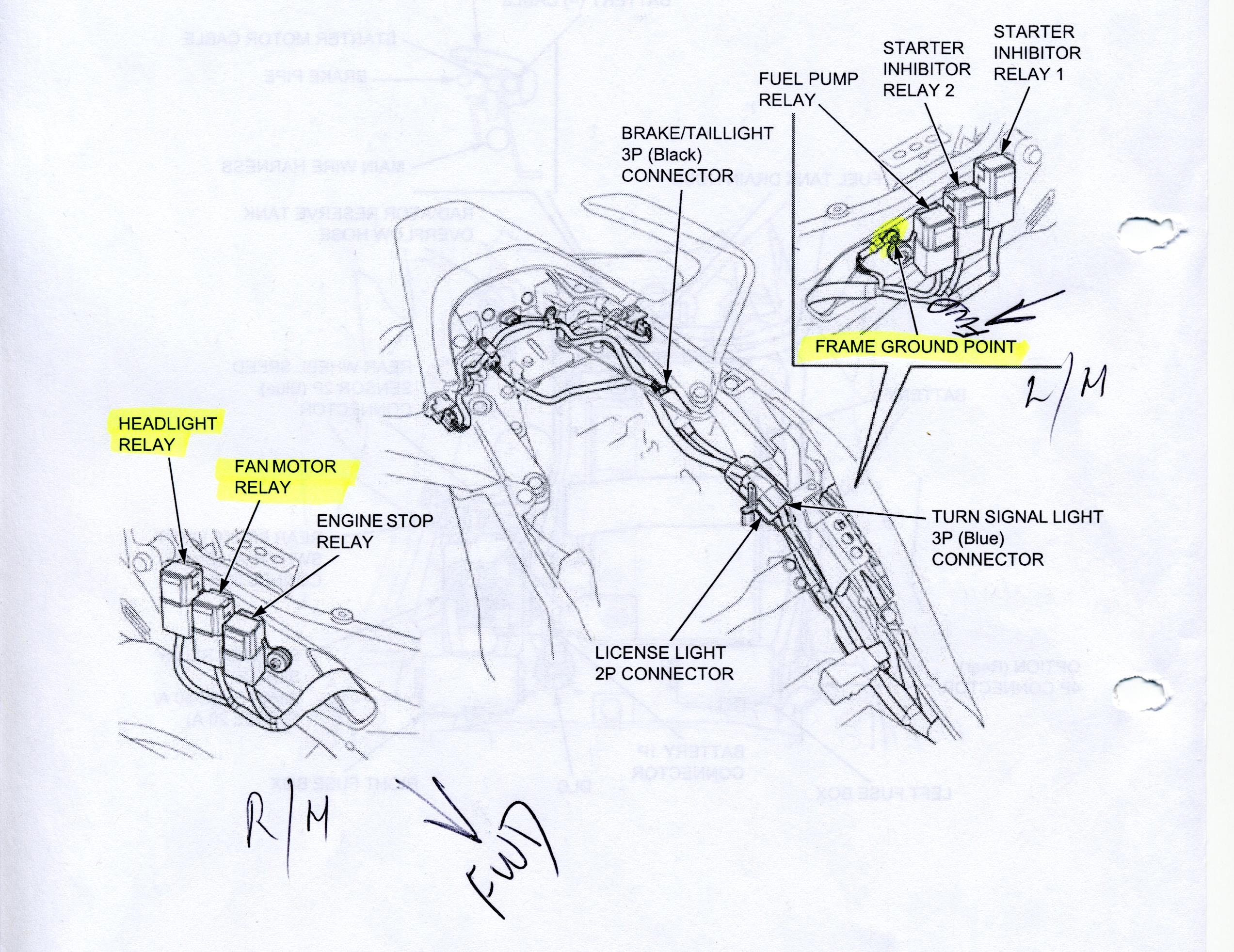

Member Contributer Grum Posted June 27, 2019 Member Contributer Posted June 27, 2019 33 minutes ago, Rollos said: I am under the 4 year Honda care I bought with the bike last year but I'd love to narrow down the issues before I bring it in. I use the bike to commute and don't want to be without it for months. Any suggestions would be welcome. I'll check the fuze this afternoon Ok. If the fuse is good. Then with a meter check the ground supplied to the fan relay by the ECU which should be there at around the indicated 225degF. If it's a relay issue this can be easily swapped with the headlight relay (headlight relay is only for Hi Beam operation). Also it shouldn't be a hard task to unplug the fan relay and jumper the power feed for the fan to check its operation. Cheers. 1 Quote

Member Contributer Grum Posted June 28, 2019 Member Contributer Posted June 28, 2019 Hi Rollos. It seems like your Thermostat is not fully opening as it should be by 203degF (or something horrendous with your water pump). So without full coolant flow your cooling fan may not be sufficient to cool your bike. However what disturbs me a bit is the fact you did a test all the way up to 240degF (115degC) and your fan did not come on! Why not just for the hell of it swap your Fan Relay with the Headlight Relay, they are right next to each on the R/H side of your bike. You will need to carefully remove the R/H Rear Cowl. You can then also have a good look at the Relay wiring, run some voltage checks and check continuity of the ECM wire Gr/Bu from A23 (ECM Black Plug) to the Relay Base. If your are really keen you could test the Fan, by removing the Fan Relay and place a jumper link between Bi/Bu wire and one of the Bu/O wires with Ignition to OFF, the jumpering of these wires should start your fan up every time you make the link. WARNING - Just DON'T jumper anything to the Gr/Bu wire as this goes to your ECM. Do you have the wiring diagram, and service manual? Good Luck. Quote
