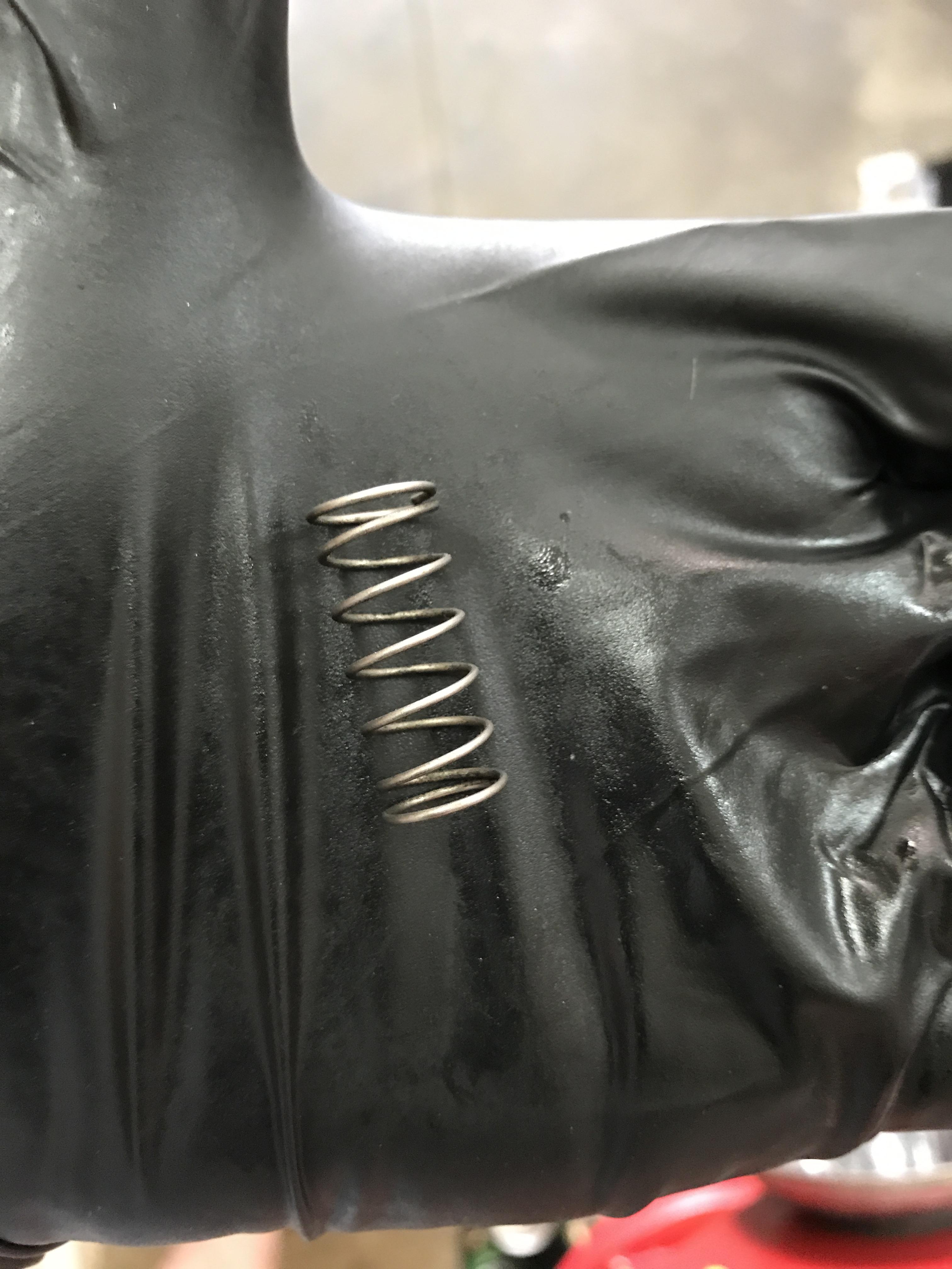

WGREGT Posted April 8, 2019 Author Posted April 8, 2019 Ok. I finally got around to pulling the carbs off. Pulled all of the pilot/slow jets and....they weren't really clogged that I could see. I was HOPING for a full-on gummed up/clogged jet(s) and/or float bowls but they were all sparkling. Blew the jets out anyway with the compressor and soaked them overnight. Still looked like I just pulled them out. Pulled ONE of the carb tops just to check and make sure a diaphram wasn't torn, but it was fine. Here's where I need your help. Put it all back together, and....found a small spring loose on the left side near the idle screw cable, just sitting on the engine. And I have no idea where it goes. I looked at the fiche. I ONLY took off each float bowl and removed each pilot jet. No springs there anywhere. Took off that one carb top (which has a much larger spring under it), but I rechecked that and the spring is still there. Looked all over the fiche in the CARB diagrams and found nothing that I could see where this goes. So...any ideas? Quote
WGREGT Posted April 8, 2019 Author Posted April 8, 2019 PS If it helps, all I did was pull the carb bank out and flip it over. I did not disconnect the throttle cables. Just a lot easier and quicker this way to get to the bottom of the carbs I thought. Quote
WGREGT Posted April 8, 2019 Author Posted April 8, 2019 Wherever it went it just slid off from somewhere. Had to. In other words, I didn’t remove a screw or a nut etc that this went under. Does it go with any of the choke lever linkage somewhere maybe? Quote

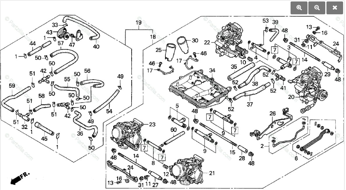

Member Contributer COS_VFR Posted April 8, 2019 Member Contributer Posted April 8, 2019 Its hard to tell how big it is, but there are some springs between the throttle linkages, look at #10 and #12 on this picture. Quote
WGREGT Posted April 8, 2019 Author Posted April 8, 2019 Yep. I saw those two. And they are on the bike. Those are huge, tightly coiled springs. Probably 4" fully coiled. Quote
WGREGT Posted April 9, 2019 Author Posted April 9, 2019 Correction: about an inch long. Just re-checked. Quote
squirrelman Posted April 9, 2019 Posted April 9, 2019 damned if i know................but it looks to be either #10 or #12 above. Quote
WGREGT Posted April 9, 2019 Author Posted April 9, 2019 Nahhhh. Those two are really tightly coiled springs that run between 1 and 3 and 2 and 4. Also those are really heavy duty springs, looks like. The one I found is a light little one. Quote
WGREGT Posted April 9, 2019 Author Posted April 9, 2019 Ok...just for fun, let's say it was #10 or #12. Where exactly do they go? In the diagram, it doesn't show really. The longer I look at it, the longer I think the two coiled springs I saw on the bike are the ones shown attached to carb bodies #22 and #23 in the foto. Quote
WGREGT Posted April 9, 2019 Author Posted April 9, 2019 Odder still, nothing was disconnected other than the float bowls, so if it IS #10 or #12, it slid off something without being taken apart etc Quote

WGREGT Posted April 9, 2019 Author Posted April 9, 2019 If only there HAD been a previous owner...I'm pretty tight on keeping this thing clean. It was just sitting between the heads near the idle screw. I would have seen it earlier... Quote
Member Contributer magpie114 Posted April 9, 2019 Member Contributer Posted April 9, 2019 Is it off the idle control cable?Sent from my iPhone using Tapatalk Quote
WGREGT Posted April 9, 2019 Author Posted April 9, 2019 That was my immediate thought, but it doesn't look like there's anyway for it to go on that cable. Too small to fit over the knurled blk knob. Quote
Member Contributer magpie114 Posted April 9, 2019 Member Contributer Posted April 9, 2019 But it goes over the thread at the other endSent from my iPhone using Tapatalk Quote
WGREGT Posted April 9, 2019 Author Posted April 9, 2019 yes it does but I didn't unscrew it or mess with it. Quote
Member Contributer magpie114 Posted April 9, 2019 Member Contributer Posted April 9, 2019 It’s the only place I can think of - it’s shown below in place on the idle control cable (9)Sent from my iPhone using Tapatalk Quote
WGREGT Posted April 9, 2019 Author Posted April 9, 2019 yeah that one is smaller and stays locked on the cable unless you unscrew it I guess. I'll guess I'll have to pull them off again and see how #10 and #12 stay on. It's the only thing I see. Quote
WGREGT Posted April 9, 2019 Author Posted April 9, 2019 Just pulled them off again and flipped them over and still did not see where it might go. Didn't see where #10 and #12 went either. It HAS to be 10 or 12 but I'll be damned if I know WHERE they go. Doesn't seem like anything goes THRU the spring, esp. since I didn't unscrew anything and take it off. 10 and 12 just seem to float in that diagram. Thoughts? Quote
