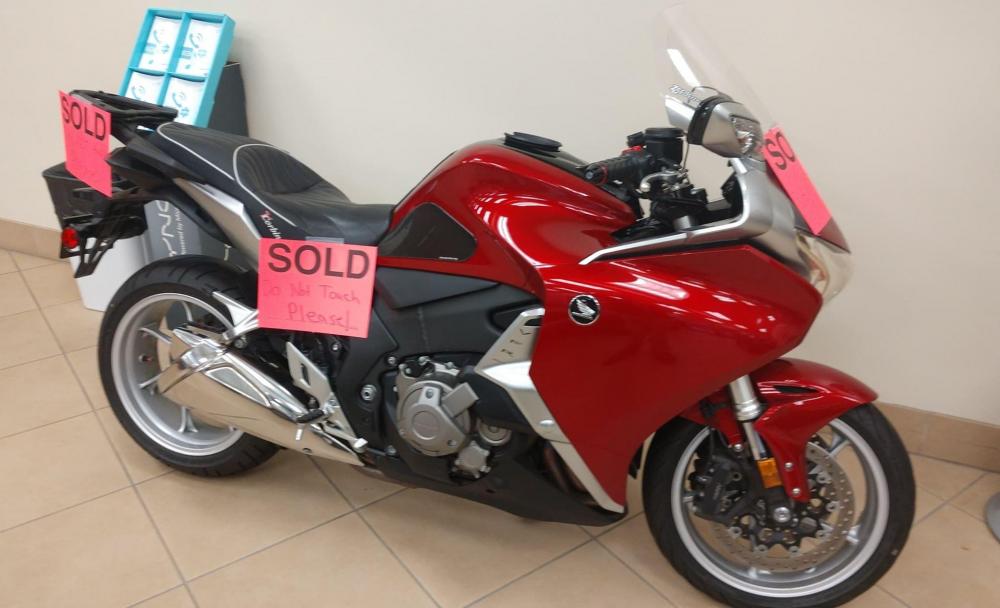

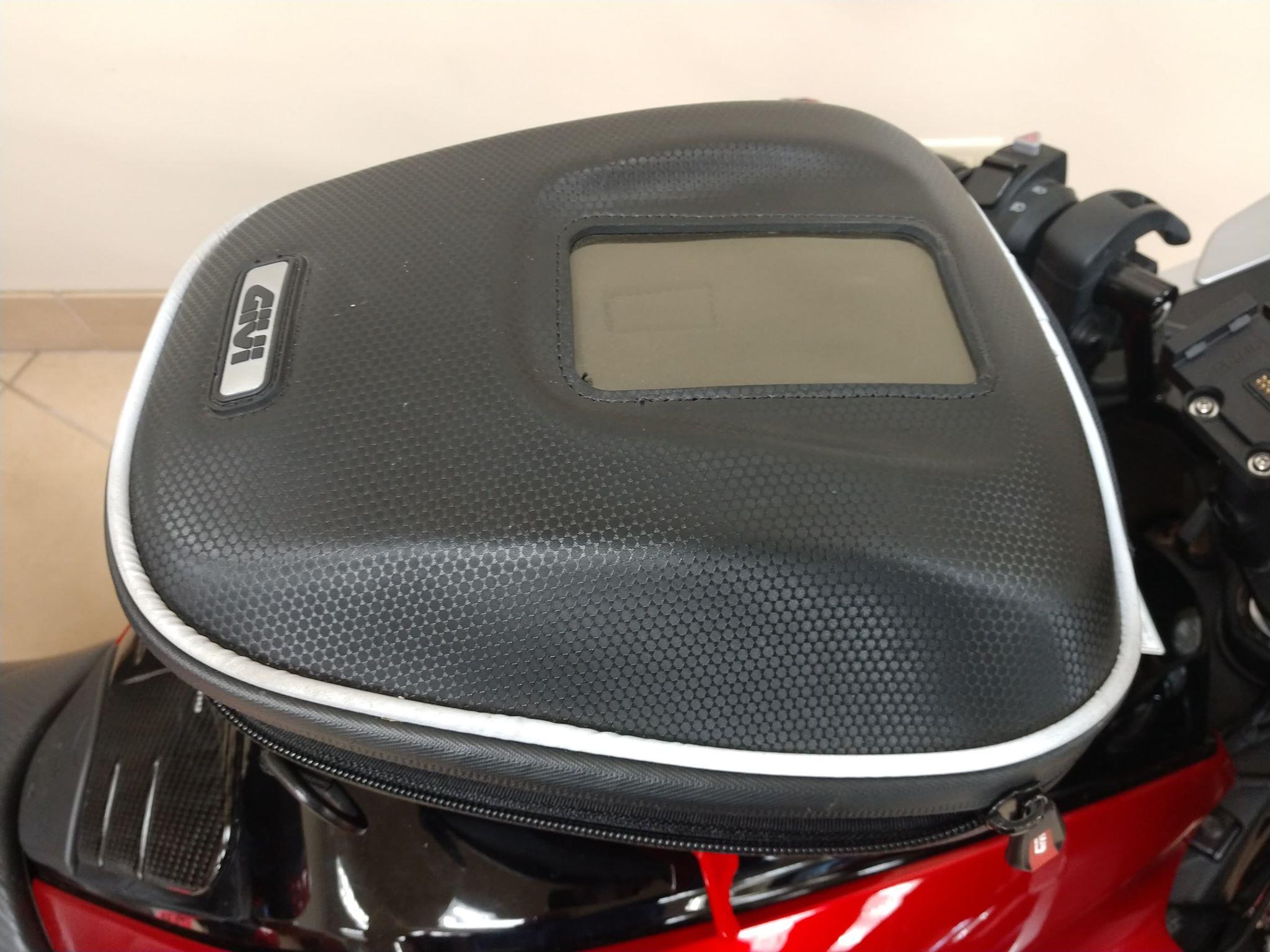

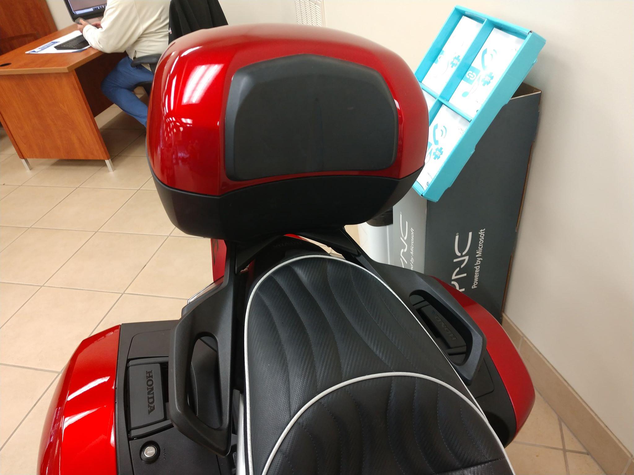

UpArrrow Posted December 7, 2018 Posted December 7, 2018 I did call my local Dealer and fed them the VIN and they confirmed the bike is eligible for the recall.  Here she is BTW. Will be here in about 3 weeks.   1 Quote

vfr1200f Posted December 7, 2018 Posted December 7, 2018 8 hours ago, UpArrrow said: I did call my local Dealer and fed them the VIN and they confirmed the bike is eligible for the recall.  Here she is BTW. Will be here in about 3 weeks.   Great looking bike... looks like new 😛 ... i'm just teasing ya'. Also, i noticed it's a DCT. Enjoy! Quote

UpArrrow Posted December 7, 2018 Posted December 7, 2018 10 hours ago, vfr1200f said: Great looking bike... looks like new 😛 ... i'm just teasing ya'. Also, i noticed it's a DCT. Enjoy!  My 18 Wing has DCT, I only ride it in manual mode and enjoy it in sport mode. I plan to do the same with this one.   I'm short & round-ish with knee flexibility issues at 55 years old. With marginal reach to the ground, I figured not having to work the clutch pedal at start & stop would probably save me an embarrassing drop several times over. And once one is accustomed to manually flicking the fore/aft triggers the DCT is quite enjoyable to use.   Quote
