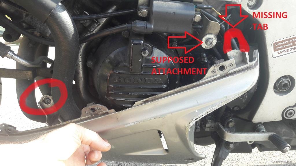

Then I have some fairing questions for you guys.
I found some decent parts for the left part of the bike.
There are a few broken tab but I feel confident Plastifix will handle it.

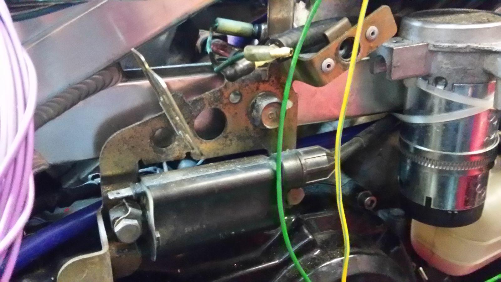

I went to look at the bike to evaluate which bolts and screws I might be missing and here is what I found:
Don't ask me why but it feels like the coil holder seems like it's not in the right place. I am writing this and I feel like the answer is in front of me. The holder bolt should go through the left hole that we can clearly see on the last picture, is that correct?
I hope this is an easy fix since this bolt is holding the engine and I remember well putting the engine in the frame is not an easy task. I am pretty sure I have the same problem on the other side of the bike 😞

Additional photos of the holders. The marks tell me my assumption is correct and I mounted them incorrectly. Can anyone confirm?

Yes, definitely the bolts are in the wrong holes on the coil brackets.  The middle hole is huge!  Not sure how you even managed it!

Sure when you realize it, seems obvious I used the wrong holes. Just remember when you put it on, you're in the middle of mounting the engine in the frame which I did twice already and is not fun at all... I clearly remember now you have to put one specific bolt first (front right side) and I guess the frame twists itself for the rest to go. Otherwise, this crazy b... never goes in... There's something like 2-3mm between the hole in the frame and the engine mounting point.
I hope I can remove the holders one by one and put them back without issue. Will probably put a jack under the engine to support part of its weight.

At the same time, I mounted the fairing on the left side. I relocated the coil holders without issue (I jacked the engine just in case).  I also rebuilt the broken tab on the lower left fairing with Plastifix (damn that works well) but I forgot to take a picture.
Now I have a mixed condition fairing parts with top heavily damaged, bottom damaged but ok and side panel in excellent condition... I have a bad condition right side panel (with missing air duct) but no lower part. I struggle to find it on Ebay (in Europe). But I'll find it (or I'll try to order a replica from LineaMoto in Italy). I also have a (broken) red V fairing but I need to mount the right side before repairing (and mounting) it.
