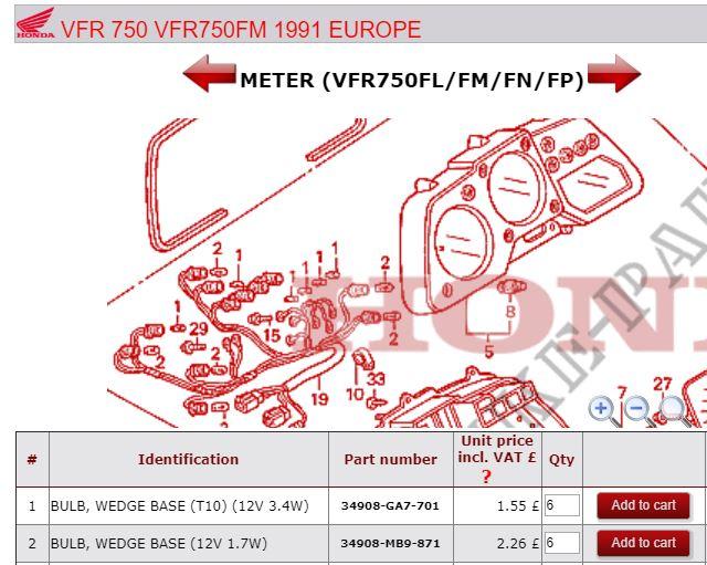

bdouvill Posted June 11, 2018 Author Posted June 11, 2018 Another basic question: The clock light bulb is broken and I cannot figure the bulb reference or if this must come as one part (bulb and holder). I was able to use a car one but it's too deeps and I cannot close the cover 😞 Quote
Member Contributer Dutchy Posted June 11, 2018 Member Contributer Posted June 11, 2018 is it not #2? https://www.bike-parts-honda.com/pieces-honda-detail-4693-13MT4L41-VFR750FM-1991-F__0200-VFR+750.html hhhmmm "Clock Assembly is #18 but where in the Fiche is it??? Quote
bdouvill Posted June 11, 2018 Author Posted June 11, 2018 Hi @Dutchy https://www.cmsnl.com/honda-vfr750f-1993-p-france_model5630/partslist/F__0200.html#.Wx6-Ue6FM3g #2 is the light bulb for indicators and dashboard lightening, this is a W5W. The lightening for the clock is #3 and apparently bulb comes with holder. If it's only a few Euros, I will order it with my next parts order. Unless I can find a standard reference since it looks a lot like this: https://www.autobulbsdirect.co.uk/r509tybk-1.4w-t5-14v-1.4w-indicator-and-panel-bulb-black-base.html Quote

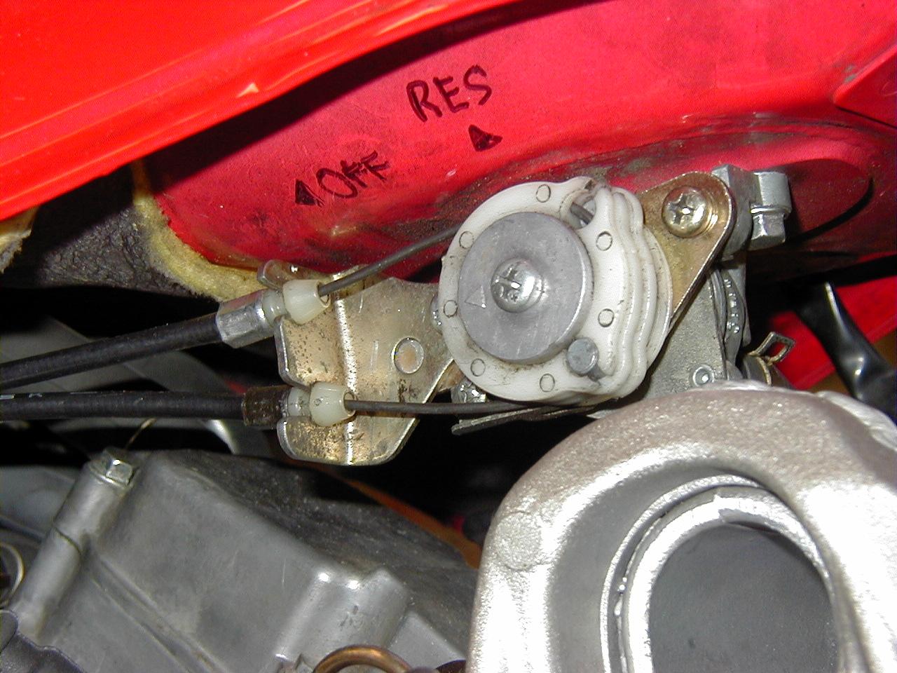

Member Contributer JZH Posted June 11, 2018 Member Contributer Posted June 11, 2018 Is this what you mean? I don't have the fairing (or the cables--they're attached to the fairing) on the bike at the moment, but it's not complicated to get them to where they need to be at the tank. Ciao, Quote
bdouvill Posted June 11, 2018 Author Posted June 11, 2018 11 hours ago, JZH said: Is this what you mean? I don't have the fairing (or the cables--they're attached to the fairing) on the bike at the moment, but it's not complicated to get them to where they need to be at the tank. Ciao, @JZH I figured how they connect to the lever as we see on your pic, but I don't understand the route around the coil that is managing the left rear cylinder. I would appreciate if you could share some pictures Envoyé de mon SM-A510F en utilisant Tapatalk Quote
Member Contributer JZH Posted June 12, 2018 Member Contributer Posted June 12, 2018 Sorry, the cables are off the bike at the moment, so when I re-fit the fairing I will have to figure it out again myself, but I've done it many times and I don't remember any problems? Ciao, Quote

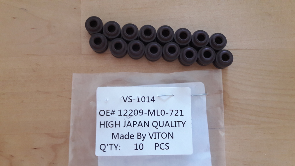

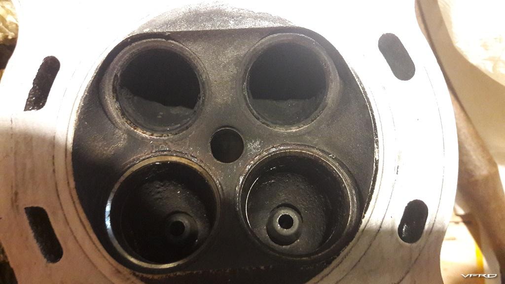

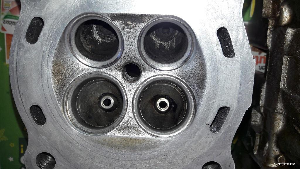

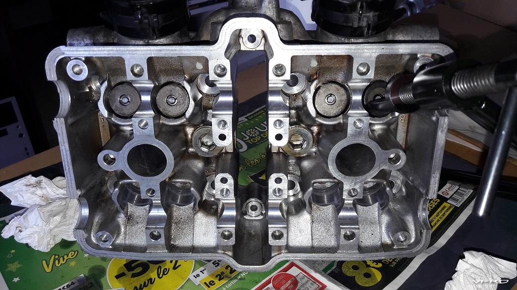

bdouvill Posted November 15, 2018 Author Posted November 15, 2018 Because I don't want to accept easily the defeat, I dismantled the engine again... I removed it from the engine, removed the 2 cylinder heads to change the valve seals. I took this opportunity to lap all 16 valves properly with this tool which worked great. The seal I got from the Bay were fine. Some old one were ovals, no surprise they were leaking. That was obviously before: and after the lapping The whole thing took me more time that I thought. Engine is now back in the frame and I synch'ed this bad girl. Fires like a charm and gone is the white oil smoke 😉 I am currently in the brake rebuild process: new seals and lot of red grease, braided lines, new fluid. Let's hope I can run it again before Christmas. Quote

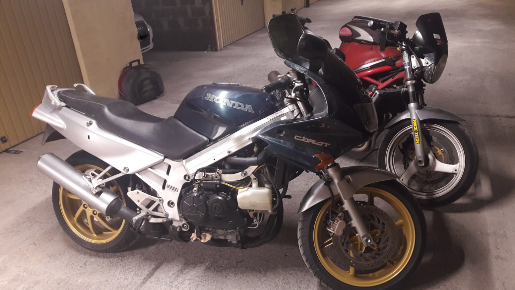

bdouvill Posted November 13, 2019 Author Posted November 13, 2019 Damn it, I am 4 days late to celebrate 4 years of this thread 😉 Here is my (late) birthday gift - pics taken today Quote
