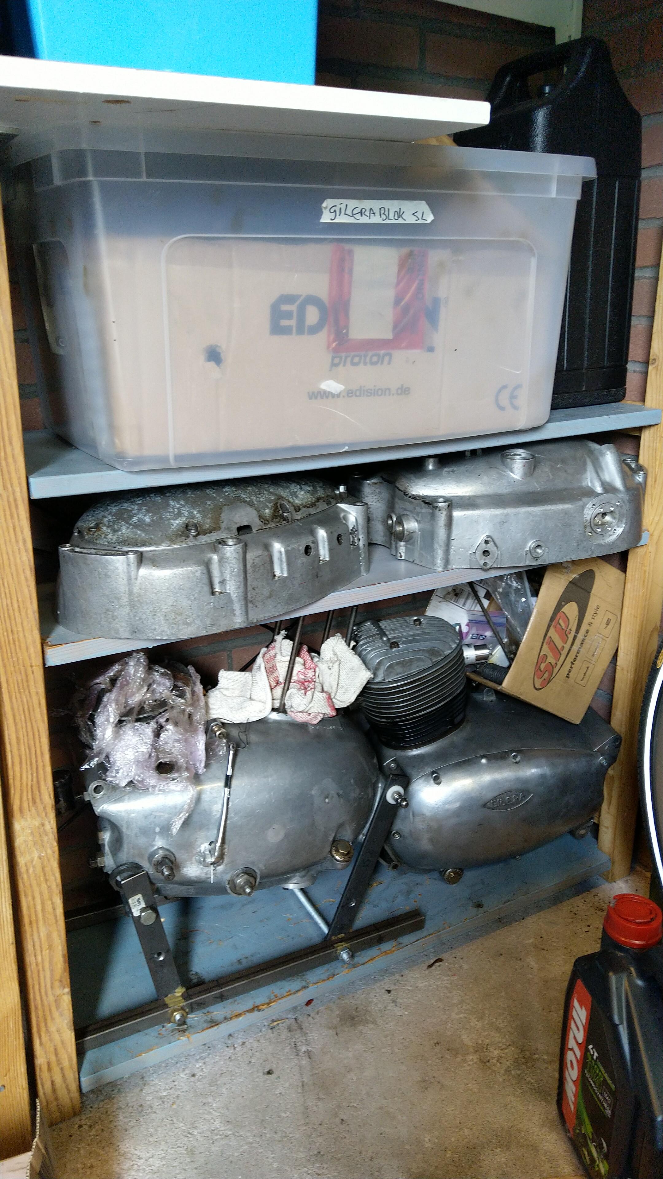

Cilinder honed, head refurbed, new piston rings
Contact points from spare engine

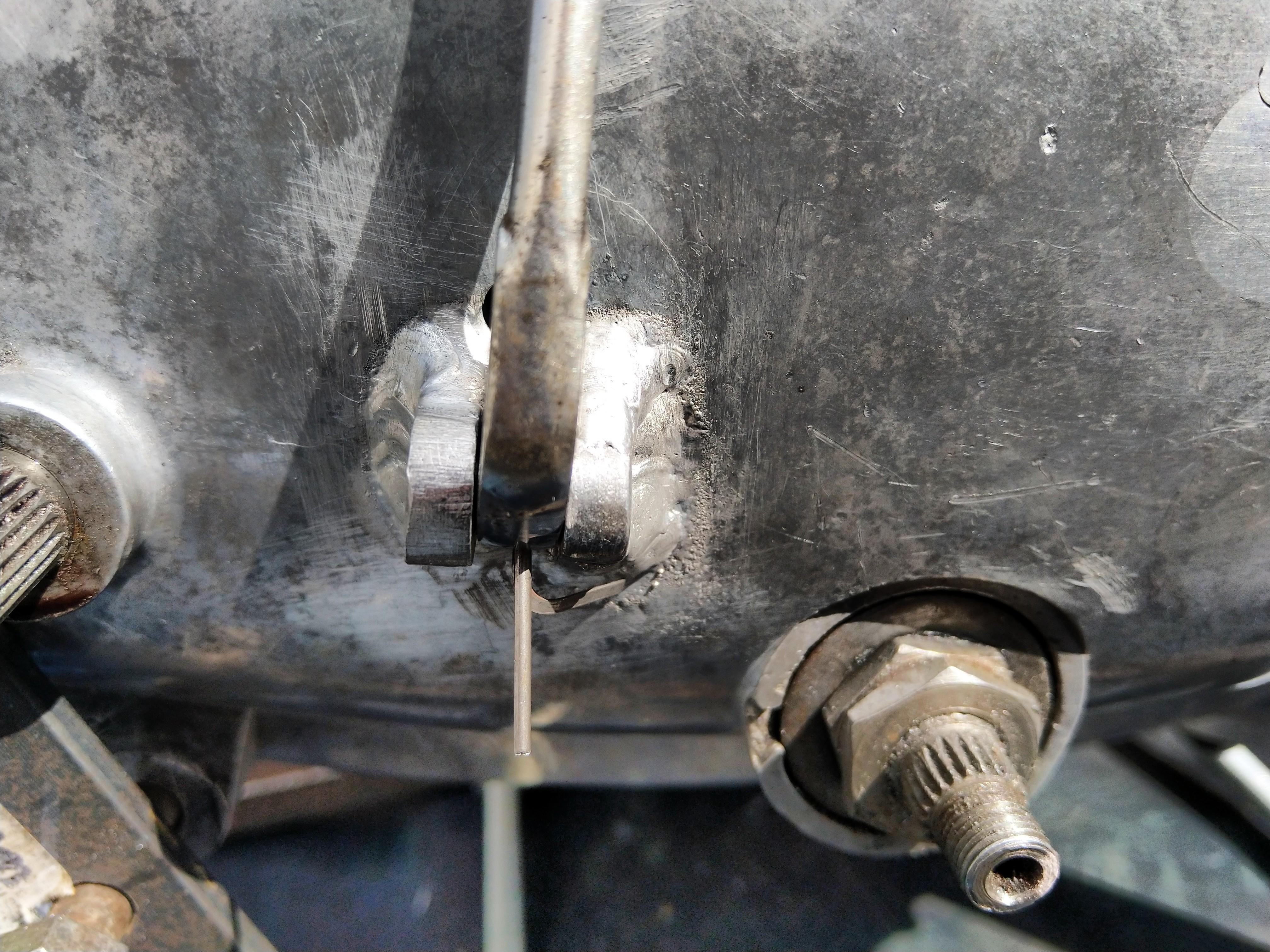

Broken tabs fixed/welded
(I was told it was a biatch due to it being produced 66 years ago.....)
"The Stash" :tongue:

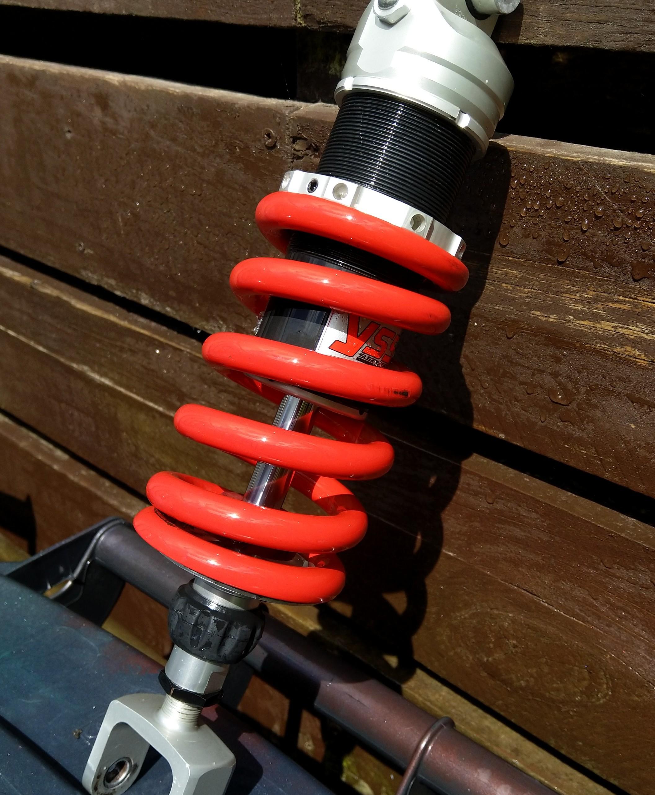

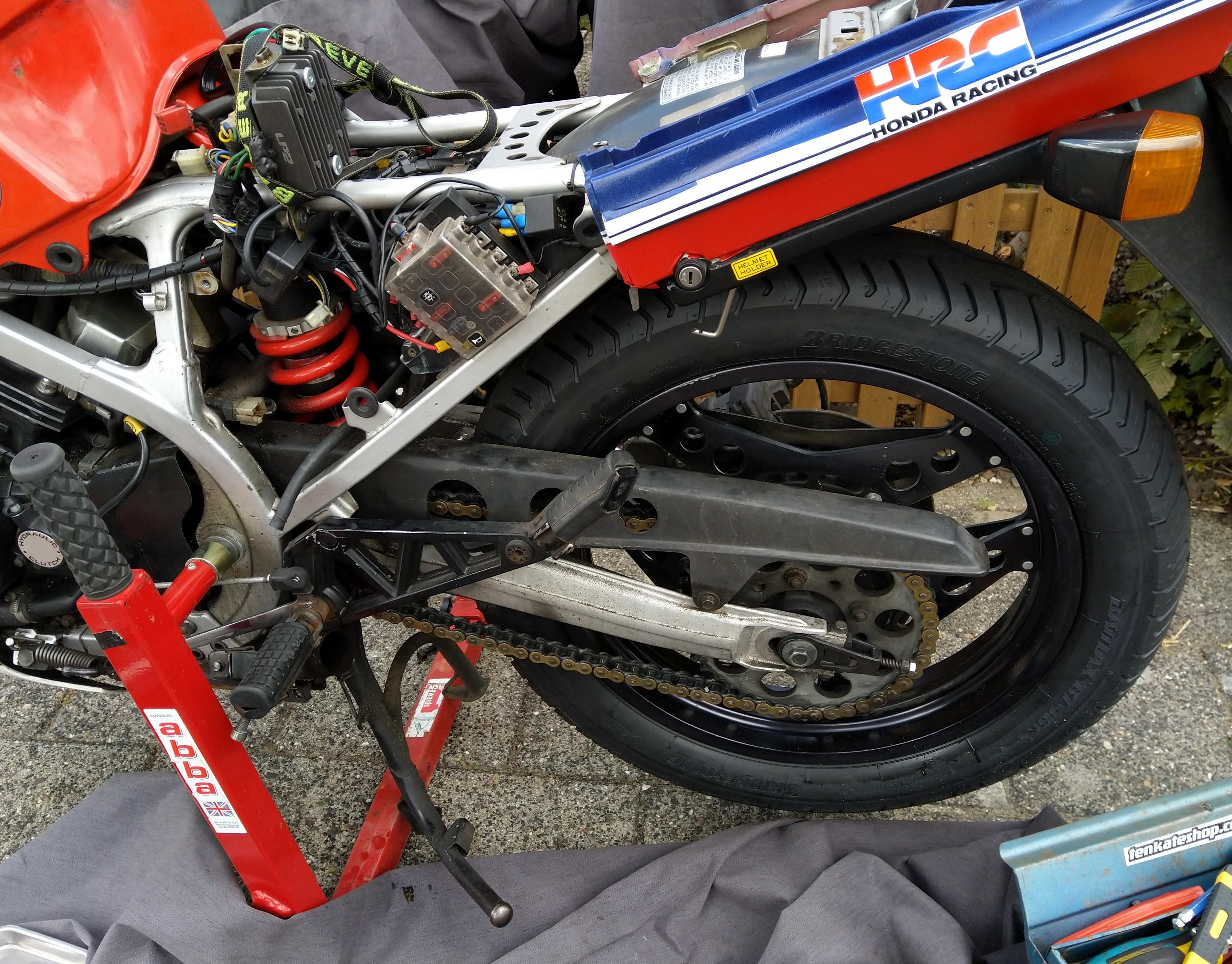

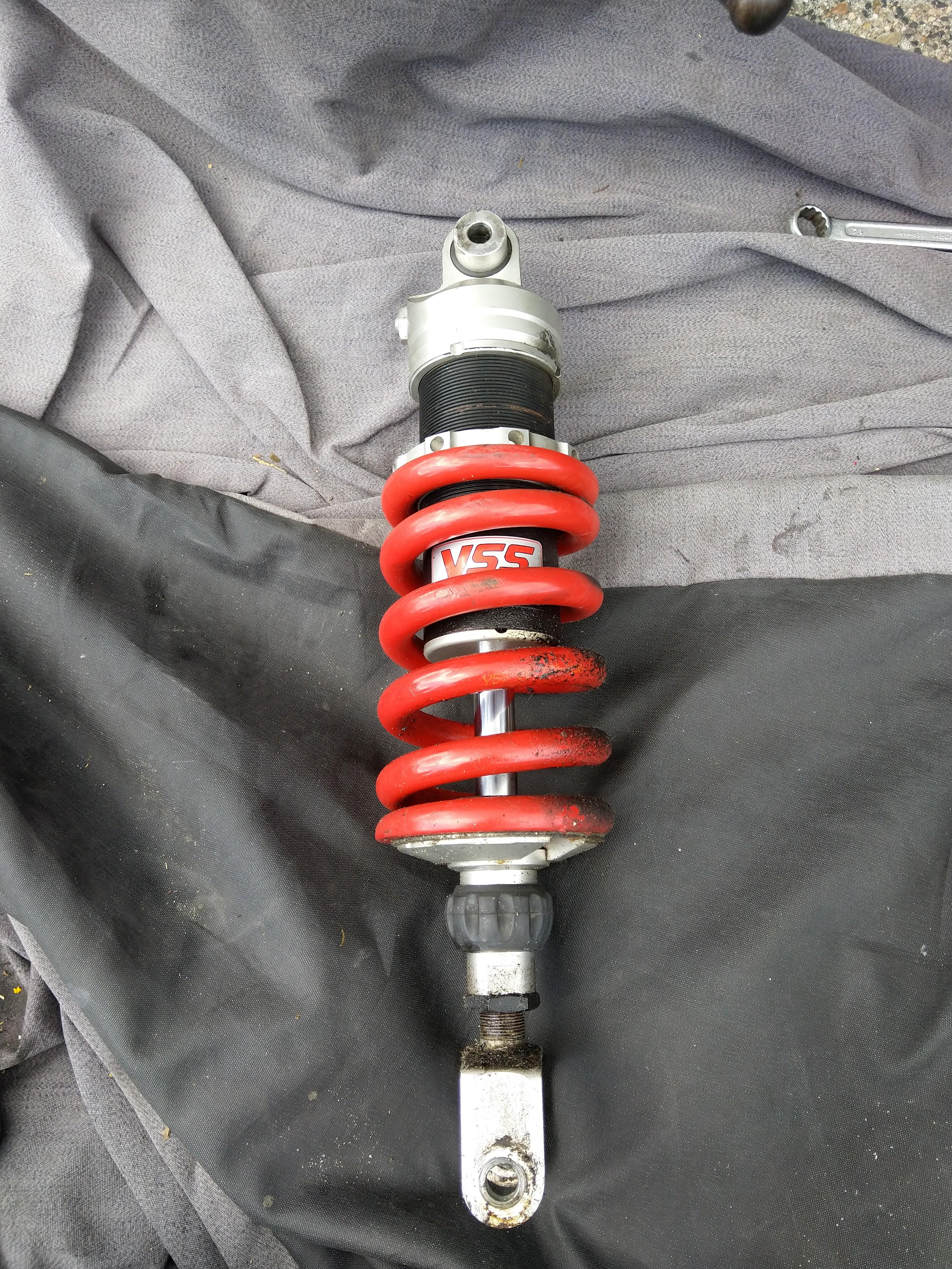

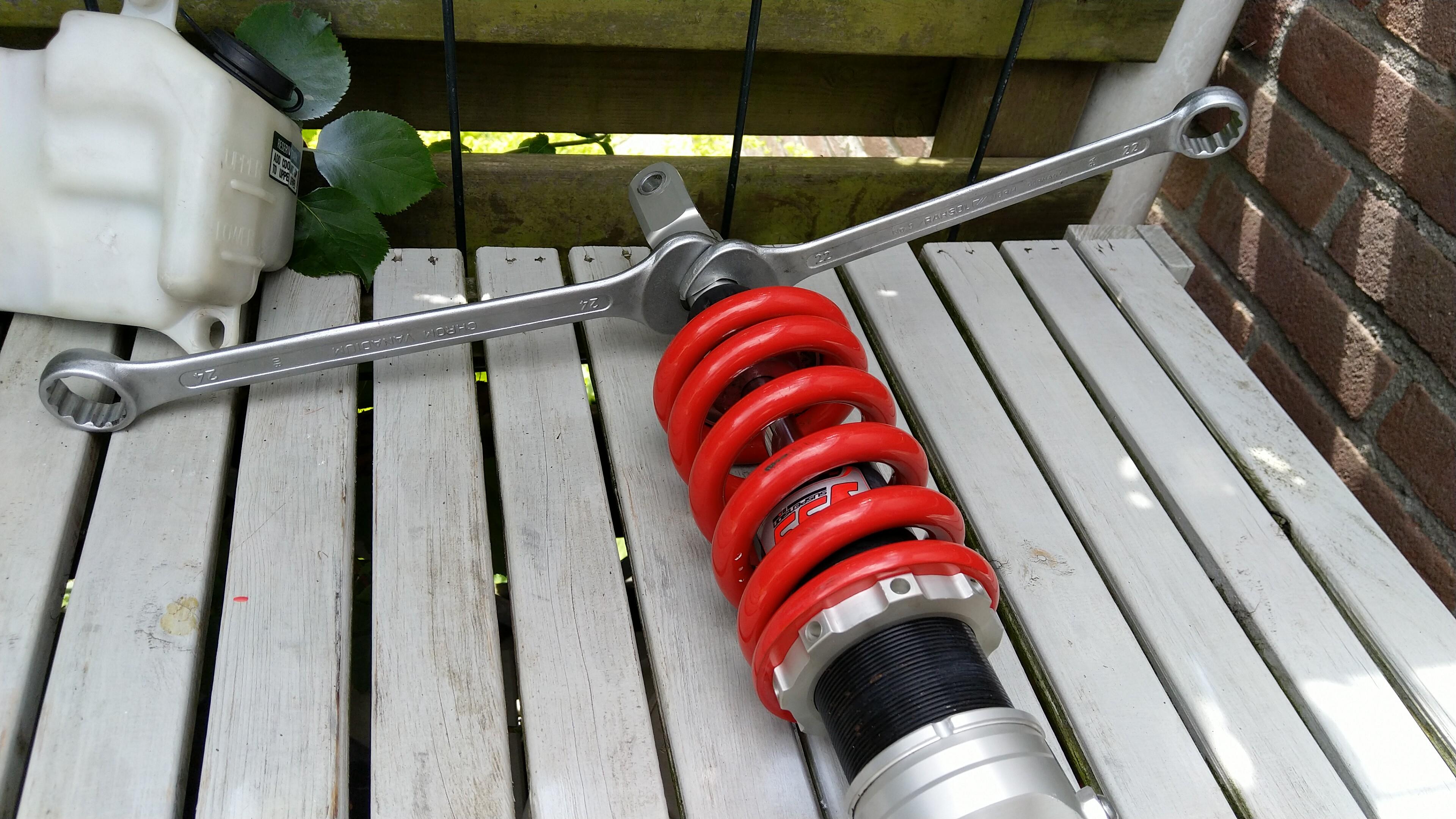

Standard rear wheel is 110/90, but I prefer the 120.  In typical S F B fashion, I ordered a 120/90.  Which should have been a 120/80, just like the worn one....
Sure enough, the 9mm higher tyre led to the rear not to clear the ground when using the centre stand 😞
But, my YSS has height adjustment, so all ended well....

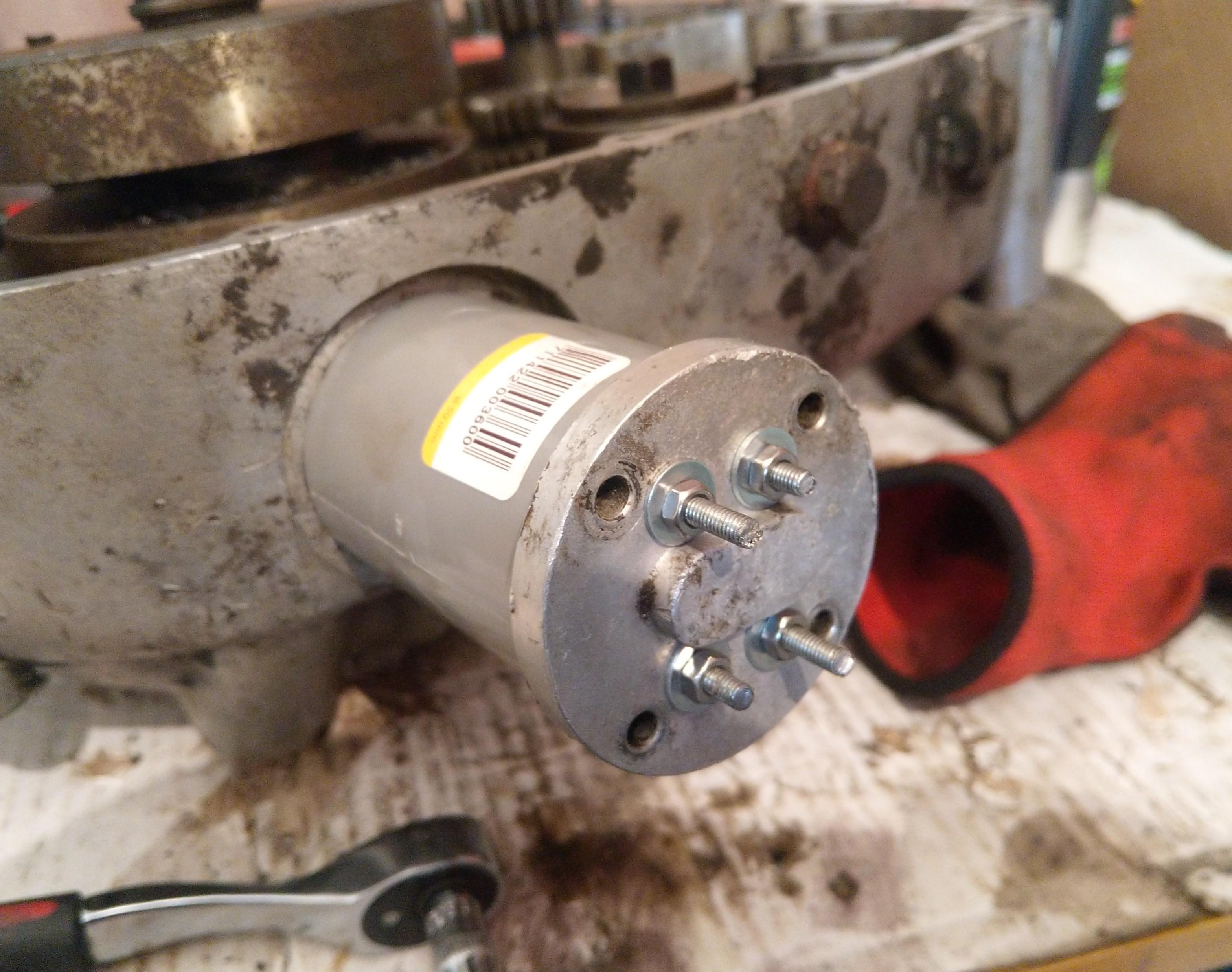

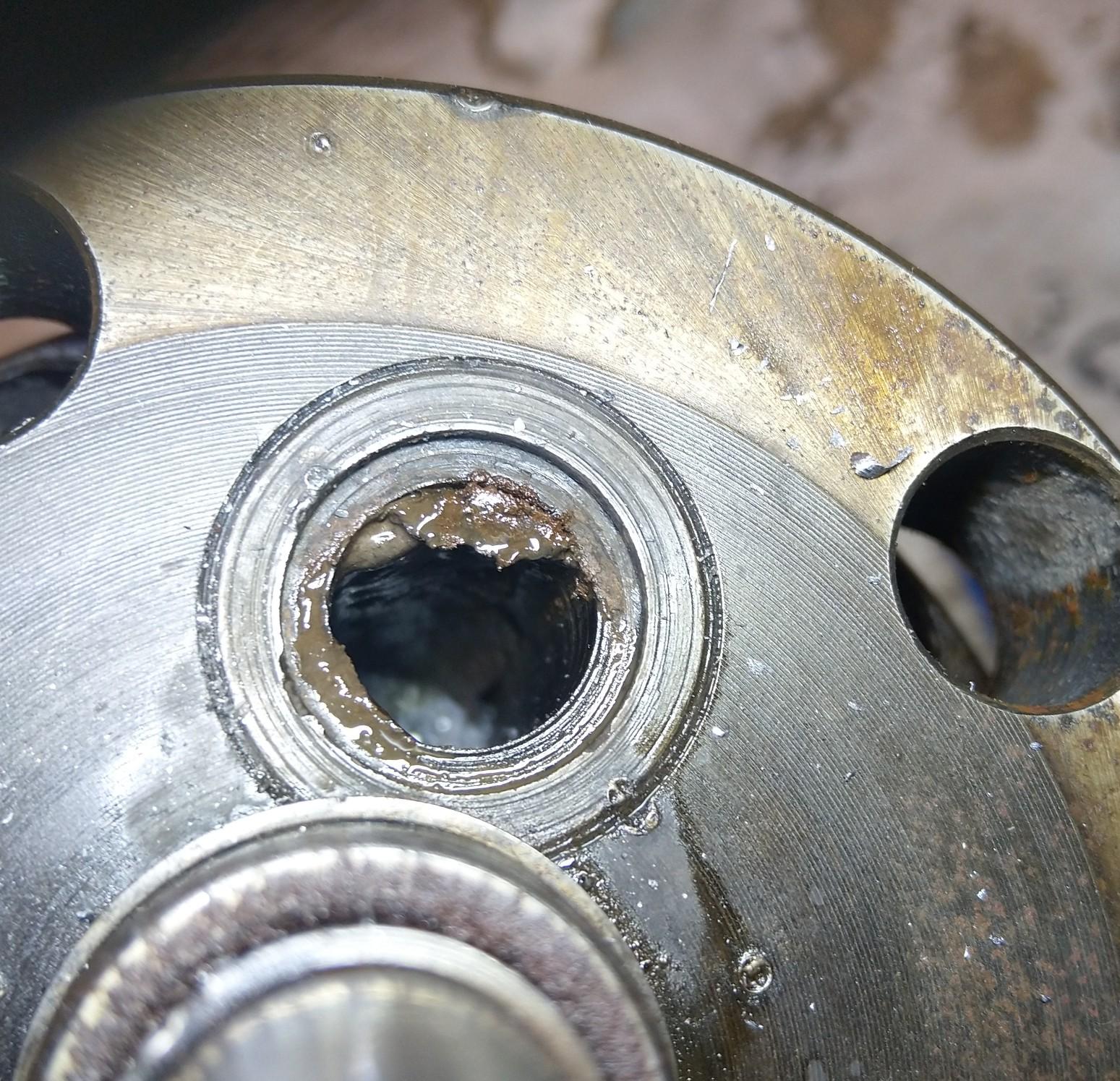

Using the donor engine (which had a seized head) to practise and learn.

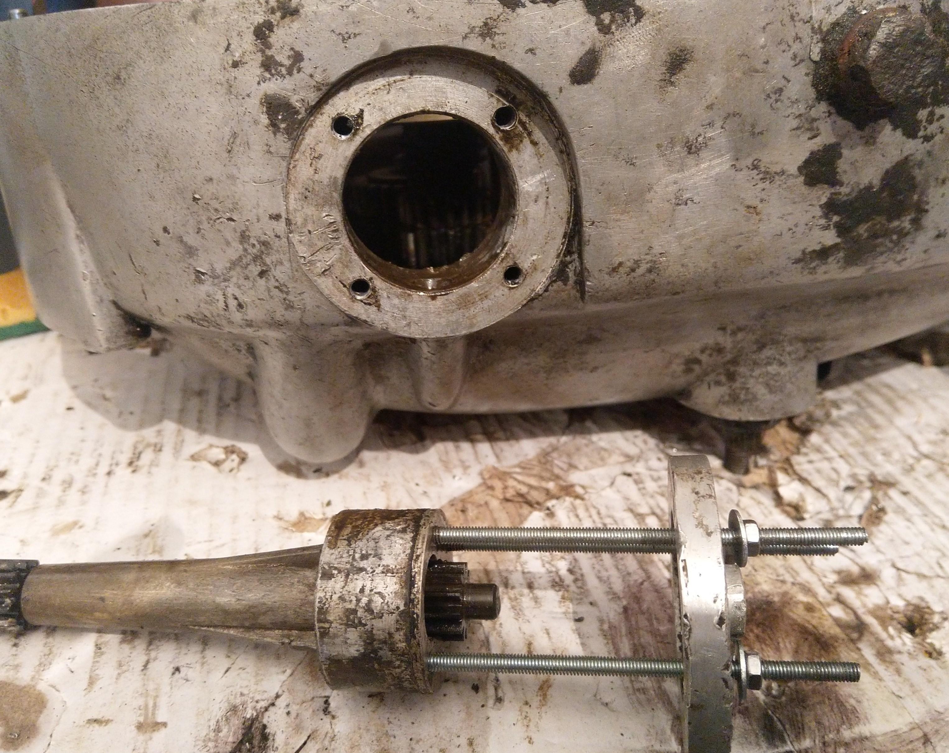

Oil pump removal
Thinking it through first...
Off to the DIY and start

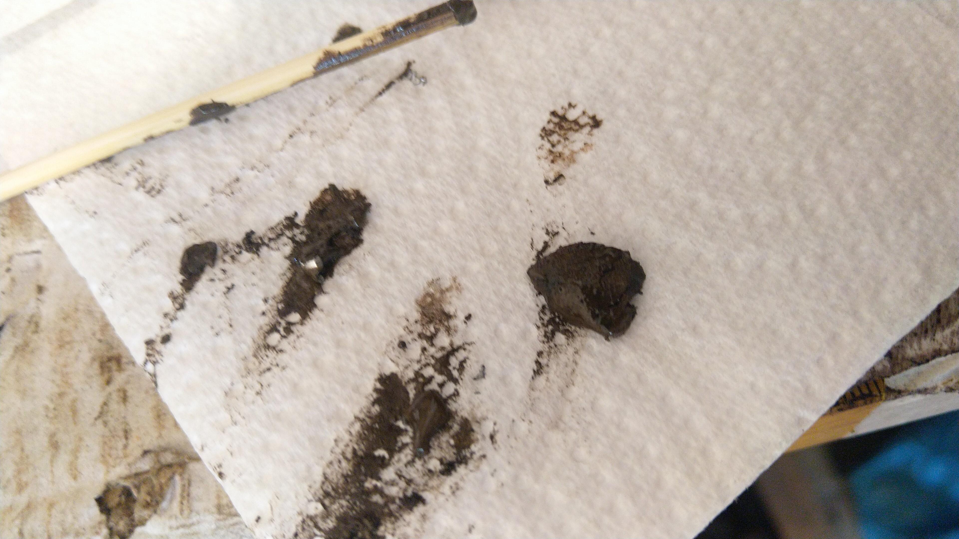

Cleaning out the big end
Lots of poo.....
Hhhmm, good thing this is not the engine I will use.
