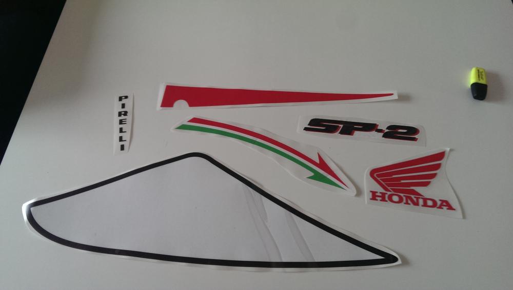

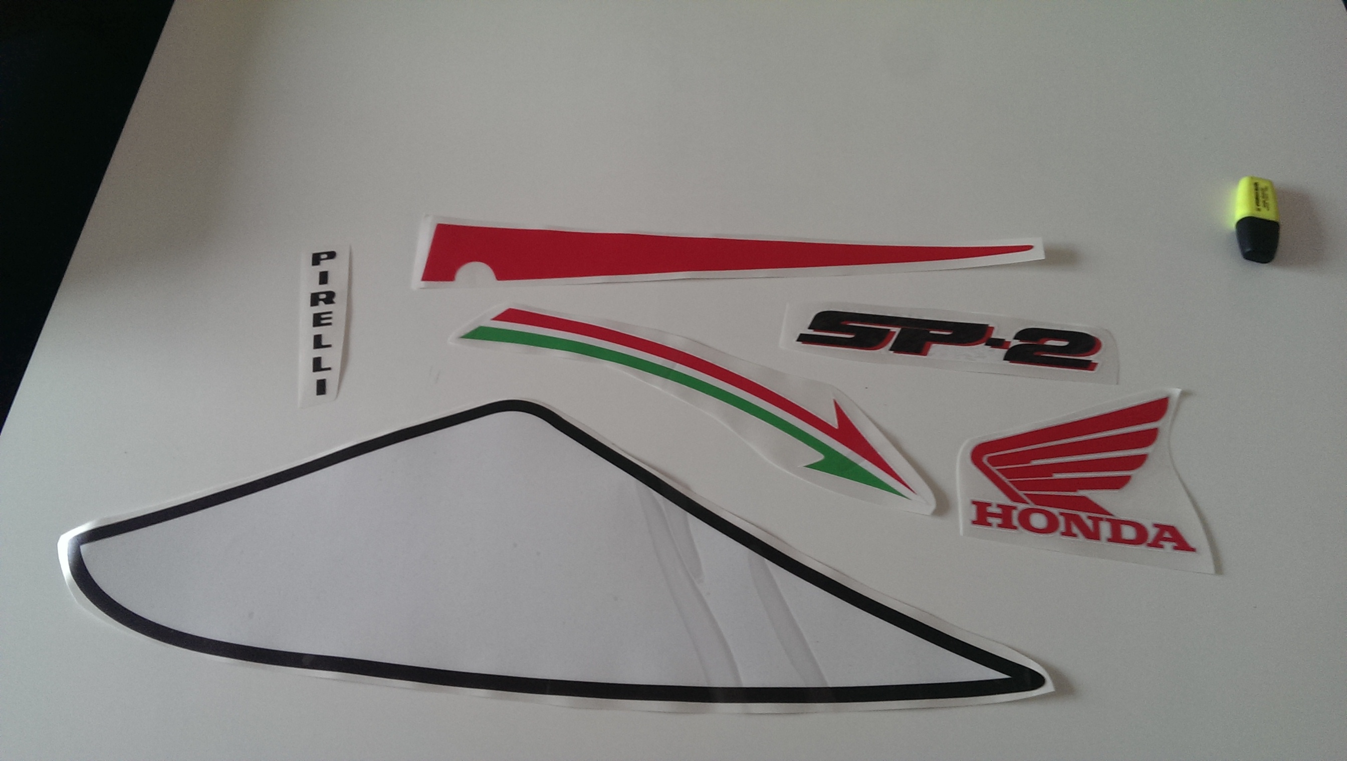

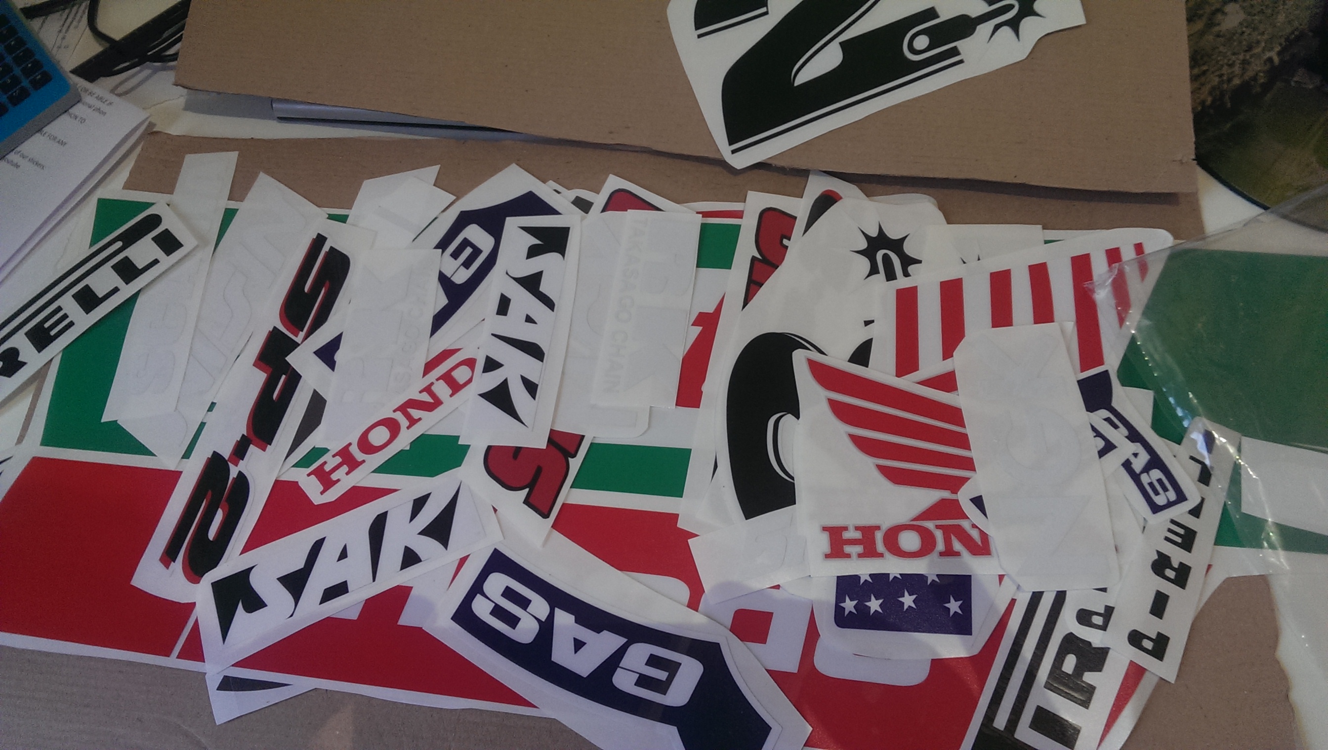

The stickerset came in, quality looks really good. And as per their instructions, the material is bubble-free allowing air to be pushed out. No soapy water etc since the stickers can be pulled off for 2 days. Any wrinkles in the material will be "righted" with a hot air gun. We will see!
Will fit and ride with the chinesium panels for a while first, see how they hold. Before putting the decals on.
Asked (and I got) to replace the stickers that emulate the headlight with the stars and stripes from another RC51 set
:beer:
and since I will be running PIRELLI instead of MICHELIN, they changed those as well
(OK one set they made in black; whereas these go on the under cowl; they will fix this in Yellow or yellow/red)

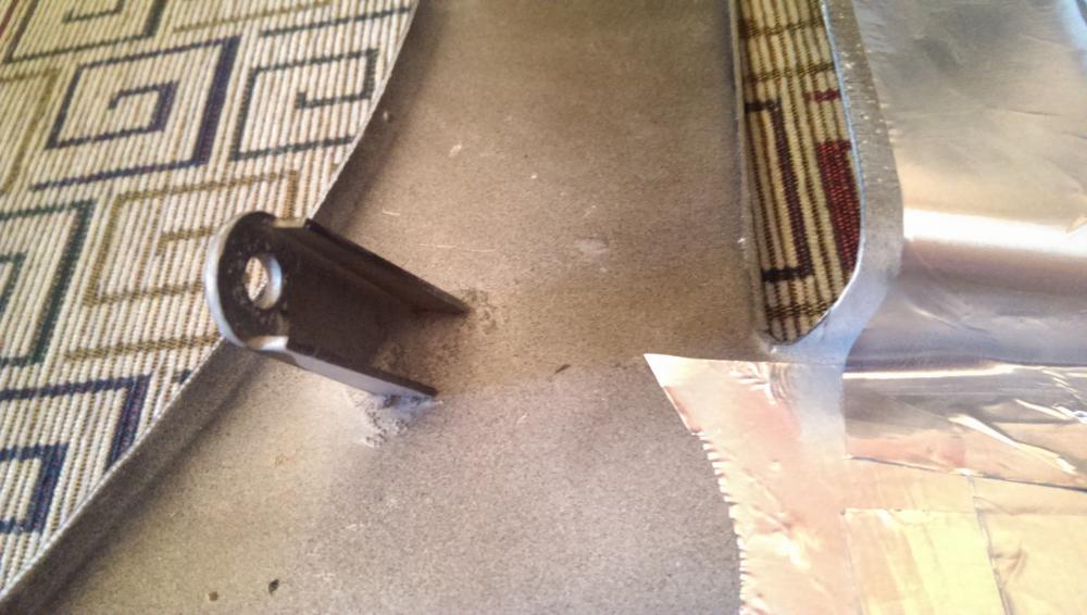

Now here is a question to y'ALL (it is a Colin Edwards set...)

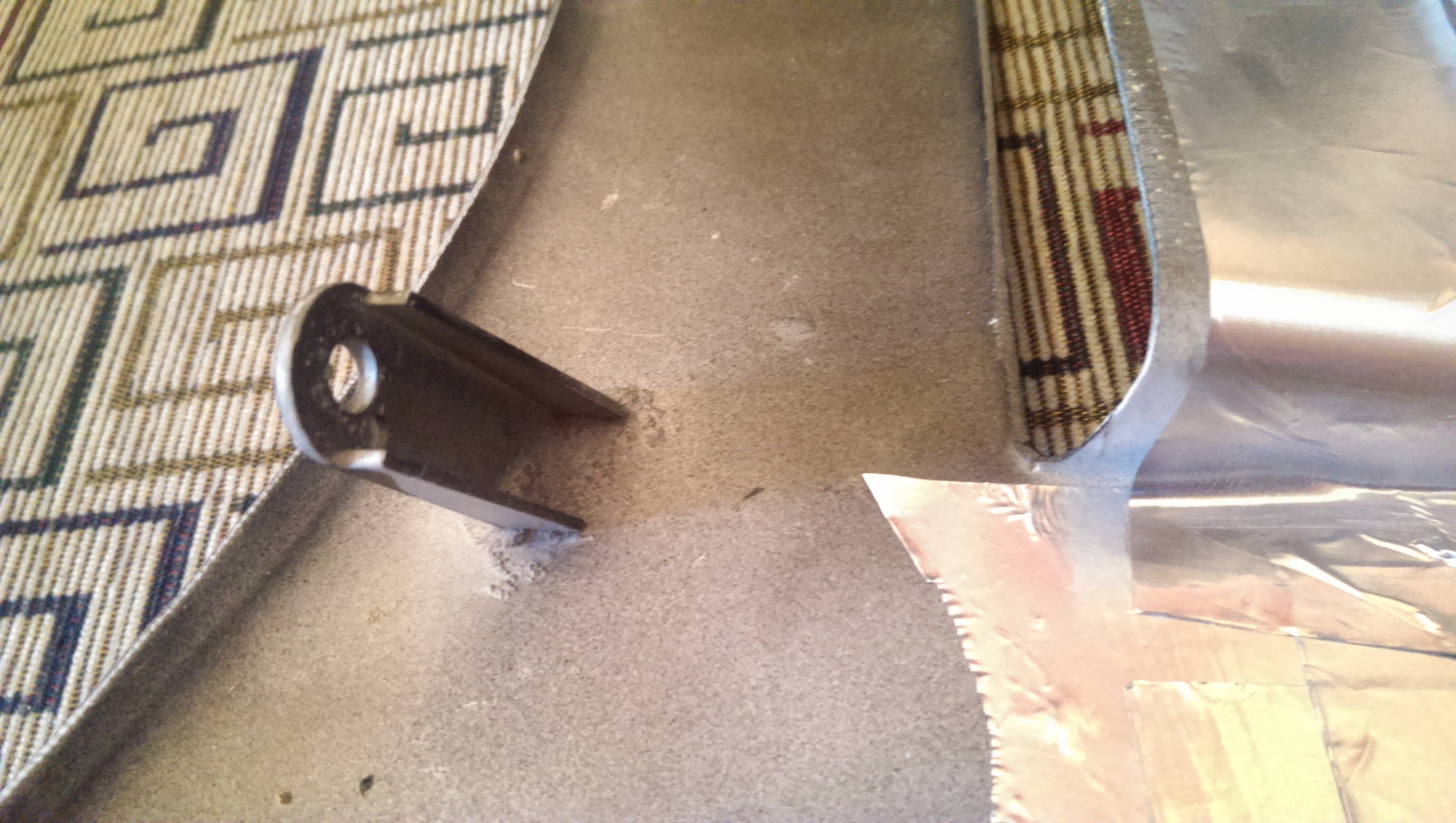

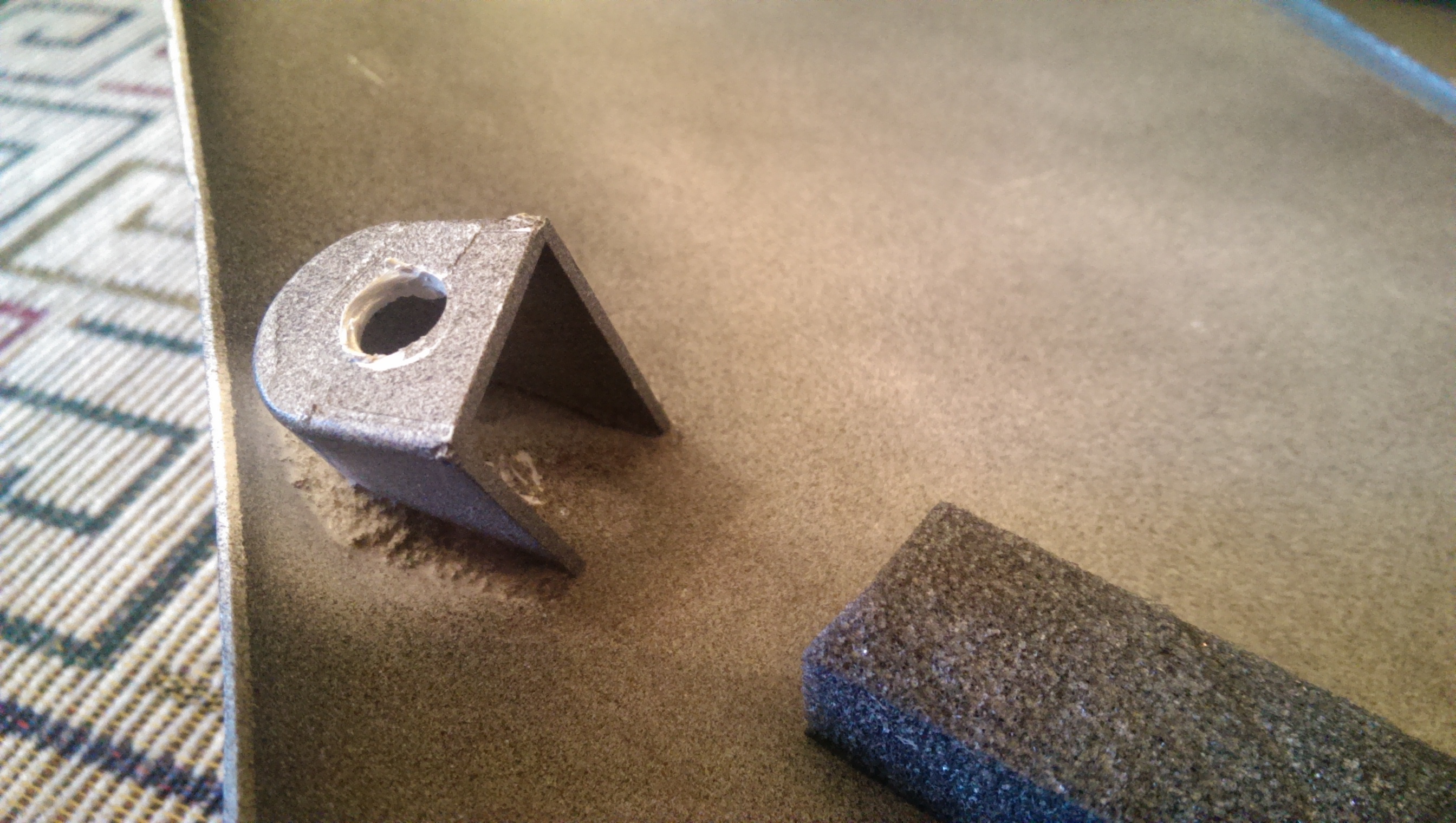

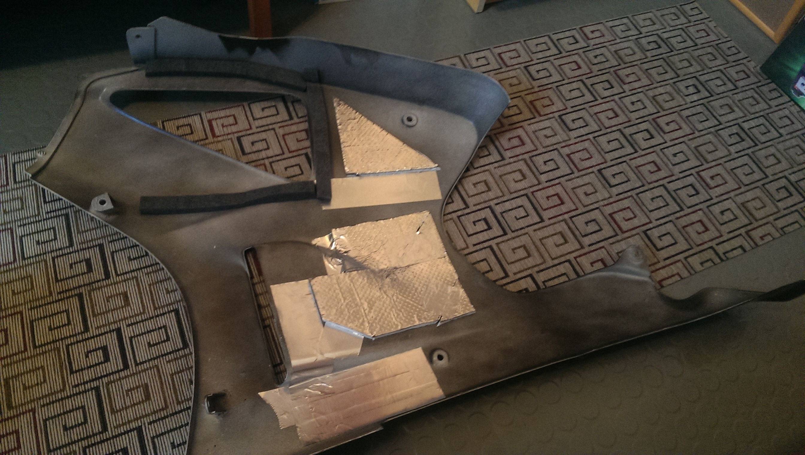

The chinesium ABS panels' (no idea of pressed or molded) tabs look like this.
Reportedly they can break, so what can I do in advnace to reinforce? Sperglue&bakinf soda (sodium bicarbonate)
IMAG9565.thumb.jpg.7d7918e4ade70eaec15657642bc4899d.jpgIMAG9566.thumb.jpg.c95afb264dc8f030a32ec2ada527aad3.jpg
The "radiator surround foam bits"were not included with the panels and the OEM bits are like $7 a piece (and you need 6....). So I bought some "Soudaband". A self expanding foam (20x20mm) with a sticky tape backing. $8 for 5 meters or so :goofy:

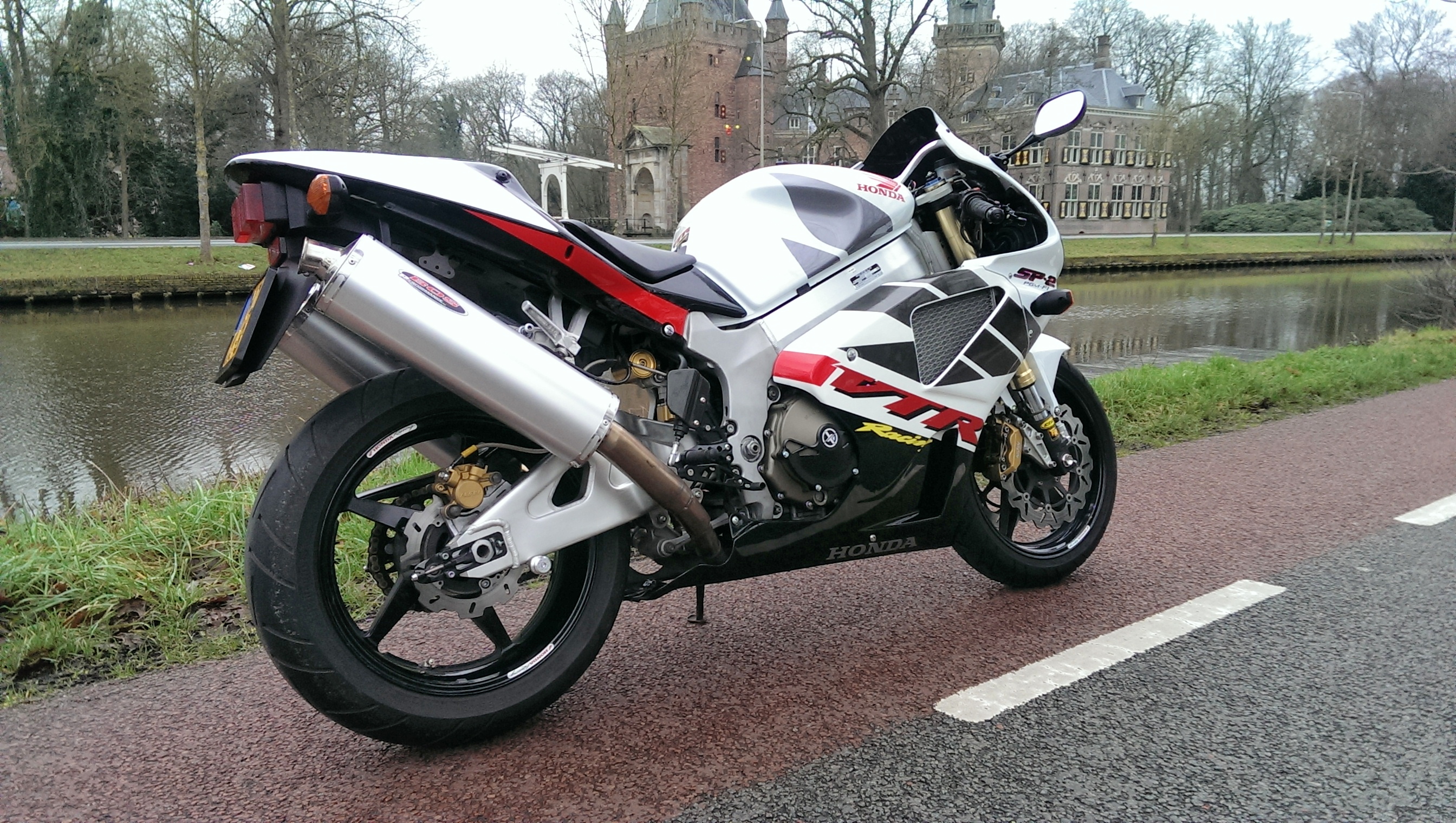

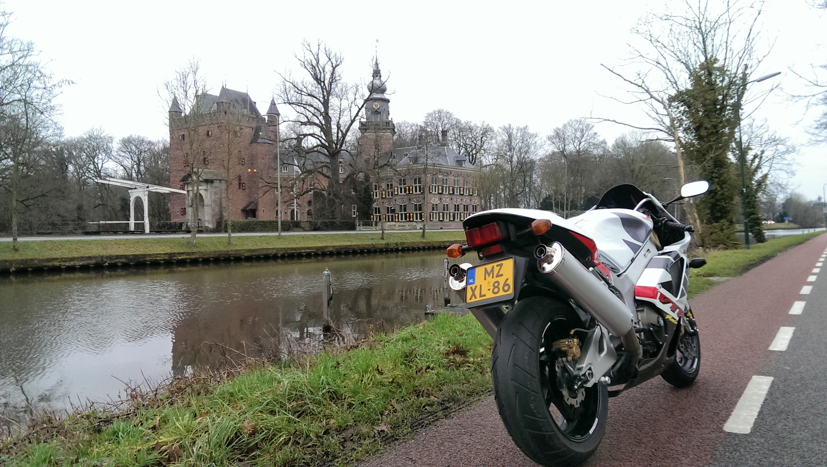

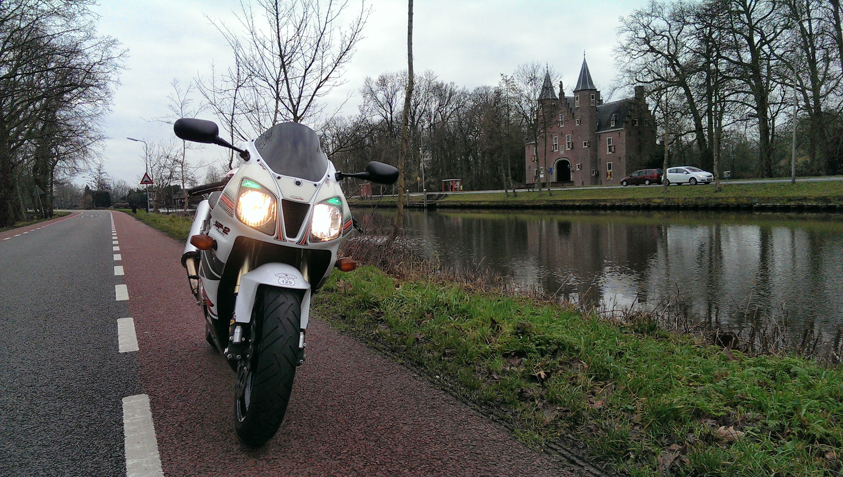

Nippy but nice, 1st ride in 2018. Testing the chinesium (side/rear) panels and the new FactoryPro shift star kit.
All good!.
I had a problem with hard to get into neutral and that is 100% solved. Shifting feels solid/smooth.

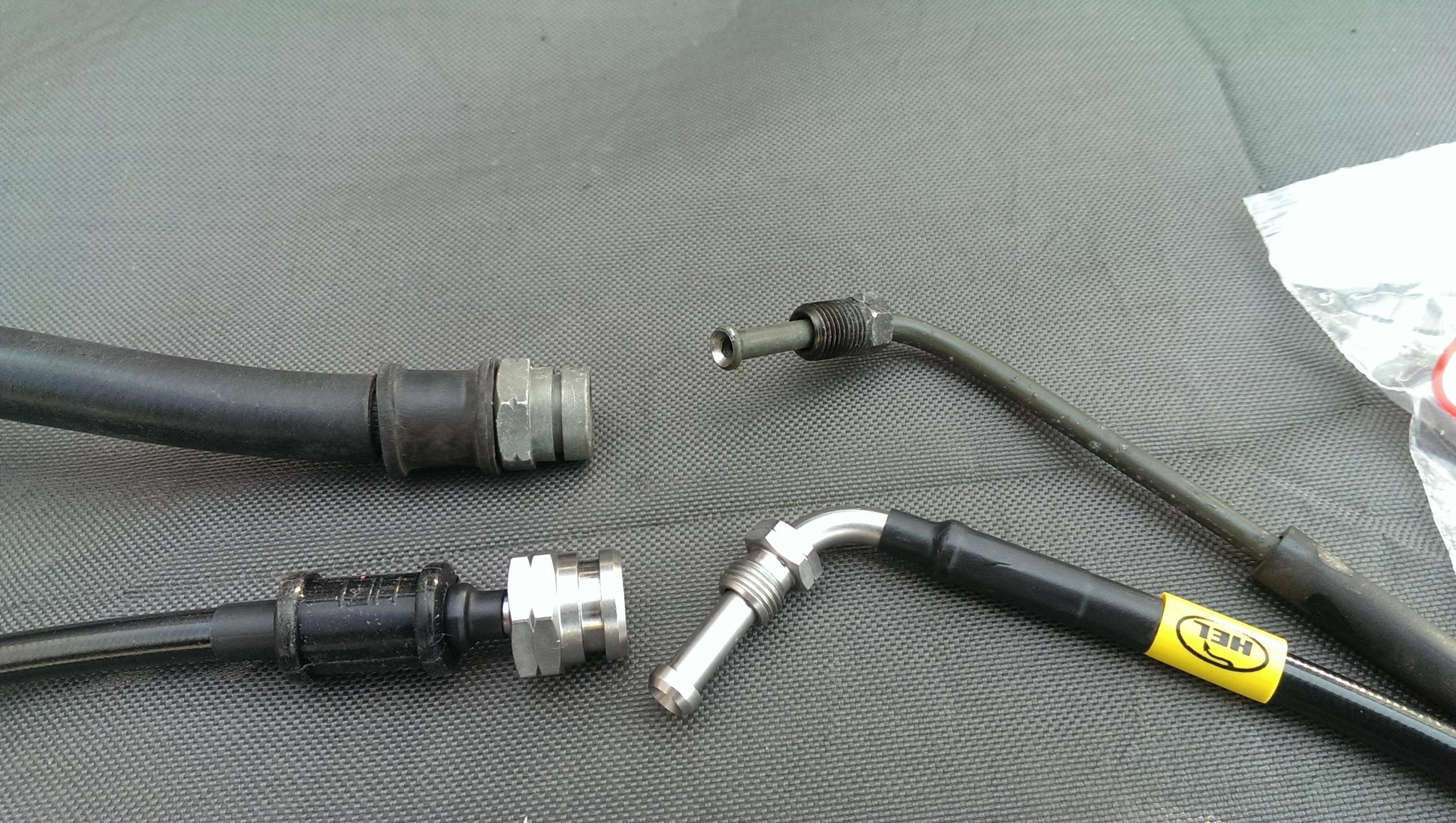

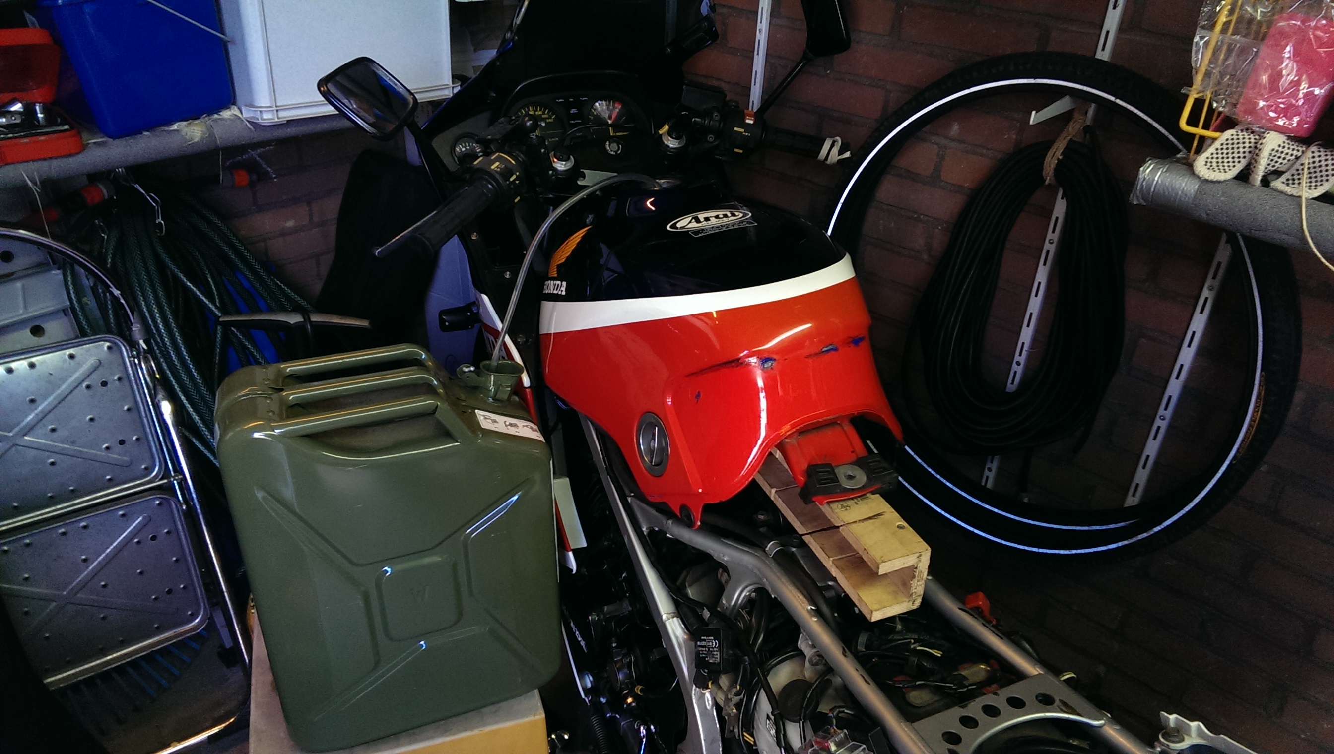

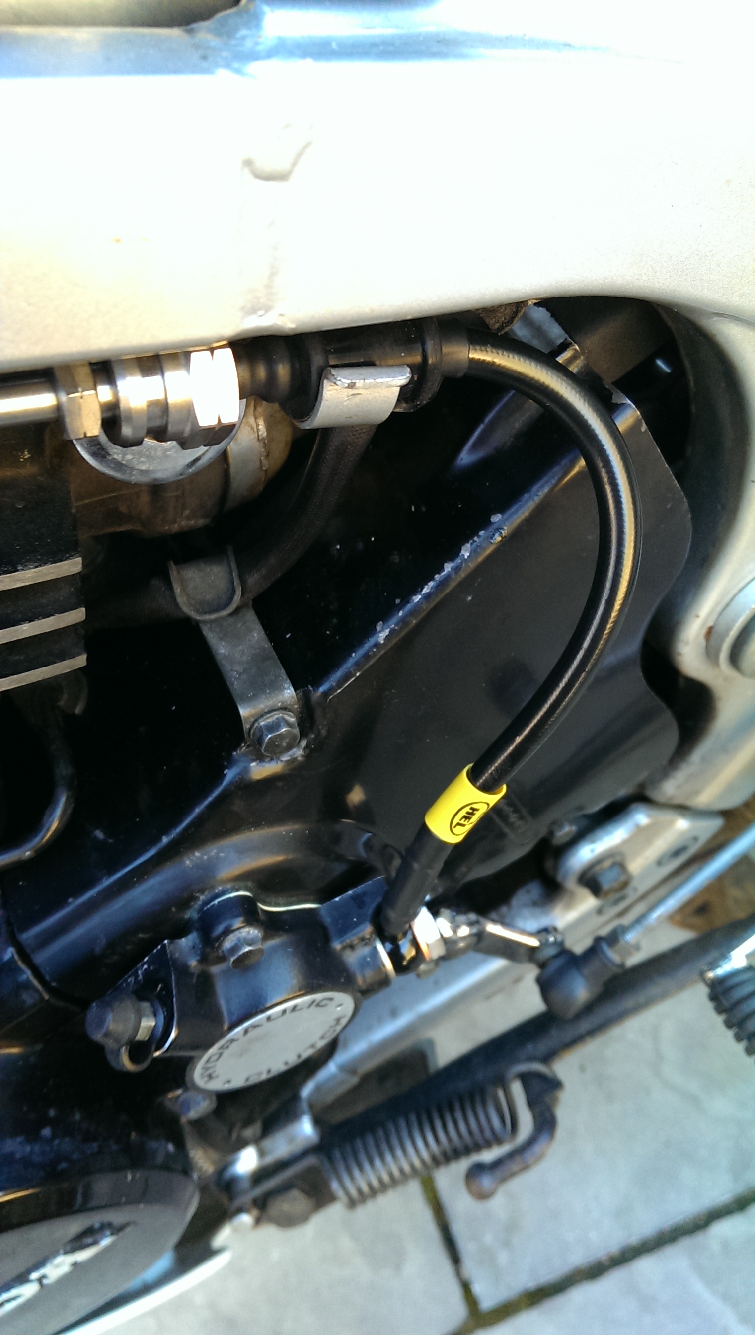

Not neglecting my little cougar/puma :-)

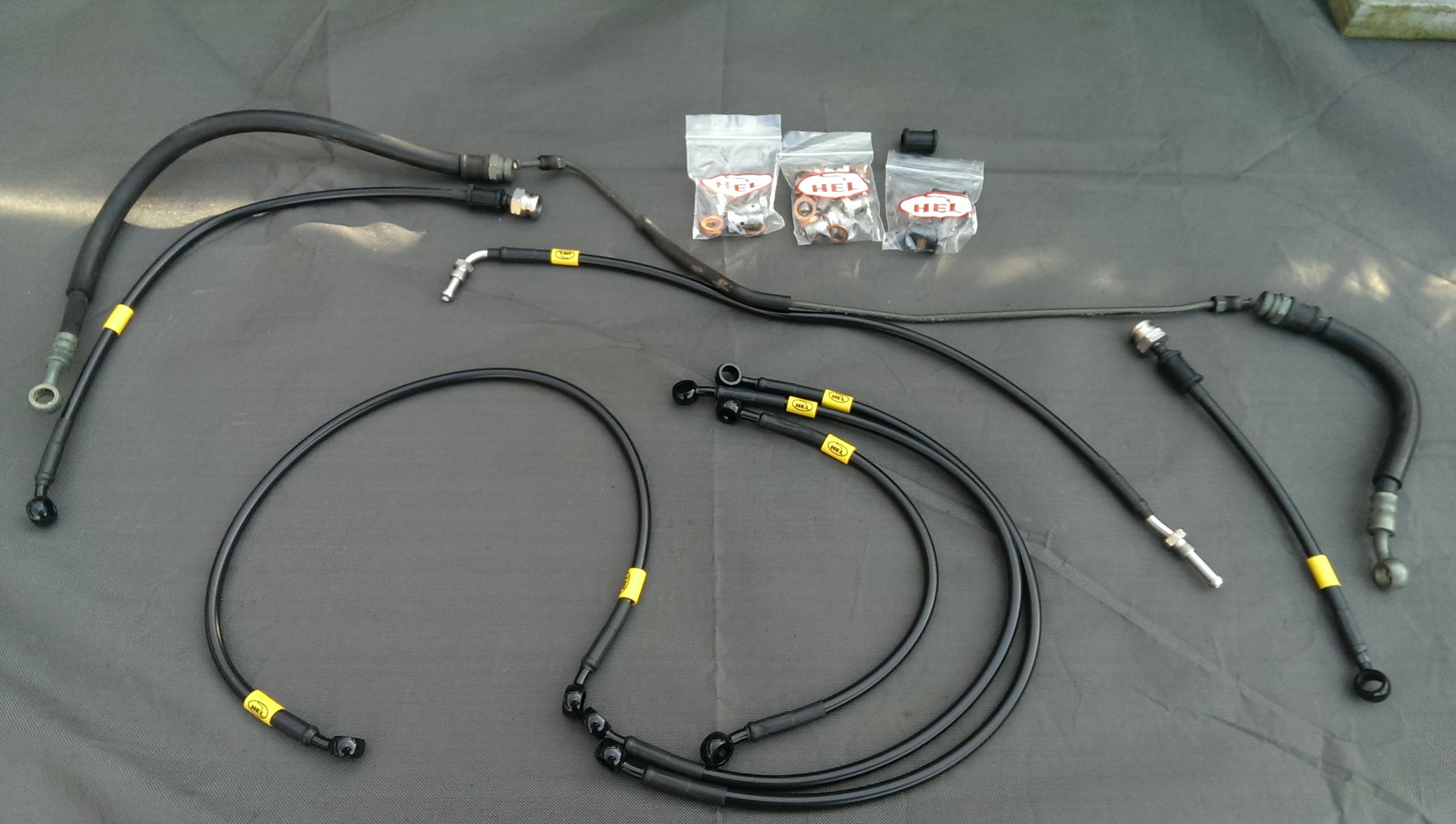

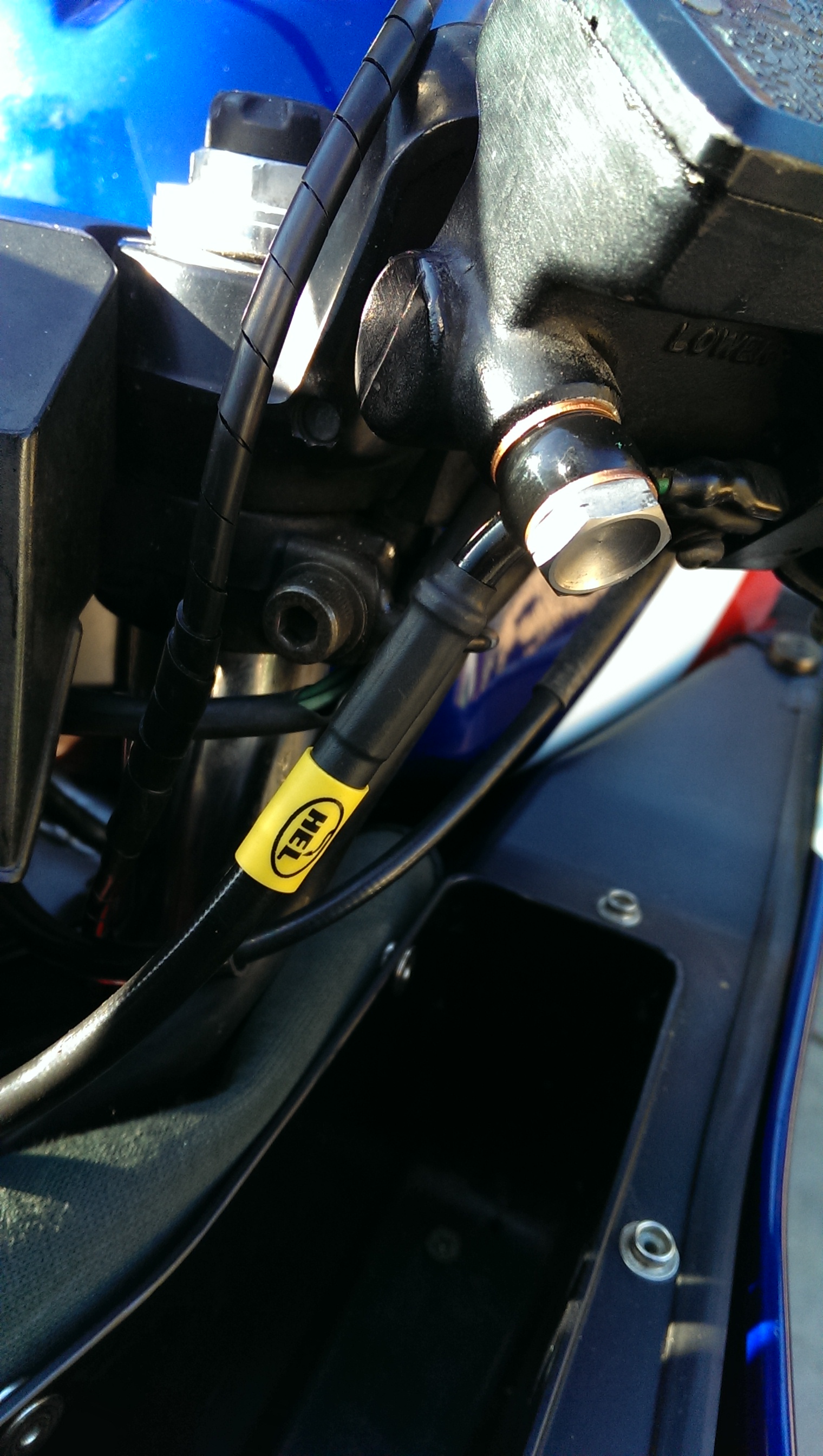

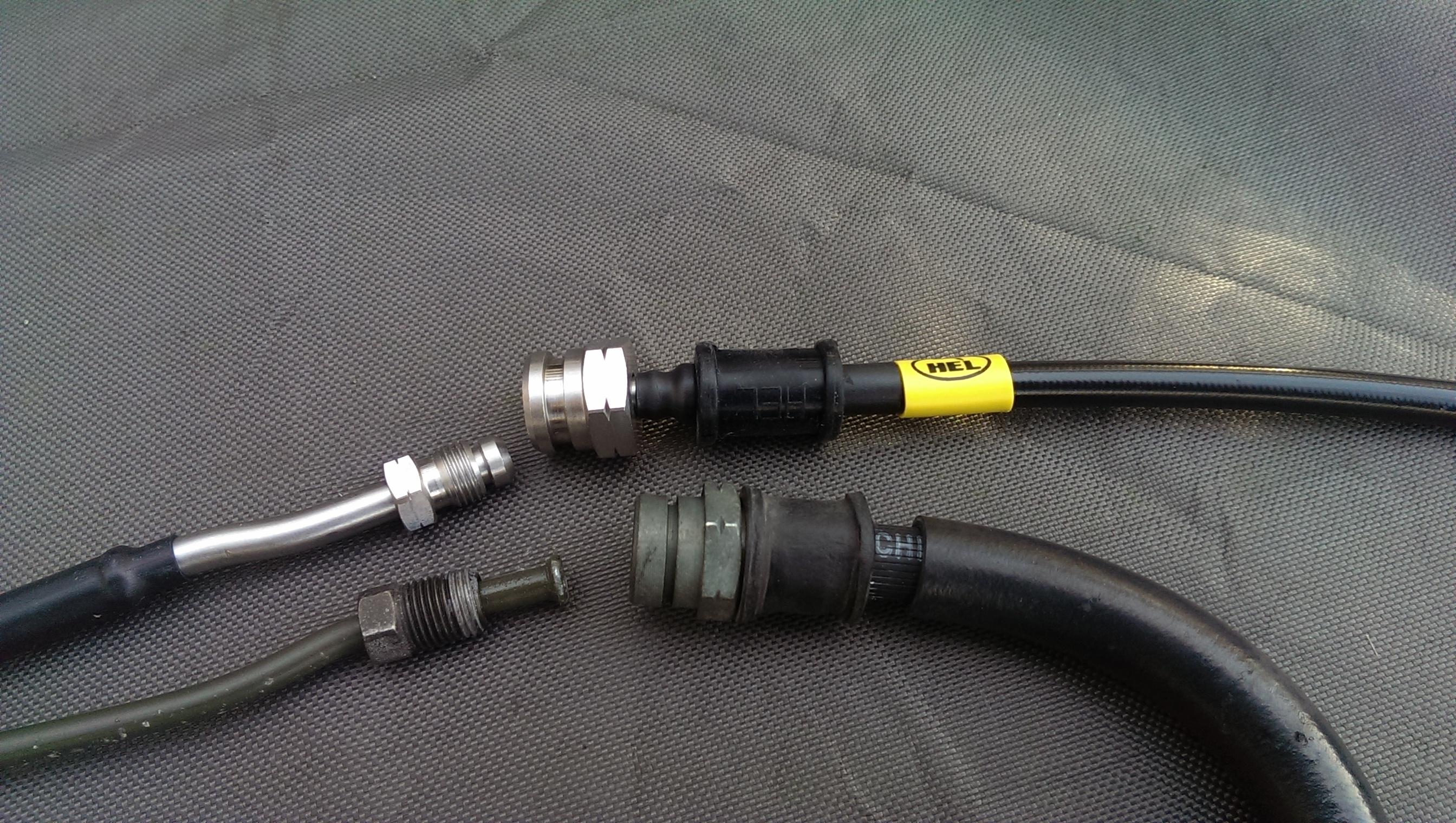

HEL UK didnot have the clutch line in their catalogue, so I sent them mine so they could copy.  I could have gone for a single line of course, but prefer the OEM look :goofy:         :beer: to Shaun from HEL!

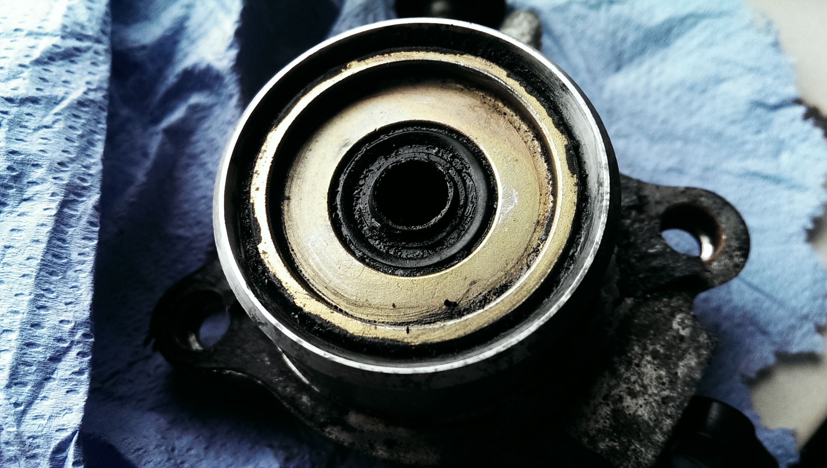

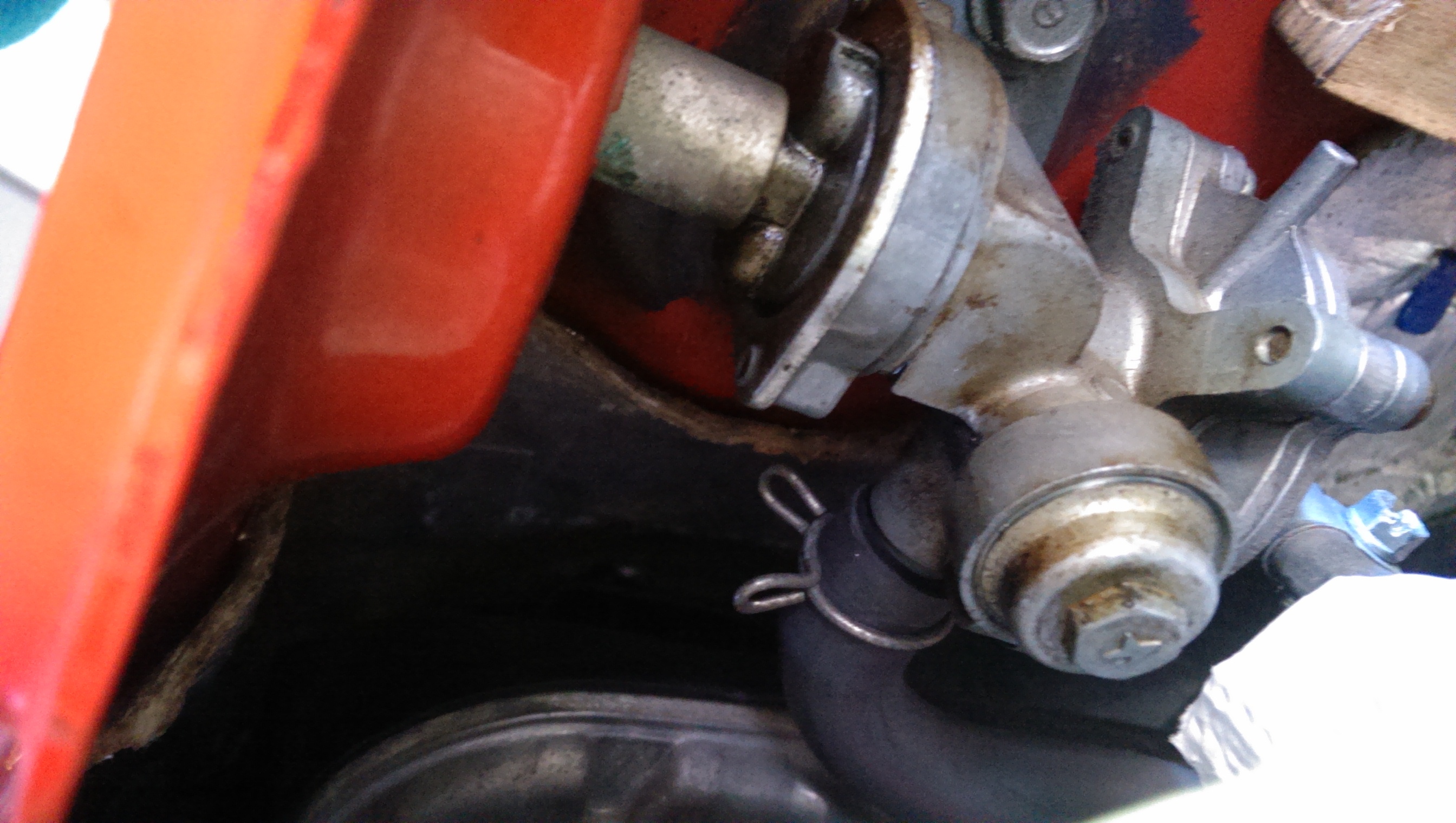

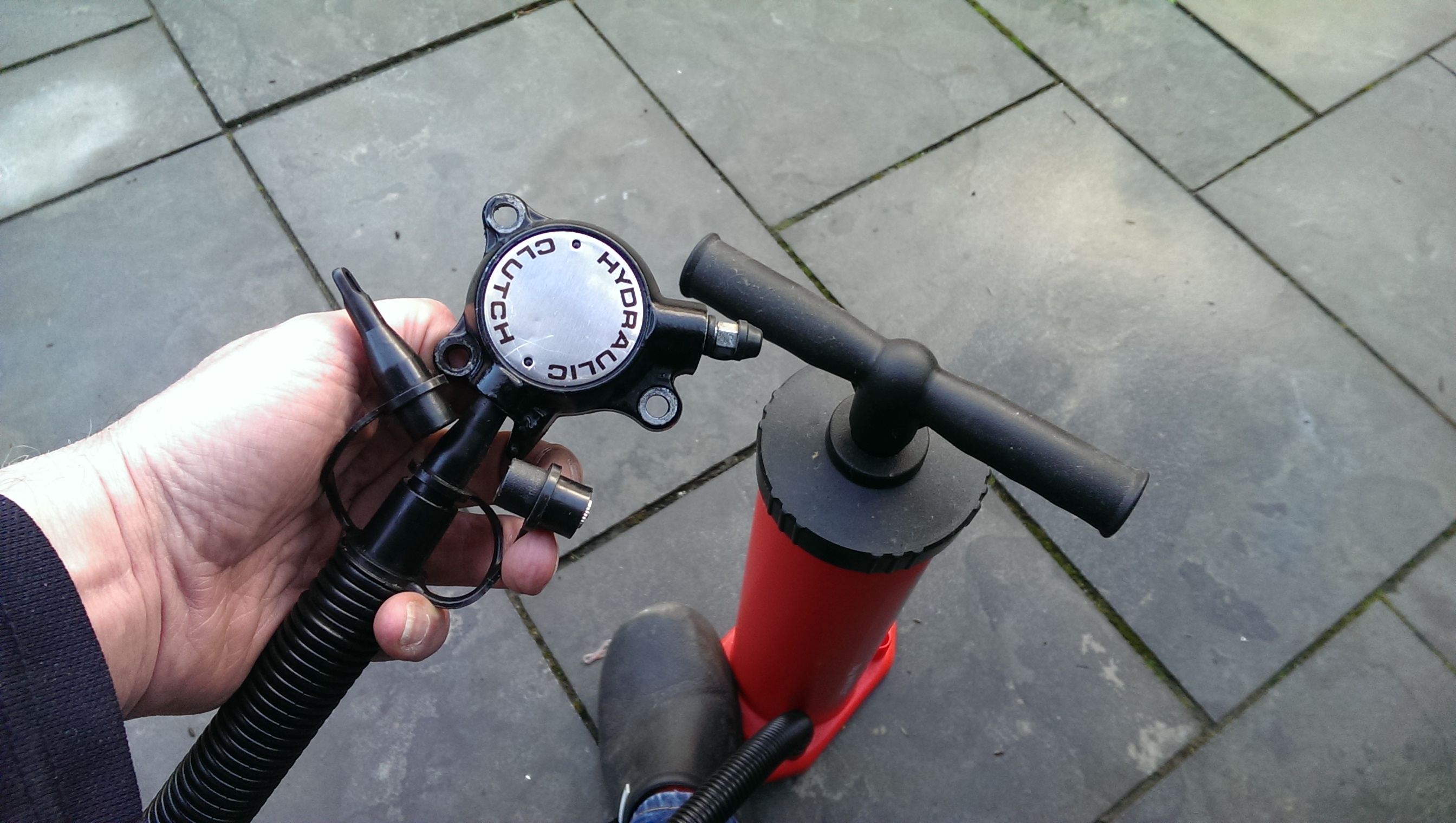

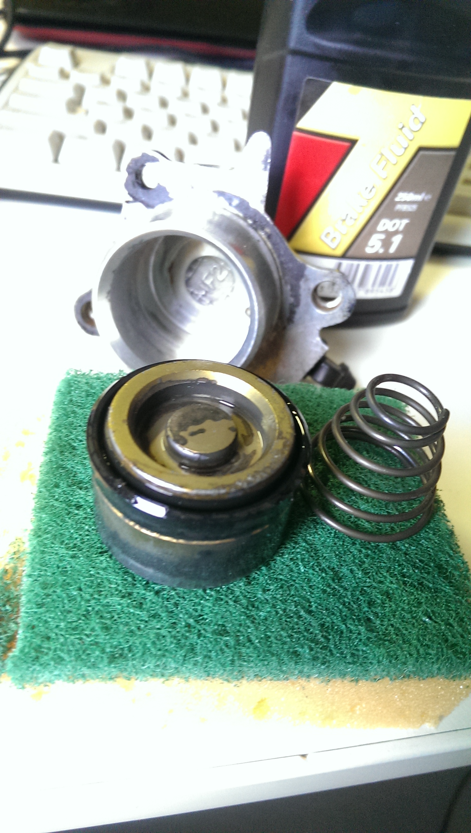

Decided to give the clutch slave a little TLC.
Clean as much as possible from the outside (compress the piston and clean crud) in the hope it would pop out by itself.
Nope.... I donot own an air compressor...
But then I realised that last month, I nearly chucked out this airbed/rubber boat pump....   Nearly!
Aye, that did the trick

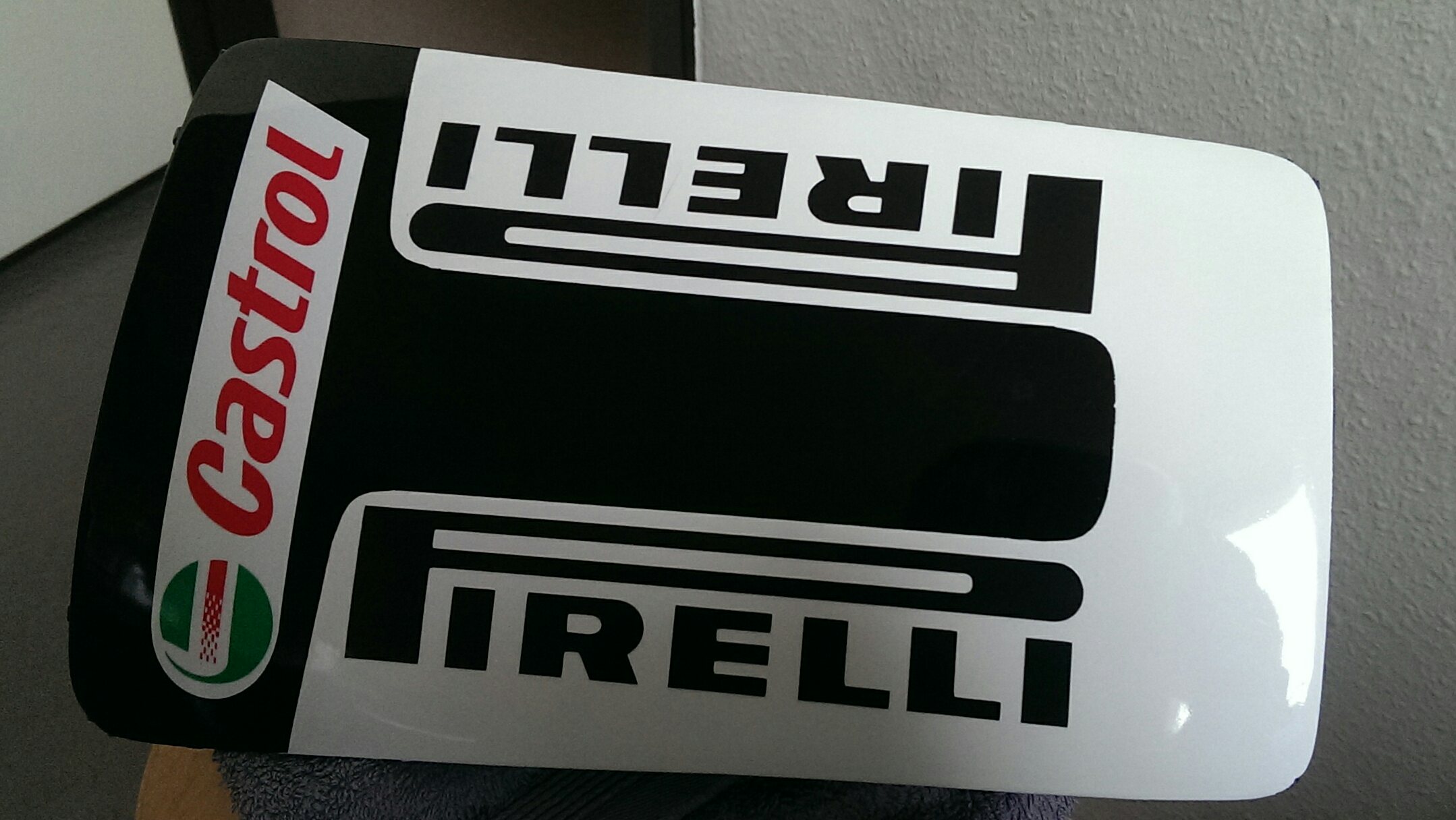

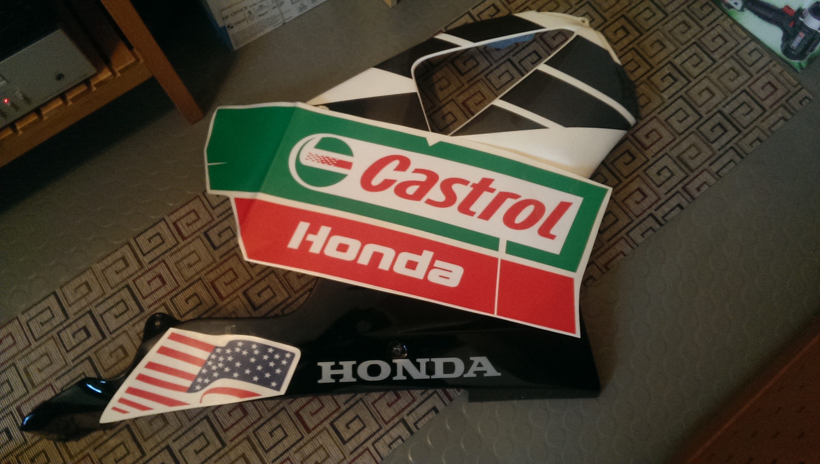

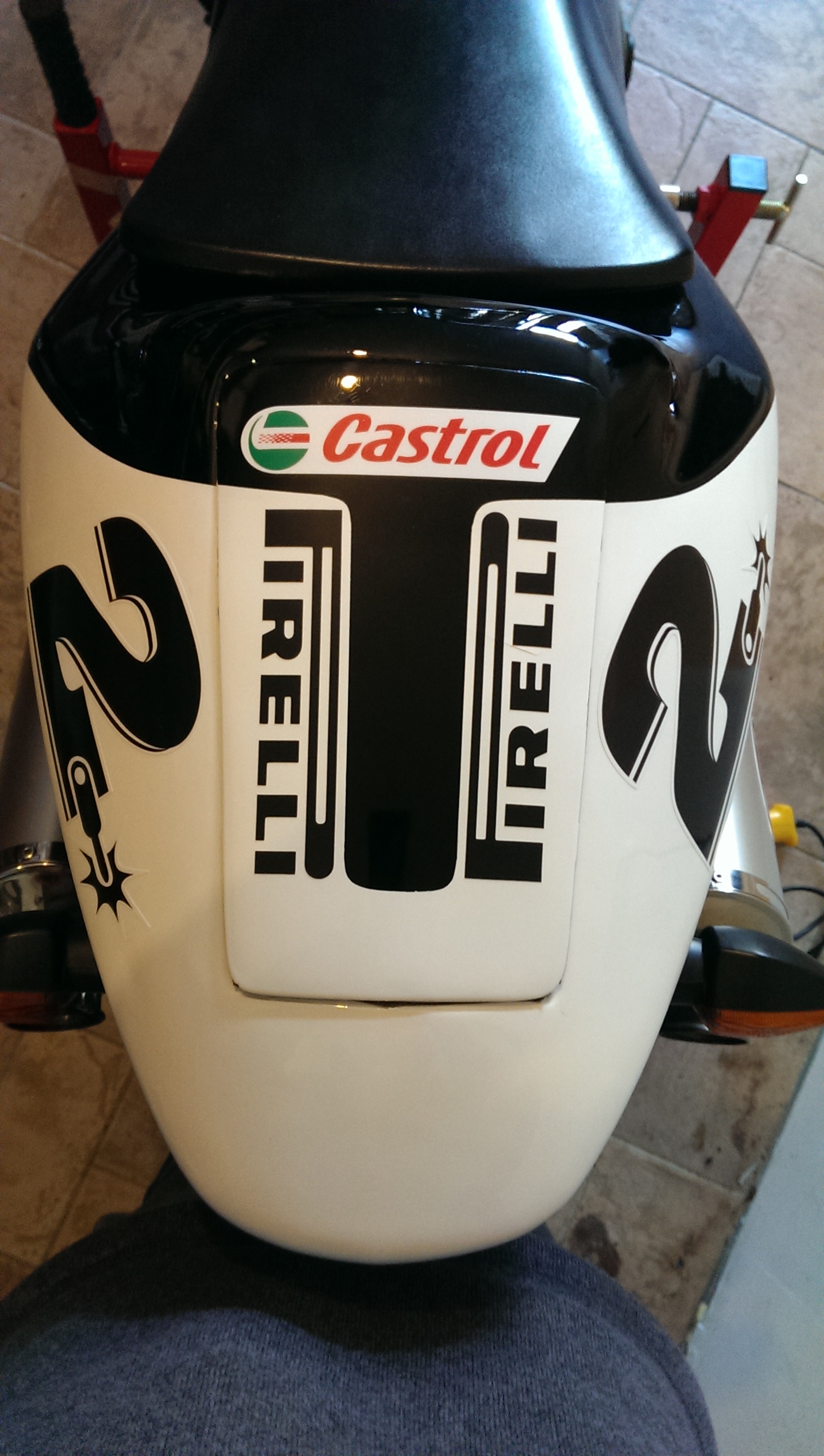

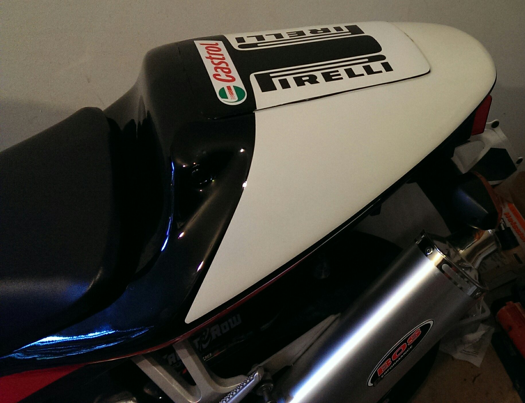

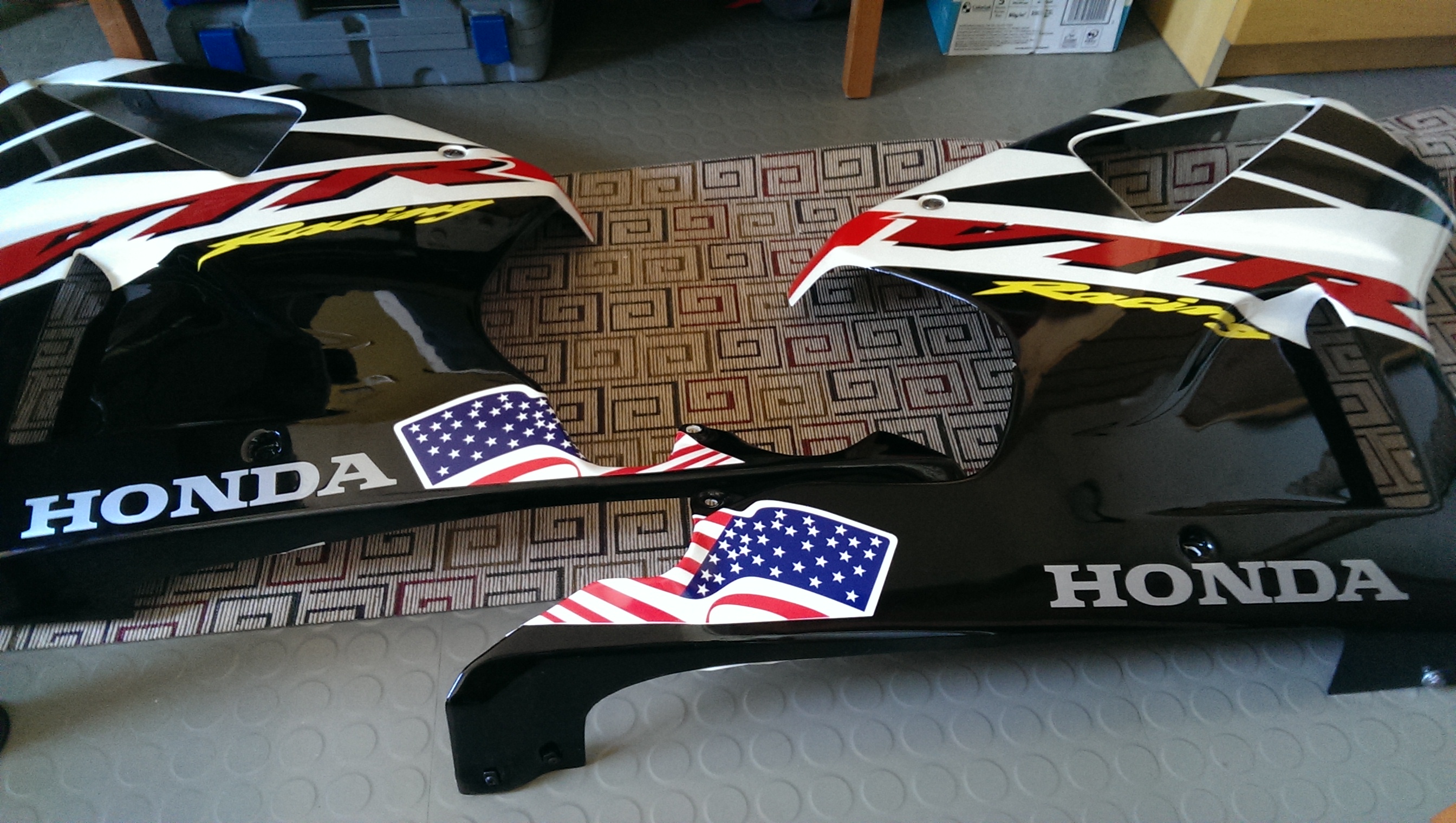

Started on the SP's Castrol stickering
Yeah, I know, Colin has Michelin decals. But I like being difficult different :goofy:
Will hold off on the side panels till I ran them a couple of time, checking how they are holding up before I apply (a lot of work) them...

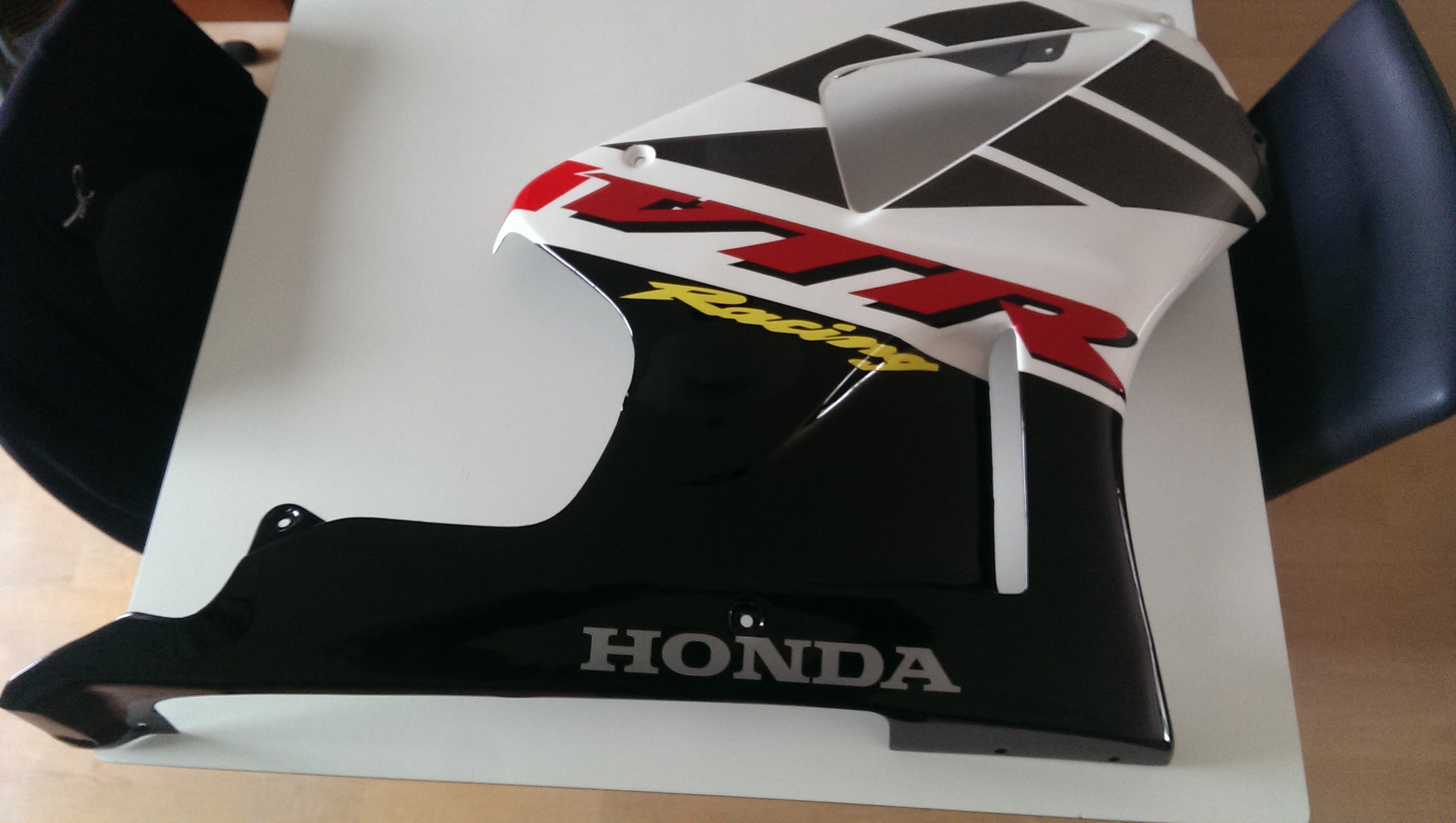

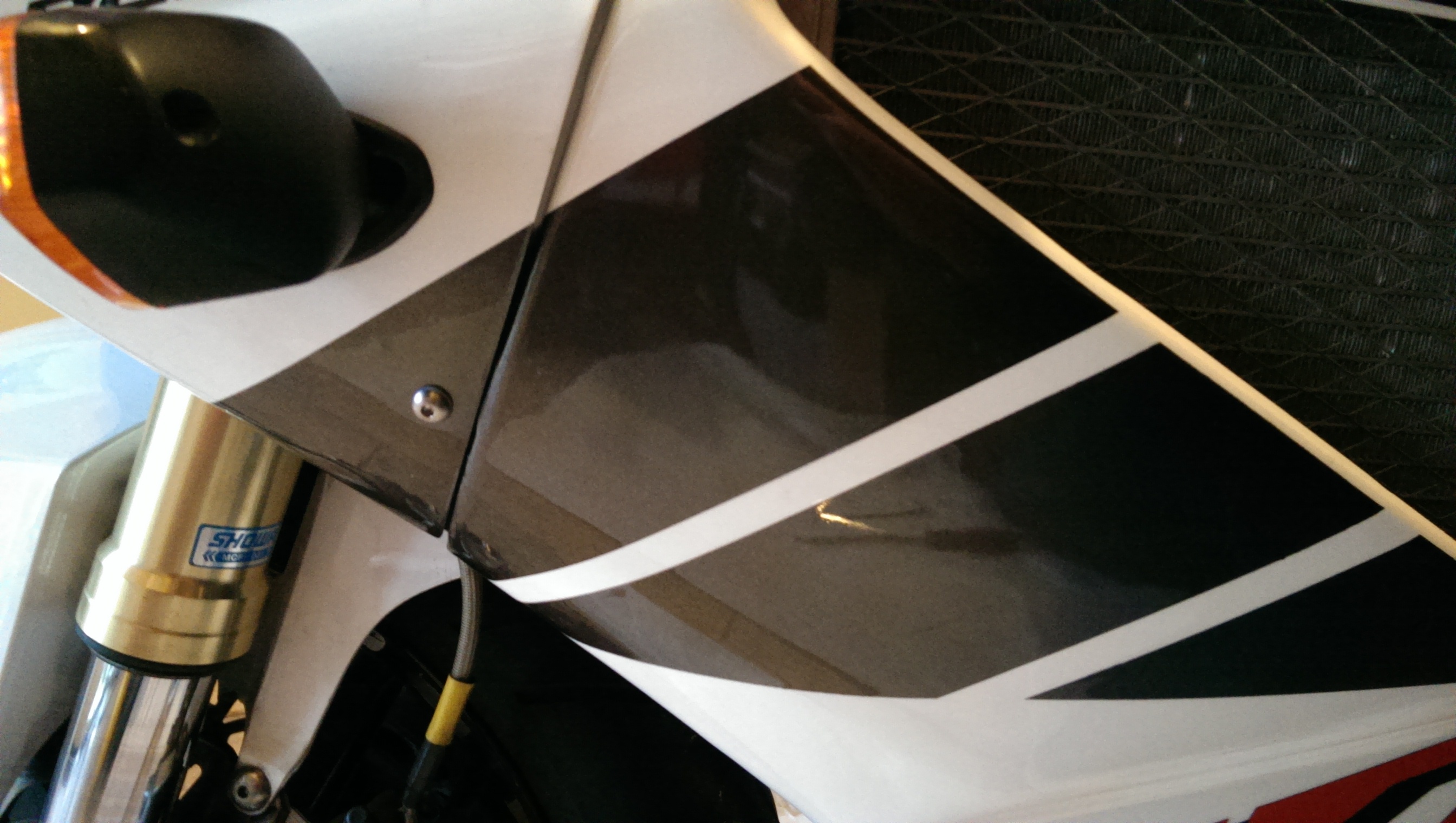

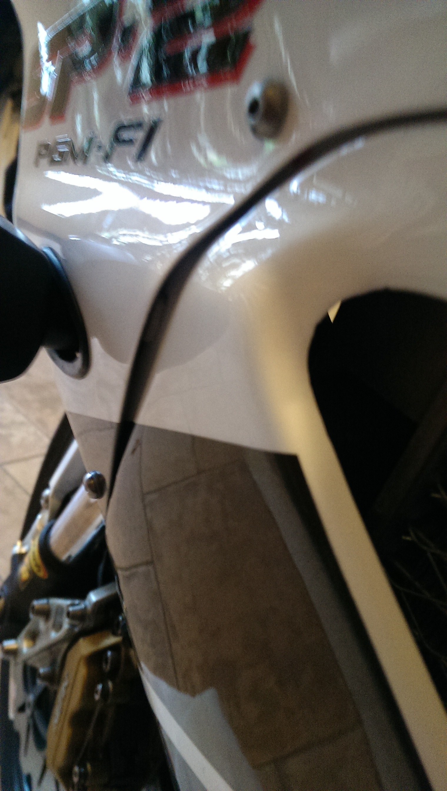

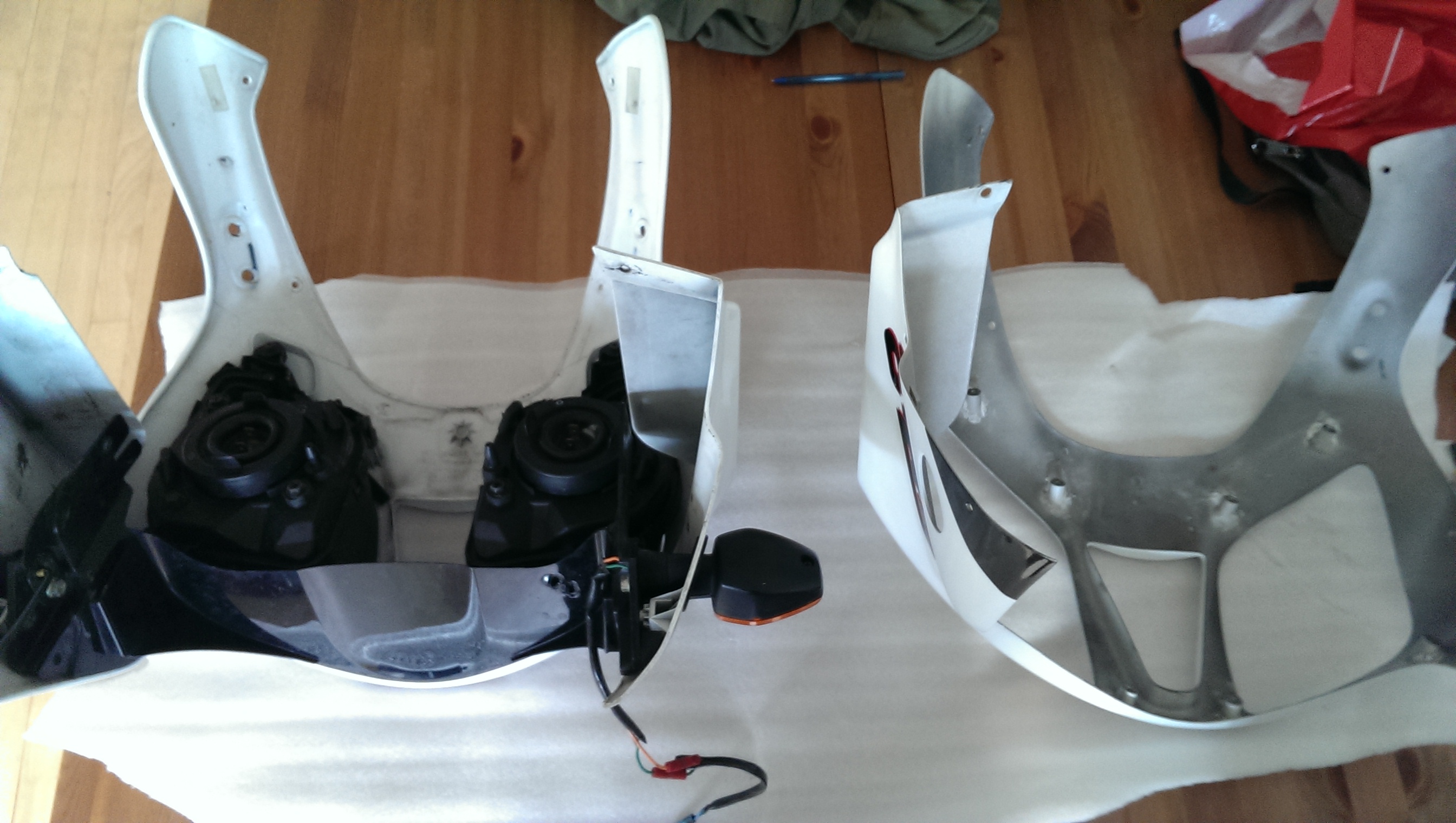

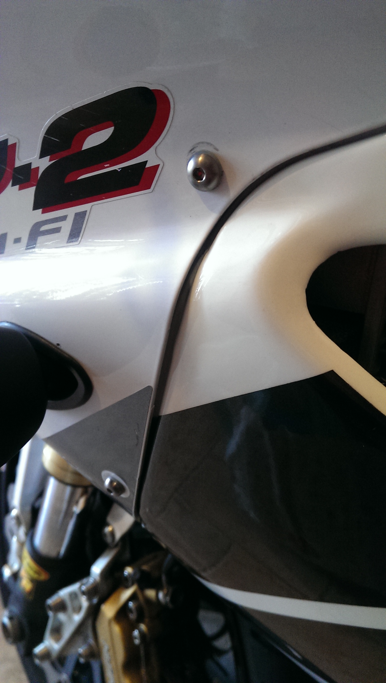

The chinesium side panel on the right side fitted ok to the oem upper (top hole needed to be expanded). But the lhs requires some thought...
Only thought....is what you're prepared to live with.....
Must've made the mold off another chineseiam copy off a copy of a copy....???
Sent from my HTC_PN071 using Tapatalk
Maybe, but what was Corbin's excuse, then?  I have a yellow Smuggler seat cowl, and the gaps are frankly embarrassing... :blush:
Ciao,
Aye, 1 well nut on the rhs needs a little relocation. Same issue/gap as with the oem upper. But the chinesium upper itself looks ok. time will tell.
Relocation time !!
The (darker than oem) wings lines up ok
Mind the gap...

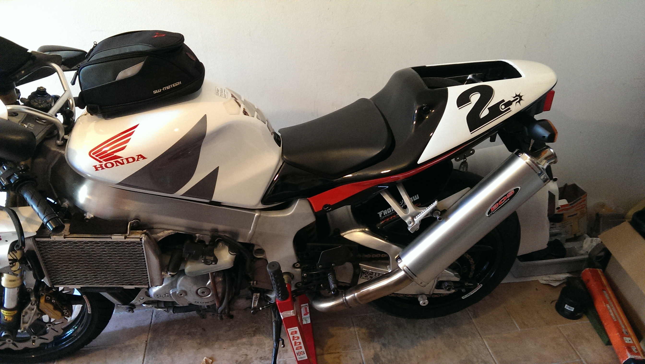

The china tail is not prone to failure so I started stickering....

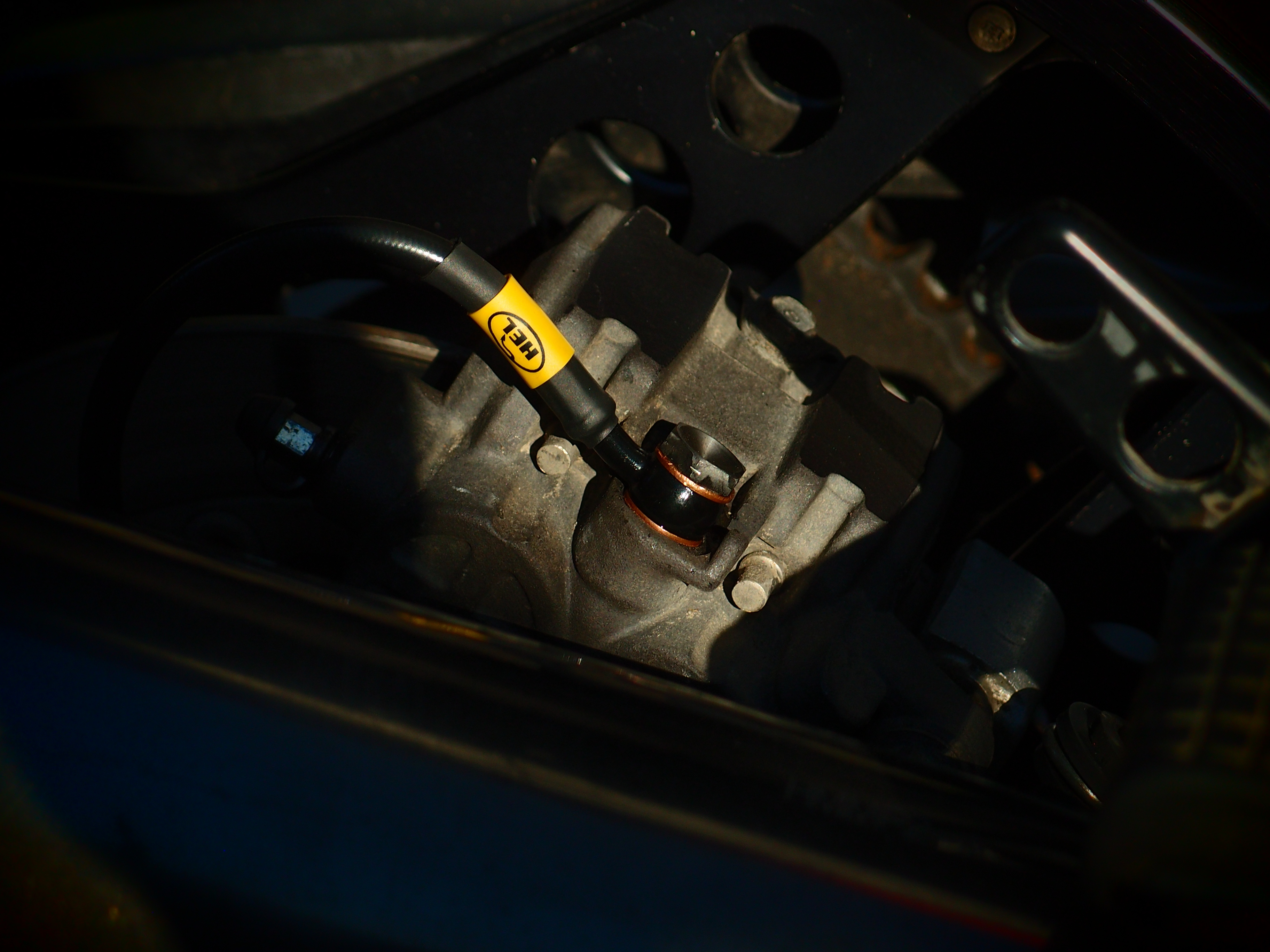

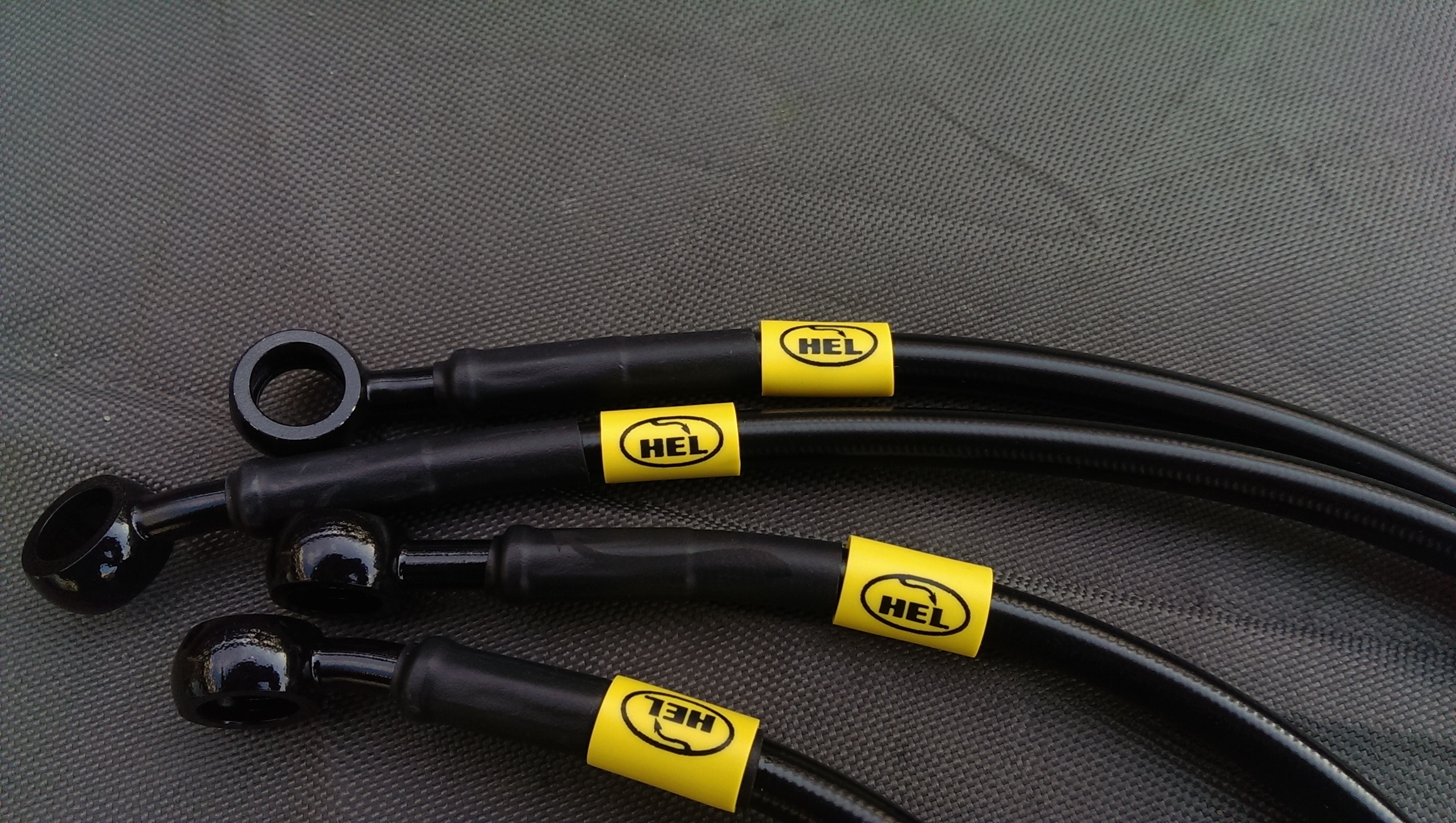

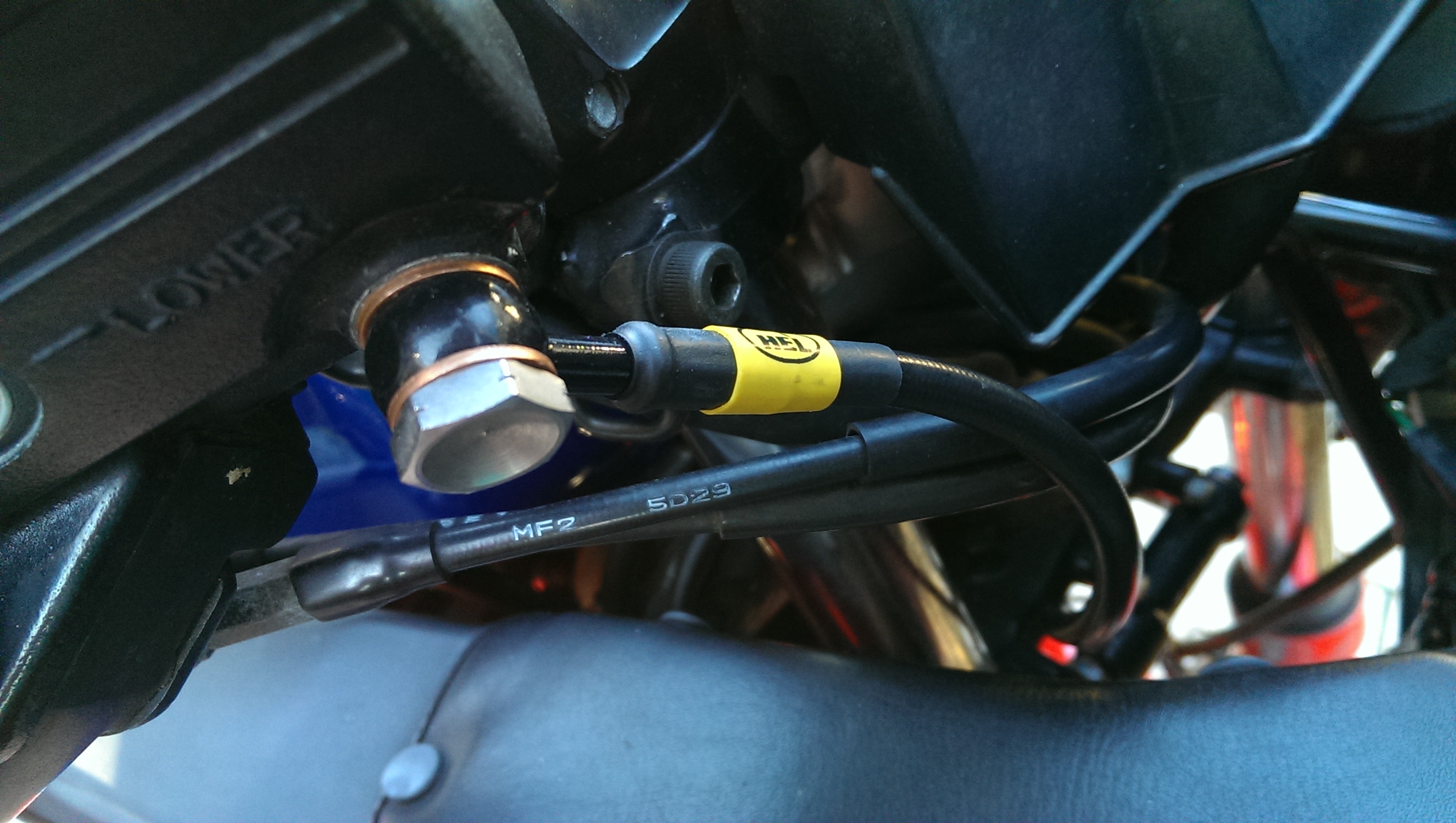

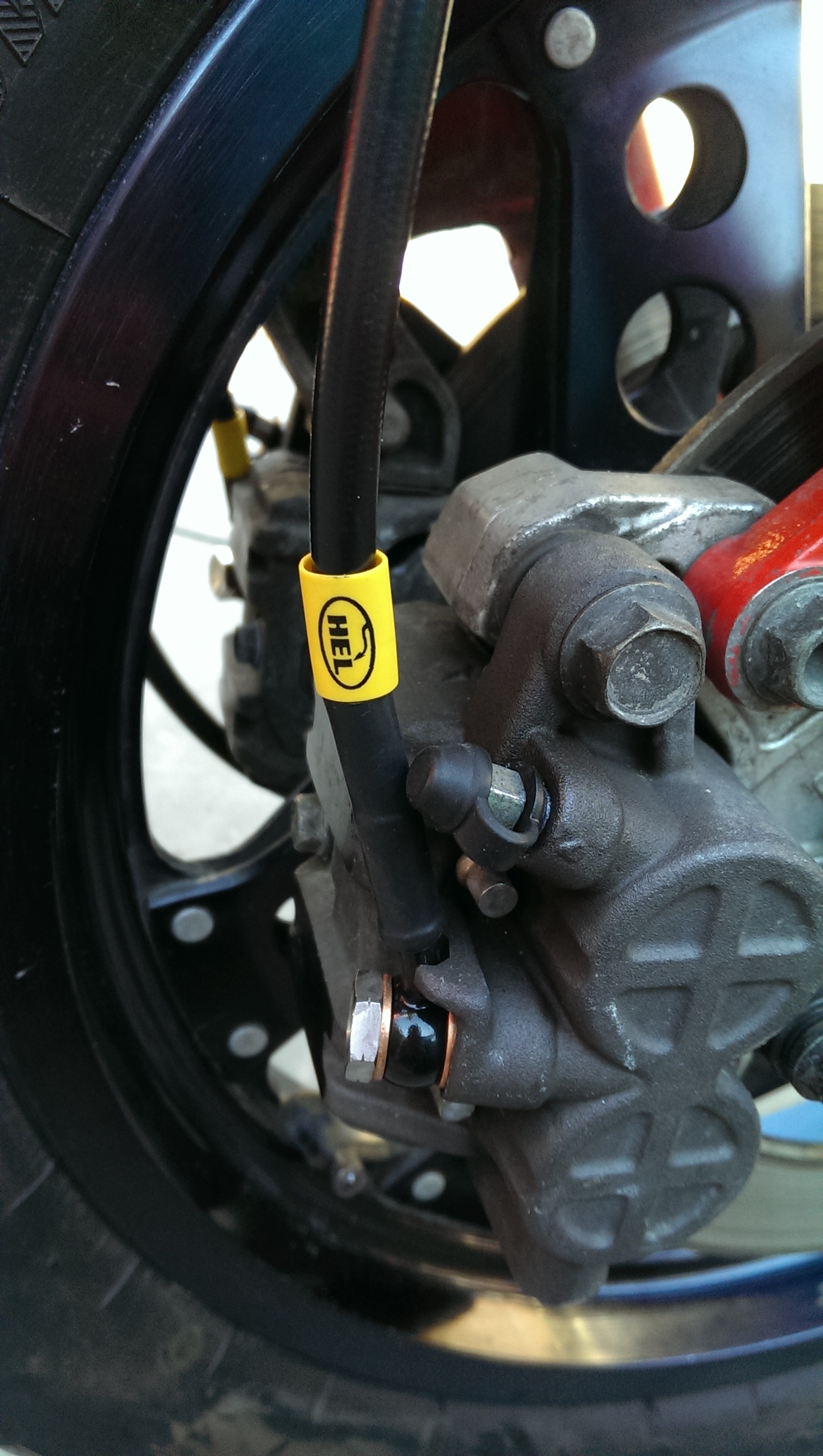

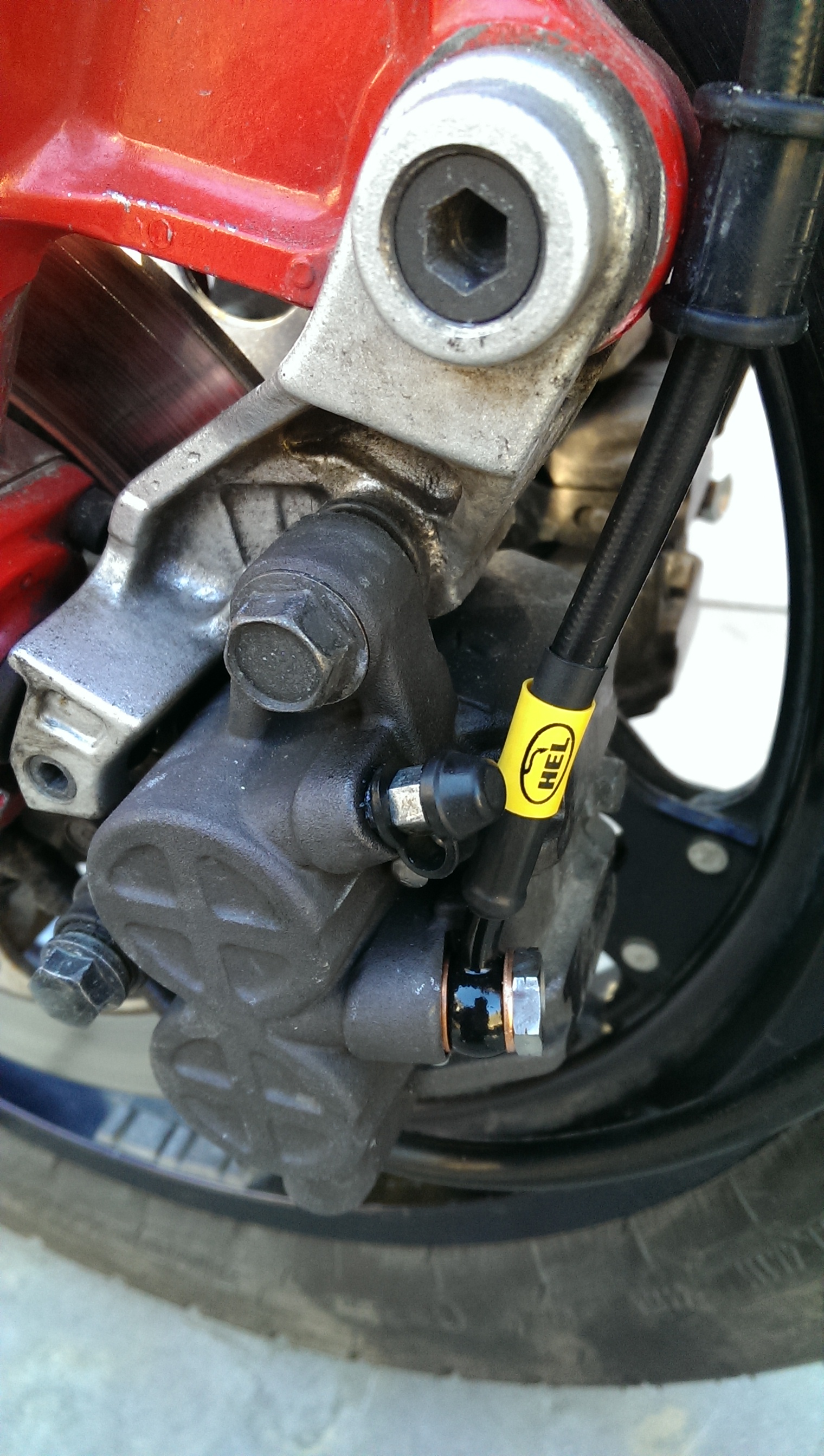

To HEL with 31 year old hydraulic lines :goofy:
They look good. Let us know if you can tell the difference. The OE lines on my two 500s have held up very well compared to other bikes I have owned. They didn't skimp on quality in those days.
Will do.
There indeed seems nothing wrong with the OEM ones after all these years....  but that 20% discount on the brake lines and a super deal on the clutch line was too good to pass up.
Not forgetting the 0.05% interest on one's savings account these days..... Not spending is actaually COSTING me money..... :goofy:
The black coating looks really nice.

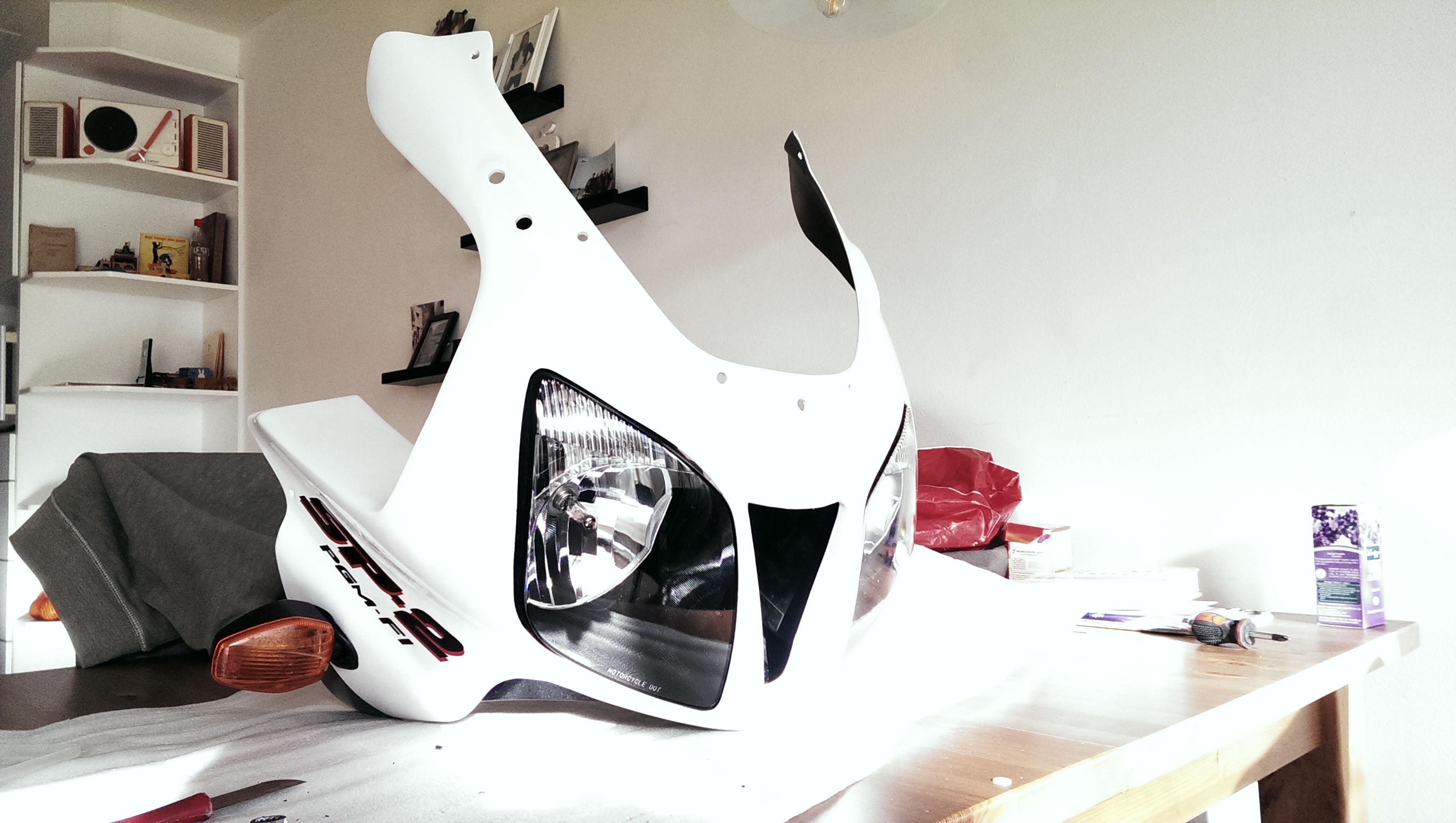

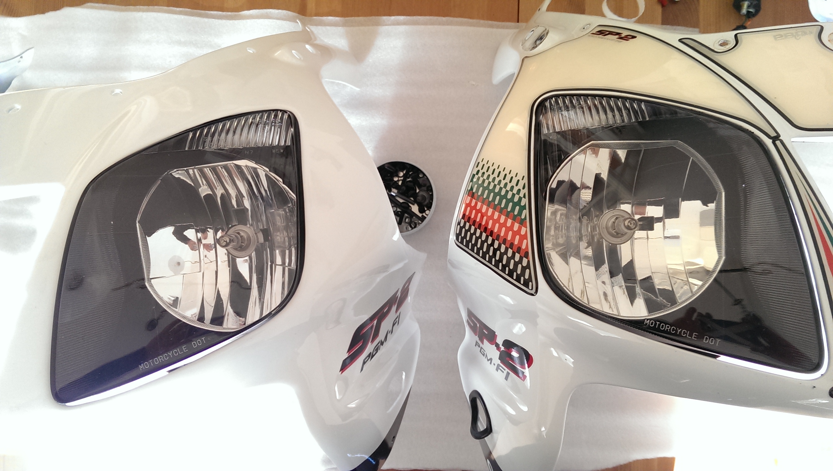

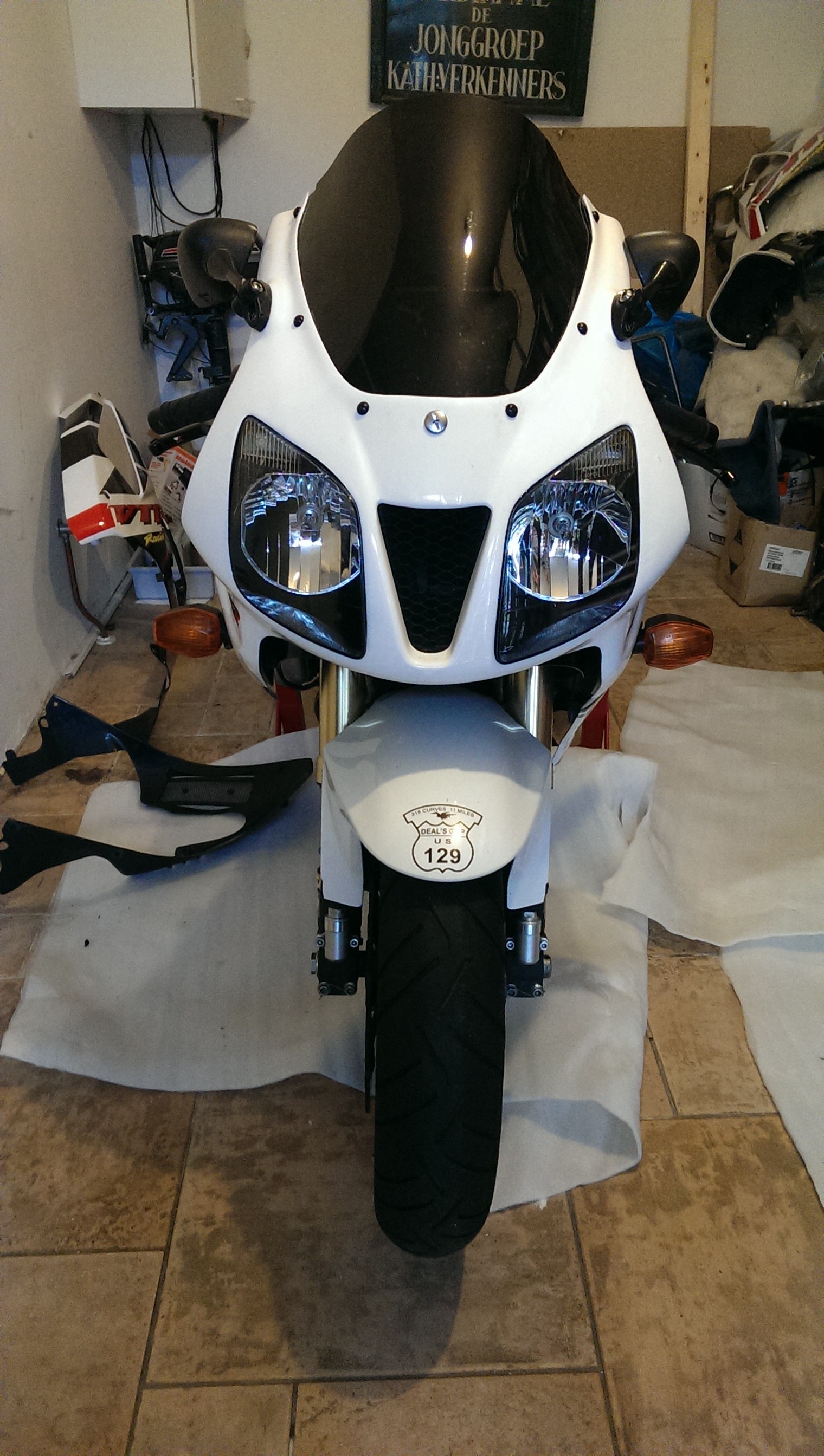

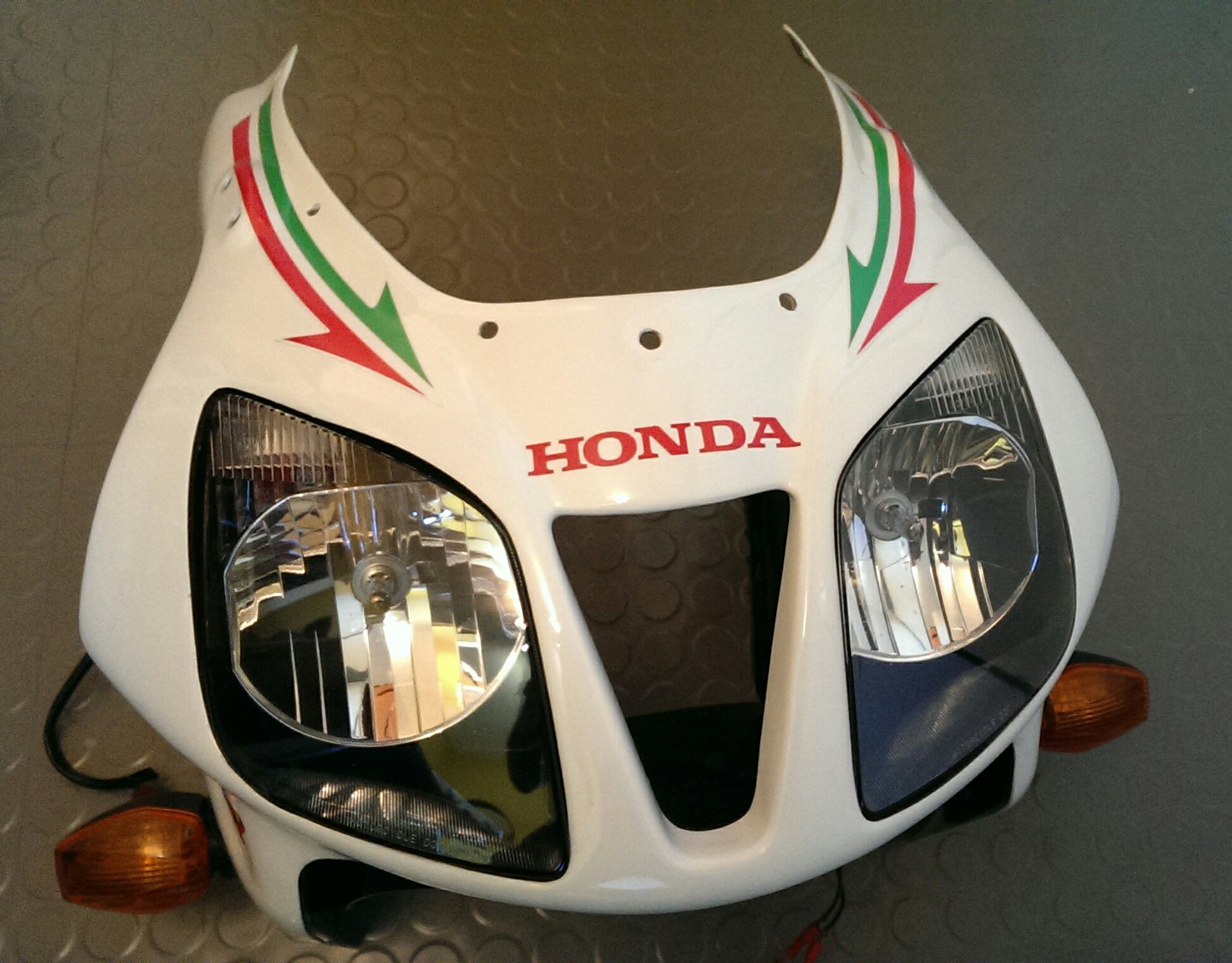

The headlights were sticking through just a tad too beaucoup for me....
So fabbed some 3mm thick "spacers" for the mounting posts...

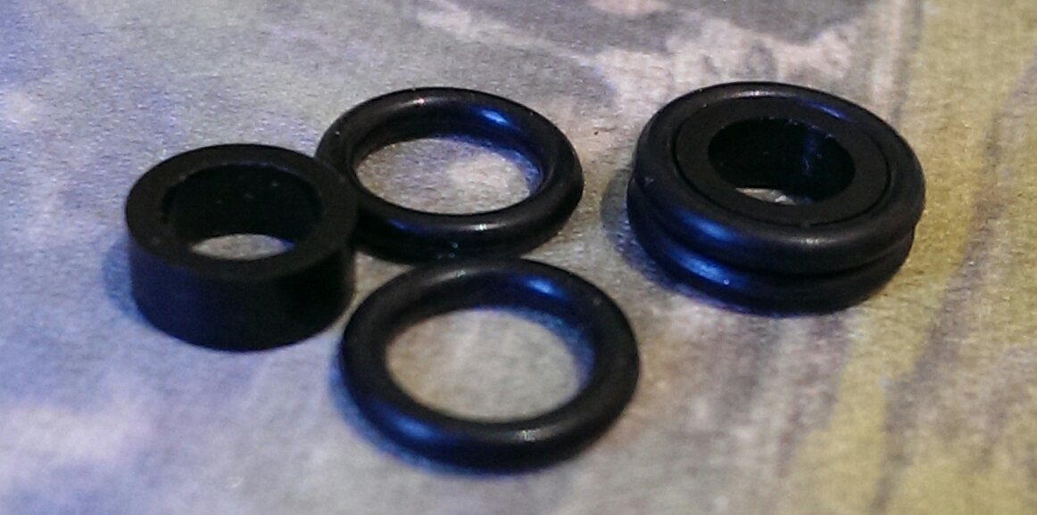

When firing up the engine for the 1st time since a cold winterstop, something was smoking.....
Had to put the bike in the shed (priorities...), but sniffed some fuel the next day and saw a small wet spot...
Yep, fuel tap is leaking....  In the off position..... In ON not so much.
Any pointers to a new seal??
Had put the tank brimful with ethanol free fuel, so......

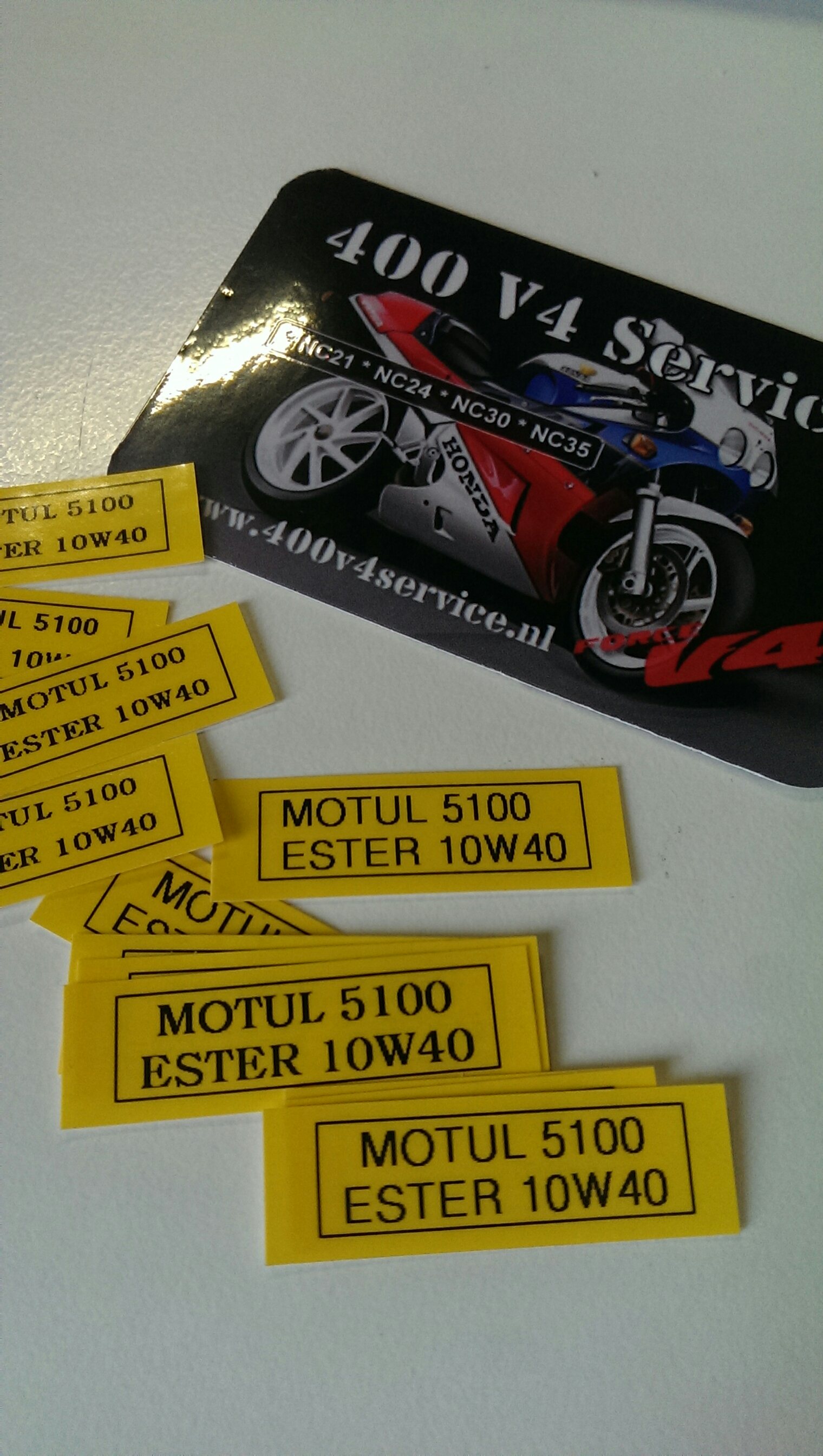

As I use MOTUL 5100 in my VF, a friendly person mIled me some wee decals to put on tge engine near oil fill plug :beer:
