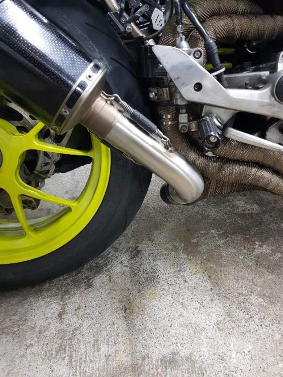

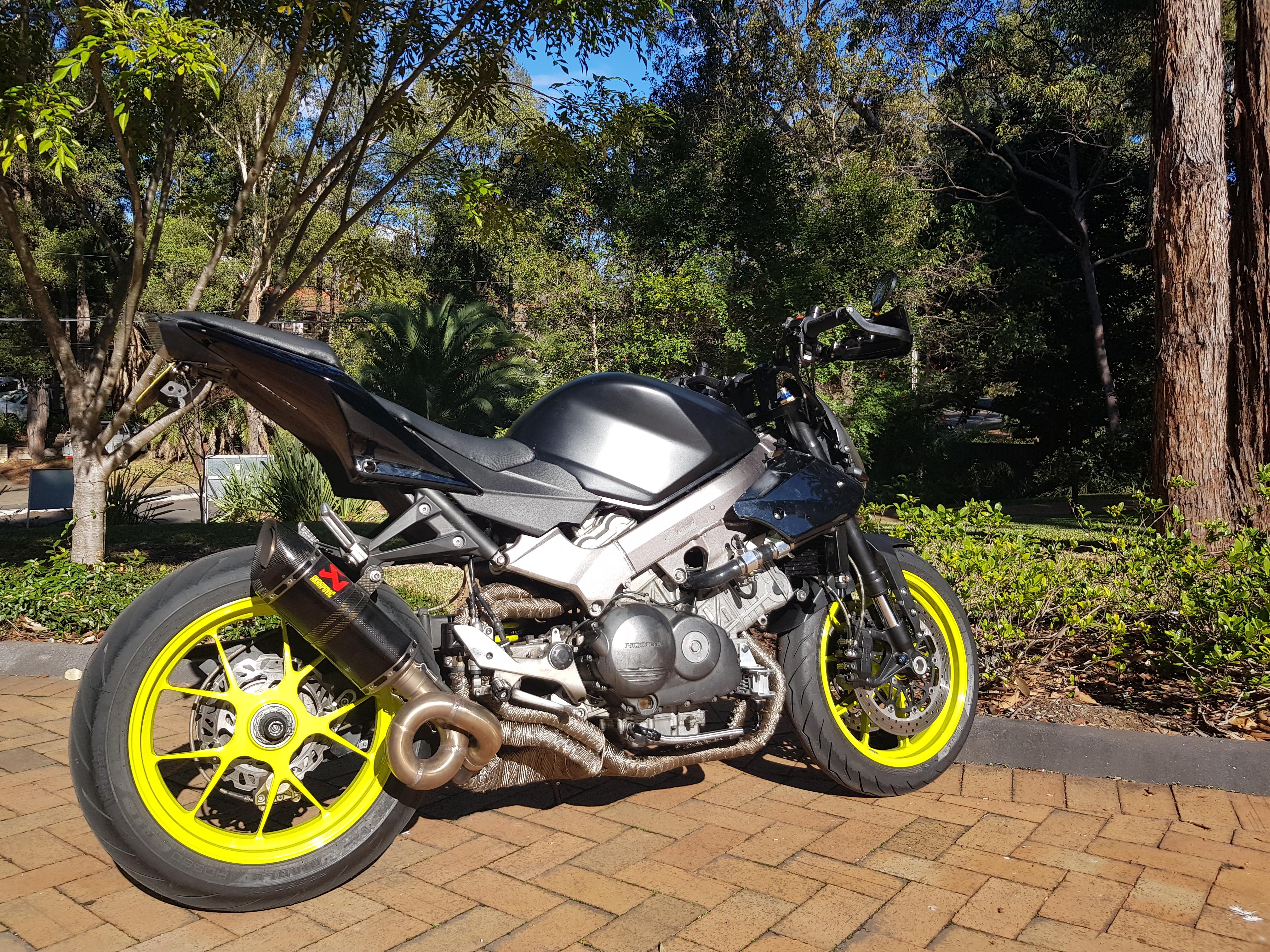

keef Posted July 26, 2018 Author Posted July 26, 2018 Went for a ride with my brother the other day, me on the VFR, and him on his tuono. He took the VFR for a spin. Great feedback an how it felt, considering the tuono is a benchmark. His first comment was it sounds ANGRY. Not bad for a gentleman's sports tourer. Now, I'm 85kgs, and hang off the bike. He's 20kgs heavier, doesn't hang off, just leans the bike. A lot. He dragged the loop, so I had a new link pipe made up yesterday. Bye Bye, loop the loop, hello ground clearance. And since I have a rapid bike, it'll just remap itself if it needs to. I'm enjoying this bike more and more - good to 6Krpm, fun to 8K, and really quick from 8K. 3 Quote

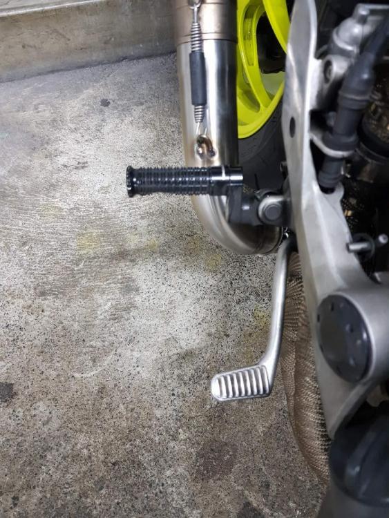

keef Posted November 11, 2018 Author Posted November 11, 2018 I did a trackday on thursday, then a weekend ride with some of the ASF guys through the mountains. No clearance issues with my new rearsets, but i did scrape my sidestand a couple of times at the track. 1 Quote
Member Contributer Brown81 Posted November 12, 2018 Member Contributer Posted November 12, 2018 I like the newer link pipe! Loop was neat but I like the cleaner look. And better clearance. Awesome project! Quote

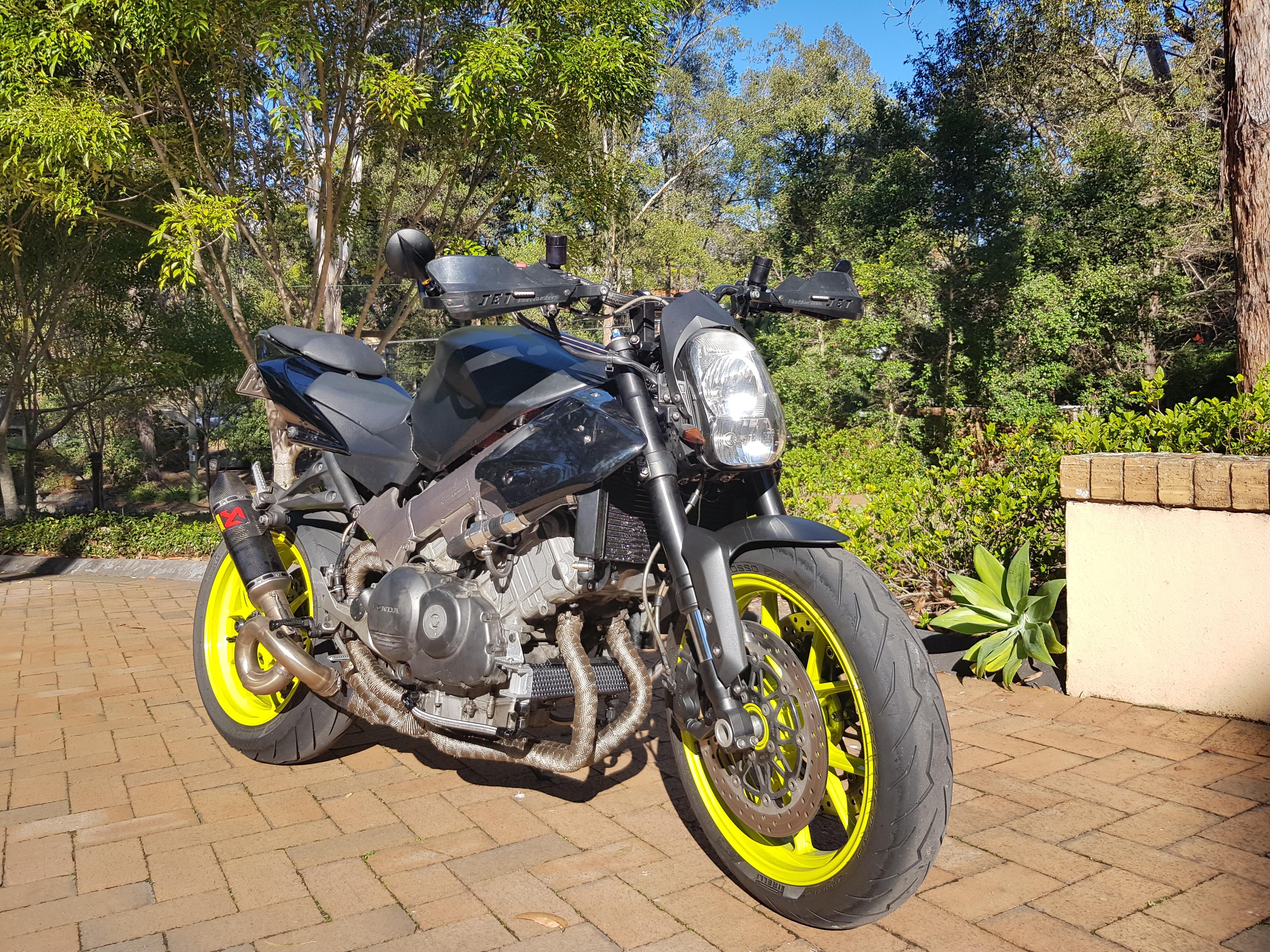

keef Posted July 2, 2019 Author Posted July 2, 2019 So, still chipping away on upgrades. Finished my mohawk big airbox to go with the supershort velocity stacks. Added some m4 rivnuts to the airbox lower since the OEM threads were pulling out of the plastic Changed to all singing, all dancing apex manufacturing clip ons, so changed my extended throttle cables to ones from a cb500r. And to make 110hp feel like 150, new grips with a 1/4 turn throttle. I may even put my barkbusters back on the clipons. Definately more a trackfighter than a streetfighter, now. Quote
Member Contributer Stray Posted July 2, 2019 Member Contributer Posted July 2, 2019 Very, very cool! Why super-short stacks and not dual-stacks a la Mohawk? Does your airbox have a lid or are you running it open? Quote
keef Posted July 2, 2019 Author Posted July 2, 2019 12 minutes ago, Stray said: Very, very cool! Why super-short stacks and not dual-stacks a la Mohawk? Does your airbox have a lid or are you running it open? The big airbox takes the filter and puts it into the airbox lid instead of inbetween the base and lid. The lid is what you can see. No dual stacks because i havent got round to it yet. I have the extra stacks, just haven't done it yet. I am running with 2 x short 6th gen stacks, and 2 x super short aluminium stacks. 1 Quote
Member Contributer Stray Posted July 4, 2019 Member Contributer Posted July 4, 2019 On 7/2/2019 at 9:30 AM, keef said: The big airbox takes the filter and puts it into the airbox lid instead of inbetween the base and lid. The lid is what you can see. No dual stacks because i havent got round to it yet. I have the extra stacks, just haven't done it yet. I am running with 2 x short 6th gen stacks, and 2 x super short aluminium stacks. Very impressive! I think Mohawk built some sort of air dam to recreate a ram air effect. Trick is to seal the rear of the fuel tank to the airbox, trapping air in the pocket. I’ve been thinking about cutting up the airbox lid and making it bigger than stock so more air space inside. There’s a bit more room for a taller lid under the fuel tank, but it’s a tricky shape. Good thing about your design is you’re no longer going to be sucking super hot air from the oil cooler. You’ll be getting marginally colder air from behind the frame instead. Really cool work! Quote
keef Posted July 5, 2019 Author Posted July 5, 2019 Ive also got a front mount rad, so air that has been through the oil cooler or rad wont really make a difference. Its the volume inside the airbox that makes the difference. Quote

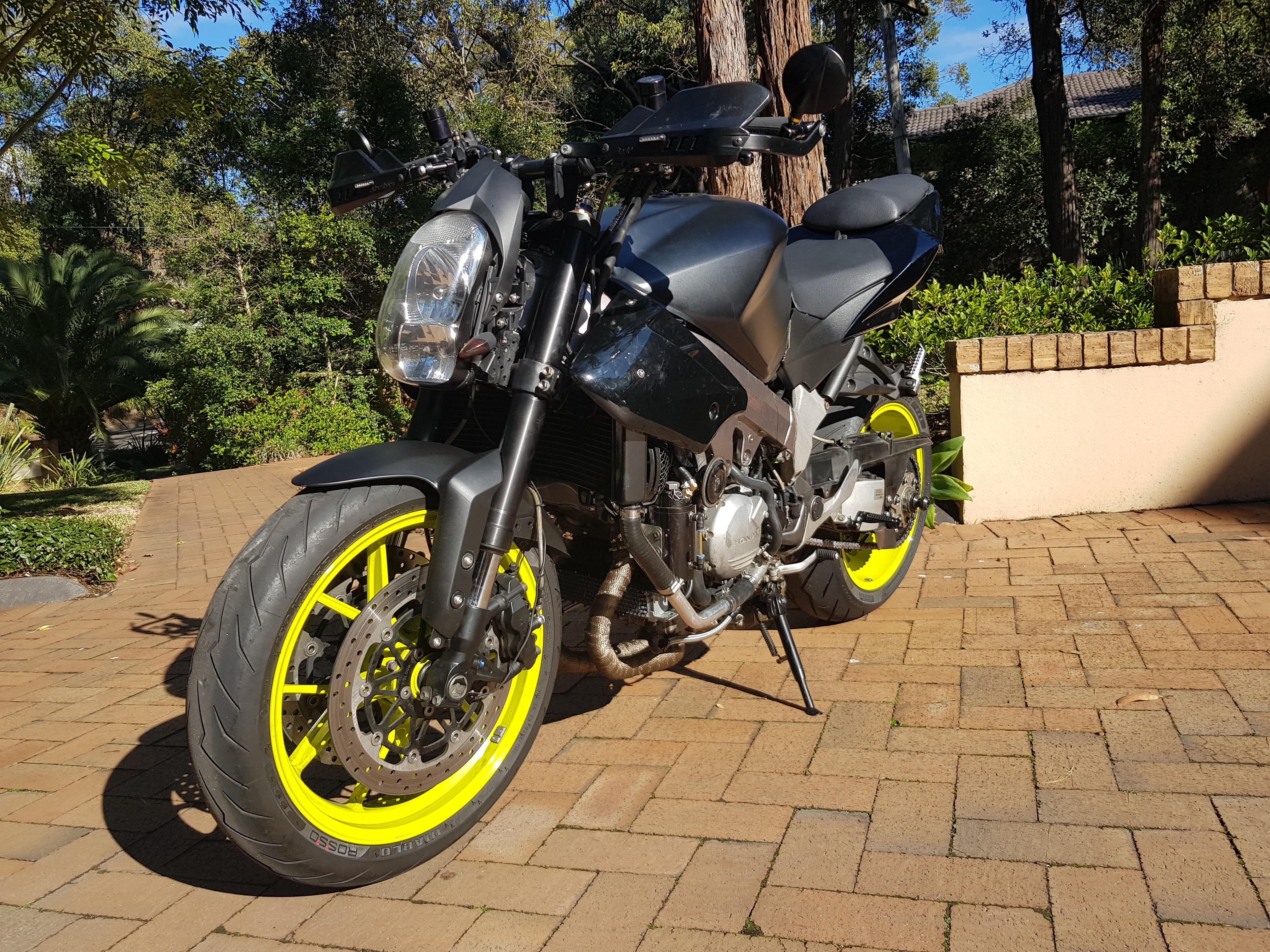

keef Posted July 25, 2019 Author Posted July 25, 2019 I manged to get my old polisport hanguards on, and commuted on it today. The angle of the clipons makes it really comfortable for such an aggressive setup- high seat, high pegs and low bars. And big thankyou to mohawk and candy red. The big airbox mod and rapidbike (and quick action throttle) make my trackfighter vfr pretty quick. 1 Quote
