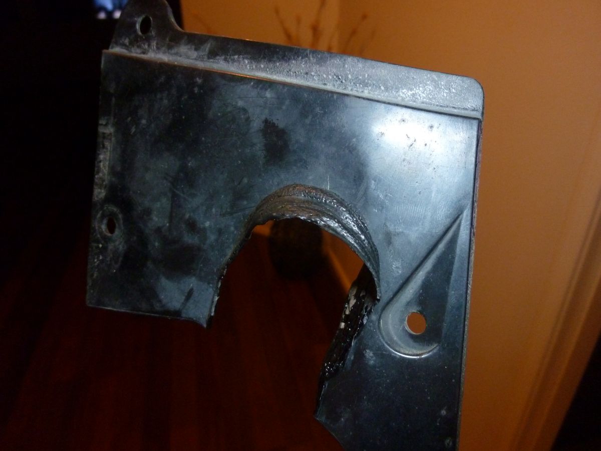

Member Contributer kaldek Posted August 17, 2011 Author Member Contributer Posted August 17, 2011 Good news! I found the source of the burning smell! Bad news! I'm a dickhead! What's that burning smell? Yes, exhaust headers get HOT, FAST. It appears that the burning smell was wafting up to the steering stem and appearing to come from the ignition switch. I swear I'm going to start seeing communists in my soup next. Quote

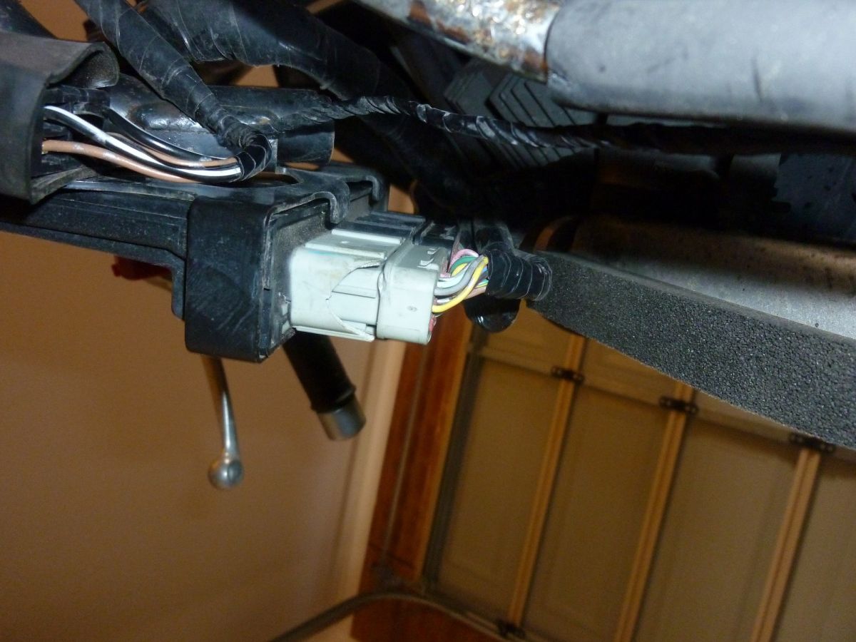

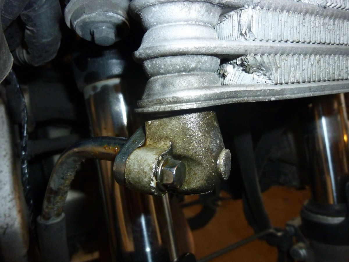

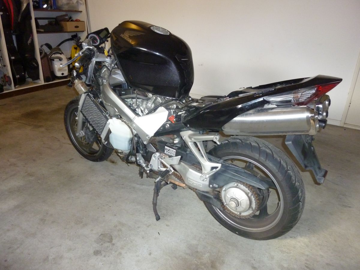

Member Contributer kaldek Posted August 18, 2011 Author Member Contributer Posted August 18, 2011 OK I picked up the wreck today. The guy there hadn't managed to start it but thanks to my (now) intricate knowledge of VFR electrics I had her fire right up. Right away it runs a lot better than mine even with a shitty tank of gasoline and probably dirty injectors. The bike appears to have crashed into the back of a truck with a tray bed, so the front subframe is bent badly and the oil cooler has a split in it. The ECU plugs also took a knock, cracked the white plug housing and one of the pins was a bit bent, but that's now sorted. It was missing a bank angle sensor (smashed to pieces) so I had to take mine with me when I picked it up. Fairings are semi-OK. One side needs a bit of plastic welding but the right hand and tail fairing are in one piece. Handy spares. Oh I also pulled the airbox - the intake stacks are short front tall rear and it looks like the airbox has never been off the bike.. Damn, that busted one of my other theories about intake stacks! Now all I need to do is put a chair out in the garage, crank up the radio, drink a sixpack and decide what's easier - moving engines or paying $1000 to register this one with my plastics, subframe and oil cooler. Quote
Member Contributer kaldek Posted August 18, 2011 Author Member Contributer Posted August 18, 2011 Discovered new bike was popping quite loudly as soon as the throttle was closed even in neutral. My immediate thought was that this is a stuck PAIR reed valve. Sure enough - shove a marble up the PAIR hose and problem has magically disappeared. Going over this bike, it looks like it's never, ever been taken apart. I mean, aside from the front end crash damage and rust from sitting around it's MINT. Aarrgh, what to do! Three hours of work and I can put all my farkles & fairings on it but it's going to cost me a grand. Or, I tear into this mint machine and shove its motor into the frame of my '02. I....I dunno what to do! Busted Oil Cooler Cracked ECU socket Pretty good condition Quote

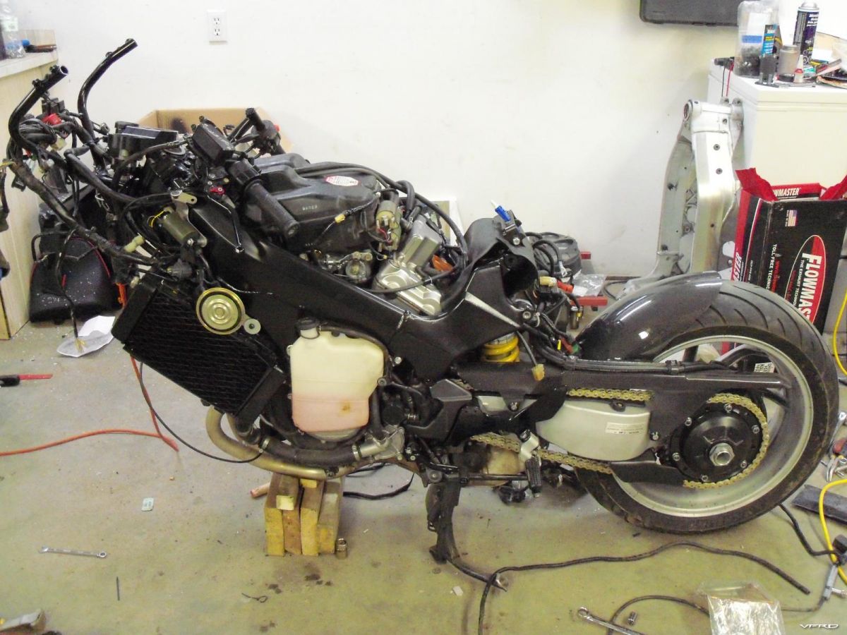

zRoYz Posted August 18, 2011 Posted August 18, 2011 I haven't ever needed to remove motor but looking at procedure I'm sure there are short cuts you can take for example the motor is part of swing arm pivot so if you remove shock & support motor with enough blocks you can remove main frame with front end up & away so motor with swing arm left on ground. You would still need to remove items to make job easy that may foul but looking at bike the main frame if motor supported will just lift off the trick would be making sure it is supported. Radiators are a single bolt with some hose clamps so no big deal there & you would have air box off to disconnect throttle cables. So more or less you would transfer the motor & swing arm ass across, have a good look at the bike you bought I'm sure it would work. You would normally remove swing arm from motor because you want to split the cases & work on motor you don't you mainly just want to swap assemblies, you still would need to drain brake fluid & all fluids except oil but I'm sure you would replace that to start a service history. Quote
SEBSPEED Posted August 18, 2011 Posted August 18, 2011 It's really much less of a motor swap, and much more like a frame swap. Remove bodywork & complete exhaust, place support under motor, remove forks, remove frame. Install your good frame and replace other bits in reverse order. Rob's got a good pictorial of this in his "Get Bent" thread where he documents rebuilding his 5th gen with a new frame. ps, I'm with Roy on this one. Quote

Member Contributer kaldek Posted August 18, 2011 Author Member Contributer Posted August 18, 2011 It's really much less of a motor swap, and much more like a frame swap. Remove bodywork & complete exhaust, place support under motor, remove forks, remove frame. Install your good frame and replace other bits in reverse order. Rob's got a good pictorial of this in his "Get Bent" thread where he documents rebuilding his 5th gen with a new frame. ps, I'm with Roy on this one. SOLD. I'll swap frames. Probably even use the swingarm from the new bike, but keep the shock on mine (since it's an ABS model with remote preload), but that's a 30 minute job. Thanks fellas. I was going to go for a ride this weekend but I think the better option is to stay home and work in the garage on the two bikes. Actually first thing's first - I will try the new bike's tank and pump on my bike, see if it changes engine behaviour. After that, there's not much left except the engine and the stuff inside it that could be toasted. Quote
