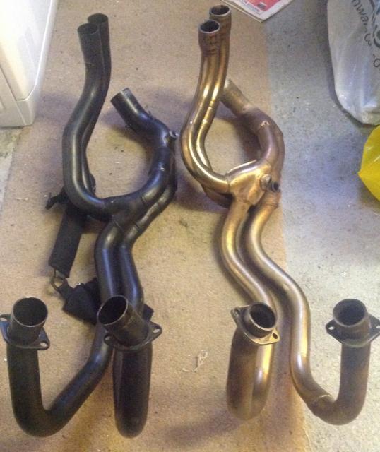

Member Contributer AnikMankar Posted March 2, 2015 Member Contributer Posted March 2, 2015 So i guess my sweet 1998 vfr will be left out of the pcv experiment due to the lack of o2 sensors? No it won't be left out of the experiement. I've installed a PCV on my 98 with great results. I have the Autotune, map by gear, and temp sensors installed and working great. All I did was drill a hole for the Bosch unit and had a bung welded. Works great. where did you weld the plug ? Quote

Member Contributer Rush2112 Posted March 2, 2015 Member Contributer Posted March 2, 2015 I think he is looking for where did he drill and mount the bung for the wideband O2 sensor... I suggest something similar to Mohawks TBR header (see below on left) Quote
Member Contributer AnikMankar Posted March 2, 2015 Member Contributer Posted March 2, 2015 i was referring more to the position of the plug on the pipes Quote
Member Contributer Rush2112 Posted March 2, 2015 Member Contributer Posted March 2, 2015 i was referring more to the position of the plug on the pipes See my post just before this one... Quote
Member Contributer AnikMankar Posted March 2, 2015 Member Contributer Posted March 2, 2015 I think he is looking for where did he drill and mount the bung for the wideband O2 sensor... I suggest something similar to Mohawks TBR header (see below on left) isnt it suppose to be more towards the header instead of the exhaust ? Quote
Member Contributer Switchblade Posted March 2, 2015 Member Contributer Posted March 2, 2015 i was referring more to the position of the plug on the pipes Oop's Quote
Member Contributer Rush2112 Posted March 2, 2015 Member Contributer Posted March 2, 2015 I think he is looking for where did he drill and mount the bung for the wideband O2 sensor... I suggest something similar to Mohawks TBR header (see below on left) isnt it suppose to be more towards the header instead of the exhaust ? That is only slightly farther downstream than the factory O2 sensors on the gen 5.5 & 6... that position allows measurement of all the cylinder gases instead of two or one. I understand your point about positioning and there is a "Goldilock's" distance from the cylinder exhaust port to get the most accurate reading; too close and the exhaust gases are too hot and completing combustion, too far and they are starting to cool and have consumed more available oxygen giving an apparent richer mixture than actual... you can adjust your A/F target to compensate for the position of the wide band O2 sensor if needed. Quote
