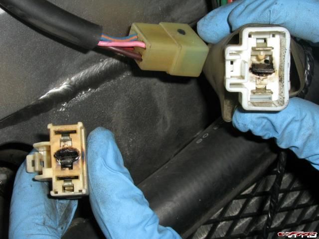

Member Contributer Das Bone Posted December 10, 2007 Member Contributer Posted December 10, 2007 Took mine in last Wed. for the recall. Running just fine as usual. Picked the bike up later that afternoon......bike ran like crap. Frustrated <_< but had to leave bike at the dealership. Two days later the service manager called and explained that they found a burned connector that's part of the main wire harness(not part of the two being replaced under the recall) and that he had contacted Honda's techline and sent pics etc. to them. At this point, I'm told that a new main wire harness should be sent out for my bike hopefully this week. Here's the burned connector...left side just forward of the the battery compartment Burned connector after recall Quote

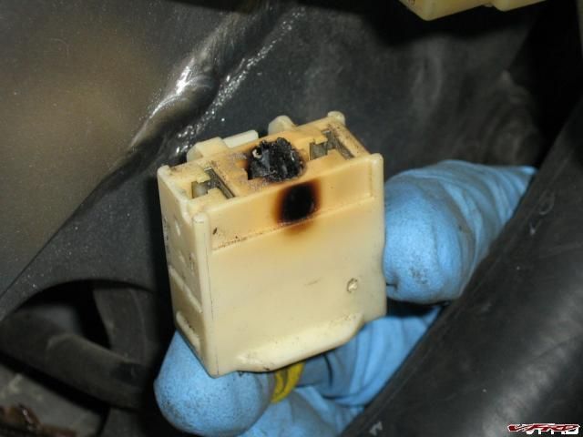

Member Contributer vfrqqq Posted December 10, 2007 Member Contributer Posted December 10, 2007 So here are some pictures my service center sent me of the wire harness. JH2RC46143M500995_2.JPG JH2RC46143M500995 _1.JPG Additionally they noticed that the wires to the R/R and stator were pretty well fried as well. They looked at the stator and apparently all but one or two of the coils were charred!! :blink: Thankfully Honda picked up the cost of the stator and R/R! :unsure: I'll post pictures of the stator and R/R when I get them tomorrow. Make sure your service shop checks these things as well. You could be eligible for some new equipment on Honda! Quote
Member Contributer jeremy556 Posted December 11, 2007 Member Contributer Posted December 11, 2007 Took mine in last Wed. for the recall. Running just fine as usual. Picked the bike up later that afternoon......bike ran like crap.Frustrated <_< but had to leave bike at the dealership. Two days later the service manager called and explained that they found a burned connector that's part of the main wire harness(not part of the two being replaced under the recall) and that he had contacted Honda's techline and sent pics etc. to them. At this point, I'm told that a new main wire harness should be sent out for my bike hopefully this week. Here's the burned connector...left side just forward of the the battery compartment Burned connector after recall That is one of the ground blocks. Others have had the same problem with them. Quote

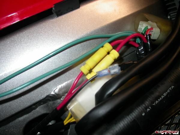

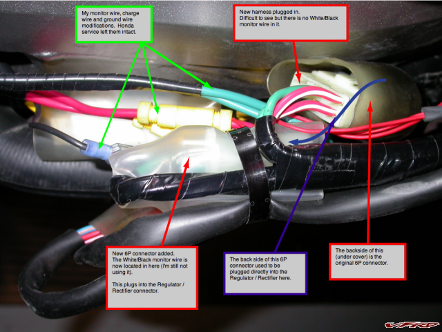

Member Contributer RosscoB Posted December 14, 2007 Member Contributer Posted December 14, 2007 I have had the recall work done with the VFRness installed. They just left it disconnected and zip tied it together with some of the other wires. They even apologized for not being able to hook it back up saying that since it was a safety recall they weren't allowed to mess with the new harness in any way. Who knows. Hooking the VFRness back up took a little extra time just to get everything to sit where you want it to be - things are pretty tight under there now. I just got my bike back from the dealer. The recall work was done while I had an extra ground wire run to the Front Harness and the VFRness installed. I told the service writer about both modifications when I dropped the bike off. The dealership didn't disconnect the VFRness from my bike. When I got it back the factory harness & the VFRness were both working and each had a 30amp fuse installed. The new factory wiring for the 30amp fuse is nice and thick! I also noticed that my dash lights are much brighter than they used to be. Who would have thunk it? (grin) Quote

Member Contributer steide Posted December 16, 2007 Member Contributer Posted December 16, 2007 was supposed to pick up mine today after 4 days in the shop... so at 5PM they call me and report that the connector at the starter solenoid is totally burned... mother honda is now replacing all my harnesses front and back AND buying me a new starter solenoid... Bad news is newest estimate for completion puts her in the shop for over a week. Good thing she's not my sole means of transportation... oh wait.... DAMN IT!!!!! Quote
Member Contributer steide Posted December 20, 2007 Member Contributer Posted December 20, 2007 was supposed to pick up mine today after 4 days in the shop... so at 5PM they call me and report that the connector at the starter solenoid is totally burned... mother honda is now replacing all my harnesses front and back AND buying me a new starter solenoid...Bad news is newest estimate for completion puts her in the shop for over a week. Good thing she's not my sole means of transportation... oh wait.... DAMN IT!!!!! So she finally got finished tonight... picked her up, but left her in the parking lot b/c the family was going to dinner... figured we'd pick her up on the way home. Anyhow, got on, started right up, proceeded to head home. I only made it about a mile and a half. Stalled during acceleration. Restarted in neutral, but the second i put it in gear, it died again... did this process twice. While still rolling down a major road in Vegas, made sure the kickstand was up all the way and tried again. Managed to conserve enough momentum to get her off the road and onto the sidewalk. Tried to start again, but now the battery is dead. So, I send my wife (who i thoughtfully told to trail me home) back to the dealership to find everyone is closing up. 3 workers are standing around and tell my wife to call a towtruck. Seeins how i was only just over a mile away, I say f!@# you and start pushing. Eventually, one of the dudes arrives and helps me push the remaining 1/3 of a mile to the dealership. WTF!!! So i told the dude honda has 3 options.... 1. give me a loaner while they unfubar my bike, 2. trade me straight up for a new VFR, or 3. call my loan square and give me a HUGE discount on a new VFR... I doubt i'll make much headway on either 3. So now, I'm back to bipedal transportation.... DAMN YOU HONDA!!!! 1 Quote
