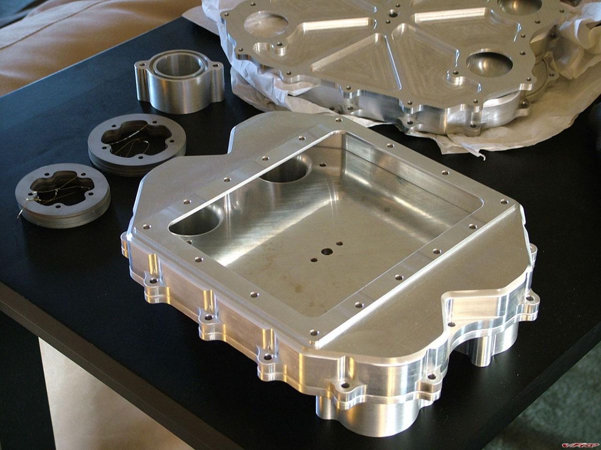

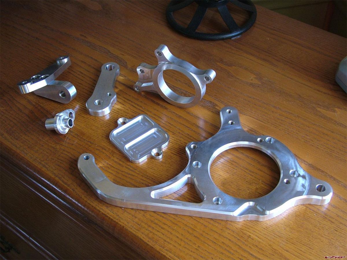

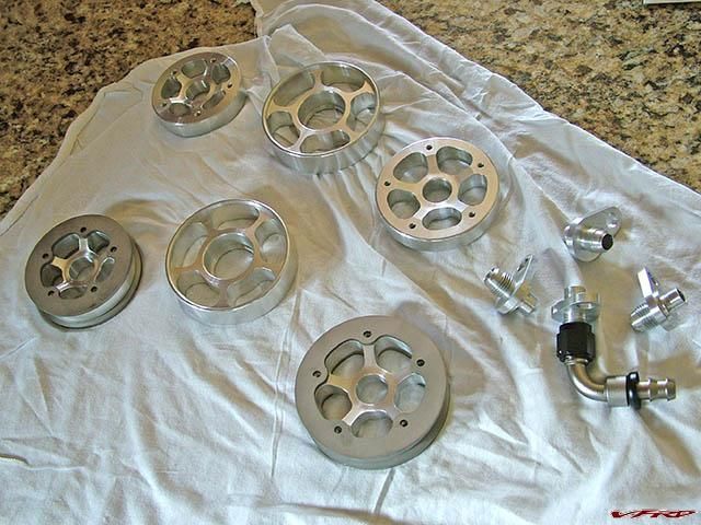

Member Contributer toro1 Posted June 16, 2008 Author Member Contributer Posted June 16, 2008 Still waiting........ :fing02: Fine John, I wanted to keep this a surprise until I got everything anodized, but you now have left me no choice... prototype_pics.jpg prototype_pics2.jpg prototype_pics3.jpg prototype_pics4.jpg I have been really really busy lately. Quote
Member Contributer BusyLittleShop Posted June 16, 2008 Member Contributer Posted June 16, 2008 prototype_pics.jpg Looking at your turbo bracket I'd subtract the triangle cut out for lightnest and add the metal back for strength... this beautiful machined aluminum piece looks crank prone to me in that junction... Quote

Member Contributer toro1 Posted June 17, 2008 Author Member Contributer Posted June 17, 2008 Looking at your turbo bracket I'd subtract the triangle cut out for lightnest and add the metal back for strength... this beautiful machined aluminum piece looks crank prone to me in that junction... That's 0.500" thick 7075, with generous corner radii. If that bracket cracks, then something has gone incredibly wrong. Wow! fantastic machining. those parts look great and robust. I was wondering whether you considered using CF/Composite for some of these, like the intake lower box you show here. Would it come out cheaper than doing this all in machined aluminum billet? There seems to be a lot of machining labor time and material with those bigger/more complicated billet parts.Beck 95 VFR Believe it or not Beck, it is still cheaper to machine those parts out of aluminum than it is out of CF/composite or to have it cast, unless of course I start selling vast quantities. Plus, who said I wasn't making certain parts out of carbon fiber?... Is that plenum for stage two, or is that still to come??!?! John, that plenum was designed for both "stages" as it can accept an intercooler or simply the intake hat. I had to do quite a bit of design work to figure out an airbox that would perform a double function like that, but I think it's going to work out great. Plus, it will let an existing customer in the field upgrade their kit, if they ever want to, without having to buy different parts. This thread has gone on for so long it has become boring. There has been good solid innovation when something new is posted then another long delay before the next installment. Gets to the road-going prototype then the longest delay of all. I could not imagine what was taking so long since it all seemed just fine. Since it was mainly cnc all Toro needed to do was stick in another chunc of ally, register the job center & press Go to make more. Then he teased us with a photo of the intercooler.Now he shows those exquisite plenums. I do a bit of cnc occasionally and appreciate the workmanship. Those chamfers on the edges are a ballache to do but it makes the job stand out. Exquisite work there Toro but get this thing done already. Don't agree with BLS. You have cut out unfunctional material around the neutral axis. Have to acknowledge that vibration induced cracking may develop. Sorry to disappoint, Ralph. I still have to work in order to afford this development, thus my time is stretched thin. Plus, every part (and I mean every single part) of the first prototype has been redesigned for this kit. I refuse to offer a subpar product to anyone, and that meant tweaking of what I had already done. Again, that cut-out portion of the bracket has the same bending resistance as the lower portion of the bracket and even greater torsional rigidity. I can't forsee it ever becoming a problem as it is already over-engineered. Also, as far as the ETA for the kits is concerned, wait until I get the bike running again. I hate making promises I can't keep... Quote

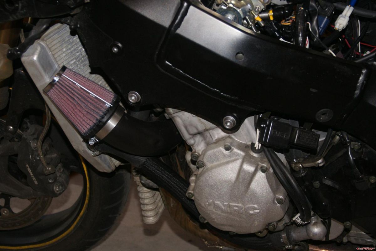

Guest hoozel Posted July 1, 2008 Posted July 1, 2008 I have just finished my own Supercharger project on a 2005 GSXR1000. Toro gave me some great advice and offered to help me where ever he could. I bought a CaliSuperbikes kit, got ripped off. he is a conartist... among other things. anyway back on track... it is a Rotrex Blower that has been designed from the ground up just like Toro did. Now its sporting an Intercooler attached to a new plenum, bigger injectors, PC3, Ignition module, Multi hub for boost monitoring, LCD screen. we reshaped the headers to allow a propper Air intake and ceramic coated the pipe to prevent the heat from the Headers. I just got it back from the Headers guy and rode it last night for about an hour, but in Traffic. It is terrifying to say the least. it goes in for Dyno tuning on Friday July 4th (not a holiday in Canada). It had 198hp before we redesigned the whole thing with the intercooler and propper intake. We think a realistic 215-225hp at 3400 ft elevation in Calgary Alberta Canada. I also wanted to say my finished product is no where near the fit and finish of Toro's. his is a work of art ! Quote
Guest hoozel Posted July 2, 2008 Posted July 2, 2008 (edited) I have just finished my own Supercharger project on a 2005 GSXR1000. Toro gave me some great advice and offered to help me where ever he could. I bought a CaliSuperbikes kit, got ripped off. he is a conartist... among other things. anyway back on track... it is a Rotrex Blower that has been designed from the ground up just like Toro did. Now its sporting an Intercooler attached to a new plenum, bigger injectors, PC3, Ignition module, Multi hub for boost monitoring, LCD screen. we reshaped the headers to allow a propper Air intake and ceramic coated the pipe to prevent the heat from the Headers. I just got it back from the Headers guy and rode it last night for about an hour, but in Traffic. It is terrifying to say the least. it goes in for Dyno tuning on Friday July 4th (not a holiday in Canada). It had 198hp before we redesigned the whole thing with the intercooler and propper intake. We think a realistic 215-225hp at 3400 ft elevation in Calgary Alberta Canada. I also wanted to say my finished product is no where near the fit and finish of Toro's. his is a work of art ! Doesn't exist without links and pics! :warranty: ask and you shall receive.... these are old pics from first design, i will get some new ones soon. oops wait cant post em. must have to donate to site. i have pics on other forums as well a Dyno sheet from old design on the edmonton sport riderz forum. Edited July 2, 2008 by hoozel Quote

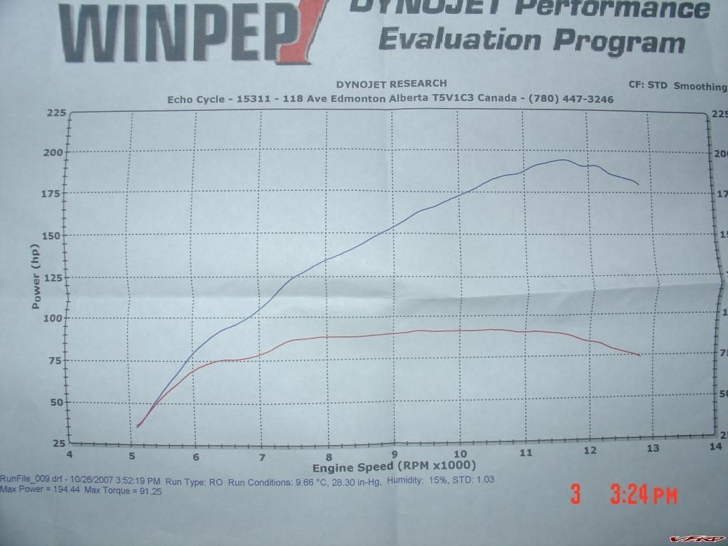

Veefer800Canuck Posted July 2, 2008 Posted July 2, 2008 ask and you shall receive.... these are old pics from first design, i will get some new ones soon. oops wait cant post em. must have to donate to site. i have pics on other forums as well a Dyno sheet from old design on the edmonton sport riderz forum. Must upload pics to your gallery first, helpfile: http://www.vfrdiscussion.com/forum/index.p...E=01&HID=17 Then insert in post using the gallery posting tool: http://www.vfrdiscussion.com/forum/index.p...E=01&HID=18 Quote
Guest hoozel Posted July 2, 2008 Posted July 2, 2008 (edited) ask and you shall receive.... these are old pics from first design, i will get some new ones soon. oops wait cant post em. must have to donate to site. i have pics on other forums as well a Dyno sheet from old design on the edmonton sport riderz forum. Must upload pics to your gallery first, helpfile: http://www.vfrdiscussion.com/forum/index.p...E=01&HID=17 Then insert in post using the gallery posting tool: http://www.vfrdiscussion.com/forum/index.p...E=01&HID=18 ahh got it thanks man ! Front side view.jpg side fairing.jpg mild tune super.jpg Its sporting the PC3 with a Multi Hub hooked into a GM3 bar Map, and Ignition Module. Wideband Commander to go in soon with LCD interface. This dyno was done with Ignition retarding quite heavily, the tuner was scared to dyno it, he didnt have much experience with a Blower. So it is extremely rich and ignition retarded till we could finish the redesign. I will post new pics and the new Dyno after Friday the 4th. Edited July 2, 2008 by hoozel Quote

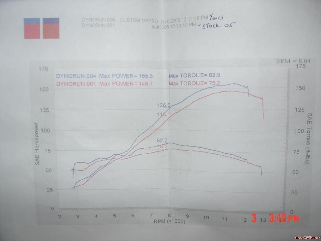

Guest hoozel Posted July 2, 2008 Posted July 2, 2008 That's wild man. You'll be putting out more HP than the WSB bikes do! And the bottom end will be spectacular. I don't know, with only 105 HP at 7k it might be a little sluggish. :fing02: Just what I need, a GSXR 1k with more power! :unsure: here's my 2001 stroked GSXR1000 before we added Cams, vs a Stock 2005 GSXR1000. For comparison. stock 2005 GSXR1000 vs a Stroked 2001 GSXR1000 Quote
Member Contributer toro1 Posted July 2, 2008 Author Member Contributer Posted July 2, 2008 Nice job Tyler. I forget, are you running a C15-60 on there? The reason I ask is that you are very close to maxing the blower out if that is indeed the model. I can't wait to see what you come up with after the next dyno session. I'm helping out another one of calisuperbike's customers now; he's got a ZX-10R and actually got shafted worse than you. Let's just hope his turns out as well as yours did. Quote
Guest hoozel Posted July 2, 2008 Posted July 2, 2008 Nice job Tyler. I forget, are you running a C15-60 on there? The reason I ask is that you are very close to maxing the blower out if that is indeed the model. I can't wait to see what you come up with after the next dyno session.I'm helping out another one of calisuperbike's customers now; he's got a ZX-10R and actually got shafted worse than you. Let's just hope his turns out as well as yours did. Yes i beleive it is the C15-60. Thanks so much for helping out with advice. Its really good of you to take the time to help us out. Yeah,maybe one day i will catch up with Jason Keats. he even scammed a guy a complete bike, that guy pressed charges i heard. might be why the website is now down. Man that guy could sure sell. what got me was that articale in Super Streetbike magazine. I was like, well he made it into a magazine he has to be trustworthy and must have a good product..... umm no. Once again i would have never got it done without your advice and a couple local turbo guys. Quote
Member Contributer toro1 Posted July 3, 2008 Author Member Contributer Posted July 3, 2008 Okay, if you find out that you can't pull any more power out of your bike, it's probably time to upgrade the supercharger to a C30 series. The blower is beyond its limit, as can be seen from the dyno graph where it maxes out at 11,500. Even if you keep the same boost ratio, just by stepping up to the C30-74 you'll see substantial power increases due to much increased efficiency and breathing room of the supercharger, and should put peak power somewhere in the 230-240 range, and peak boost just under 9psi. If you choose to increase the boost to say, 12psi max, then the power jumps to over 260, maybe even approaching 275 under the right conditions. Whoa mama. Quote

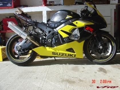

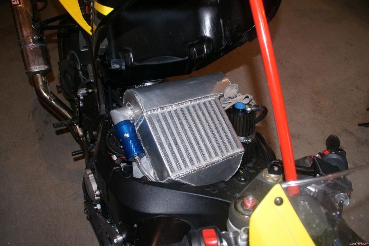

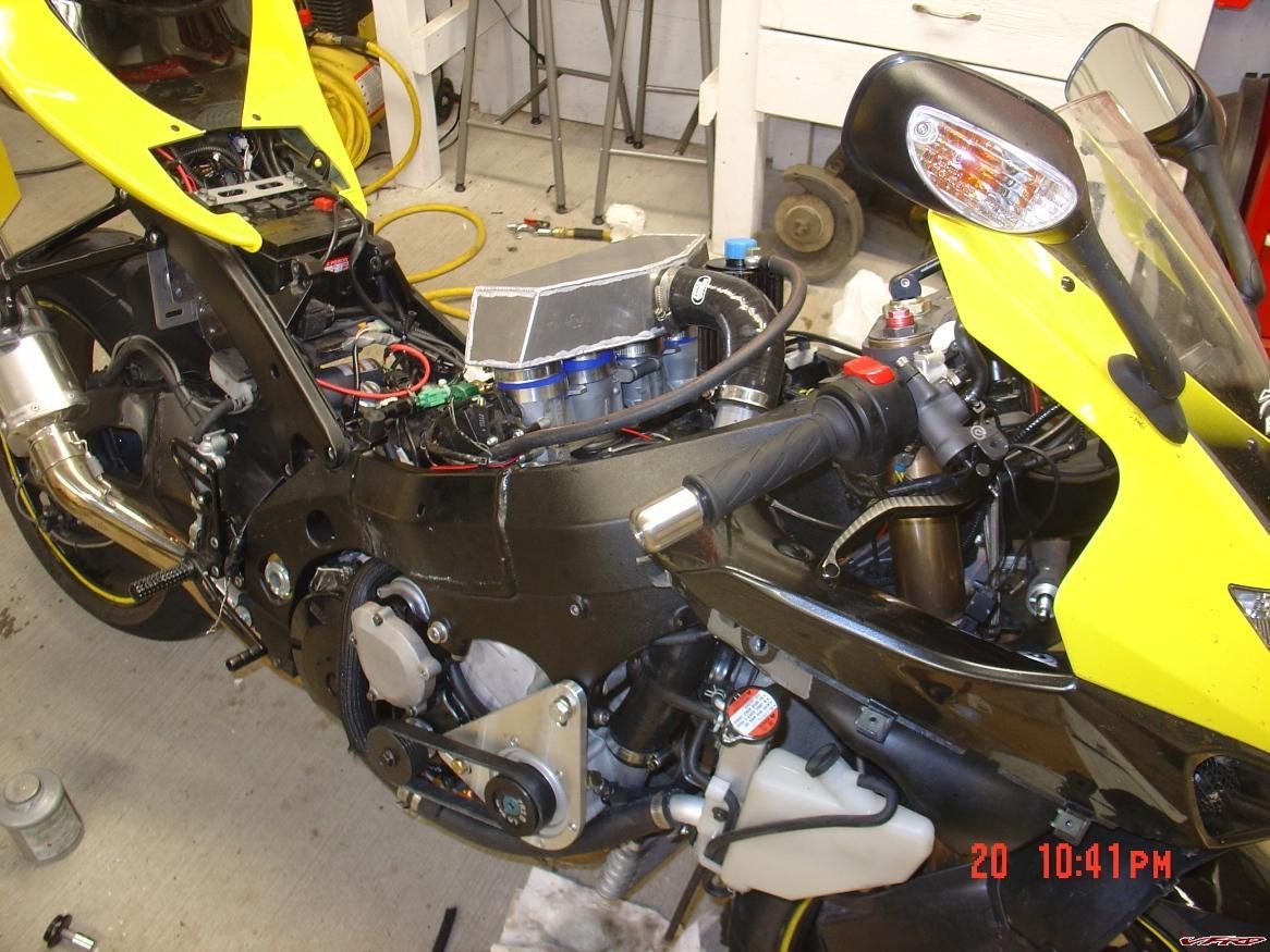

Guest hoozel Posted July 3, 2008 Posted July 3, 2008 dOOd, If I weren't married with children, I'd be all over the SC kit. Ok here is some pics of the Second Gen design, we did lots of work customizing the fairings to fit. It now looks like a stock bike almost.... except the blower area had to be cut out. So i am gonna need dome custom fiberglass work. here is the headers reshaped and moved over so we could get a propper intake on it, run over to the other side for cool fresh air. Closeup of header and Radiator.JPG Left side with Intake all ceramic coated. Close up of Intake.JPG Top down view of Intercooler and blowoff valve. Top down view intercooler.JPG Quote
Guest hoozel Posted July 3, 2008 Posted July 3, 2008 I have come across a problem though. as the wheel lifts into the air, which it does quite a bit now. I found out that the Blue cap on the Oil resevoir no matter how tight you have it, is not sealed. it is a breather cap, so oil likes to flow over everything..lol. yeah bike was smoking all of a sudden, I got off and went "uh oh this is gonna be expensive" ! but it turned out to be the traction fluid. So we are gonna need a machined cap that is sealed with a nipple in the top, attach a breather line and run that to a higher point, maybe up front with dash or something. If you can come up with a cap, i will for sure wire you money for one. I have lost my machining contact. lol. Quote
Member Contributer toro1 Posted July 3, 2008 Author Member Contributer Posted July 3, 2008 The mods look good. :fing02: As for the breather cap, even though I oftentimes also have a "light" front end, I never have oil come out. You need no more than for the reservoir to be half full -- is your filled more than that? If so, take some of that fluid out of there and see how it works. dOOd, If I weren't married with children, I'd be all over the SC kit. Rob, just start saving a penny here and a $100 bill there, and it'll add up in no time. Quote
