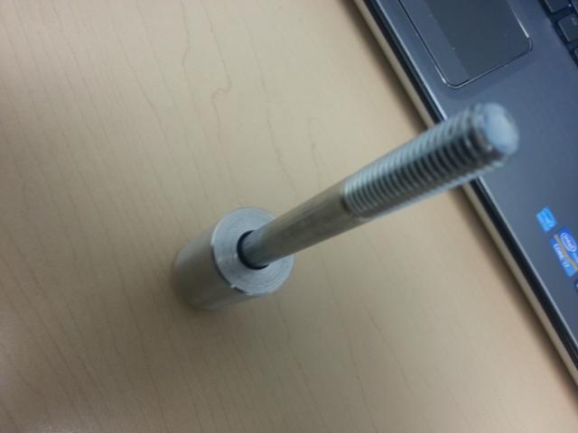

kc5555 Posted February 19, 2013 Posted February 19, 2013 (edited) Didnt have a metric bit for aluminum, ended up with a nice spacer, but not a tight fit around the metric 10.9 grade bolt.Should this be ok? Something tells me, not ideal, could introduce movement or slop in the connection. Another argument is that the forces are up and down, once bolted in snug, there should be no torquing laterally. That doesnt seem right either though. Or does an imperial bolt (sorry the sizes escape me) pass through the frame ok, in which case I would use it.... Edited February 19, 2013 by kc5555 Quote

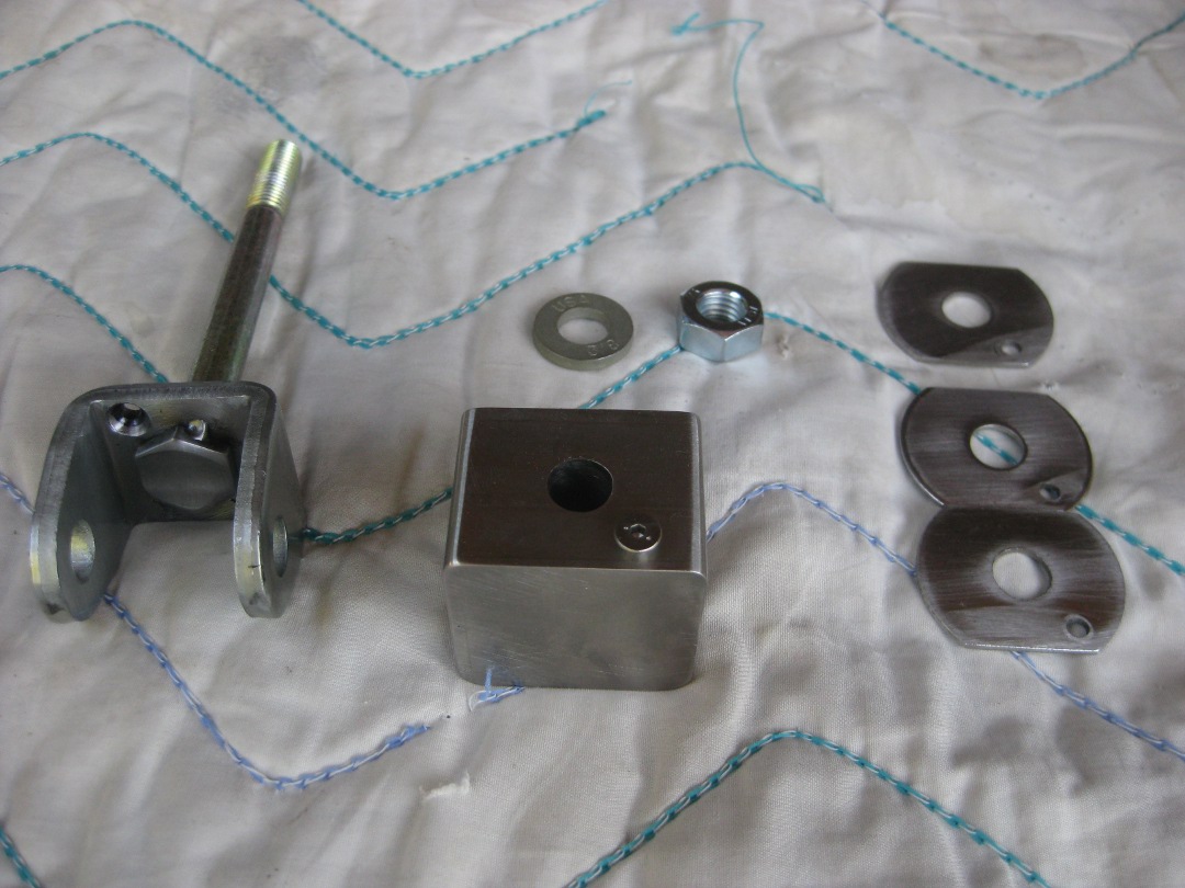

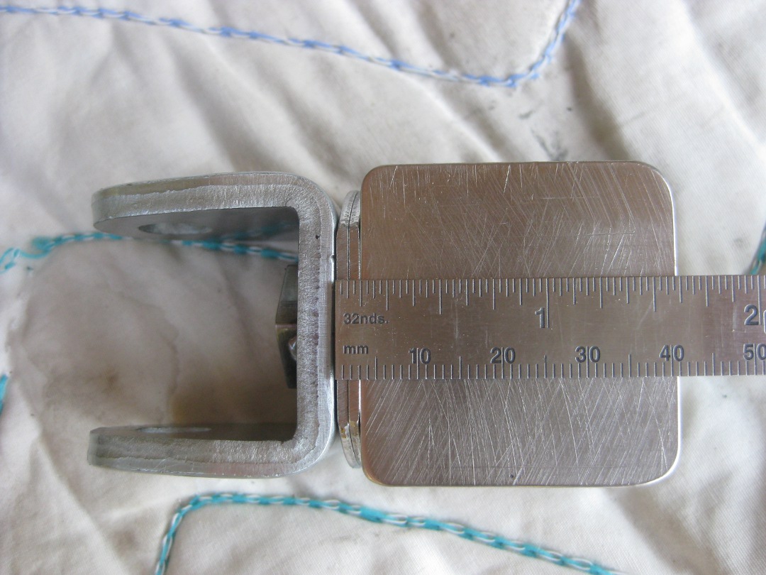

Member Contributer maxredline Posted February 22, 2014 Member Contributer Posted February 22, 2014 (edited) Yup, dragging up an old thread, but I want to update the best motorcycle ever built, so why not. My 01 is showing some signs of its age and want to do some modest updates, can you blame me, no. *I am hoping that someone may have taken the time to build a nice spacer unit to make up the difference on the 929 shock and have an extra to sell. If not there is enough info here to build my own. The front end is easy, I plan on taking it to a local suspension shop http://www.rmrsuspensions.com/ and let Rod do his magic on his recommendations. Message sent to Jamie Daugherty Edited February 22, 2014 by maxredline Quote
