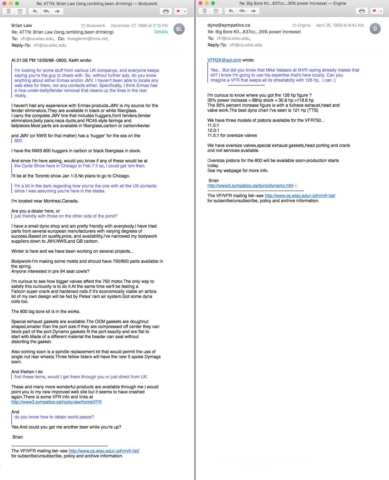

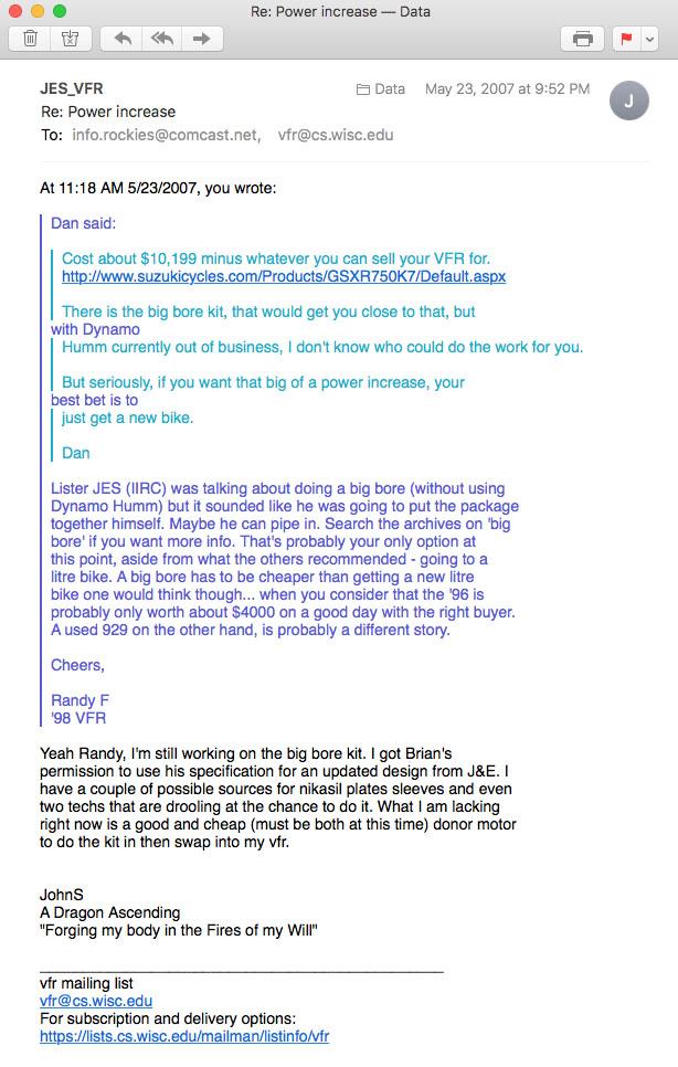

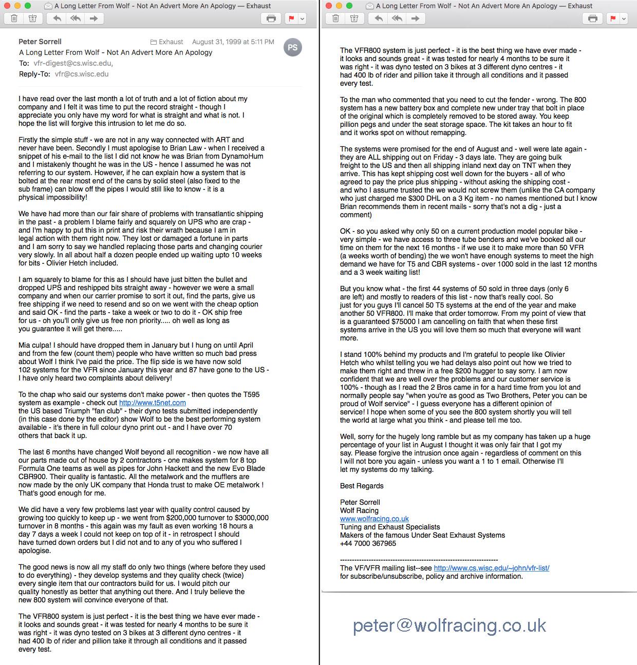

Member Contributer Lorne Posted November 27, 2024 Member Contributer Posted November 27, 2024 I found a few references in my saved emails about the Dynamo Humm 840 kit and the Wolf exhaust. Not much technical help, but it might add a little colour to the current discussion. 1 Quote
scup33 Posted November 28, 2024 Author Posted November 28, 2024 Thanks Lorne. Any info. is great ! ! It sheds some more light on things. Quote
