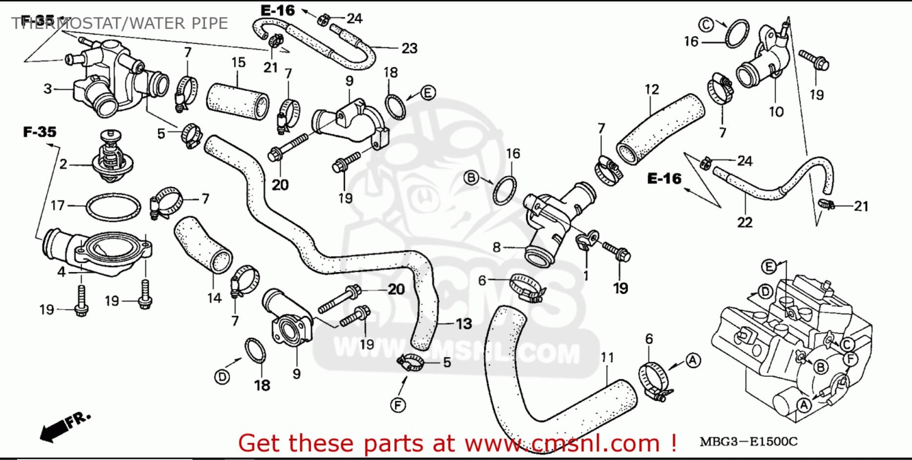

Member Contributer Skids Posted July 22, 2023 Author Member Contributer Posted July 22, 2023 No idea m8, just recall the difference in my experience over 130,000 miles vs others who didn't have to change shims. I liked yr idea of buying hoses now for future use when they may no longer be available, but it's not cheap. Not sure if all these parts would be needed but the cost of these: 2, 11, 12, 13, 14, 15, 16 x 2, 17, 18 x 2, 22 & 23 is £229.13. That is a bit of an investment, especially as I checked all the hoses on my 22 year old sub-9000 mile VFR which hadn't been ridden in 6 years and only completed 400 miles in the last 16 years and none of the hoses appeared to have deteriorated at all. Does anyone know if any particular hoses/seals are prone to deterioration? Quote
Member Contributer Bren Posted July 22, 2023 Member Contributer Posted July 22, 2023 Well I intend to get the RS3 hoses and keep them till I need them. I would be replacing seals 16, 17 & 18 when the time comes. Quote

Member Contributer mello dude Posted July 22, 2023 Member Contributer Posted July 22, 2023 Probably means AS3 hoses... plenty of members here have purchased them... https://www.as3performance.com/collections/silicone-radiator-hoses-honda-vfr-800 Skids... what is your current milage today? 1 Quote

Member Contributer Skids Posted July 22, 2023 Author Member Contributer Posted July 22, 2023 2 hours ago, Bren said: Well I intend to get the RS3 hoses and keep them till I need them. I would be replacing seals 16, 17 & 18 when the time comes. Ordered! Thanks. Quote
Member Contributer Skids Posted July 22, 2023 Author Member Contributer Posted July 22, 2023 21 minutes ago, mello dude said: Probably means AS3 hoses... plenty of members here have purchased them... https://www.as3performance.com/collections/silicone-radiator-hoses-honda-vfr-800 Skids... what is your current milage today? Thanks for the correction....ordered. Quote
Member Contributer mello dude Posted July 22, 2023 Member Contributer Posted July 22, 2023 You will need to consider waht hose clamps to use also.... AS3 set or I am looking at Norma based on... 1 Quote
Member Contributer Bren Posted July 22, 2023 Member Contributer Posted July 22, 2023 40 minutes ago, Skids said: Ordered! Thanks. Oops as Mello said AS3. I'm in Ireland on holidays so going off my Guinness fuelled memory. Good move to get them now before they stop producing them, only Samco after that and they are $$$$ 1 Quote

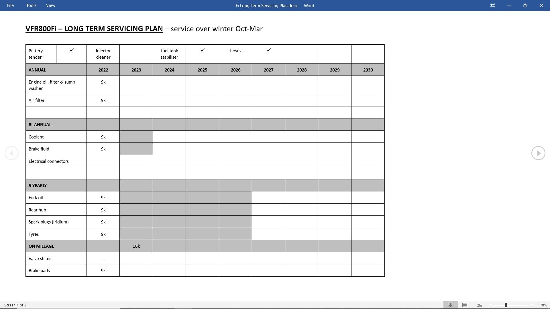

Member Contributer Skids Posted December 14, 2023 Author Member Contributer Posted December 14, 2023 On 7/22/2023 at 2:00 PM, Bren said: I would like to see your schedule when it's finished if you don't mind, always good to get more ideas. @Bren - sorry it took so long, starting on winter service next week. Here's a wip, not doing 18 month replacements (air filter) and right now I'm thinking air filter every 2 years. Also still tempted to take a look at the valve shims. I know it's only 9000 miles but it's also 22 years. Dunno. Fi Long Term Servicing Plan.docx Quote
Member Contributer Bren Posted December 17, 2023 Member Contributer Posted December 17, 2023 @Skids looks good to me. I would do the electrical connectors purely due to the age, I see you have this listed already. Do you intend to change out the most likely stock RR? I got a CBR500 one which is a FH020 and it´s working perfectly, I used the Metri Pack connectors for the stator connection also instead of hard wiring them so I can remove it if necessary. If it gives you peace of mind then check the valves, won´t harm anything. Enjoy the servicing its a great winter pastime when its not possible to ride 🍺 1 Quote
Member Contributer Skids Posted December 17, 2023 Author Member Contributer Posted December 17, 2023 @Bren the RR is original. I have fitted a voltmeter and already have a replacement upgraded RR waiting in a box. Just oil and filter this winter but I may decide to check the shims next winter. Quote

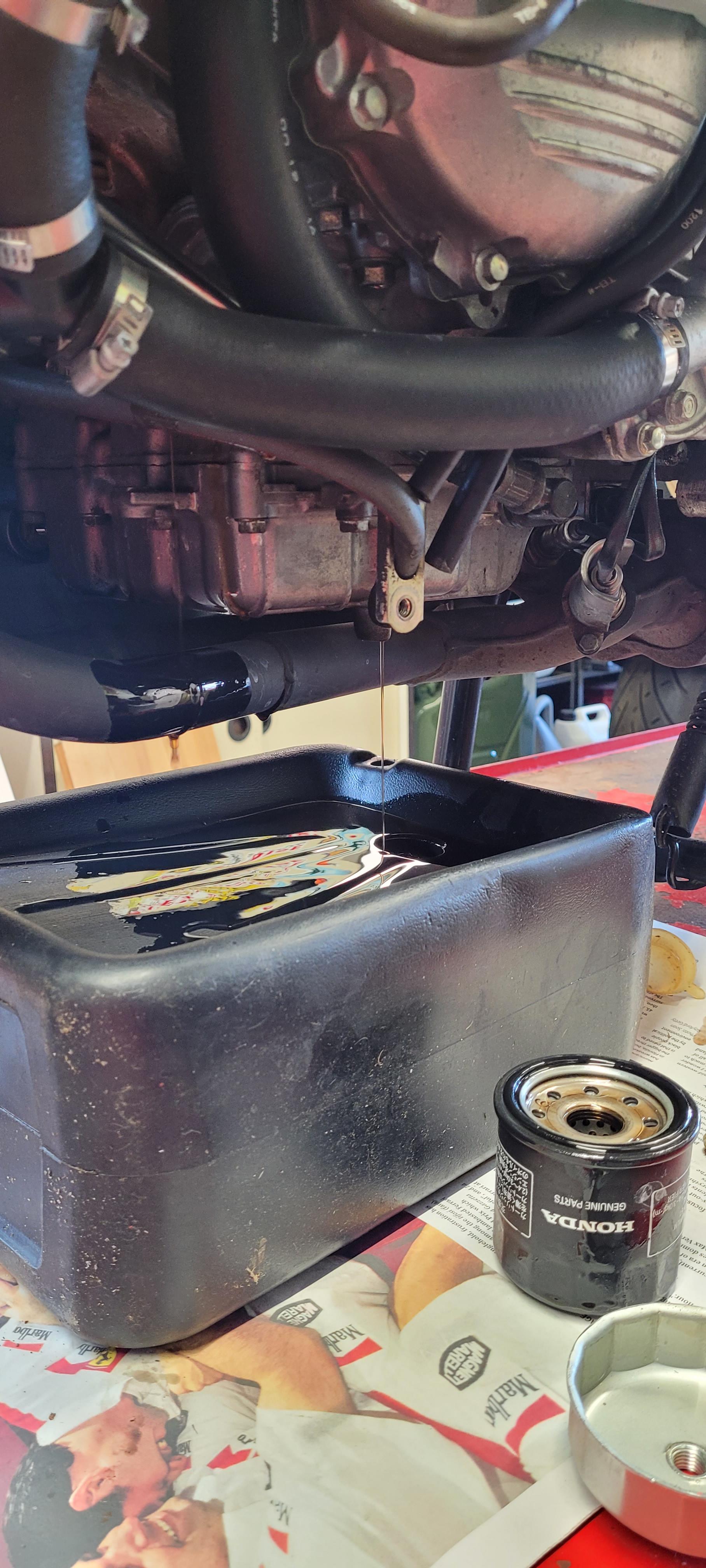

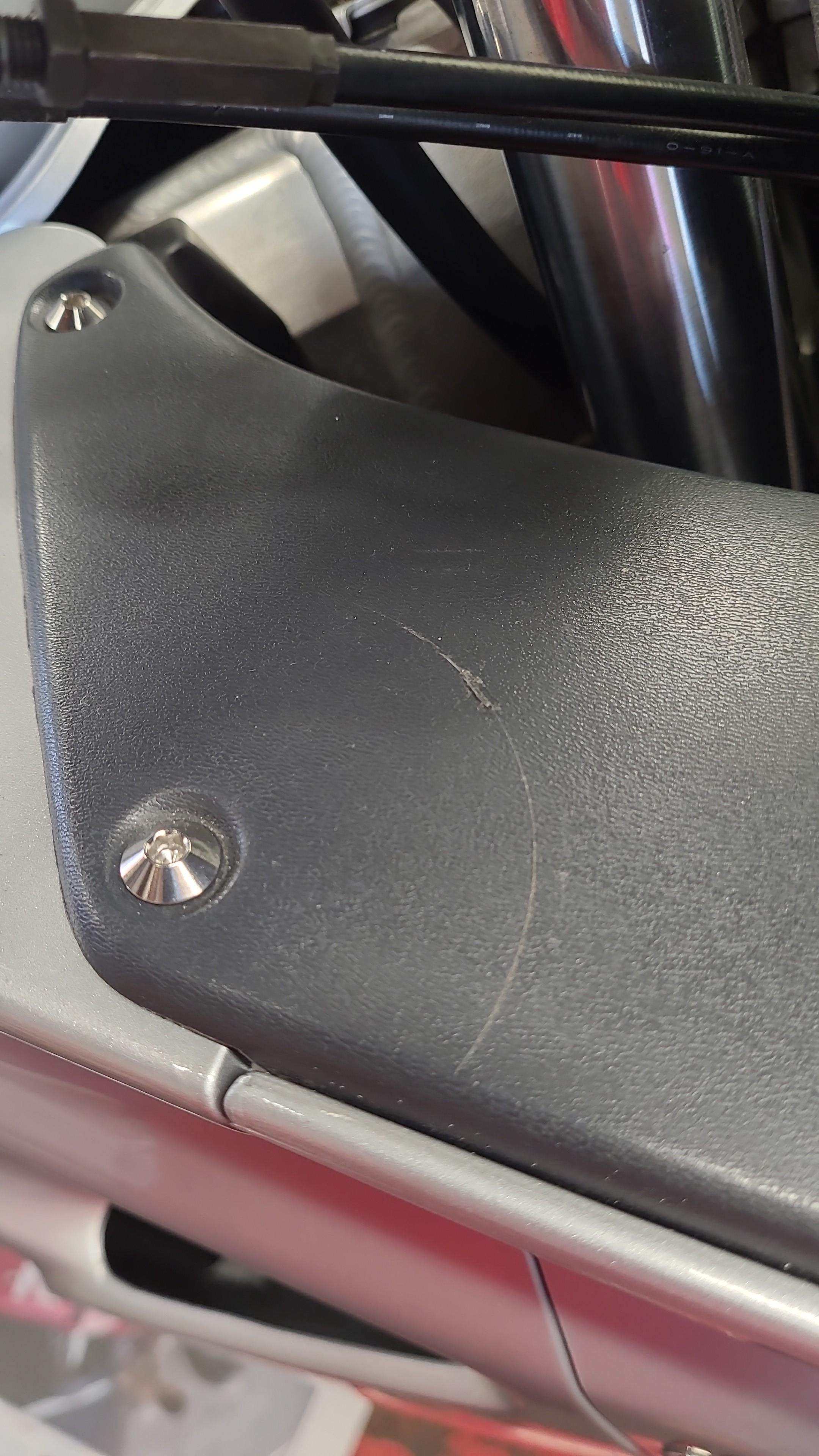

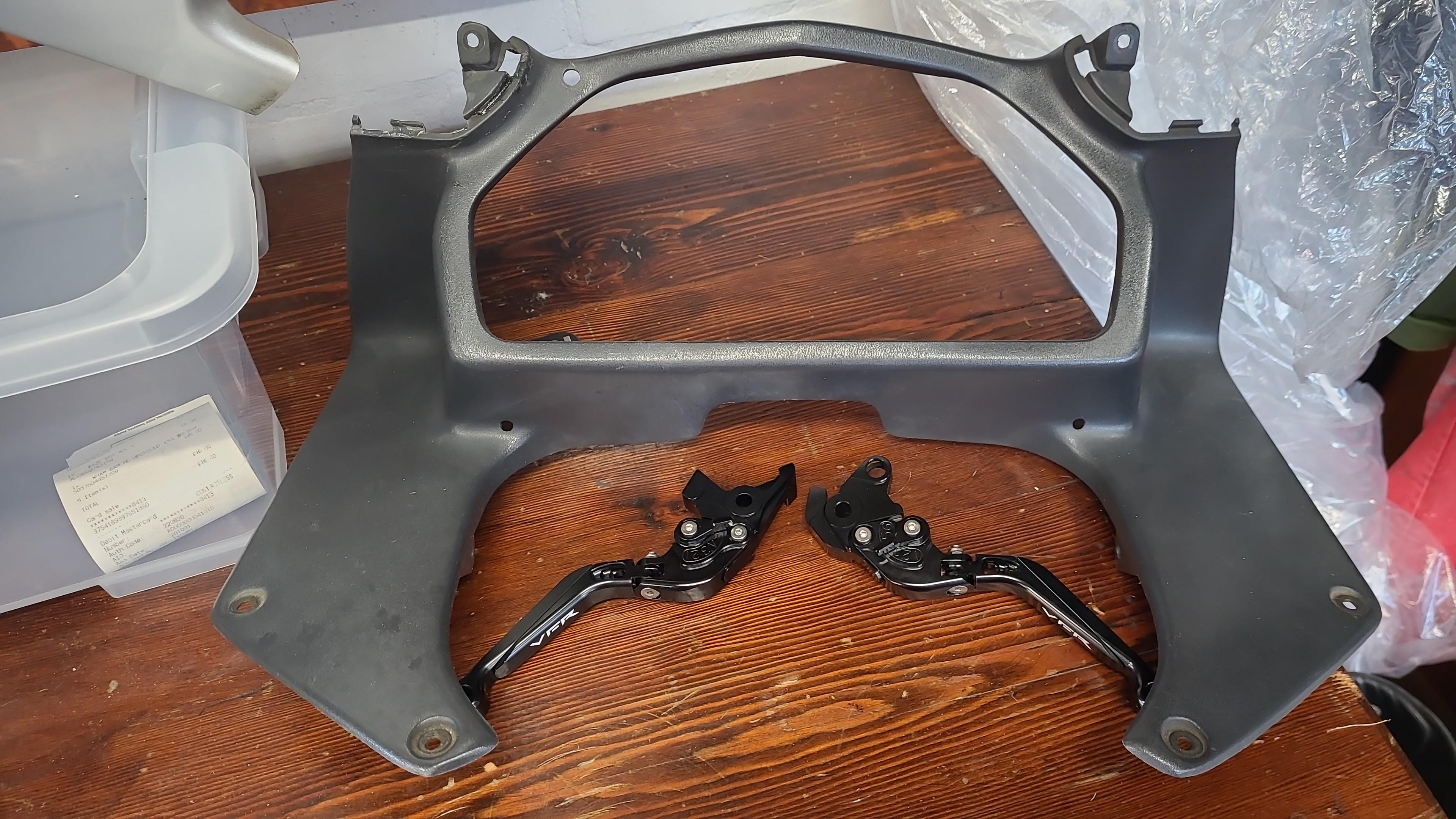

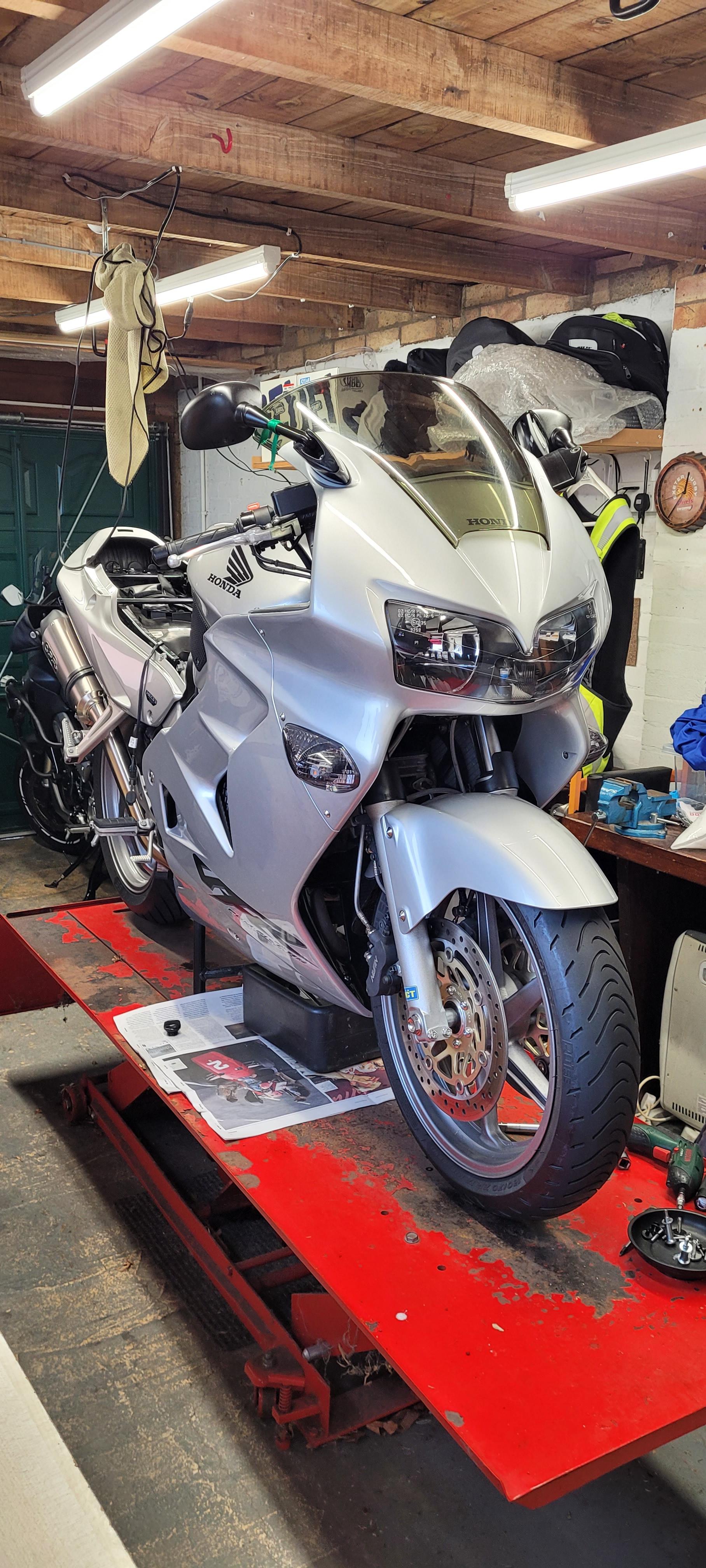

Member Contributer Skids Posted January 28, 2024 Author Member Contributer Posted January 28, 2024 Annual service whilst she is off the road fir the winter. Plus fit new levers and a replacement binnacle as the PO made a huge scratch in this one Quote
