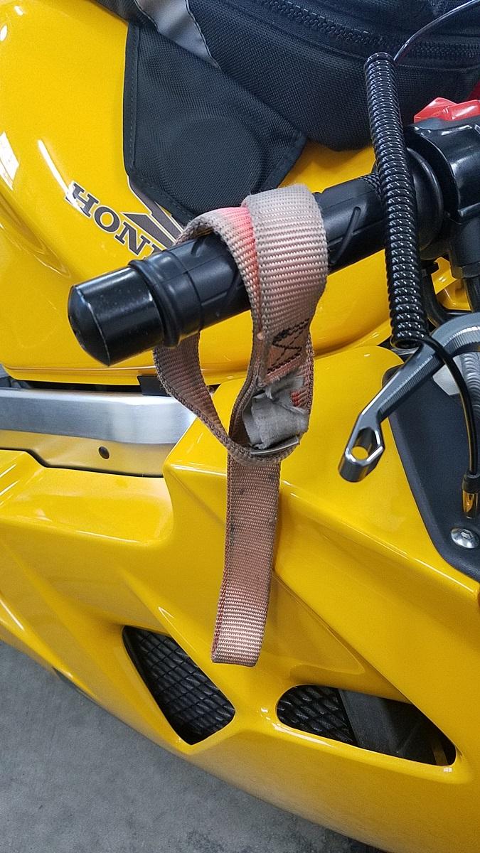

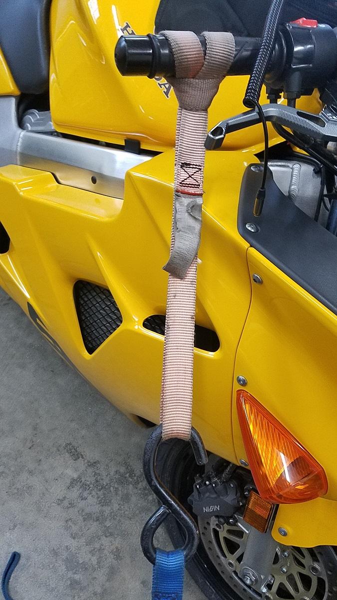

Maybe I can put a strap across the two handlebar grip straps to prevent it from slipping outwards. Anything on top that might get damage from the pressure downwards?
Yeah maybe.   If your soft straps are long enough, you can wrap around once extra and then have both loops for the hook.  That way the soft strap cinches. Nice thing about going off the grips is the pull is more down than to the side, so less likely to slip.
I've used that method MANY times.
I've been transporting bikes for decades with a soft tie and strap on each grip without any issue (pulling up to tighten). We even hit a deer once and the trailer was up in the air. The bikes did not move. If the straps get wet they stretch out, so monitor that. If it makes you feel more comfy, put two on each side. (Also tie the back down in a similar fashion. On my 5th gen I use the rear peg mounts.)
Ensure that the soft ties aren't trying to turn the grips when tight. I usually set the right one so that a little throttle movement is used to keep pressure off of that whole assembly.
Make sense?
That's how I've it done for years too.  Transported a LOT of bikes for the shop.  Some bikes I double wrapped the strap for more tie down length for other issues and for more cinching area cuz I was extra nervous on some grips (not my bikes).

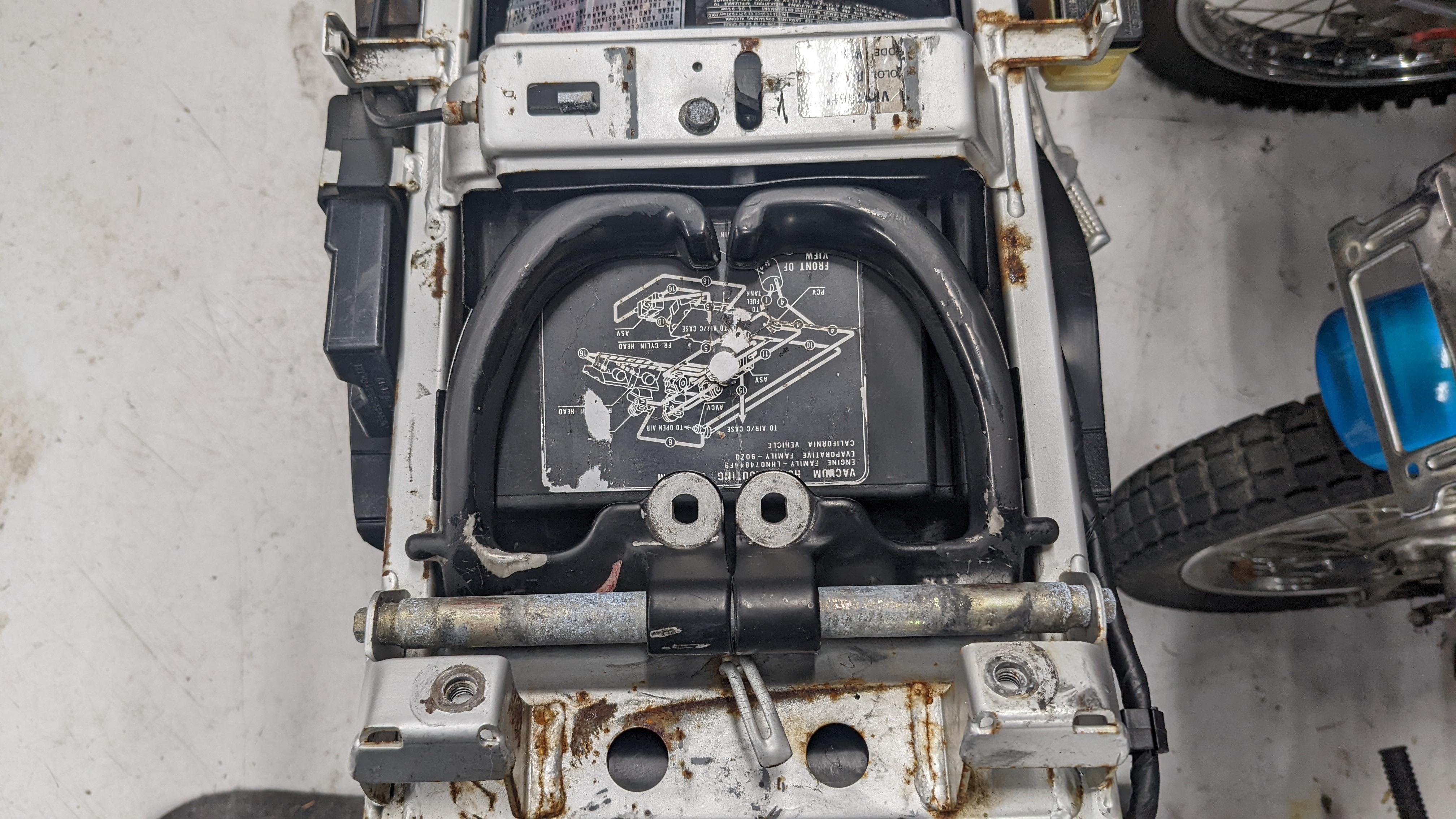

You wouldn't want to use the passenger grab handles to tie down the bike anyway.  I don't think they are metal (I know they weren't metal on at least the 5th and 6th gens) and could be prone to snapping under a lot of pressure, especially being over 30 years old.
Good luck with the trip!
3rd gen handles are cast allloy.  They could certainly take some direct side-to side stabilization, but the passenger peg mounts are the best option.
2 hours ago, DesertKyorugi said:
Just looked at the pictures again and realized my bike does not have the rear grab rails. I guess I will just have to double down on the rear pegs
It has them....  they are slid in and rotated forward under the seat in a tray (very likely).  Pretty cool feature.
😲 I am impressed! I will have to take a look and check it out. The bike has a removable seat cowl cover on it. Pretty sure the seat is still a one piece double seat

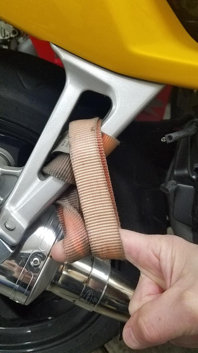

I do this on the back.
That's the double wrap I sometimes do on grips.

Just looked up the manual, the bike should have this. And from the looks of it, it can definitely work as additional side to side stabilizer after the front and rear pegs have already been tied-down
Once at your destination, replace this bolt with a longer one with a nylock nut (or one with Loctite).
The OEM one is just a bolt and will at some point decide it wants its freedom.....

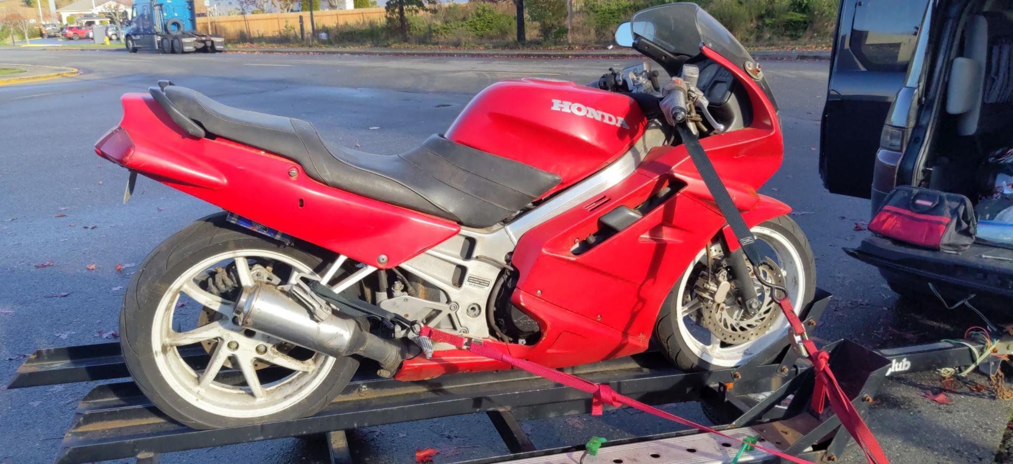

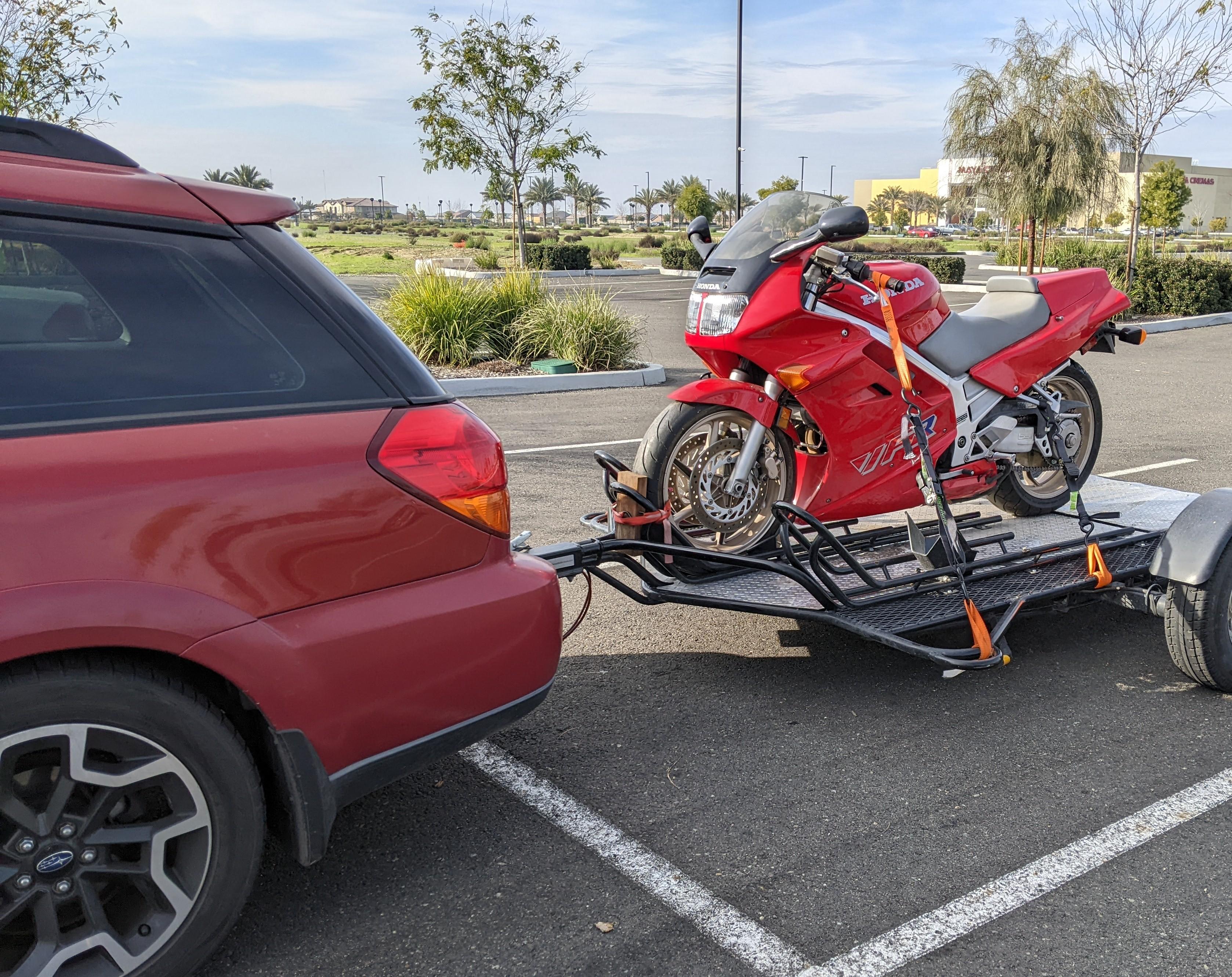

Got it home safe and in one piece. The right hand strap slid off the throttle grip a couple of inches after 250 miles. Had to redo the strap for the rest of the 100+ miles.
All original with the factory tool kit, rust free California bike
  • Like 6
For the future, the front straps are tied too far back on teh trailer. They should be pulling the front wheel into the chock...then they can't move. 🙂 Glad you got the job done! Congrats.
