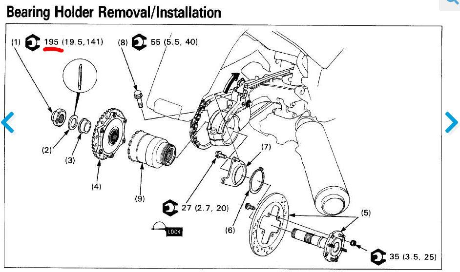

nikovee Posted September 24, 2021 Author Posted September 24, 2021 Looks like 195 Nm per the service manual. I know the nut was staked as I recall seeing the deformation, but guessing it wasn't staked well enough. fortunately I work in aviation and have access to plenty of safety wire, will most likely be making that mod to prevent this from happening again. Quote

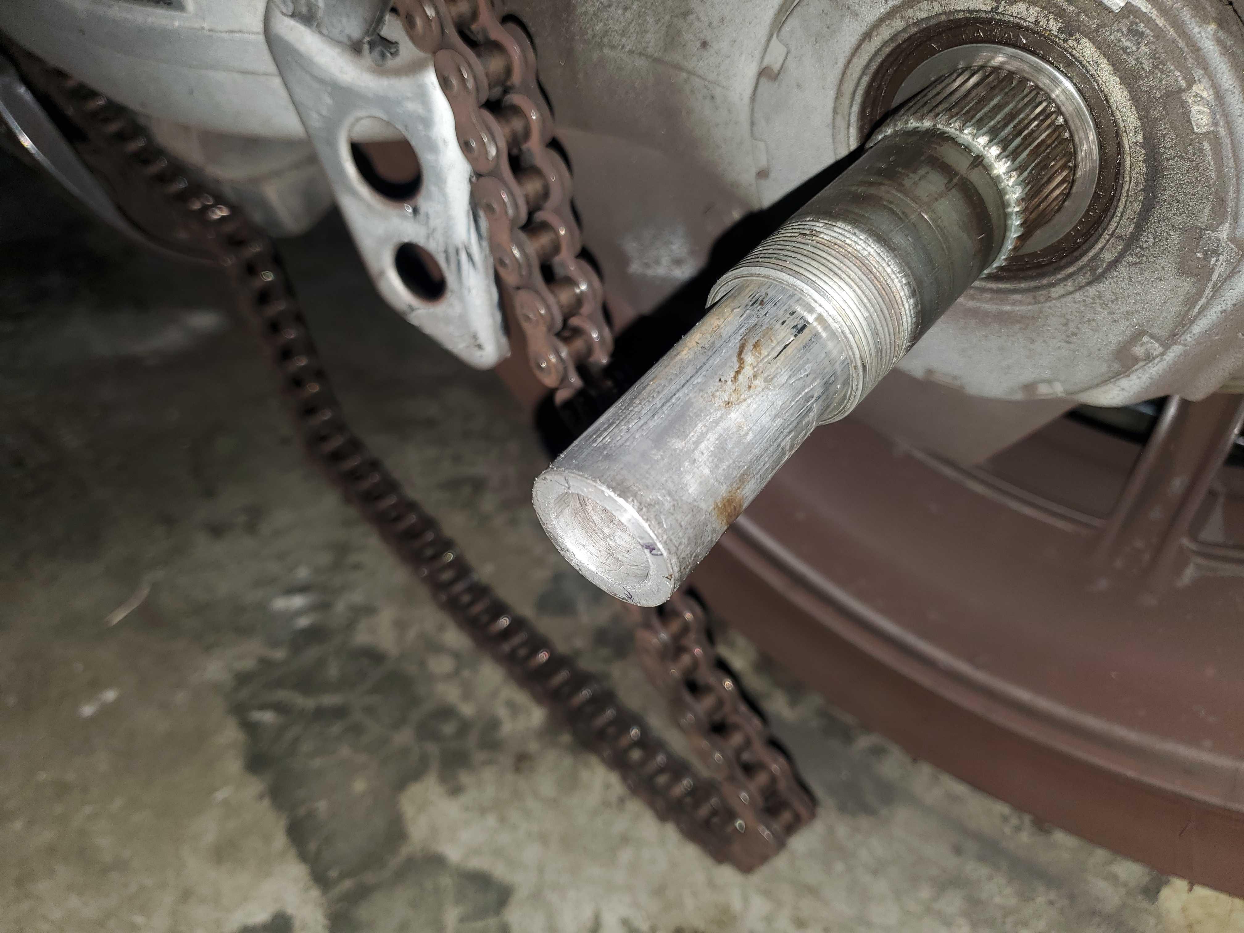

Member Contributer JZH Posted September 25, 2021 Member Contributer Posted September 25, 2021 Sorry to hear the 35mm ID "conical spring washer" is NLA--that's never a good sign! Titan Classics reproduces the 38mm version of this in titanium, but that's only good for the NC30/35/ RC30/45 sized axles. FYI, Revzilla says it's in stock, but I don't think I believe them, because nobody else shows it as available. It'd be different if they were David Silver Spares or Hondarestoration.com, but I suspect their database is just out of date. Worth checking, though. Speaking of whom, DSS says it can be special ordered, which might be true, given that I also found it showing as "in stock" at a Japanese parts site. If the bushing is an insert, I bet it will simply tap out using a big drift from the wheel-side. OTOH, if that's all it is, there's probably no particular reason to remove it. Unless you're using a SSSA stand or planning to do a single-nut conversion (which utilize a solid axle within the hollow axle), the only useful thing I can think of which you now cannot do is put a u-lock through it (or a Pragmasis "Anti-Pinch Pin", which I have here). Ciao, JZH 1 Quote

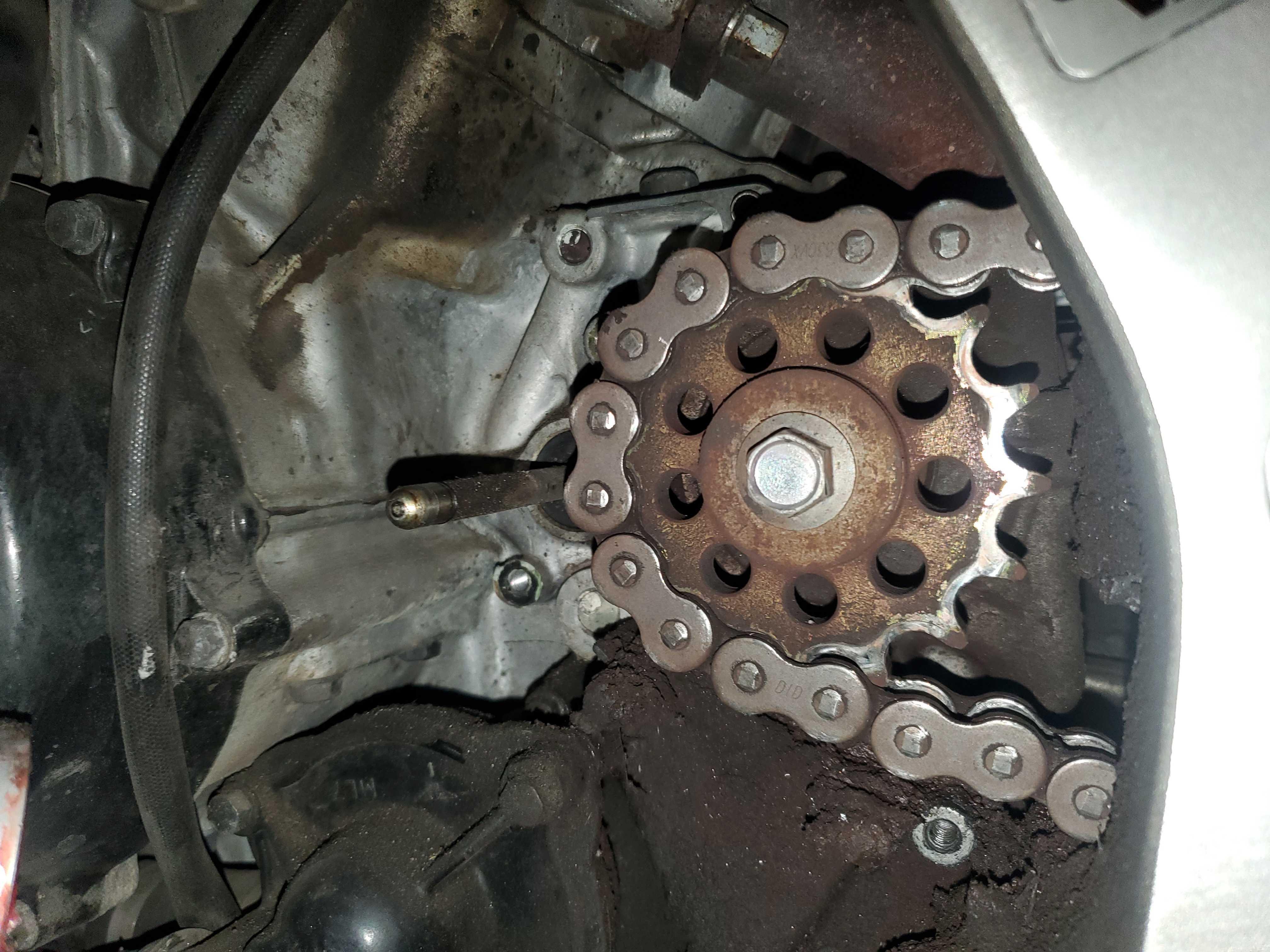

nikovee Posted September 27, 2021 Author Posted September 27, 2021 thanks for the tip JZH! placed an order through DSS, hopefully it won't take too long. I was able to successfully remove the insert, finally got that rear up on the stand. looking at the front sprocket, I didn't notice any damage in the area nor on the cover, so I think I may be good there. I did discover that at some point the slave gasket was replaced with RTV, so ordered a replacement. Now debating whether or not I should replace chain+sprockets while I am at it, but not overly excited about having to cut the OEM masterlink-less chain off Quote

Member Contributer Captain 80s Posted September 28, 2021 Member Contributer Posted September 28, 2021 So somebody replaced the chain with an endless OEM one at some point? Or it went that far? Anyway, with the potential trauma that chain might have suffered and how lucky you were not to have any damage around the counter shaft, I think it's wise to replace at this juncture. Plus, if the chain fails and takes out your clutch rod and counter shaft area, I will then ask you how much would you pay right now to not have had it happen. Guarantee your answer is more than $100. 1 Quote
