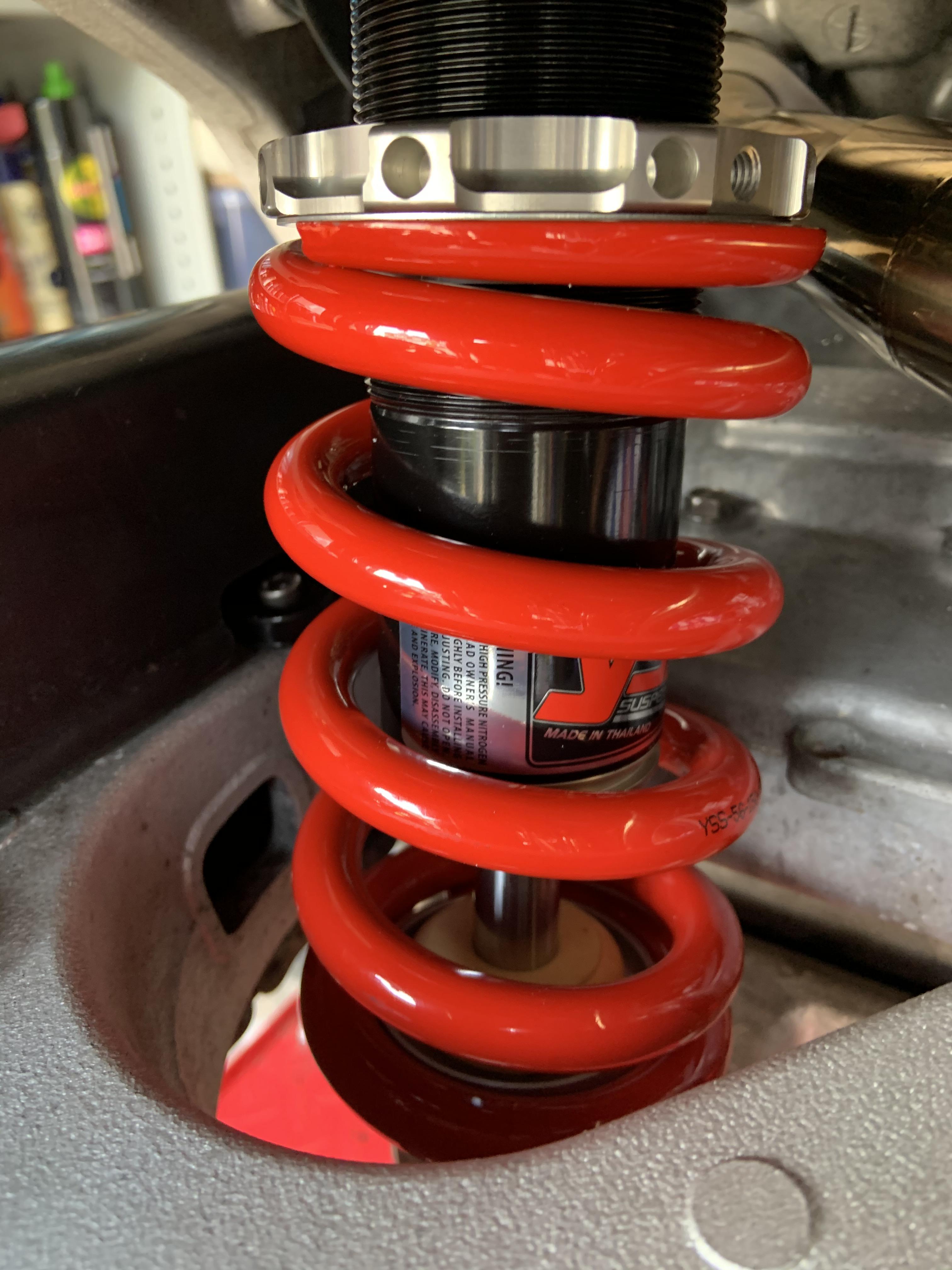

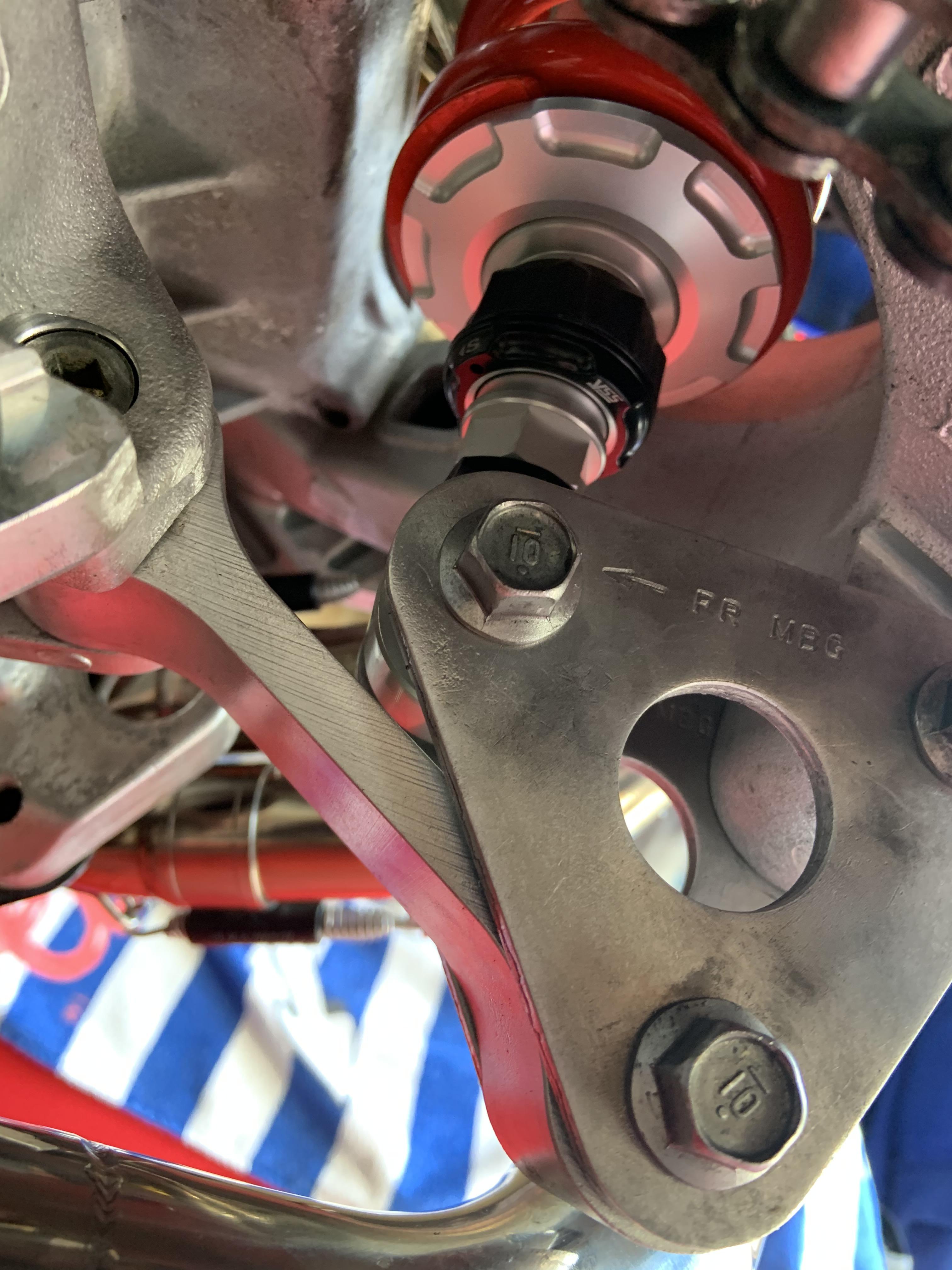

Don't bother looking for an original shock. They will all be well past their sell by date. No one can rebuild them and not economically viable either. I know , I tried.
Your choice of aftermarket shock is quite wide.

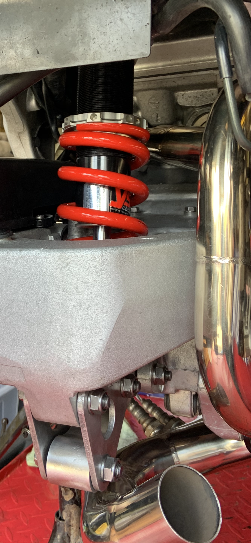

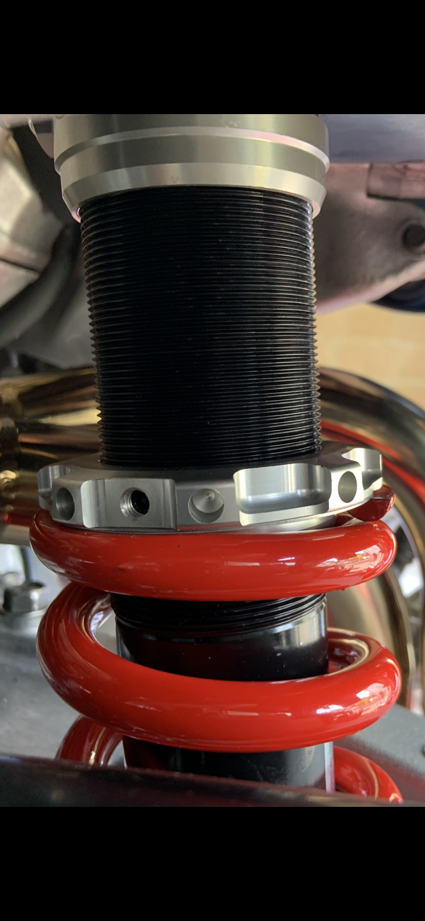

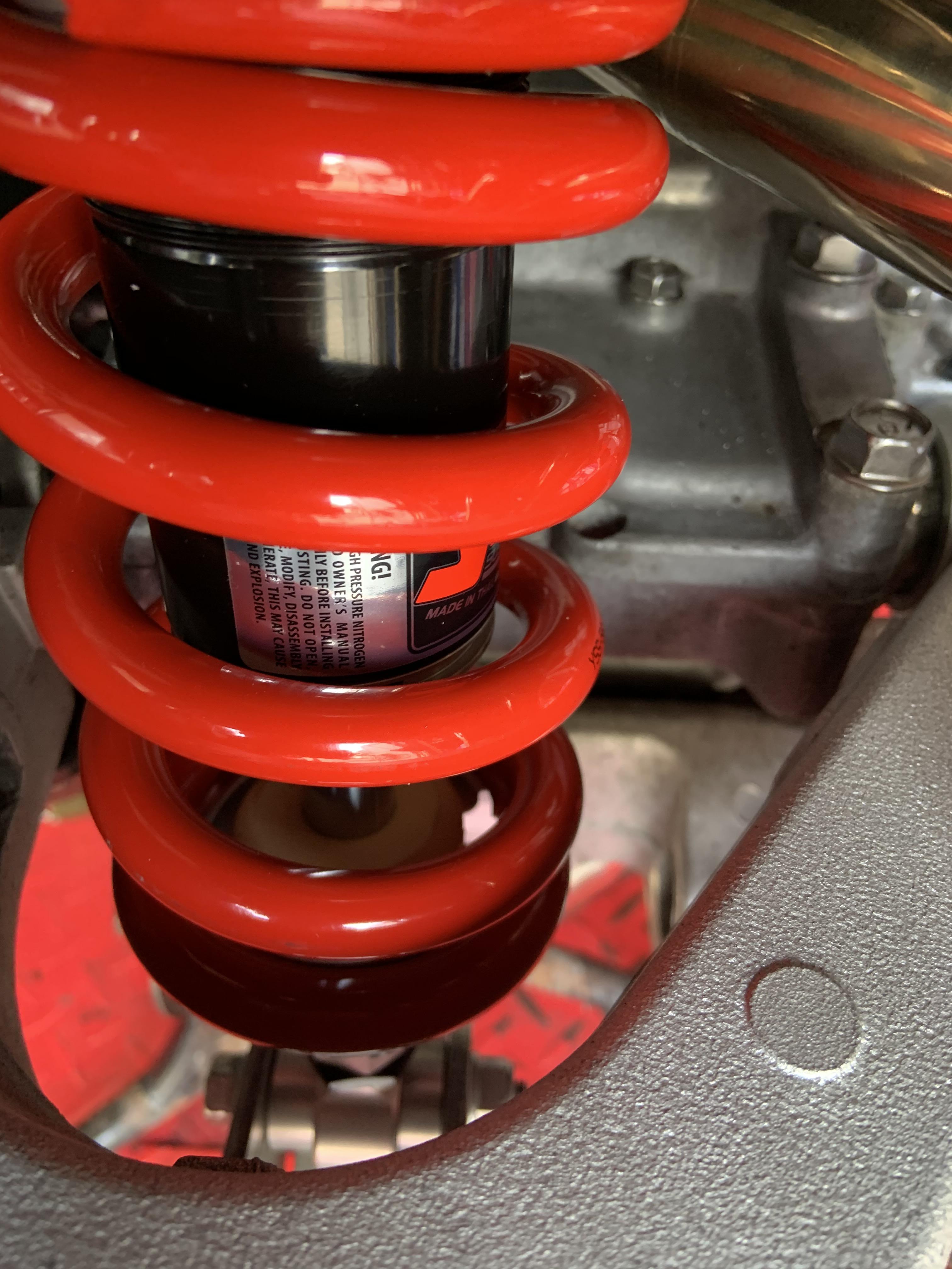

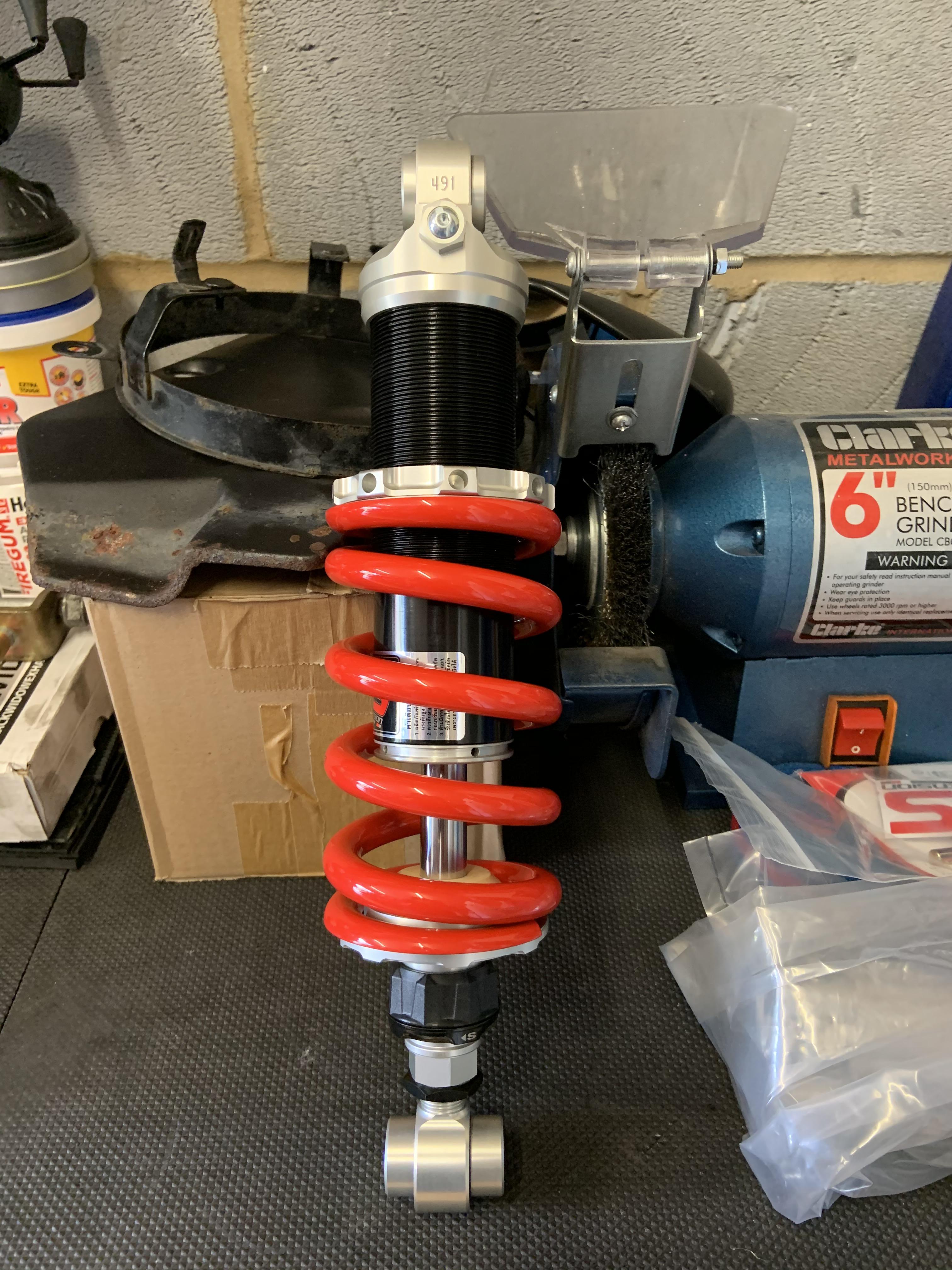

After much research I went with a YSS  rear shock .
 I am very pleased with it. I have had bikes with Ohlins / other high end shocks and I have absolutely no qualms giving the YSS shock a recommendation. Quality is excellent , beautifully made and went straight on with  absolutely no issues.
I am not lightweight , about 105 kg. I find the shock works admirably .
I bought mine from Brooks suspension . They gave me excellent service and can recommend them. When I spoke to them about it, they thought I was working on a track day / race bike and their comment about YSS was " surprisingly good ". When I told him it was for a VFR 800 Fi road bike he said its all you will ever need.
I am not sure what else I can tell you about it.
Some pictures of mine just after fitting it.
  • Like 4

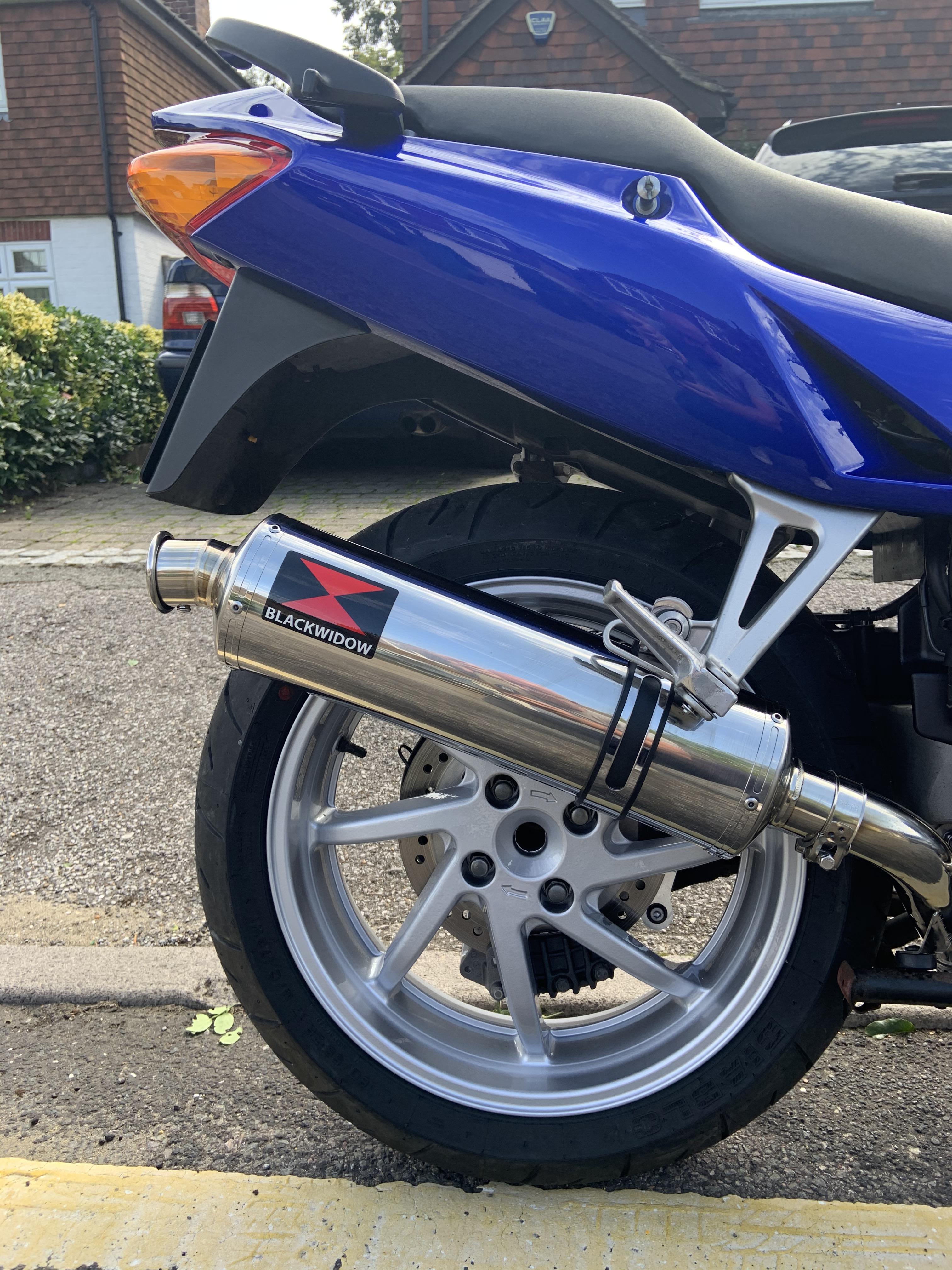

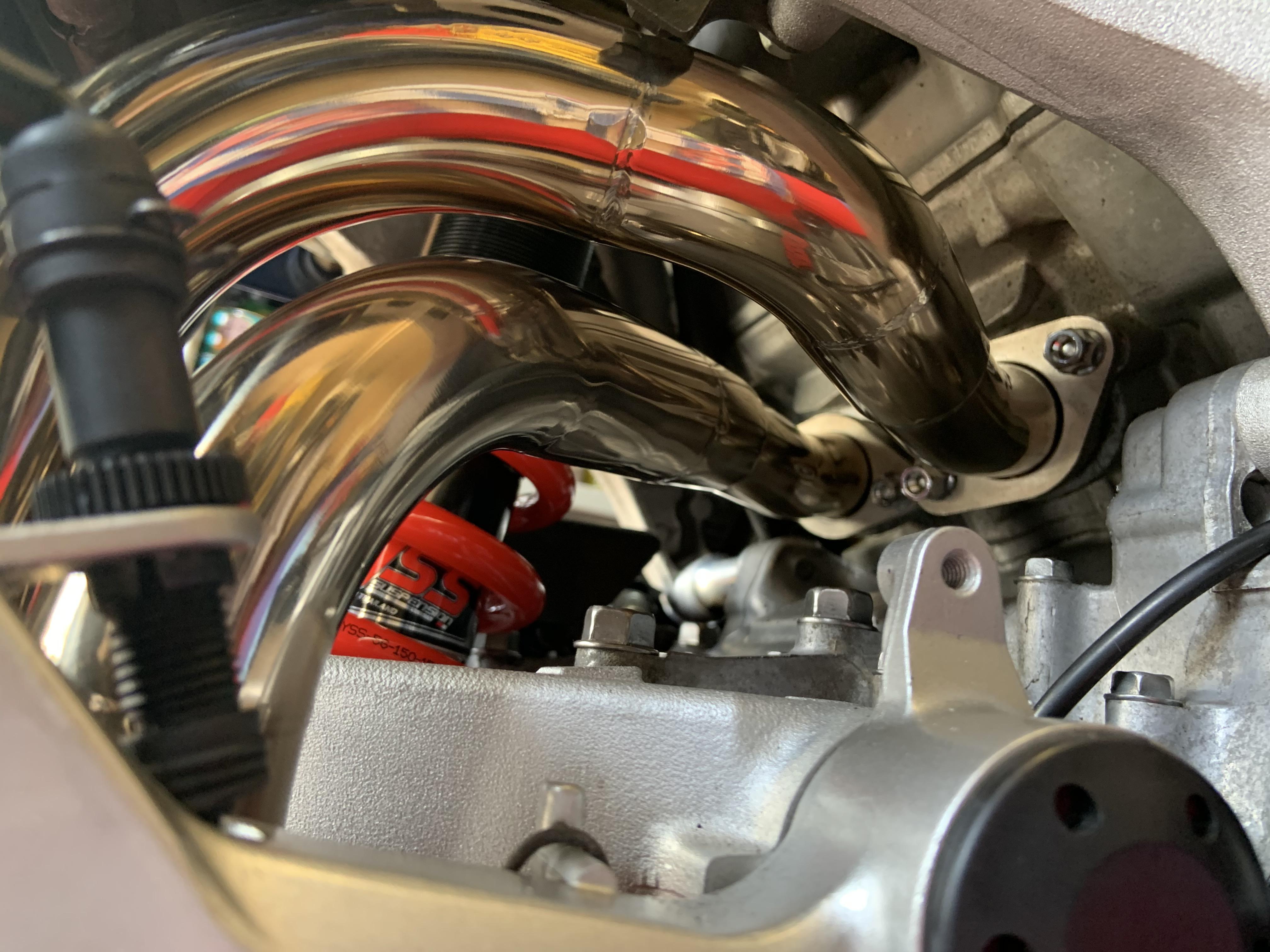

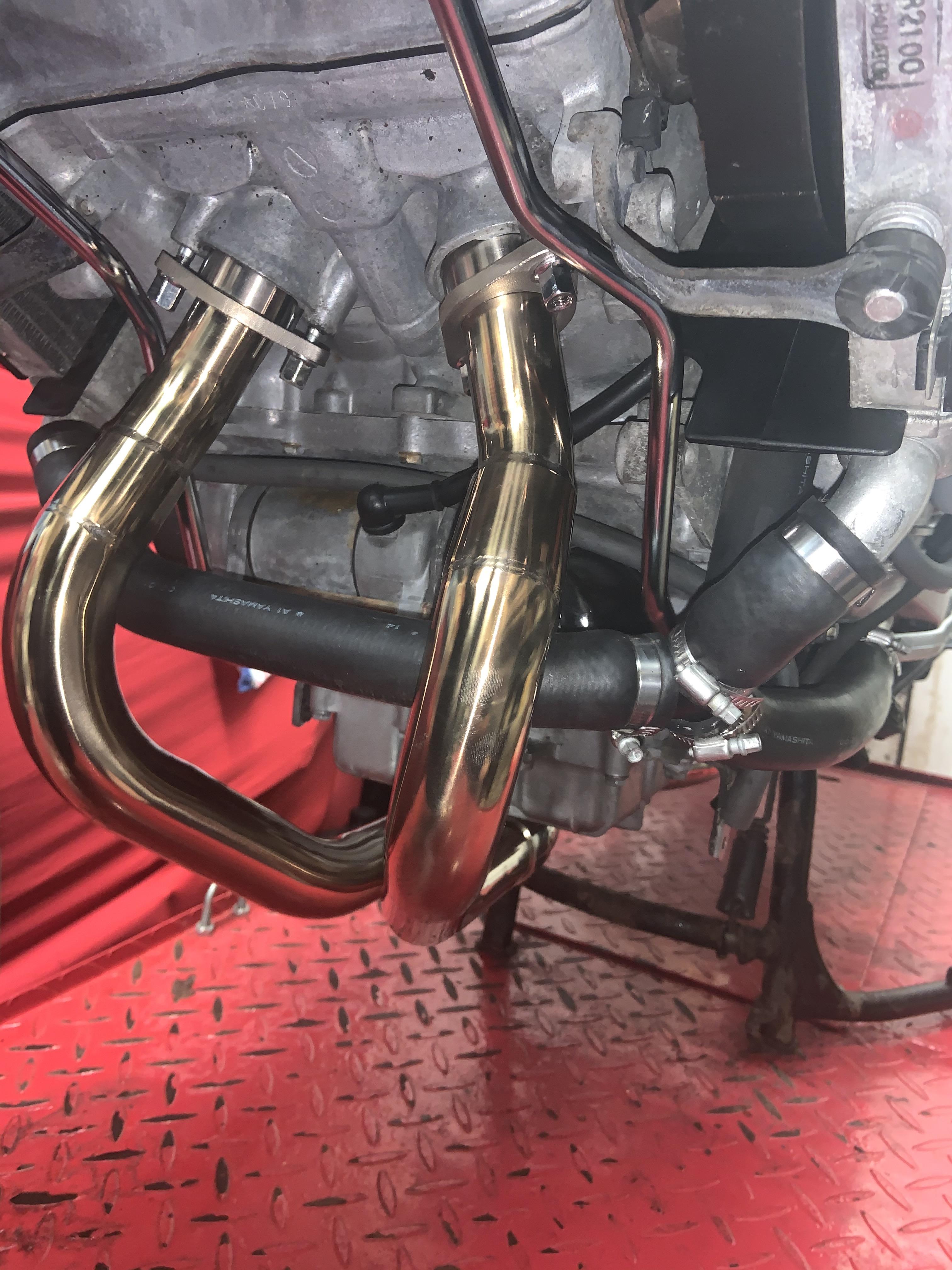

Hi Jukka ,

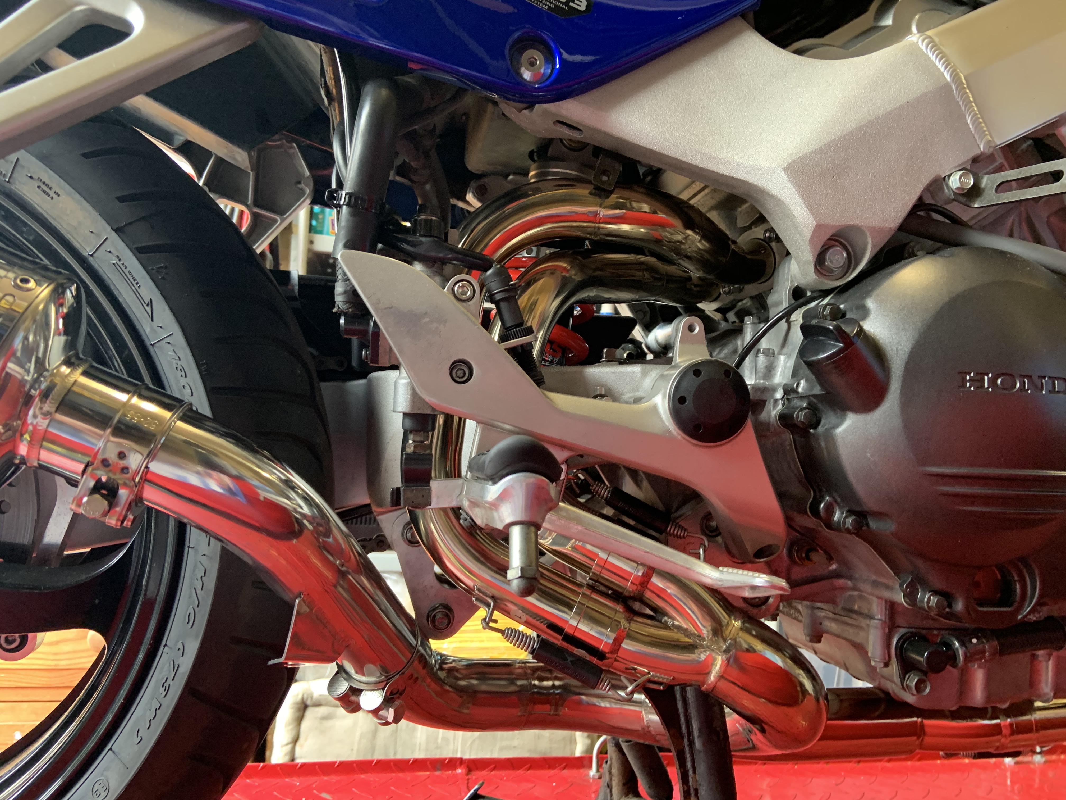

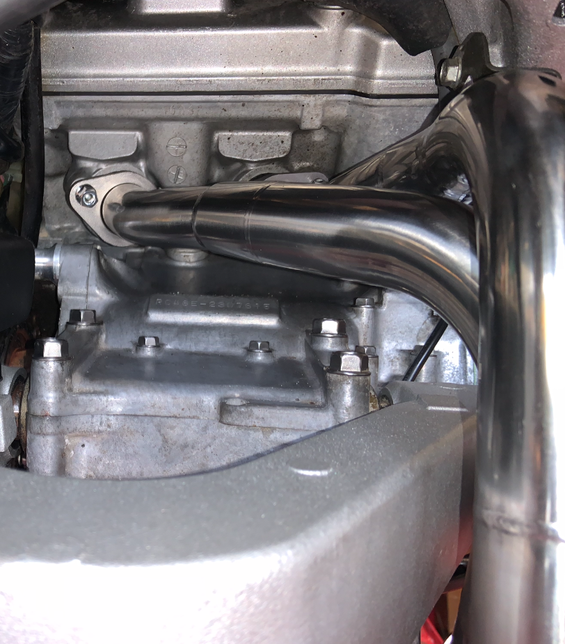

You are correct , I have installed the black widow headers and end can .
I am very happy with it and I thought the quality, fit and finish was very good. The O2 sensors fit straight in and I have had no issues with any of it. The bike runs very well and I think if you are using the standard air filter and the standard end can it just fine as it is.
However , if you change the air filter for something like a K&N and use a different end can then I think you would benefit from a fuel re-map to get the best out of the new system as these bikes run a little lean from standard and the changes will lean it out further . I have gone that way , having fitted a power commander V with a generic map, which did make the bike ride much better . When the weather gets better as its winter here also, but nothing like your winter ,  I shall go an get a custom map for it because I think the bike has more to give .
I have included some pictures in case anyone else is thinking of going the Black Widow way .
Rewgards,
Nat.
Those BW headers look nom nom nom! But will you guys get some DIRT and BUGS on your bikes! It takes me 10min riding to generate a 3 day cleaning and I've still got ugly shit on everything.  Just as well I can ride my filthy girl with a reasonably clear conscience.
The Showa rebuild for me is a moot point now that I've sourced a 929 shock. Even the AU$600 price tag for a YSS is well more than half of what I paid for the bike.  There's showroom rebuilds and there's economic reality for me.  Regardless, very much enjoying this bike.  A far cry from the two Transalps that took me (mostly off road) around Australia and bits of Africa - grossly overladen and at an appropriate pace: slow!
Those headers look a lot better than the "Sandy Bike Spares" efforts of old, I must say...
