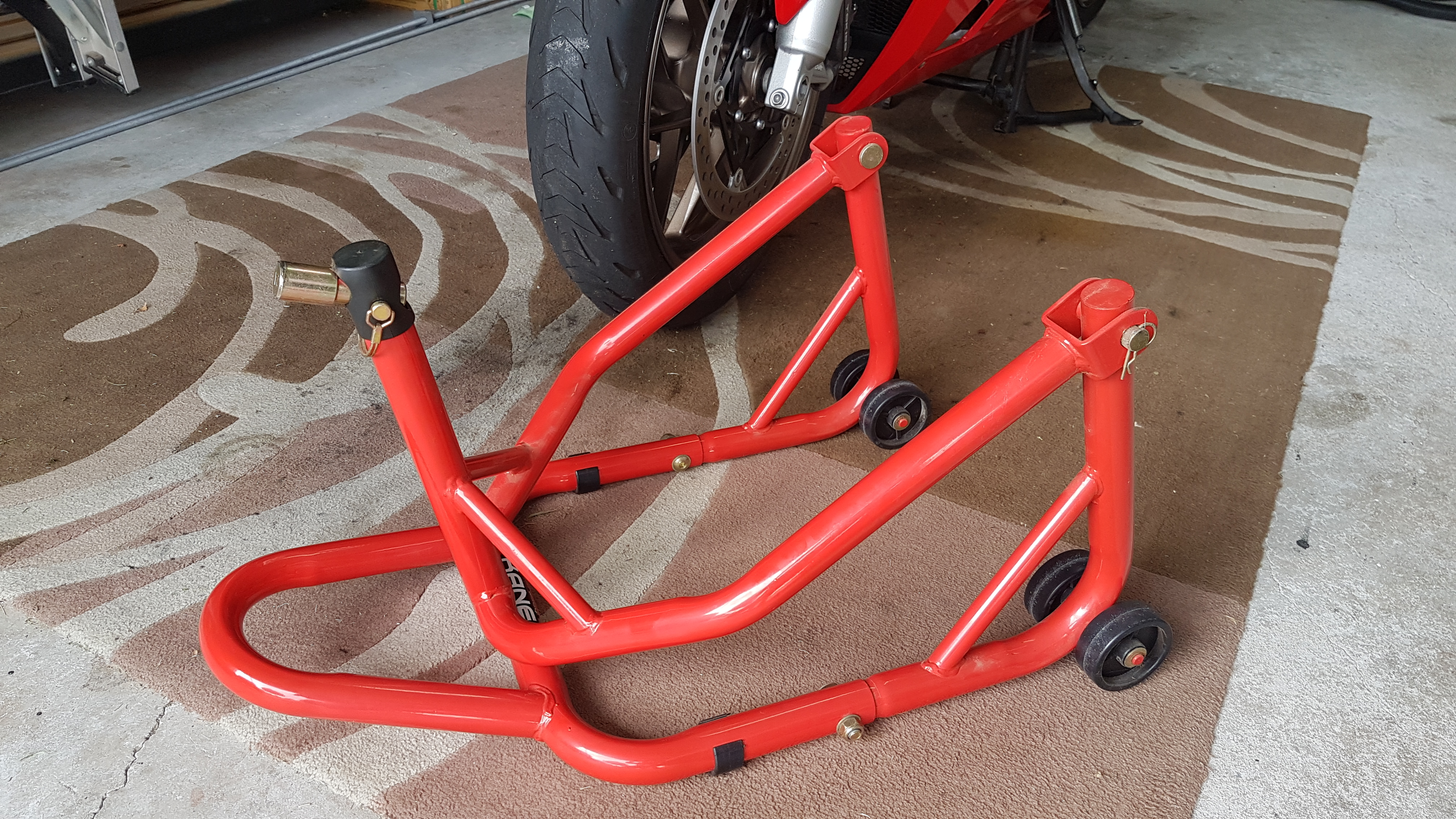

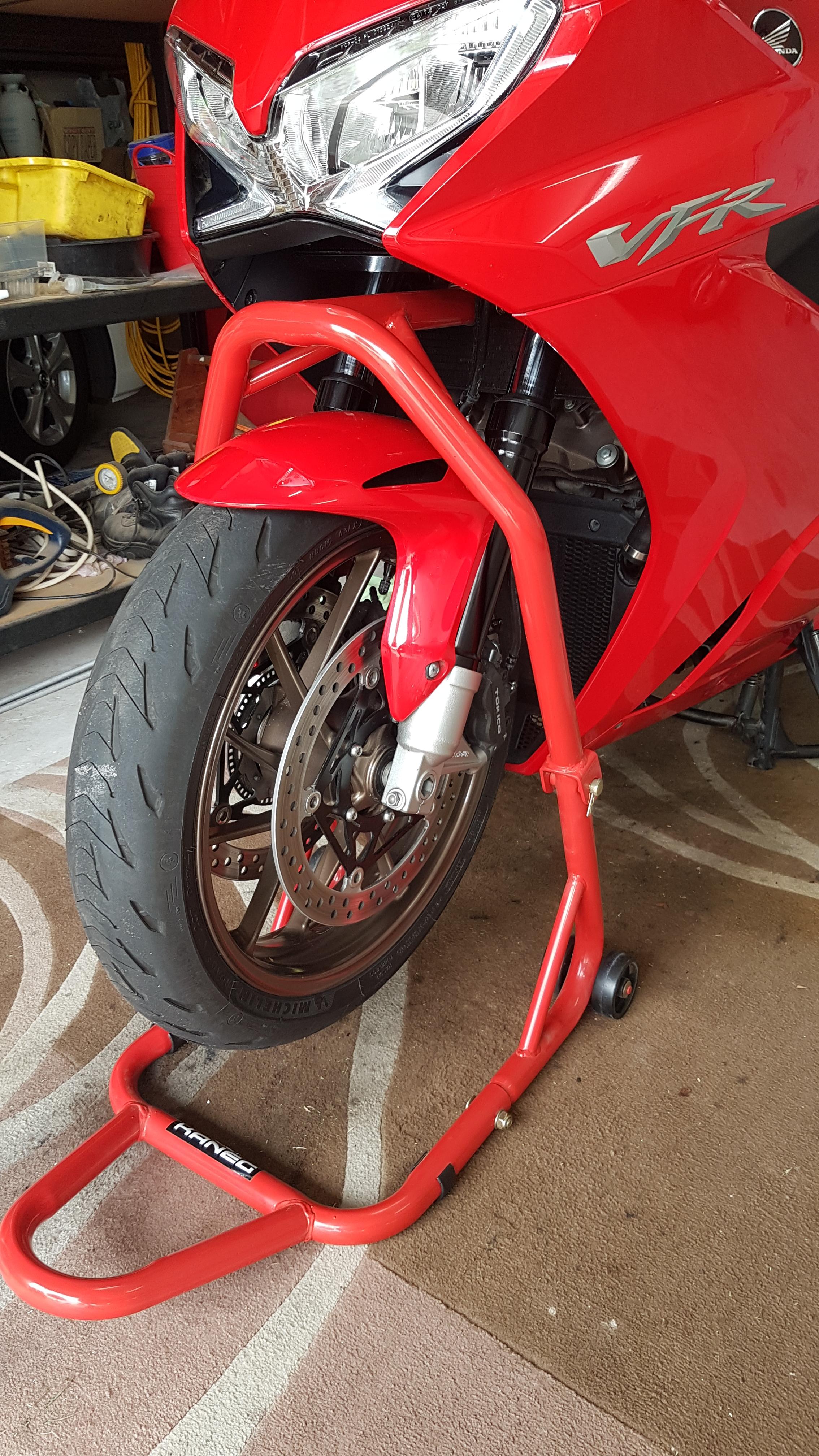

Member Contributer Grum Posted November 21, 2020 Member Contributer Posted November 21, 2020 Have a head lift stand made by Kaneg, check out their web site, they have a huge range of stands. Find this is just brilliant for dropping the front wheel, works great combined with the bikes center stand. Not sure if this is what you're after. 1 Quote

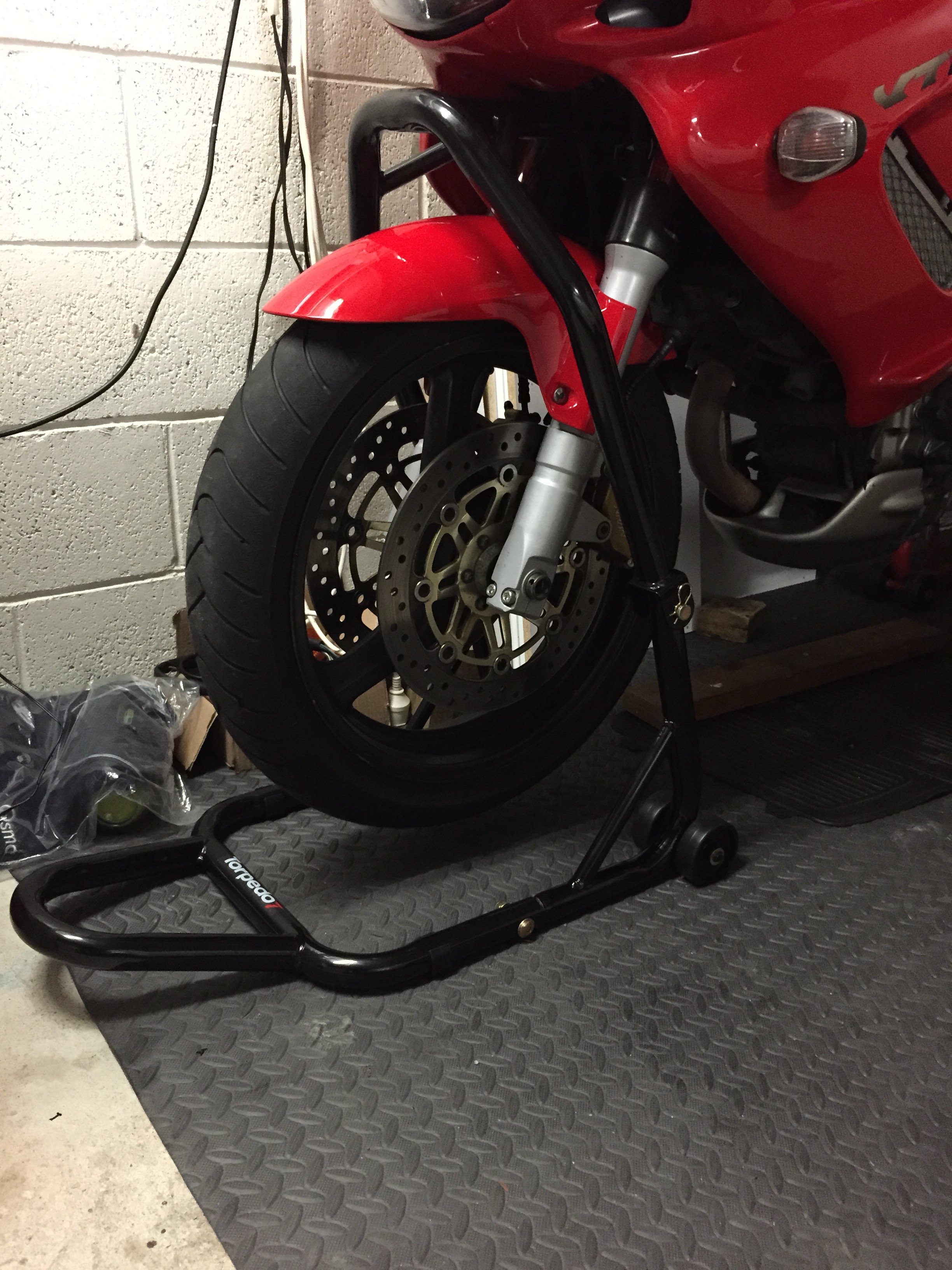

Member Contributer Terry Posted November 21, 2020 Member Contributer Posted November 21, 2020 I have a very similar stand locally retailed by Torpedo7: https://www.torpedo7.co.nz/products/T7S7LNNFH/title/torpedo7-motorcycle-front-head-lift-stand It is very easy to use and super stable. Quote
Member Contributer Grum Posted November 21, 2020 Member Contributer Posted November 21, 2020 59 minutes ago, Terry said: I have a very similar stand locally retailed by Torpedo7 Hi Terry. I think our two head lift stands from two different companies appear to be so identical perhaps they were made in the same factory! Glad I got the faster colour! Quote
