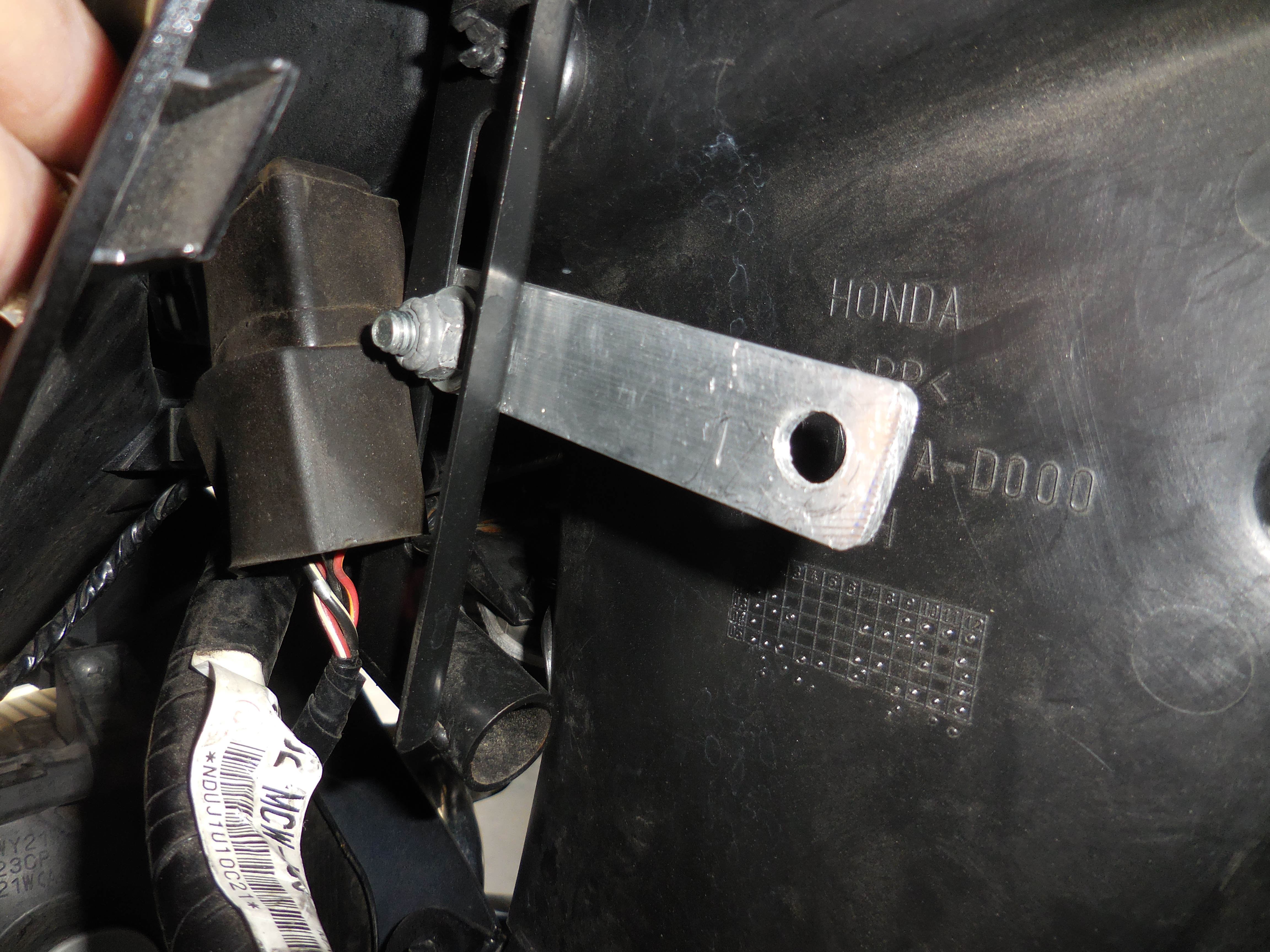

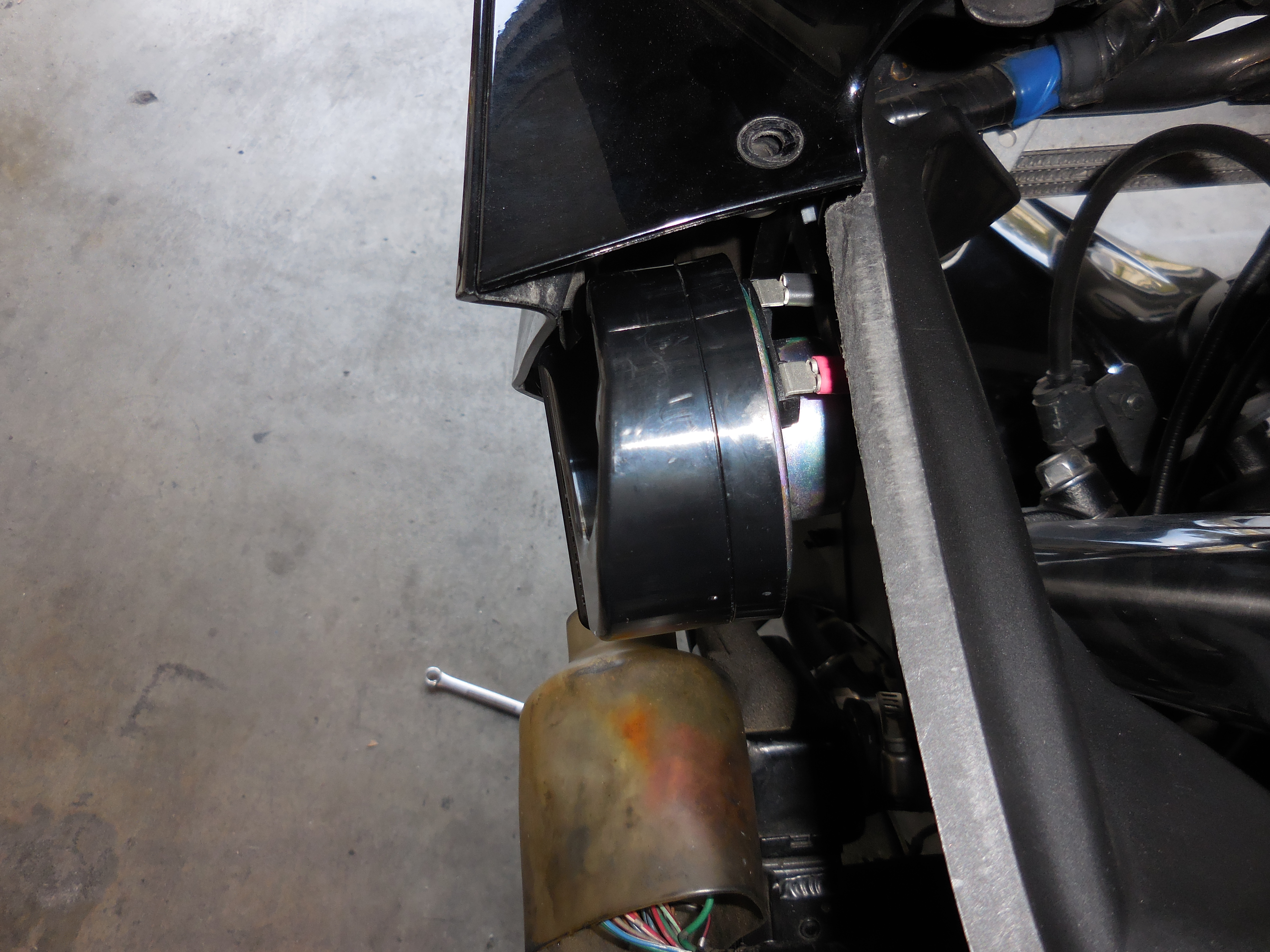

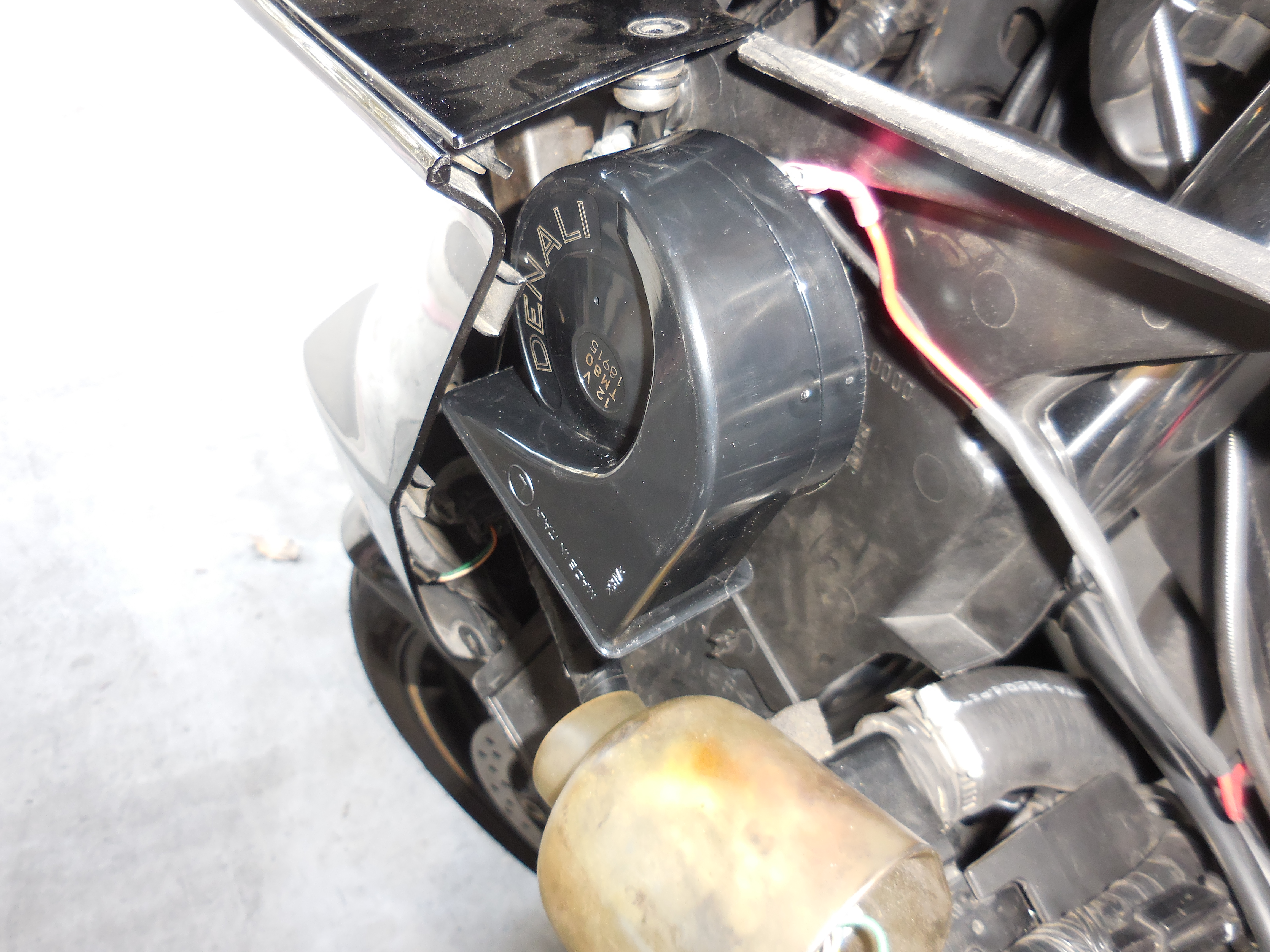

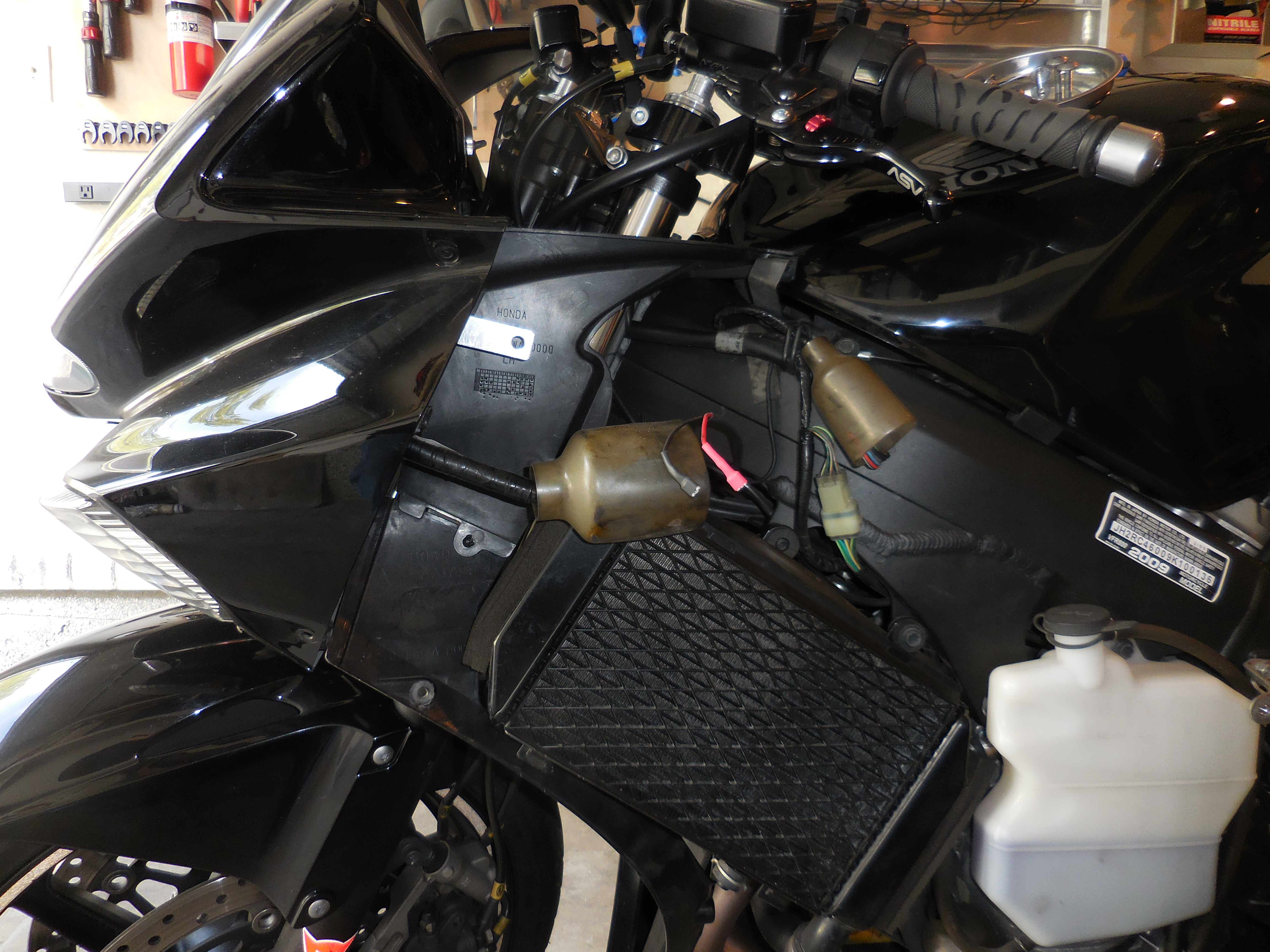

Although not the full size Stebel, I put a Sound Bomb Mini inside the left had side fairing where Marooncobra mentioned. I used an aluminum bar and bolted it to the fairing sub frame.  Here are some pics.

The Aluminum bar mounting location and final results
@Duc2V4, how do you like that Denali, I was thinking of getting one. I'd like a horn that sounds like a mid 70's Cadillac, my reference for a horn that gets peoples attention in primal fear kind of way.
It works really well IMO, although being behind the fairing does muffle it a little bit but it's definitely louder than the OEM horn, it has caught the attention of a few motorist though. I thought about relocating it in a more open area but in all honesty I don't use it all that much, only in the rarest situations that calls for it and/or an evasive action. The size of it definitely makes it easier to find a possible mounting location.
