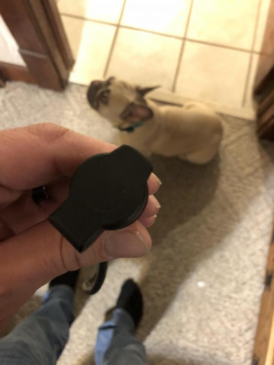

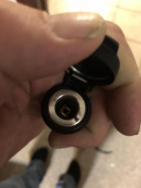

PepperVFR Posted March 2, 2020 Posted March 2, 2020 I just sold mine that was in the forks, they do make them but as I hear they are hard to find....like this? Quote
