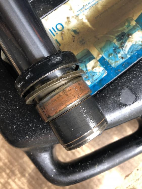

Northesk Posted February 23, 2020 Author Posted February 23, 2020 Good thing these forks are getting rebuilt, the bushing looks worn. Plus the oil was a horrible colour, with metal shavings floating around. Quote
Member Contributer Dutchy Posted February 23, 2020 Member Contributer Posted February 23, 2020 Aye, they ARE worn alright... Quote
Member Contributer Terry Posted February 23, 2020 Member Contributer Posted February 23, 2020 Actually, the bushings don't necessarily look worn to me. The thicker lower bushing is showing a full dark grey coating of teflon on its outer, sliding face, as it should. The skinnier upper bushing is showing its non-sliding, back surface that sits wedged into the top of the fork leg. You can't see the sliding face against the fork tube. 1 1 Quote
